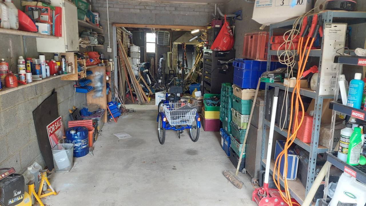

It's been a bit quite car-wise of late, and that's because I've been rather busy with the workshop.
It started as two sheds and a shanty shack very loosely attached to the side. These were built behind the current garages:
It doesn't look terrible here, but it leaked like a sieve and never really dried properly after heavy rain.
This is looking from the back of the carport/shed lash up through into the double garage.
The ax has been secreted elsewhere to create a through route for the demolished sheds and the new garage panels.
There were 3 roofs here, the one on the carport and 2 over the sheds, most was third hand corrugated steel sheets. Heavy work to remove, but a glimpse at the available space.
All the shed walls were double clad, this is the back of rhe woodshed knocked through to the car port.
Any tin I couldn't fit in the berlingo was left out for the scrap man.
The skeletal remains of the sheds, the roof sheet in the background is roughly where the blue bike was leant further up.
Each time I built up a load of timber, the little berlingo was filled and taken to a neighbour whose whole property runs on a wood fired boiler, he is always happy to take any old timber, well apart from the bits that had been soaked in creosote.
Of course nothing is ever simple, the fence that was supporting the roof was very well attached ton3 very rotten fence posts, as the fence is only temporary, i sistered in 3 new posts on the other side of the fence, but had to leave part of the roof structure up until I could do so.
Lastly the slabs are now just about clear for the delivery on Sunday, I've just to knock a few bits of old mortar off where the dwarf walls were, and repair the retaining wall at the back.20240829_184723.jpg.f50d33eb1287aecb2e138438e1d5aad2.jpg
