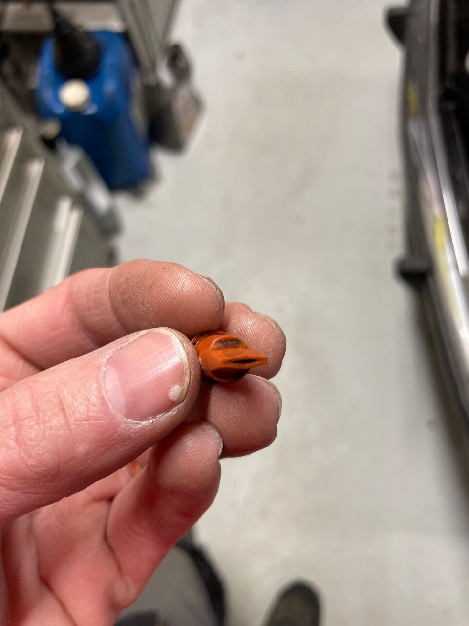

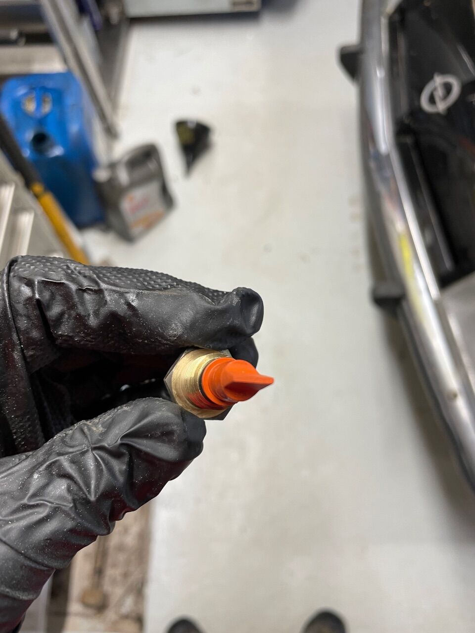

The new duckbill valve arrive. £22 for that! Jeeeeeeezzzzz.
anyhoo.

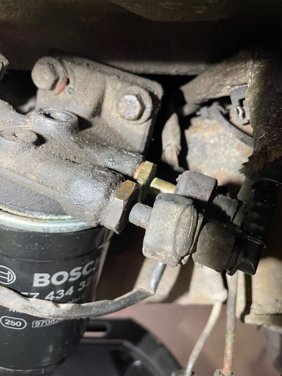

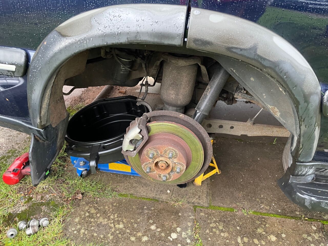

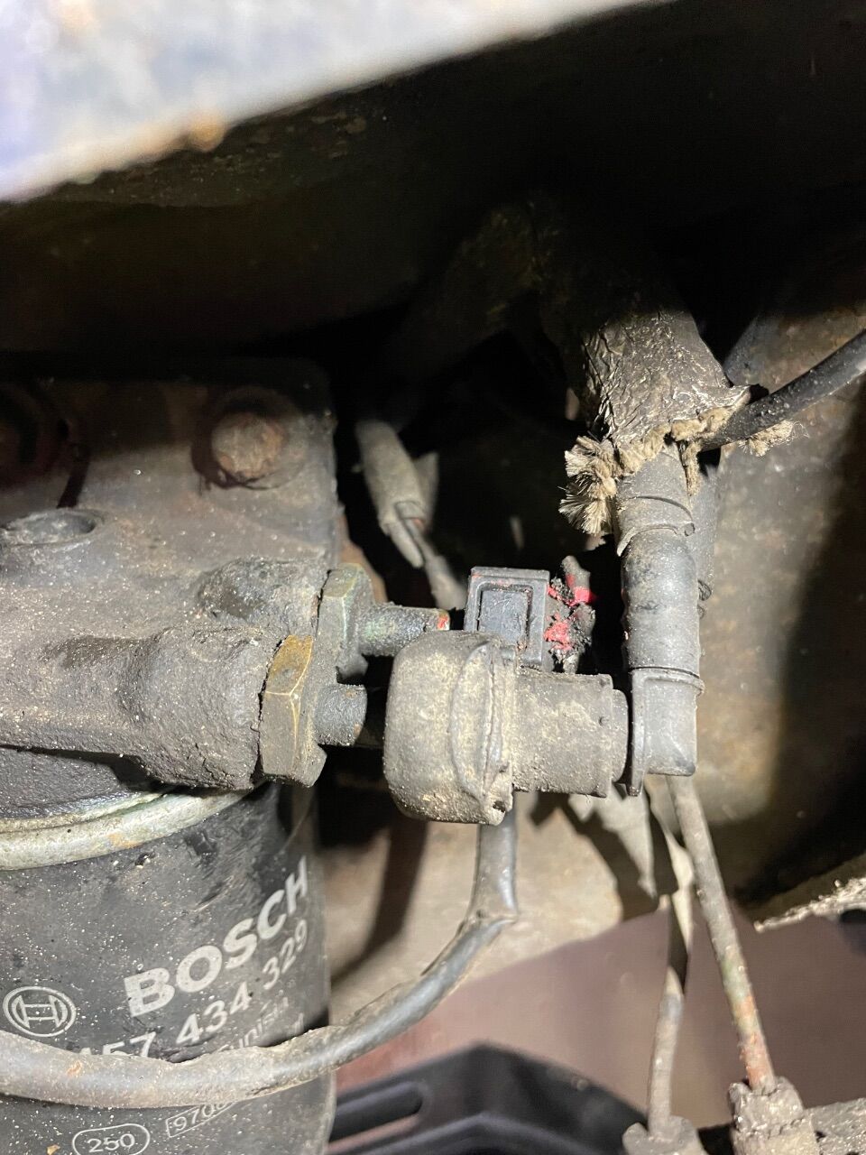

off with the wheel in the rain
it’s that back pipe there, closest to the chassis. See it?

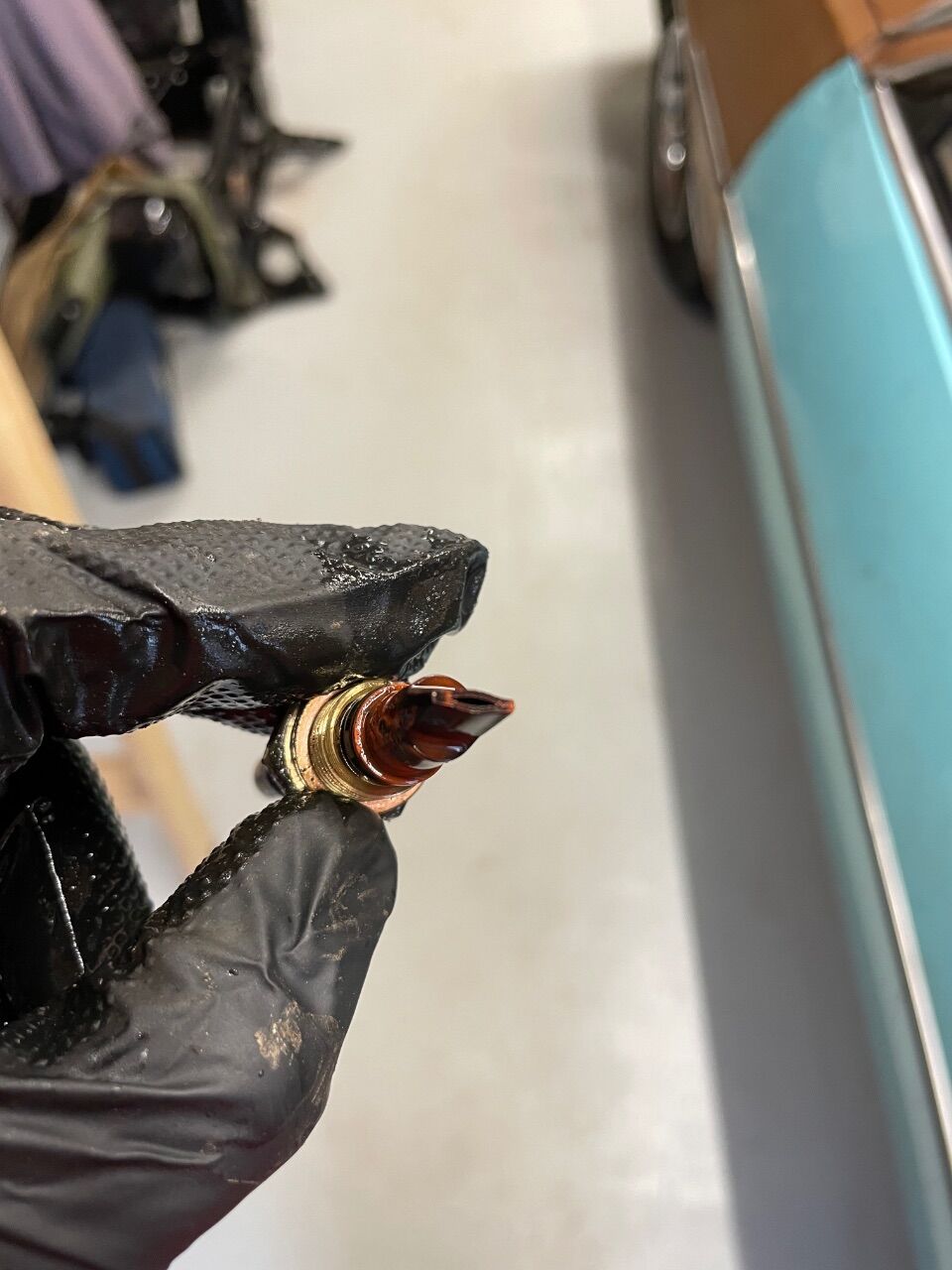

with that union removed the duckbill one way valve sits inside.
And it’s definitely buggered
its jammed open.
here’s a better pic
new one
such a simple job to do. cleaned up the union and refitted.
Two primed of the ignition and it’s running. Let’s see if it starts up in the morning eh!

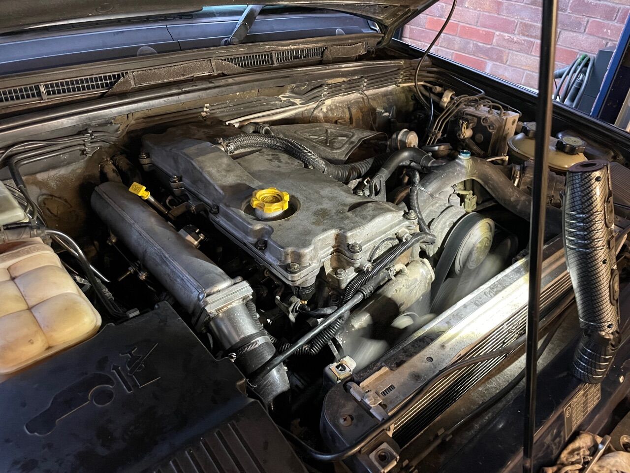

Guess who’s spending MORE money on the fuel system today!
When the injector seals were knackered on my Td5 I’d got a mega squealing noise from the in tank pump when priming, don’t know if you have anything like that?
Nope it’s pretty quiet now there’s a new pump on board. By the time I’ve finished the injector seals there won’t be much left to change other than the injectors themselves and the high pressure pump!

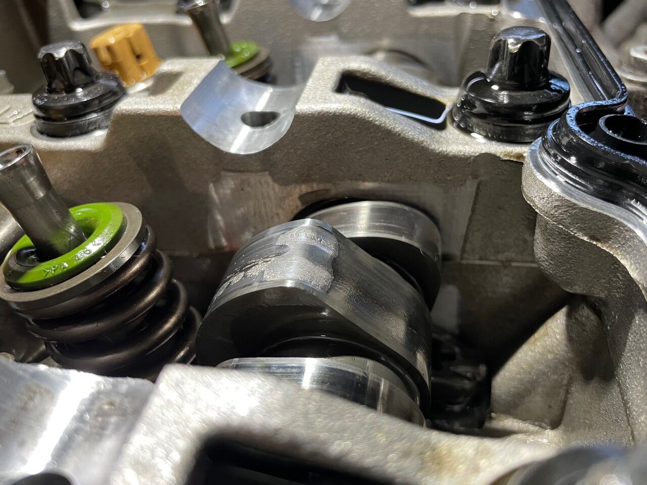

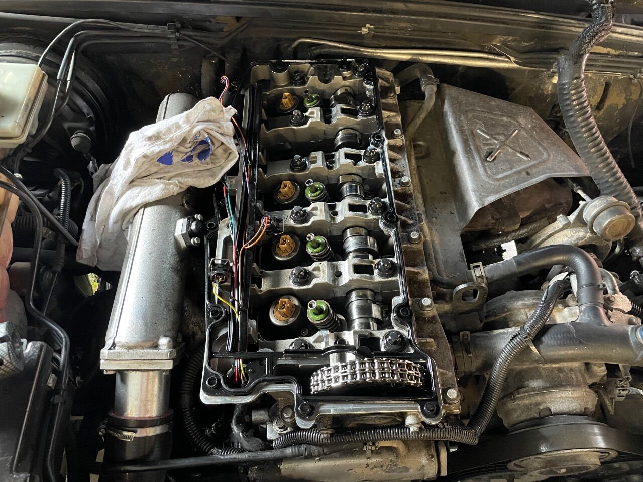

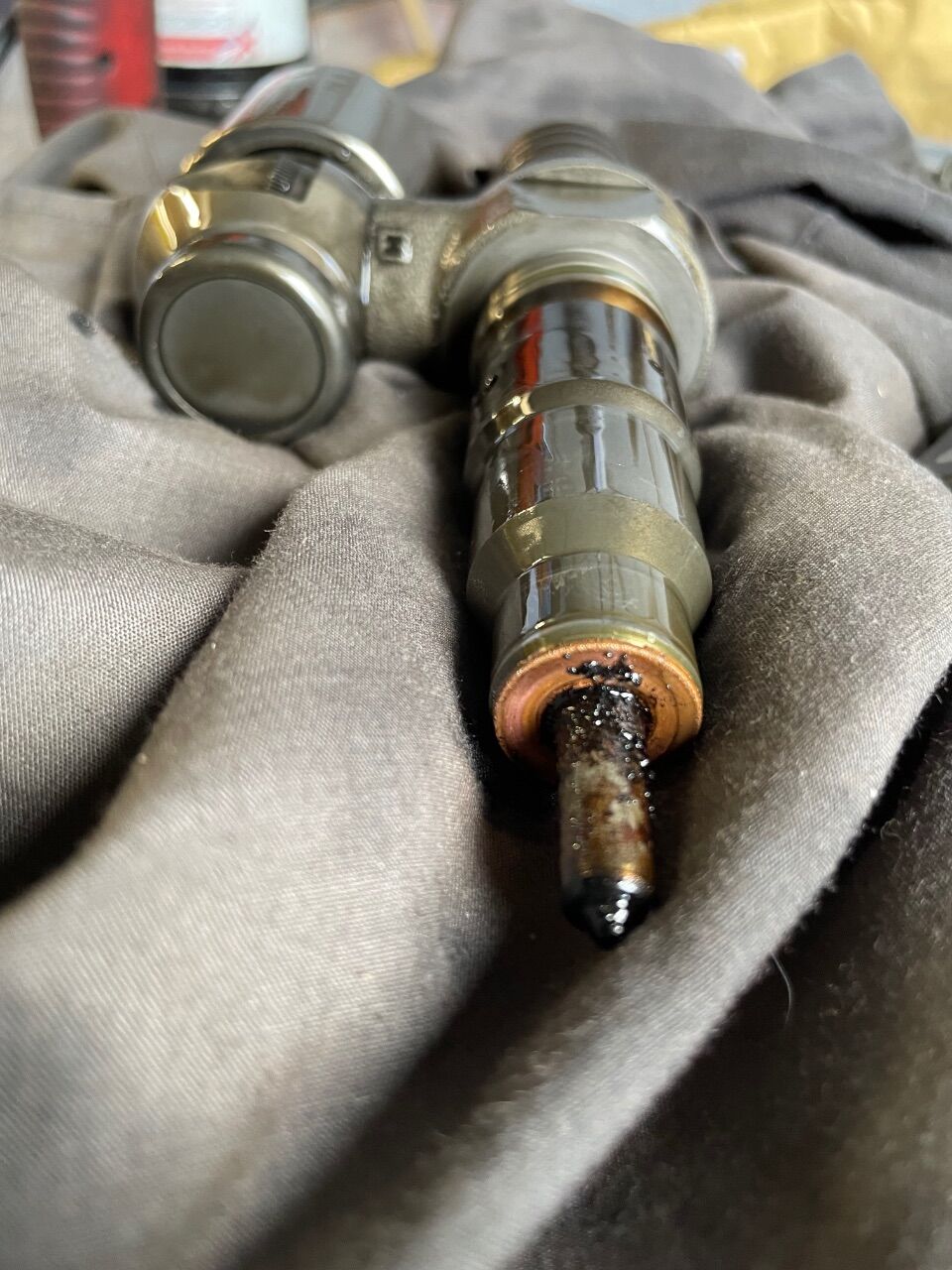

because changing the broken non return valve didn’t cure my starting issue, the next job is injector seals.
all 5 copper washers and seals replaced. A bit of a faff cleaning the injector holes out but it’s all done now. Tbh they weren’t that dirty.
still, they needed a good clean.

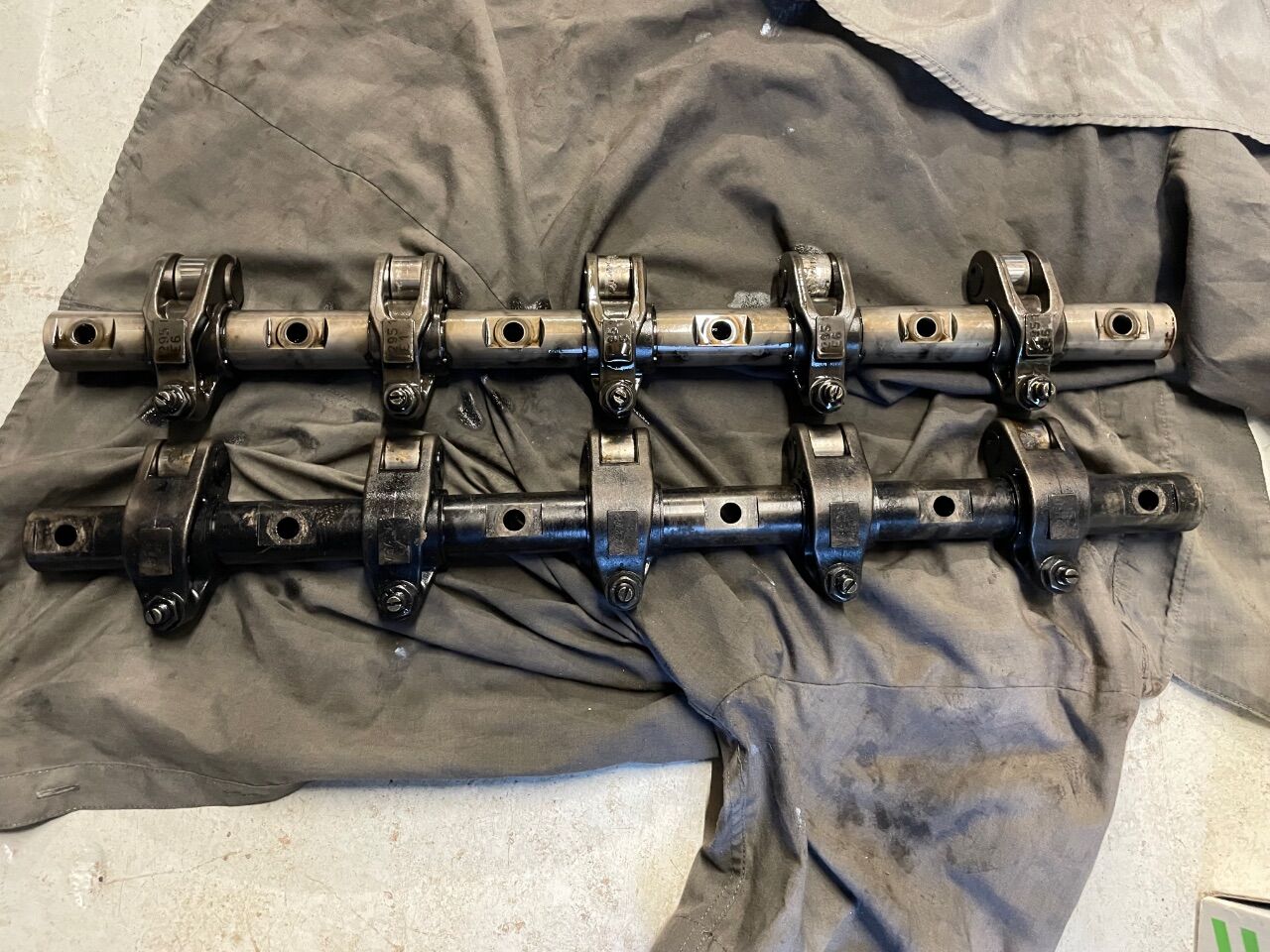

BUT. We have some bad news. The injector rockers are toast on cylinders 2 and 3.
not good. And the cam is a little worn on 2.
Yeah. NOT good, seeing as the camshaft is a head off job to replace. I don’t think I’ll be changing that cam, not at 200k. It can have a new rocker shaft and I’ll risk it for a biscuit.

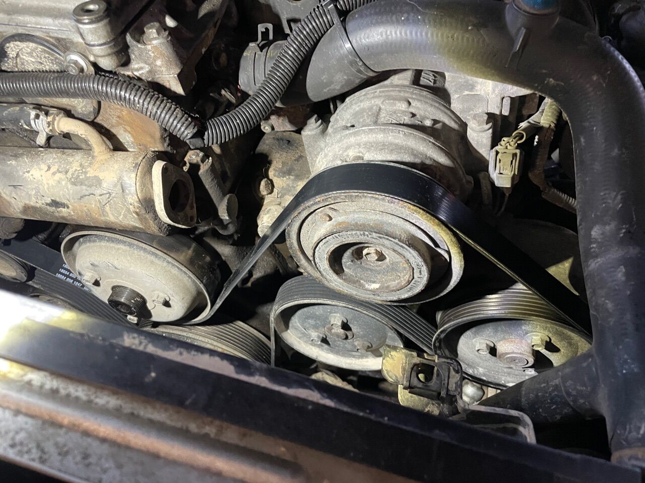

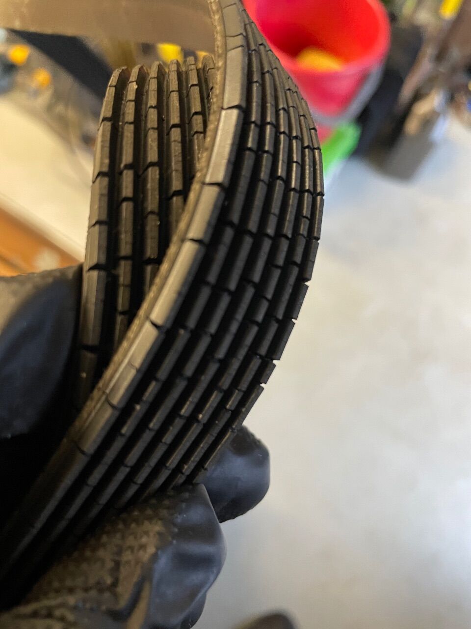

while I’ve got the fan off, it can have a new belt!
It’s running and driving again, but we will see over the next few days if the starting issue is cured.
TD5. Yuck.
If only they'd done that bit more development, it could have been amazing.
3 hours ago, comfortablynumb said:
How old is the belt? They seem to last the entire 200k, or fail within 1k IME
No idea. It was on when I got it. New one came in a box of spares with the car . It’s done nearly 200k but I highly doubt it’s the original. It has had a cylinder head around 150k but my guess is they reused the cam and rockers etc.

second hand rocker shaft. I was amazed at how black and coked up the replacement was in comparison to the original one I’ve taken off. You could say that this engine has been well looked after as the top end isn’t dirty at all! Apparently these rollers on the rocker shaft can seize up and cause damage, but they weren’t. Is it possible that they once were stuck but freed themselves off? I dunno.
there is a slight difference in design, but it makes no difference to running at all.
