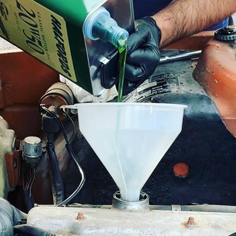

The inspector is coming in a few days, so I’m getting the old girl some attention:
More work yesterday on the 1974 BMW 520 E12. Oil & filter change and looked at the spark plugs. They’re the wrong ones and gap was too wide. Went for another mini drive and idle still crap.
New ignition parts to be ordered (dizzy cap, rotor arm, condenser and plugs) valve clearance to be adjusted and timing to be check. Only after all that is sorted the. I can start the carb tuning… which I still need to learn.
