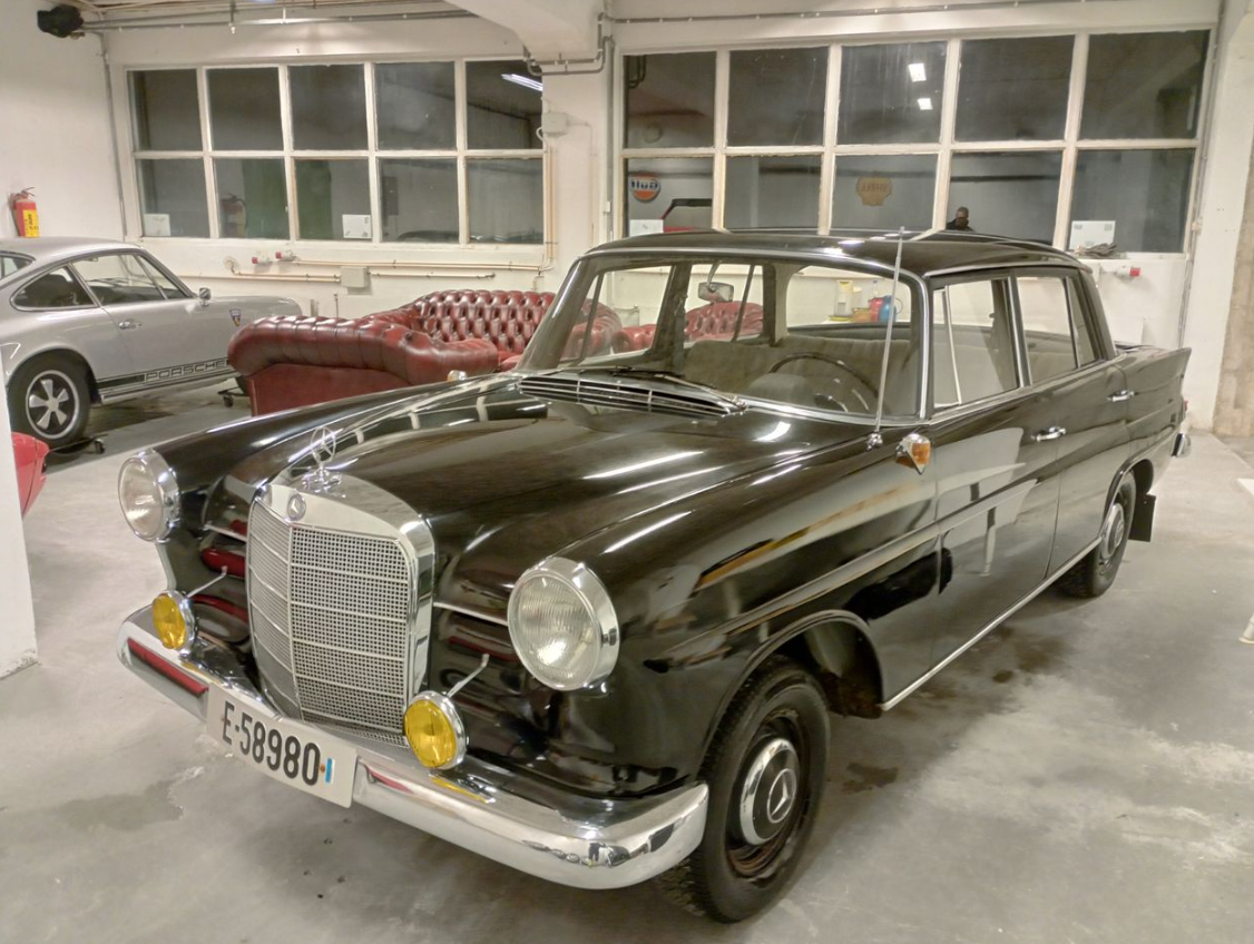

Dyslexic Viking Posted May 19, 2024 Author Posted May 19, 2024 If anyone wants to see pictures of a beautiful untouched one of these, below is the link to one that is for sale in Norway now. It is quite similar to mine but is in much better condition, so if I wanted a really nice and original one, it would be cheaper to buy this one and have both. https://www.finn.no/car/used/ad.html?finnkode=338465284 tooSavvy, Dick Cheeseburger, Jim Bell and 8 others 11
