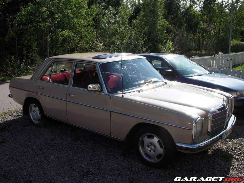

Another blast from the past: Mercedes 220D -75. I took the train to Gothenburg, bought it and drove it home. Noisy and with crappy seats it was not an enjoyable journey. After a couple of years i sold it and I can´t say I miss it. It looks like it´s been exported from Sweden in 2022.
The car beside the Mercedes is my ex-girlfriends Honda Accord 2,0 LS -94. Total reliability. She had that car for many years and drove it 220 kilometers every day.

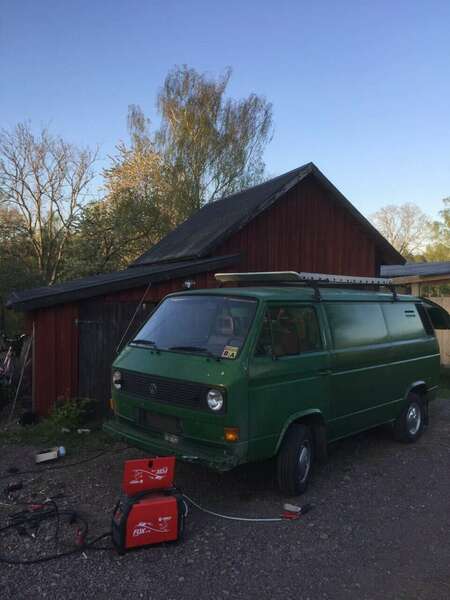

Had the VW T3 in for our version of MOT. Two guys checked the car over. One of them bumped into the Turbo… and I thought that was it. Ah, it’s a diesel he said and it was a PASS!
They should have seen me 15 minutes before I rolled into the testing station. Pressure washing an oil leak away and removing the engine hatch so they hopefully wouldn’t notice that the engine now is a bit bigger than it should be and therefore sticks out through the engine hatch.

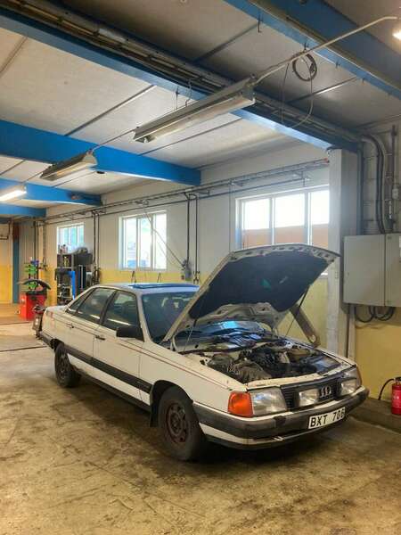

Took the Audi 100 out on its first proper test drive, it needs to have the cobwebs blown out off it. It’s done 300 kilometres in the last 10 years. First drive went to an abandoned Swedish air force base. I almost had a trouser accident when I lifted off the throttle at 100 km/h and the car turned sharp right… on acceleration it turn’s slightly too the left, but when you lift off the throttle it bites. Need to look into that. Otherwise it cruises really nice. Work for the upcoming weekend includes changing a noisy generator and some other minor stuff.

Audi 100 Diesel: Had some time after work before it got dark. So I tried to get the gearbox better. The linkage is badly worn. I had some success, reverse is now easier to find. Fifth is also easier but the linkage needs new bushings.
The other problem this car has is that you can’t switch the engine off with the key. The former owner claimed ignition switch, but I measured 12 volts at the fuel shut off valve when the ignition was on and zero volt when it was off. I can hear the valve working but the engine won’t stop. So I guess the valve is bad?
Other stuff I realised is that the battery is bad and the clutch is on its way out even though it feels fine when you drive.

Audi 100 Diesel: Had a few minutes to spare. So I changed the fuel shut off valve and success! I can now turn the engine off with the key. The work was really simple, took maybe 10 minutes including getting the correct tools. But the battery is definitely bad, had to jumpstart it.

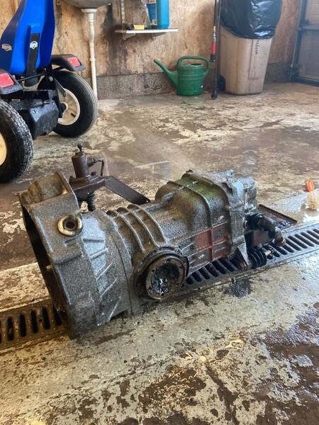

VW T3: gearbox change. Well that went downhill fast.. while prepping the new gearbox I noticed that it looked slightly different. So I measured it and found that it was around 2 centimetres shorter than the old gearbox. Posted a picture on a T3 Facebook group and a nice German gentleman answered. Yes it’s an T3 gearbox, no it will NOT fit because it is an early one. Then I sat and stared at the floor for about an hour then packed up and went home…
