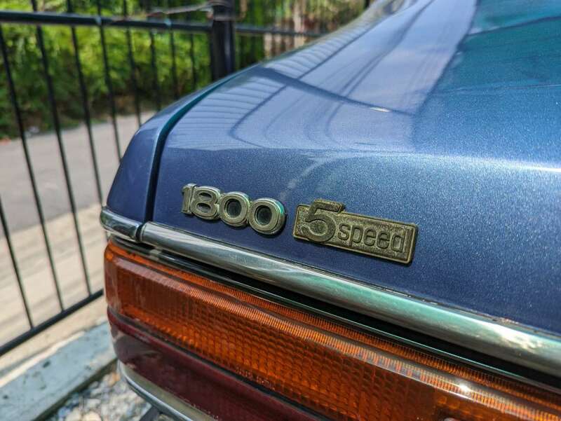

Firstly, it's important to show how decadent you are, 5 speed badge. I don't think this is actually original to this model but would anyone know otherwise?

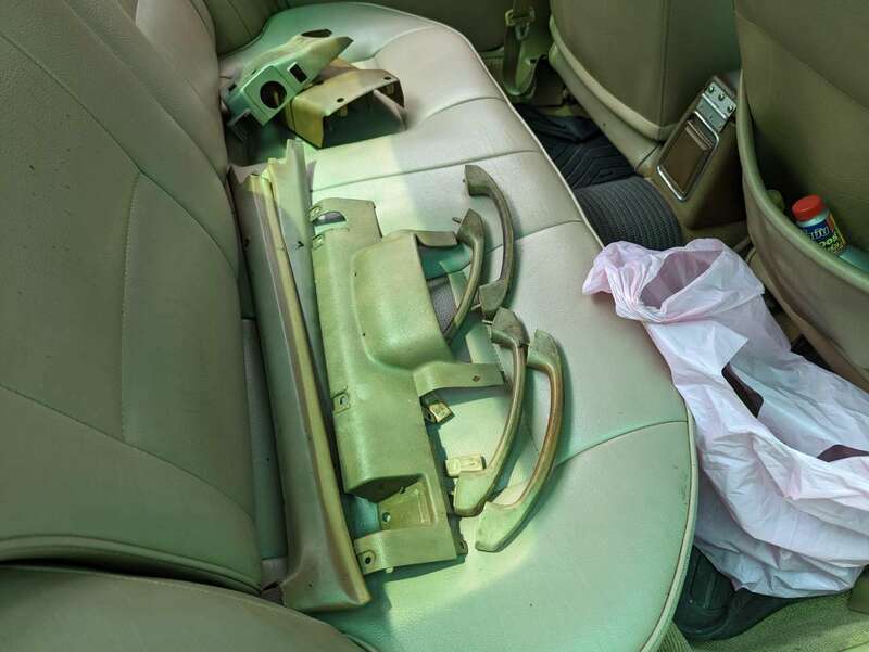

I also got a lot of hen's teeth interior bits. A-pillar trims, steering column cover, jesus handles, door lock button. I hoped for dash pad and b-pillar trim as well but they were shite so I didn't take them. I'm especially after the A-pillar trim and column cover so I'm happy.

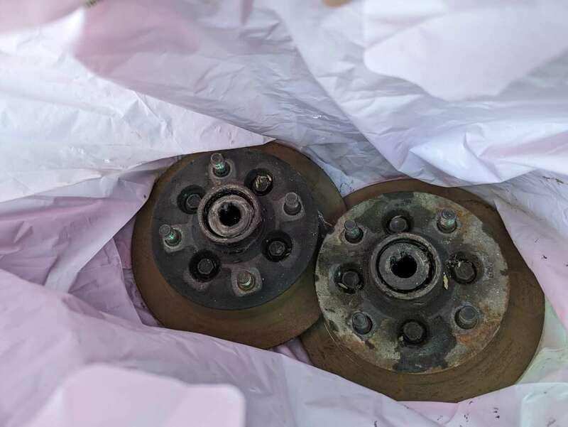

Most important bit though, one that made me jump very quickly. Used brake discs. Why would I buy manky old brake disc you might be wondering? Two reasons. 1. These are actually near new. 2. They're NLA.
I made sure to actually taking mine to pick them up and not a random modern. I find it works well when it's individual breaking their own car.
I paid £35.
No it was the inverse. First model to not be badged Toyopet in Japan.

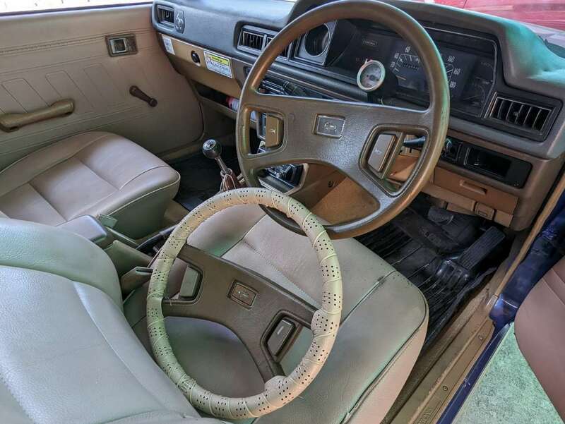

Found a replacement steering wheel for £20. The rubber rim of the old one was peeling away from the metal frame and was covered up with steering wheel cover. I removed that when I bought the car and replaced with lace counterpart which works well and looks good. But original rim in good condition cannot be compared so I'm pretty happy.
