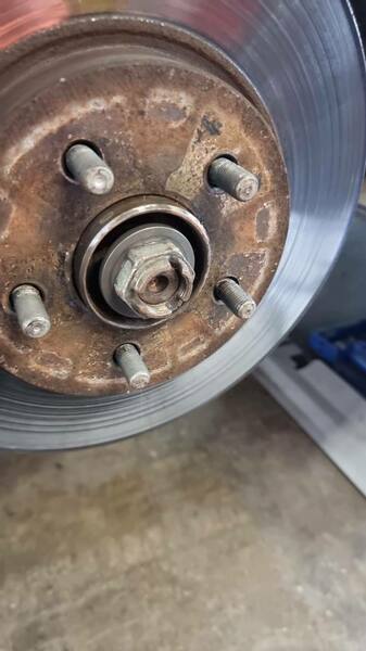

Just to give an idea of the absolutely amazing attention to detail paid by the last gibbon who wielded their magic spanners on this... Here's what greeted us when we removed a front wheel.. IMG-20220305-WA0002.thumb.jpg.c2a4b4ea6f437ccf8786750e0744fb25.jpg
Luckily we were able to repair the threads and replace the nut with one from the wheel bearing kit we also fitted.
