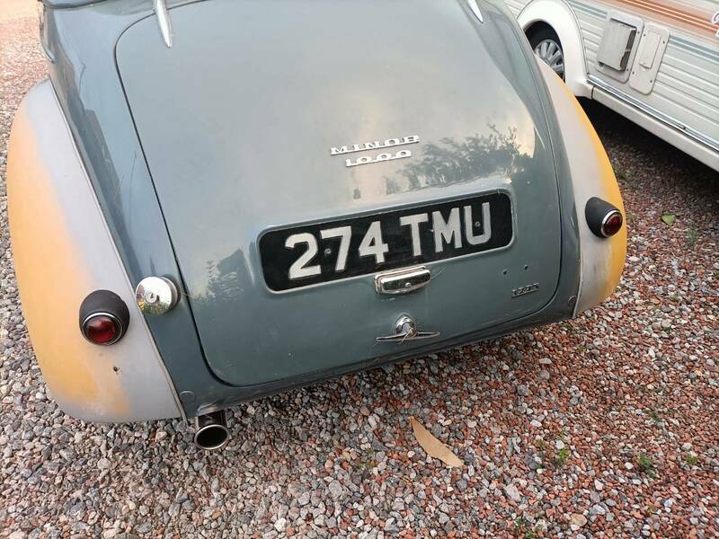

Looks brilliant. You should be justifiably proud of the work you've put in.
Cheers but he's far from finished.
There's no interior fitted,well it's in there but in boxes on the rear seat and in the boot and none of the lights are wired up either.
The rear lights look odd at the moment as the current red ones are actually the indicators and another pair the same need fitting below for the stop and tails.
And he has a horrible flat spot and hesitation when you accelerate hard so electronic ignition and probably a carb rebuild await.

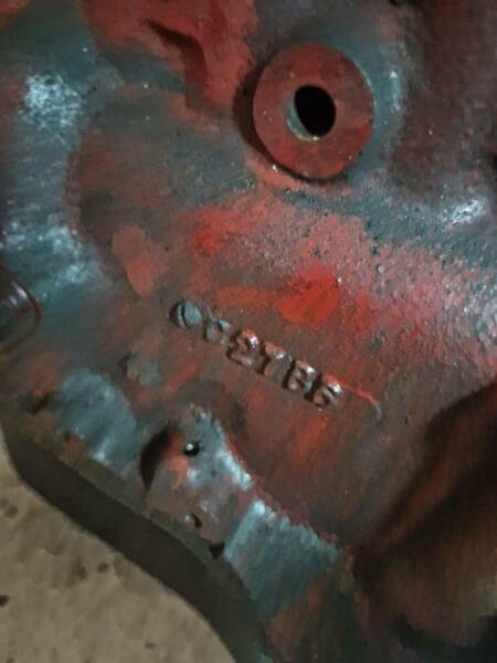

I had clocked the filter position and figured Marina, but a quick bit of mental reasoning under the bonnet I figured it would fit without impeding on anything else.

Many thanks to @Mr Pastry, @SiC, @Egrvalve, @MiniMinorMk3 and anyone I've forgotten for the ID help. Defo a 1275, defo a marina lump. Going to get on with this soon as possible. Thorough clean of all lumps first, engine strip and refresh (rings, shells, head gasket, oil pump all that jazz) gearbox rebuild but I'm farming out the diff to a mate. Too much pissing about with dtis and the like for me. I do mechanicals, never had much patience for measuring sadly. I can do, part of the training, just I'll avoid it where I can 😆
