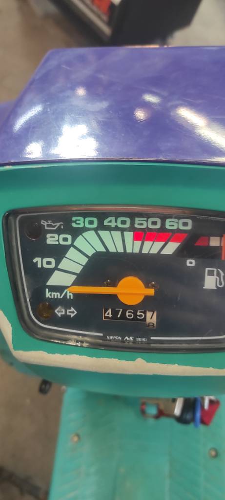

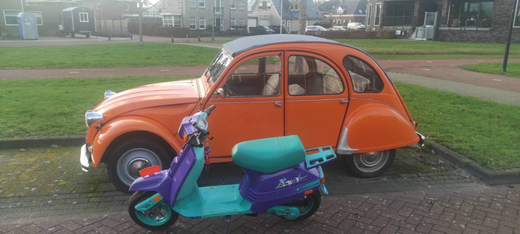

Inca-mpetent Posted January 27, 2022 Posted January 27, 2022 Since I couldn't really find a thread to post it, and did want to share, I guess I'm creating my own thread of stuff I am working on To start things off, my 1991 Peugeot Rapido is finally ready to go on the road after nearly 5 years. It still needs some work, though it's mostly fettling VID-20220125-WA0000.mp4 davehedgehog31, sdkrc, Jim Bell and 5 others 8
Inca-mpetent Posted January 27, 2022 Author Posted January 27, 2022 Things to do:- get some new stickers made(maybe), since the old ones are worn-limit the speed, as it does 50-55km/h at the moment, and 25-ish is allowed-more to be added as I find itSent from my Redmi Note 9 Pro davehedgehog31 1

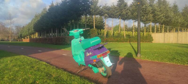

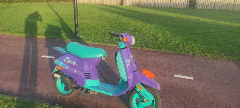

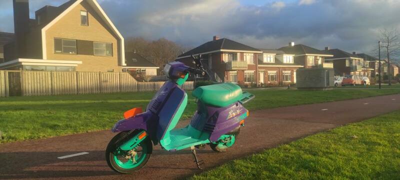

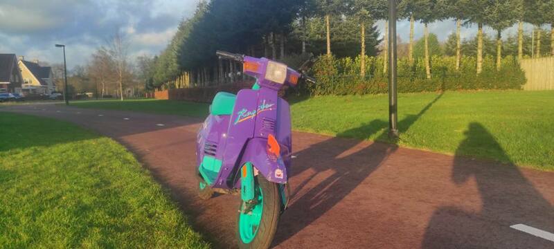

Inca-mpetent Posted January 29, 2022 Author Posted January 29, 2022 Took the Rapido out for a drive, and some pictures in the afternoon sunOnly did 4700 km in 31 yearsSent from my Redmi Note 9 Pro cort1977, Flat4, AnnoyingPentium and 11 others 14
Inca-mpetent Posted January 29, 2022 Author Posted January 29, 2022 By today's standards, a 2CV is small.......Then this thing is miniscule, but so much fun to driveSent from my Redmi Note 9 Pro 500tops, AnnoyingPentium and Low Horatio gearbox 3

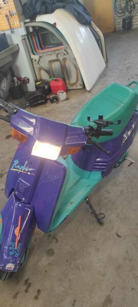

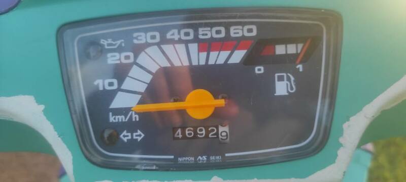

Inca-mpetent Posted January 29, 2022 Author Posted January 29, 2022 A definite thing that needs looking at.......It doesn't consume fuel too muchHeadlamp bulbs, on the other hand, are a favourite snack, it seemsThey don't last a day, and at €2 per bulb, that's quite costlySo, either I need to sort that, or get my hands on a truckload of B26S lampsSent from my Redmi Note 9 Pro AnnoyingPentium 1
Missy Charm Posted January 29, 2022 Posted January 29, 2022 1 hour ago, Inca-mpetent said: A definite thing that needs looking at....... It doesn't consume fuel too much Headlamp bulbs, on the other hand, are a favourite snack, it seems They don't last a day, and at €2 per bulb, that's quite costly So, either I need to sort that, or get my hands on a truckload of B26S lamps Sent from my Redmi Note 9 Pro It might be the case that the bulb holder has deteriorated. We had a bayonet light fitting in the house that was worn out and didn't allow the bulbs to seat properly. They kept blowing as a result. The same goes for my light up make up mirror, which blows bulbs frequently owing to poorly designed electrical contacts. Incandescent bulbs shouldn't be sensitive to changes in voltage, within reason, but seem to blow at any sniff of a short circuit.
Inca-mpetent Posted January 29, 2022 Author Posted January 29, 2022 It might be the case that the bulb holder has deteriorated. We had a bayonet light fitting in the house that was worn out and didn't allow the bulbs to seat properly. They kept blowing as a result. The same goes for my light up make up mirror, which blows bulbs frequently owing to poorly designed electrical contacts. Incandescent bulbs shouldn't be sensitive to changes in voltage, within reason, but seem to blow at any sniff of a short circuit. The bulb holder is fine in this case, as it doesn't exactly twist inThe negative terminal is a ring on the lamp, which connects to the reflector.The positive terminal is at the back of the lamp, to which a metal strip connects, which also holds it in placeBtw, it wasn't B26S, it was P26sSent from my Redmi Note 9 ProSaid bulb:
Mr Pastry Posted January 29, 2022 Posted January 29, 2022 1 hour ago, Inca-mpetent said: Headlamp bulbs, on the other hand, are a favourite snack, it seems They don't last a day, and at €2 per bulb, that's quite costly Isn't that a sign that your generator is over-charging?
Zelandeth Posted January 29, 2022 Posted January 29, 2022 That thing is fantastic, love the colour scheme. Worth checking the system voltage to make sure your headlight bulbs aren't being nuked by way more volts than they're designed to handle. No idea where the regulator would be on one of these. sdkrc 1
Inca-mpetent Posted January 29, 2022 Author Posted January 29, 2022 Isn't that a sign that your generator is over-charging? Could very well be, might take a look at thatSent from my Redmi Note 9 Pro
Inca-mpetent Posted January 29, 2022 Author Posted January 29, 2022 That thing is fantastic, love the colour scheme. Worth checking the system voltage to make sure your headlight bulbs aren't being nuked by way more volts than they're designed to handle. No idea where the regulator would be on one of these.It's a magneto, and I will check operating voltageThe colours are prime late-80s, early-90s, when I wasn't even bornAnd they have grown on me, big time.This thing is never leaving my fleetSent from my Redmi Note 9 Pro Matty 1

Inca-mpetent Posted February 2, 2022 Author Posted February 2, 2022 Quick Rapido update: Ordered a new voltage regulator in Monday, which arrived today at my dad's (as he's home most of the days, and I'm not), and he was kind enough to drop it off at my work(where the Rapido and I were), and I replaced it, and the lightbulbs(headlight, tail light, dashboard illumination) on my break. And during the drive home I kept an eye on it. Seems to be working properly now Still to do(kinda urgent): -horn. button is probably f*cked, so either order a new one, or reroute to another switch, Also still to do (not a priority): -New starter motor -Get a set of stickers made, as the current ones are worn(only if I have some spare cash) Sent from my Redmi Note 9 Pro LightBulbFun, Six-cylinder, Zelandeth and 2 others 5

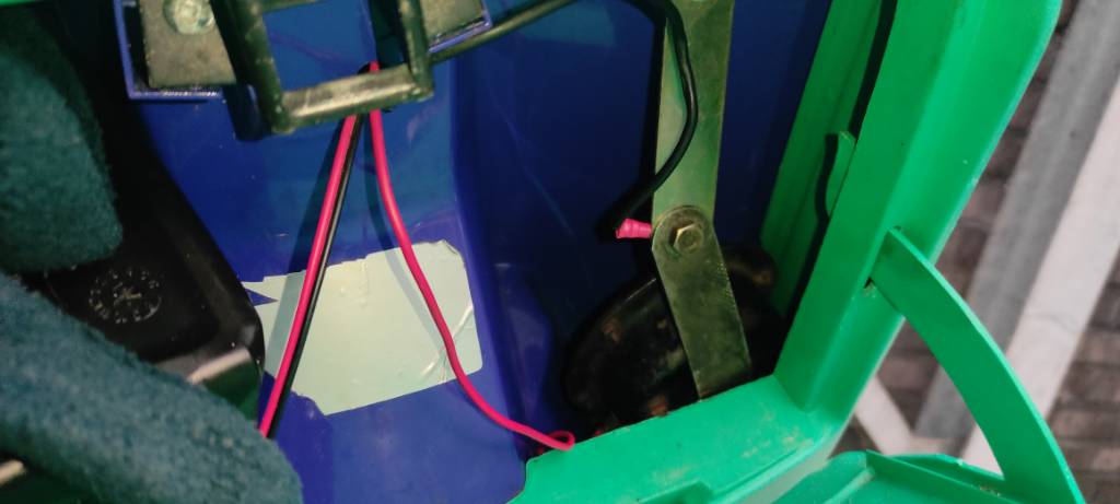

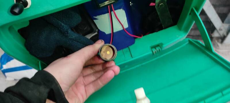

Inca-mpetent Posted February 3, 2022 Author Posted February 3, 2022 More good news, horn is fixed now The one that was on the Rapido is dead Pulled a 2CV horn from the parts bin at work, got it going on my break, mounted it in the glovebox, wired it up, and boom, I have a very loud horn now Botch-job well done, if I may say so myself I also fitted a 12V socket in said glovebox, when I got the Rapido, back in 2015, which is good for charging my phone AnnoyingPentium, mk2_craig, LightBulbFun and 4 others 7
Inca-mpetent Posted February 3, 2022 Author Posted February 3, 2022 On 1/29/2022 at 6:03 PM, Missy Charm said: Incandescent bulbs shouldn't be sensitive to changes in voltage, within reason, but seem to blow at any sniff of a short circuit. getting back to this for a second, since I found out some things. point is, the voltage regulator let through AC power from the engine, which kept killing the bulbs Six-cylinder 1

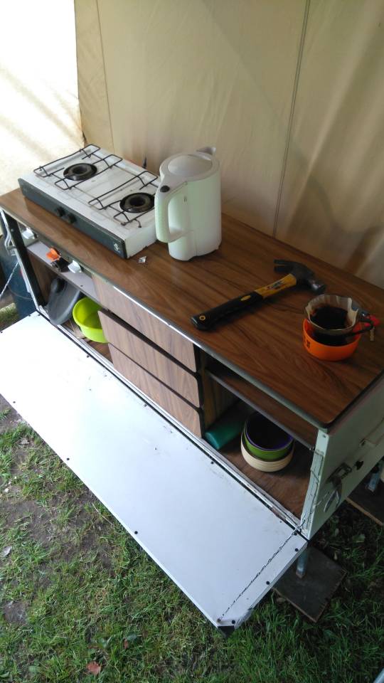

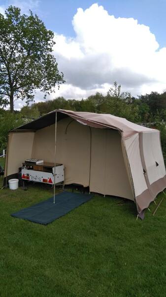

Inca-mpetent Posted February 17, 2022 Author Posted February 17, 2022 On my big list of things that need sorting, I almost forgot something.My 1983 Conway Campa DL trailer tentThe canvas needs restitching, badly.Something that's going to be an expensive job.Could buy another one to replace, but nah.Because 80s, with all the brown goodnessSent from my Redmi Note 9 Pro Asimo, Low Horatio gearbox, privatewire and 4 others 7
Inca-mpetent Posted February 17, 2022 Author Posted February 17, 2022 Bought the thing in 2018 for €350, used it once to find out what's wrong with it.Turns out, having to get up in the middle of the night to tape the roof back together isn't good, so restitching is needed.That stove is missing a nozzle for a gas hose, which I can probably work out.Might consider fitting a CEE connector and an outlet in itSent from my Redmi Note 9 Pro AnnoyingPentium 1

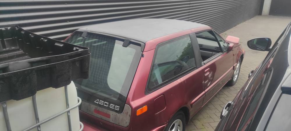

Inca-mpetent Posted May 30, 2022 Author Posted May 30, 2022 It's been a while, and I bring great news!A new project will soon land on my doorstep (when I collect it next week)It needs some love, but has tons of potential.Sent from my Redmi Note 9 Pro rob88h, tobyd, privatewire and 15 others 17 1
Inca-mpetent Posted May 30, 2022 Author Posted May 30, 2022 A 1995 Volvo 480 2.0 ESSent from my Redmi Note 9 Pro Dyslexic Viking and AnnoyingPentium 2
Inca-mpetent Posted May 30, 2022 Author Posted May 30, 2022 Fucken yasssssss.It's not roadworthy, though.It hasn't run for 1,5 years, and there's an aftermarket immobilizer that's missing it's decoder thingie, the MOT ran out in June last year Also, it won't be a long-stay car.I dabble in the car trade whenever I can get something cheap, which I could probably sellSent from my Redmi Note 9 Pro AnnoyingPentium 1
bear-in-the-air Posted May 30, 2022 Posted May 30, 2022 I have a soft spot for those, plus its a 2.0 which is a touch more rare. Good luck sorting the aftermarket immobilizer, they can be a nightmare sometimes. Low Horatio gearbox 1
