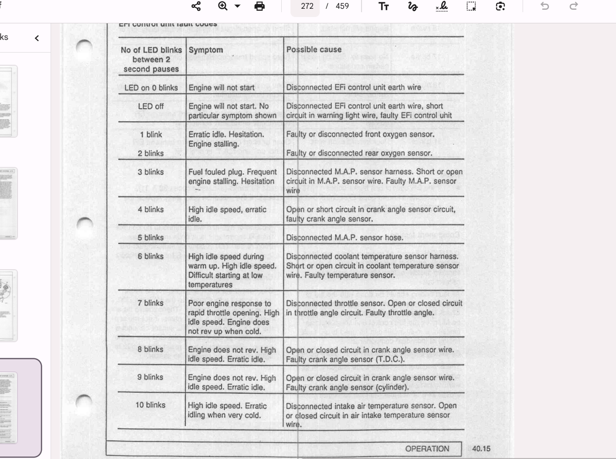

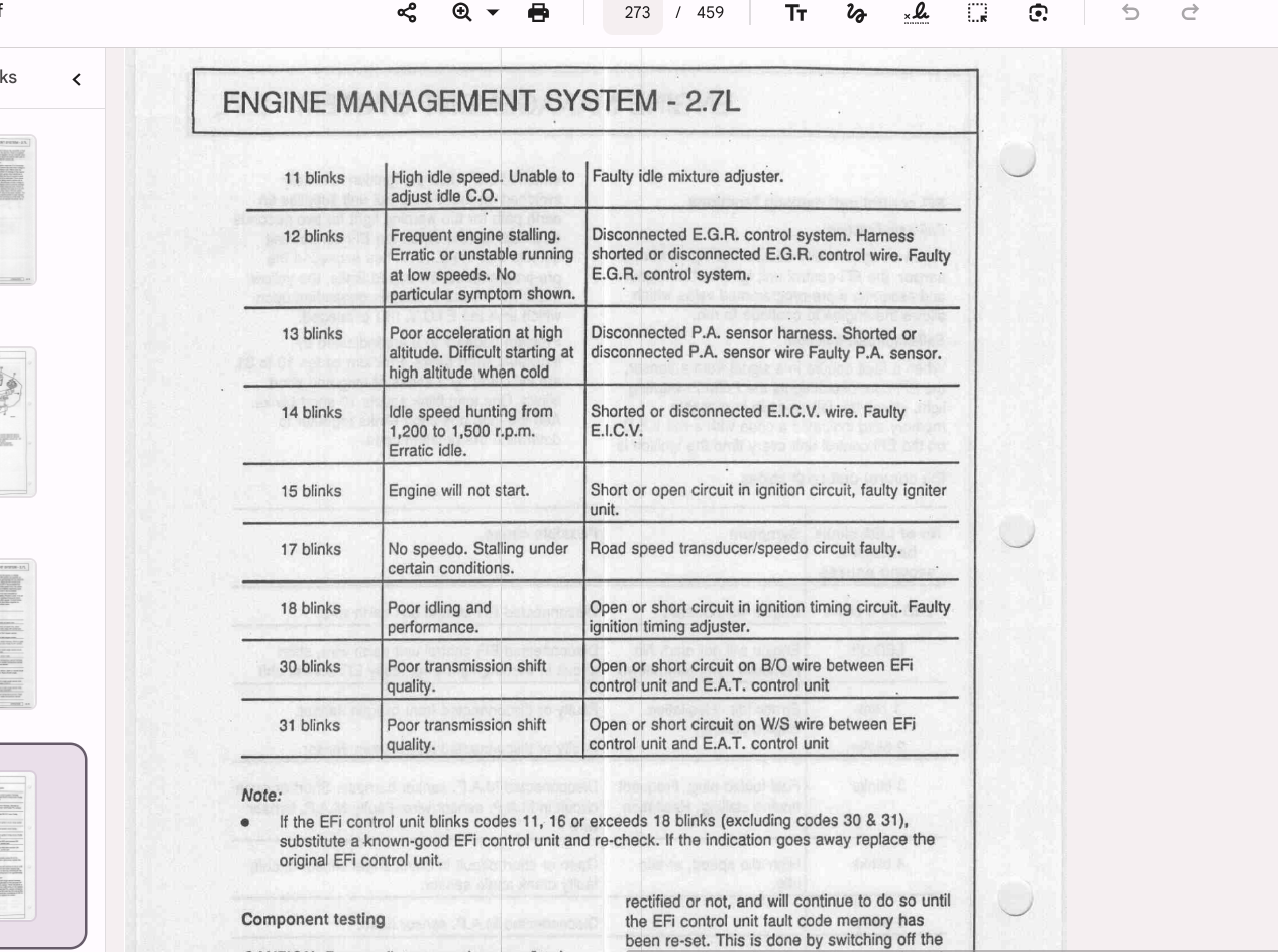

For 827 and possibly Honda Legend 2.7 V6 owners out there here are your LED blinks for the PGM-FI system...

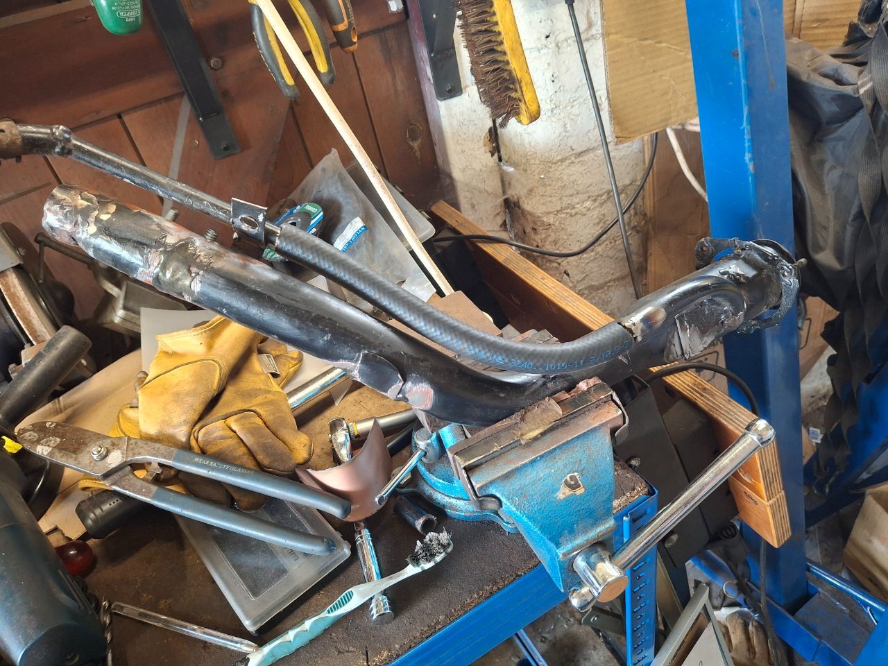

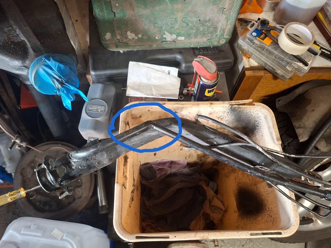

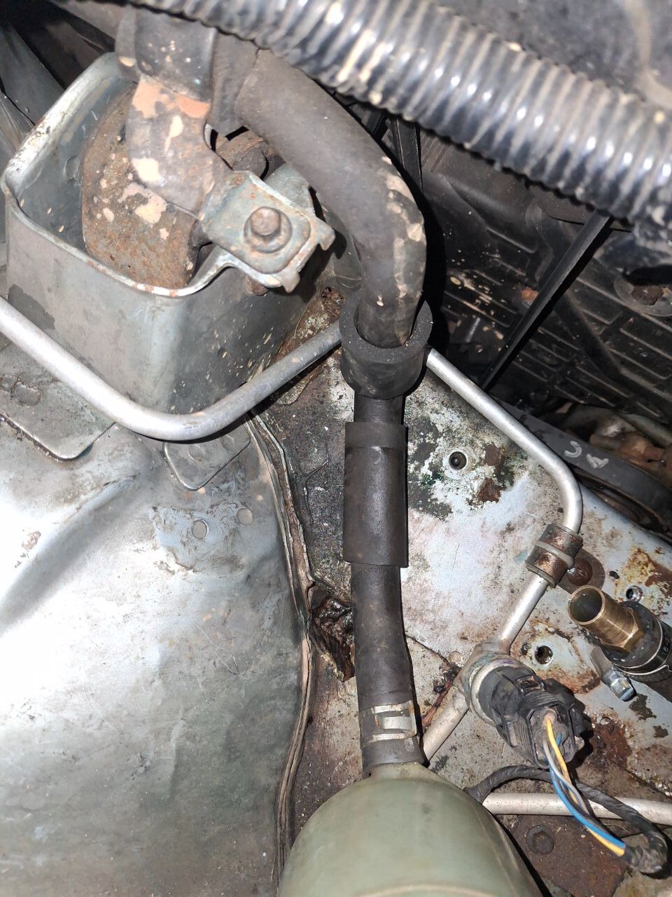

I have been getting very bored of filling the Rover from fuel cans, so I decided that maybe I could modify the current fuel filler to make it work properly.
My suspicion is a breather issue, I think my fabrication may have been a bit clumsy causing restrictions. So I have pulled it off the car and have made a change....
That right angle bend seems like an obvious issue...
So I chopped it out and replaced it with a bit of bendy rubber...
Just ignore the mystery toothbrush, that is for smoothing my eye brows....
Since then, I have cleaned and painted it and re sealed any welding pin holes with chemical metal.
I just need to put it back on the car and test it......

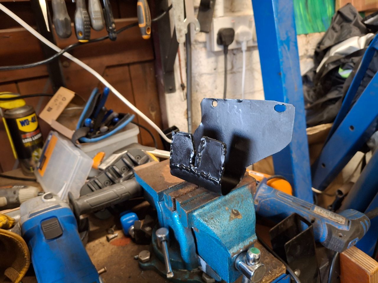

This has progressed some what, I offered it back up to the car and realised that when you attach the main hose to the filler neck the  positioning flattens out what should be a curve in the hose. This may also be a filling issue so I  decided to get radical.
Not the happiest shape...
Its flatter than it looks in the picture..
I chopped the end of the filler off, splayed out the remaining end and the played around with re positioning the end so the hose would curve properly.
Once I was happy with the position I tacked and tested the fitment.
Yes it looks horrible!
Then welded up the re positioned end.....
I then smothered it in chemical metal to fill the pin holes and re fitted it to the car.

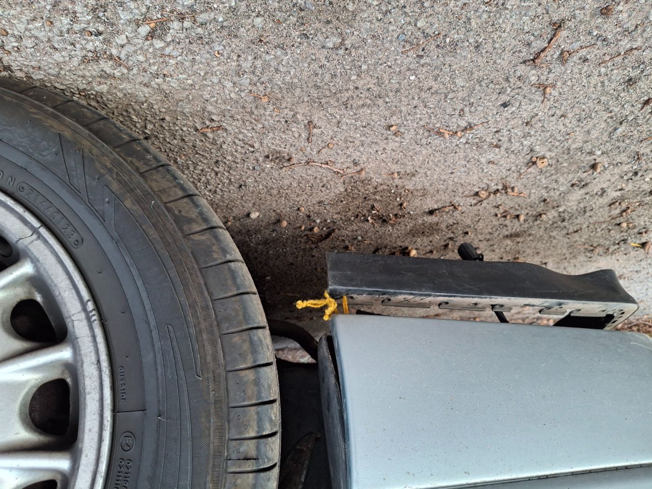

It wasn't all good, because I forgot the Rover sits pretty low compared to my normal dailys I managed to knock the front splitter/spoiler thing off on a divet in the parking area.  I had also forgotten my cable ties but thankfully Mrs MDH had some yarn on her (actual hand spun, that she had spun by err you know hand) and rescued the situation with some cunning knots......
Yep she cheated by turning the car upside down...
looking a bit deeper it appears that this part has seen some action and this was possibly the final straw, so I shall have to either remove it or try and repair and secure it better than it had been done previously.
