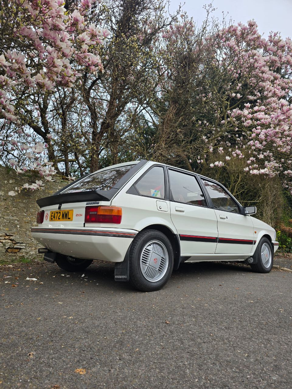

Nu_Mrs Grogee and I went out for a bimble around the lanes, lots of villages looking pretty with blossom out.
New tailgate latch held firm so I'm calling that a win.

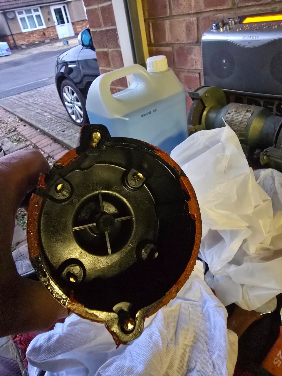

Decided to splash out £20 or so on a new distributor cap and leads. I'm sure they're Chinese shite but that's all I can get these days.
The cap I took off was (I'm fairly sure) "Lucas" ie no-name zombie brand wank. Mind you it was probably three years ago I changed it, maybe that's how long they generally last?
Anyway the centre electrode that rubs on the rotor arm has left the chat, which would explain the misfiring and kangarooing I'd been experiencing during warm up.

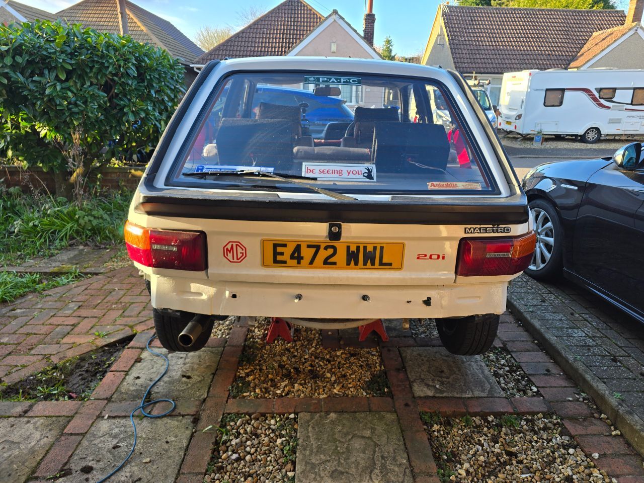

Did a bit of Forth Bridge style rust proofing this morning. I'd spotted signs of crustiness coming through on the bottom of the sills so I wanted to give it a seeing to.
Also, I had treated myself to a litre of Aquasteel, as recommended by @sierraman.
Gave it a good wipe with alcohol before splashing some onto the bottom of the sills. I even took the rear wheel arch spats off to check behind them for any grot, luckily all clear.
Nice to see my fixing strategy for the spats is holding up - thread inserts in the sills, with small holes in the wheel arches and stainless fixings all round. Seems to be holding up well.
