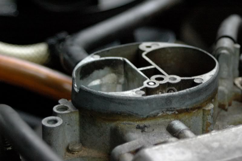

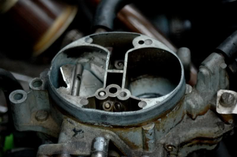

I think we may have discovered why the 305 is running like a load of crap.
In this shot you can clearly see a massive chunk missing out of the throttle butterfly and carburettor body. And it appears to have been dropped and then stuffed unceremoniously back in the car. Can I find a Solex 32 34 Z1 anywhere? Can I bollocks.

Soz for the photo repost, but that looks like a choke flap rather than the throttle plate, and the damage looks like someone tried to screwdriver it open.... I wouldn't expect it to make much (if any) difference to the way it runs unless the engine ate the piece of choke flap and killed a valve. I suppose it could be wedged in the venturi or jamming the throttle open, so it's worth pulling the carb off for a better look.
edit - does that flap move at all? Is the car flat as a fart and tends to cut out after a short distance? It may be jammed - solex autochokes are a bit rubbish. If so, the hole is supplying all the air to your primary venturi and strangling the hell out of the engine.
SOC - forgive my utter crapness.
The flap has a screw missing which is probably in the guts of the carb. And yeah, if you can get it start it stinks of fuel, runs crap with bugger all power and then cuts out. How do you reckon the body got dented? Someone dropping it? Can I just lob some kind of disgusting Weber on instead?
The little flat bit at the front of the picture? You can bend them like that overtightening the jubilee clip!
It sounds like you have a jammed choke and and probably a worn float needle too. Look on ebay for a rebuild kit, strip it and clean it should be good as new. FWIW, you can probably just bin the choke flap entirely, or make a replacement from thin alloy sheet if you are feeling really keen (or it actually needs it...)
Don't worry if you never find the screw/bit of flap. Engine will have eaten it, and if it still goes on 4 it shat it out with no damage too.

Yeah, that's the thing. If you want to spend less (read no) money, I'd pull the remains of the choke flap off and see how it runs without it. You might escape without needing a rebuild. If it still smells fuelly and crap though, you need to change the float needle and seat (brass round thing, top right of the ebay pic).

Carb rebuilds are fiddly but perfectly doable.
Easy to get to on yours as well. I'd just whip that choke flap out and see if an engineering shop can knock up a new disc of the required size with the holes drilled in the right place..
