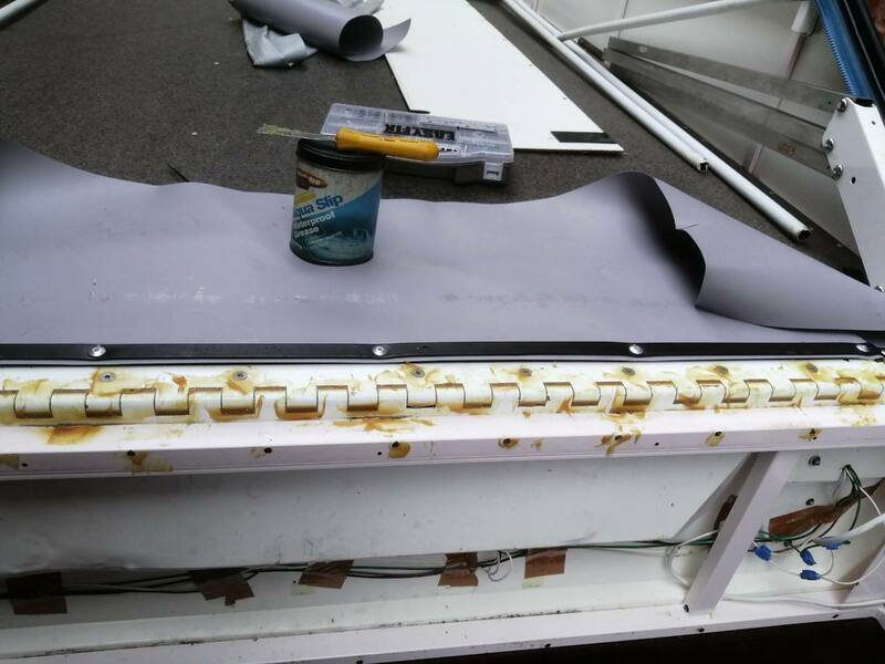

Hinge arrived this morning, which I think is pretty good, asI didn't order it till Sunday night. It's sturdier than the original, made of 3mm steel which will allow me to use countersunk screws to keep it flat. Have cut the hinge off the trailer body, leaving the flat part, as it's thin metal and the new hinge can sit on top of it. Painted the exposed bare metal. Next job is to drll and countersink the hinge and paint the bits that'll be hidden prior to fitting. The hinge is covered on the inside by a strip of pvc material which I shall have to cut to gain access.Canvas repair man has some I can have. Just need to make a support for the lid to rest it on while I'm working on the inside. Am going to ask a couple of questions on the Ask a shiter forum.

I think now, it's actually an Easy model, which is slightly narrower than a Sport. Got quite a lot done today.Hinge cut to length drilled and countersunk. Gave it a few coats of very expensive Rustoleum aerosol and left it to dry. I'm using 14 6mm screws and nuts on each side. Original was welded for short lengths at 7 points, so should be ok. Made up a support frame to hold the lid upright without straining the rubber seal which is the only thing joining the top and bottom. Can't believe the CLS timber is now over a fiver a length now. Used to be under 3 quid a yeat or so ago. Also picked up the pvc material from the canvas repair people. Got everything lined up ready for drilling and screwing together,hopefully tomorrow. There'll still be a lot of pop riveting to do putting everything back together and the plastic rear panel needs a lot of repairing, but if I can get the hinge done, I'll be well pleased. IMG_20211119_105819.thumb.jpg.4dbd23a31f454804df238dce14c780f6.jpgIMG_20211119_155856.thumb.jpg.aae680f7e9648cce26d2882521a526df.jpg

Got quite a bit done yesterday. Hinge fitted, support frame I made was a godsend. Enabled me to work single handed without the risk of the lid falling on my head. Wasn't sure how to fix hinge to the lid. Drilled right though the box section and used a screw and nut initially, but not really satisfactory as rear needed to be flush to allow refitting of closing panel. Oldest son turned up and suggested using rivnuts. He just happened to have a family sized pack of them, and the gun plus a step drill to open the holes out.Used his screws as well. Job was soon done. Have partially fixed hinge to the flange on the trailer body with screws and nuts, to make sure it opens and closes properly. Will finish job of with correct length screws and locking nuts. They'll do fine as there's plenty of clearance and they're hidden from view. Just need to get some rivets then to refit all the trims and panels. Seem to be expensive and come in large quantities. There's a shop in Leicester called All Screwed Up that sells such things in small quantities, but it's the other side of town and isn't open a lot. The rack on top was removed to make repairs easier. The hinge blocks were riveted and I drilled the out on one side. Decided to refit with screws so it can be easily removed if need be. Made a steel plate and drilled and tapped it for the screws to go in to.
Got the hinge finished off last night. Fixed it to the body with stainless screws and nyloc nuts. Had to cut the bed baseboard back about 10mm,to allow the new hinge to sit on top of the remains of the old one which went under the board slightly. The new hinge is 3mm steel against the 1.5mm of the original. So far, the repair has cost  about 80 quid, not including the rivet gun and the wood for the support frame I've made. I ended up buying a big assortment box of flange rivets from Screwfix, though. Another project that's gone over budget. I suppose, though, the Combi camp and the Renault 25, which I've gone about as far as I can with, now, stand usIMG_20211122_202637.thumb.jpg.c87fa71996bc5a7c59a1984ec6440190.jpg in at about 1500 pounds. Mrs. Doblo, who is quite looking forward to trying it out, pointed out that an elderly VW camper would cost vastly more.

Well, got the hinge repair finished off today. Another cold miserable day, but not a lot to do, so went for it between watching wifes band play and a carvery meal in a local eatery. Greased the hinge up and fitted the pvc cover strip with the plastic strips rivetted down. Lazy tong rivet gun makes light work of big pop rivets. Refitted closing panel with new trim fasteners, checked for correct opening and closing, retested lighting and job jobbed. Just got to refit repaired canvas which is stored in the Renault boot and put the mattress back in, which is in the summerhouse out of harms way. Next job is to empty the front removable storage box. All sorts of bits and pieces left by last owner. Box is plastic and fine, but rivetted to a metal frame which is very rusty and needs either cleaning up and repainting, or re making. IMG_20211205_135737.thumb.jpg.bac93a41d6f2d6c33bb49a3a3449beaa.jpgIMG_20211205_152139.thumb.jpg.0eb13b8da15ae807a0a5710366d27efa.jpgIMG_20211205_152139.thumb.jpg.0eb13b8da15ae807a0a5710366d27efa.jpgI oIMG_20211205_155107.thumb.jpg.d988e980180282c5aa1807b1602aee44.jpg

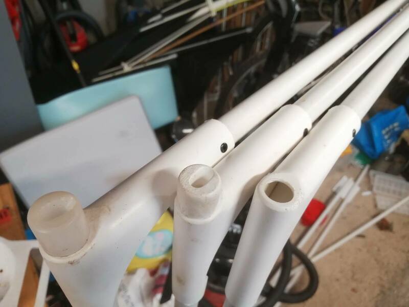

Did a bit of engineering. The frame for the canvas is in three  pieces. Each has a plastic corner bracket with a plastic bush that the hooked end of the awning poles locate in. Two of these were missing, leaving big holes. A  quick search of the Internet came up with nothing, so ordered a bit of white nylon and made a couple on my lathe and milling machine. Quite pleased with the results.I suppose a 3d printer would make light work of the job, but I haven't got one. IMG_20211219_132803.thumb.jpg.79bee559340f6f93662959afa5f8b68e.jpgIMG_20211219_132838.thumb.jpg.4ffe4a7ed98166c5120dd0732269895b.jpgIMG_20211219_133550.thumb.jpg.48a5c8fcc2d267dcc3fa046ee458dd62.jpgIMG_20211219_132434.thumb.jpg.9e1f6c23673ec55f3e79a9c6584fccc8.jpg

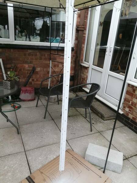

Well, got the canvas that I had repaired last year, back on. What a struggle to get both the zips lined up at the same time. Really, I've gone about as far as I can with it. Plan to take it over to my cousins place where he has a biggish lawn and I can put the awning up to check it. Mrs Doblo is looking forward to trying it out, I'm not so sure, and think I'm happier in the caravan. Just thinking, this would be a lovely thing for a Field of Dreamser. Or even two FoDers who get on well!
Photo shows the repaired canvasIMG_20220227_122330.thumb.jpg.1ddf9bbf772f7bbd6be0abf2ce43482c.jpg
