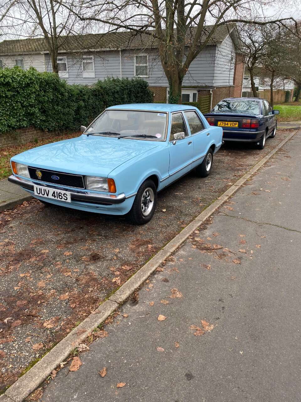

Wibble Posted December 4, 2024 Author Posted December 4, 2024 It’s not often they’re out together and still looks ok from a distance. IronStar, Dyslexic Viking, danthecapriman and 18 others 20 1
