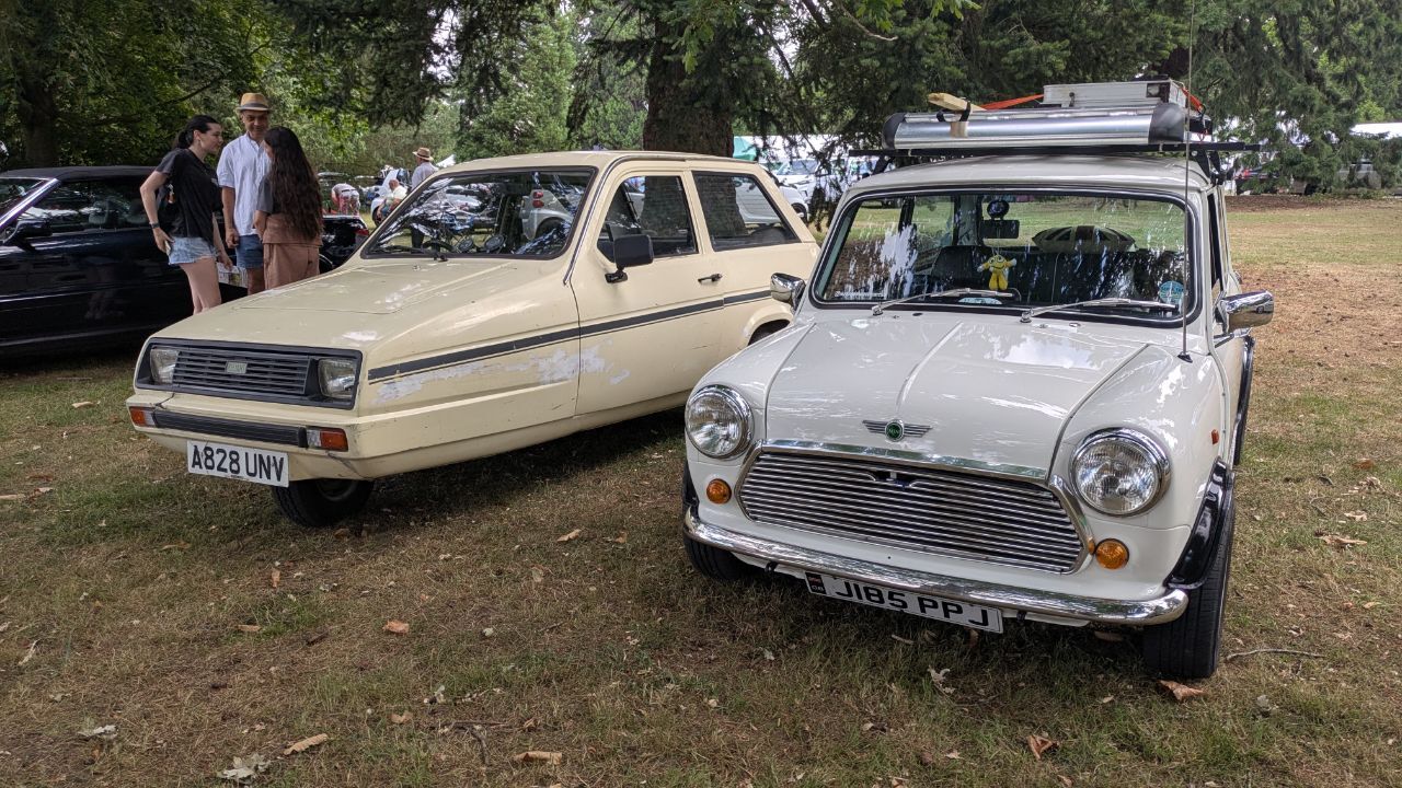

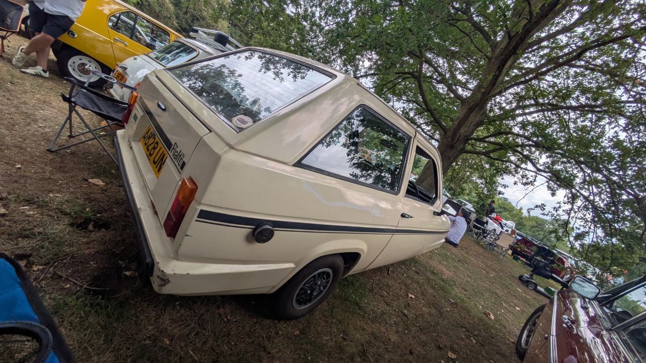

First proper outing for the Reliant with it's new* engine today. I went to Kimbolton Fayre which a fairly local car show to me. Usually about 1,000 cars.
I went to the effort of giving it a wash and a wet vac to the interior. It smells so much better
Then drove the 30 mins or so to be on a stand with a club I help run.

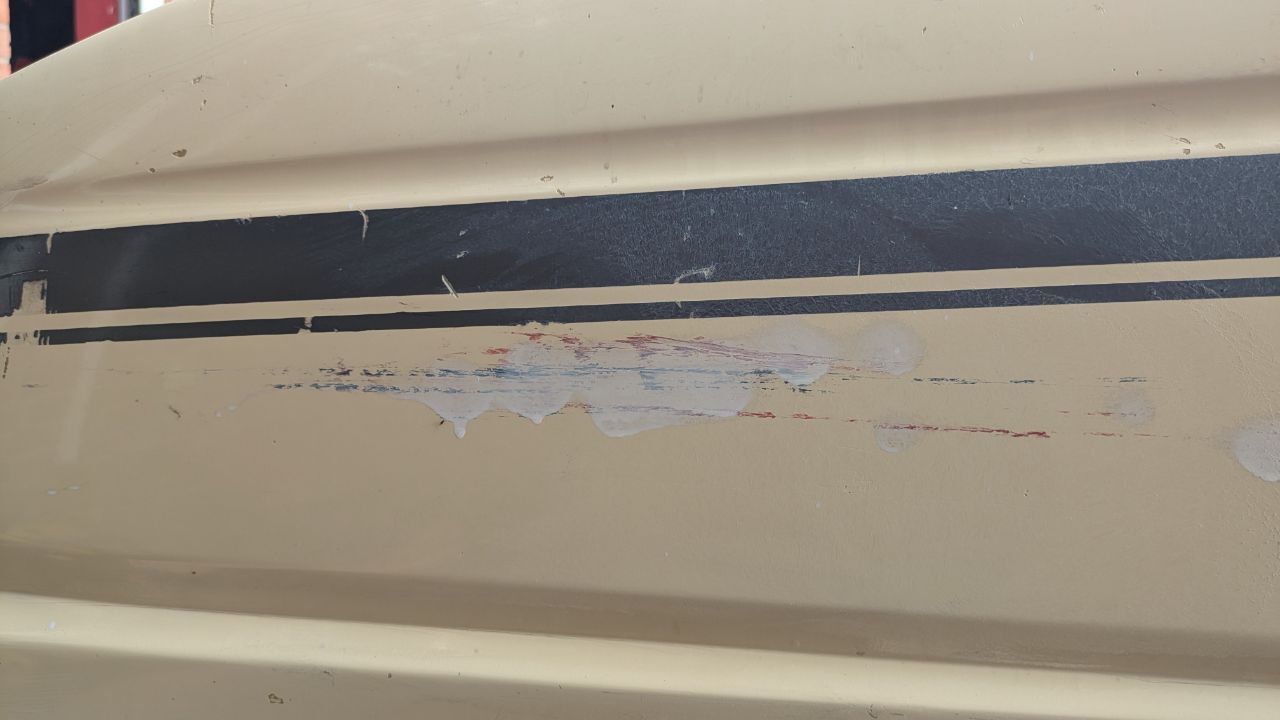

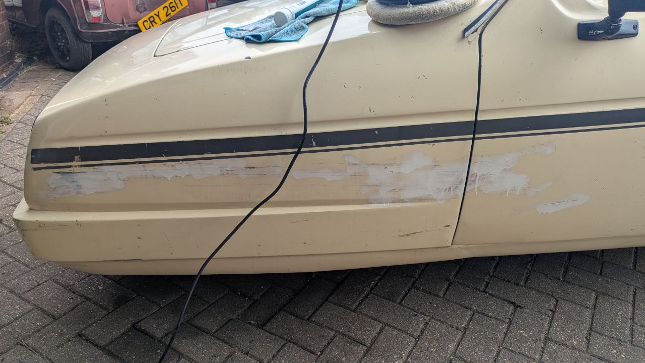

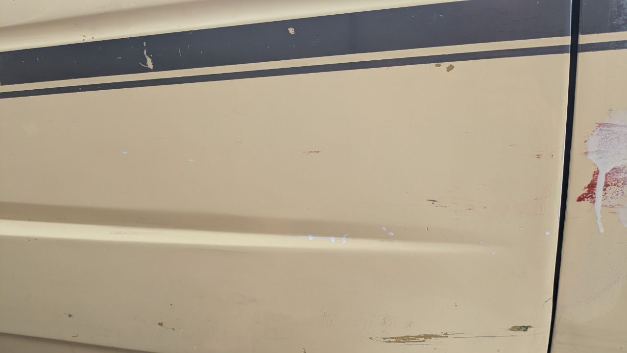

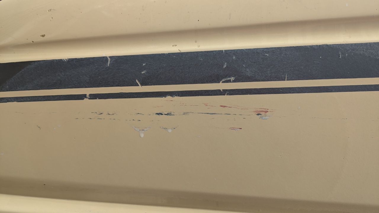

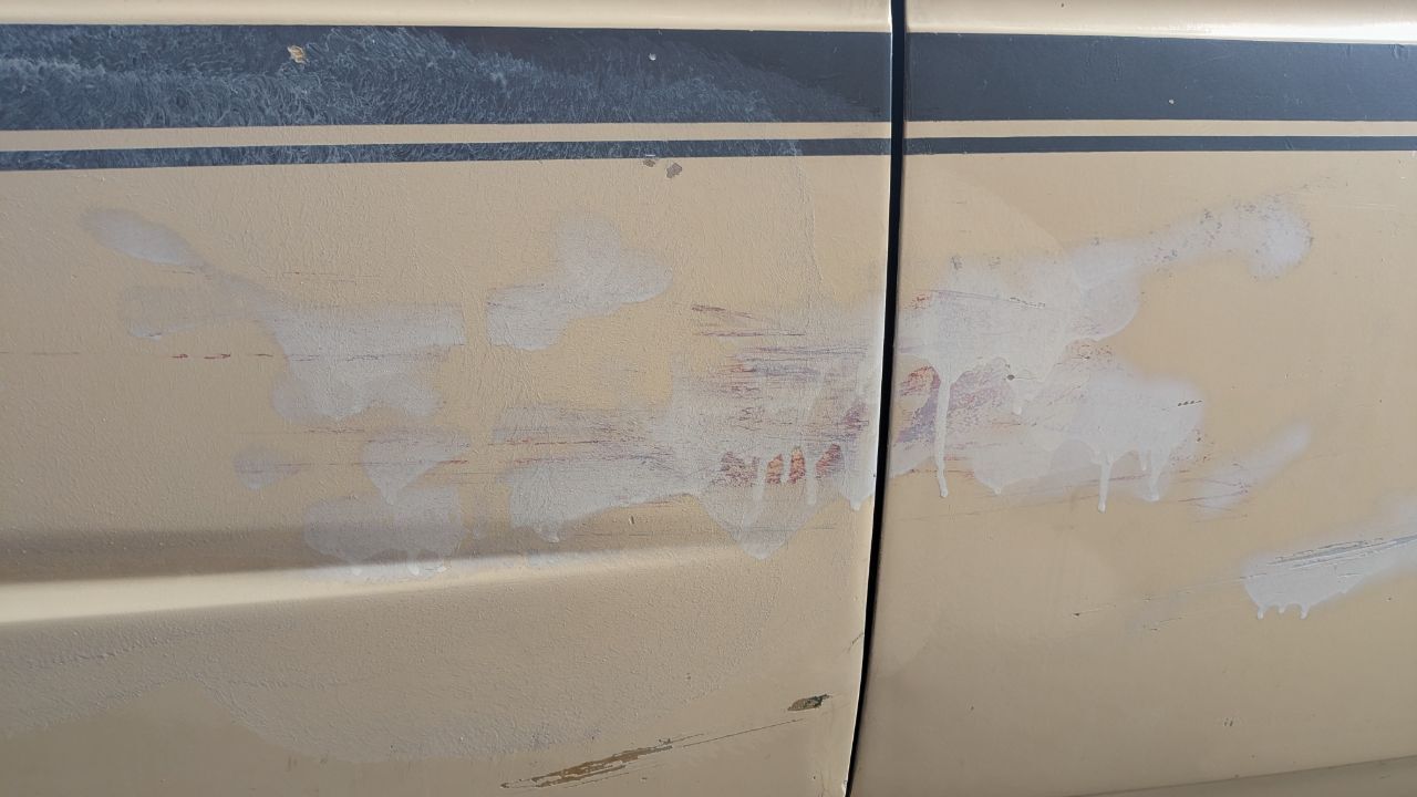

I am getting down to the nitty gritty now. I'm thinking about dealing with the white paint that's been used in various places and machine polishing it off.
I'm calling the Reliant done!
The paint is actually shiny underneath!
Turns out the scratch underneath was just paint transfer so whoever painted it was being super lazy
Worst of the spray off
White paint off
Paint gone
Definitely done enough now. I need to move onto other things

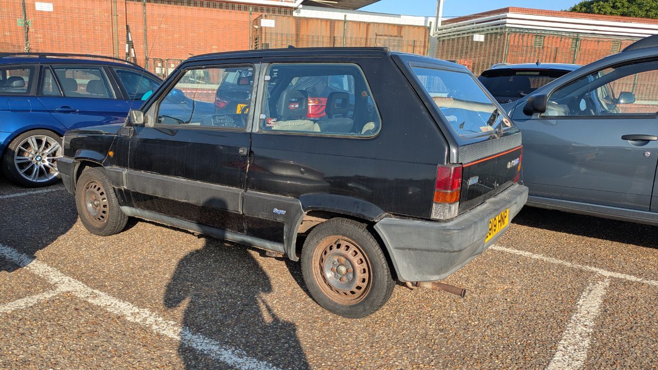

Did some tinkering on the Panda tonight. I fixed the heater fan first. That was a simple case of a new fuse and the fan sprung into life.

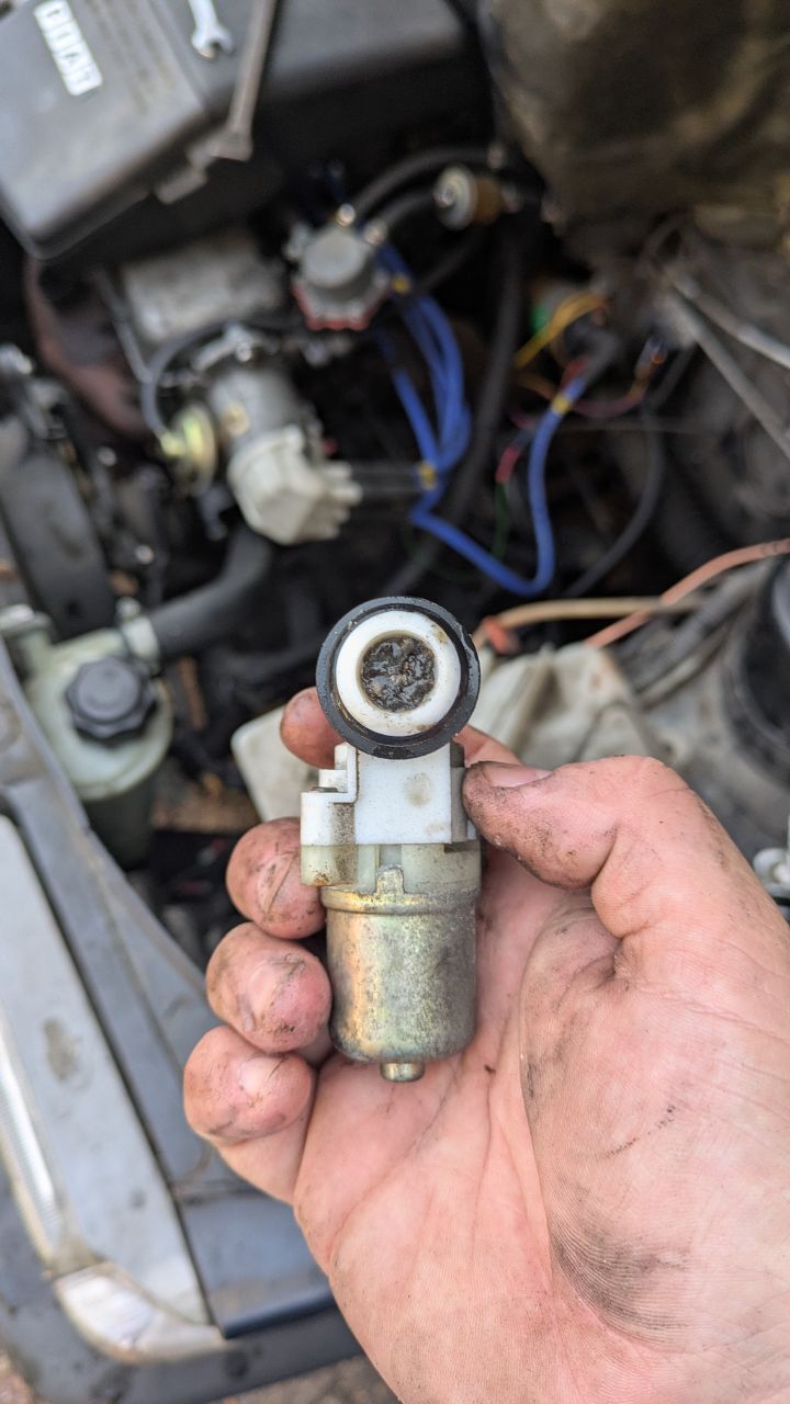

Then I set about the washer pump. Rear worked but the front didn't. After some testing I found that the front pump was dead. They're both the same pump and were both clogged up which will not have helped. So I took them apart and cleaned them and swapped them round. A front pump is far more useful and I now have a working pump.
Front pump
Rear pump
Also scored my first blood injury on the Panda so it's officially been christened
I also took my Reliant to work today and parked in definitely a parking space*. That got a slight tweak tonight too. It needed a new temperature sender which I fitted this evening too. I now am only missing a fuel gauge. Which I probably won't fix as a sender is very expensive and virtually always unavailable.

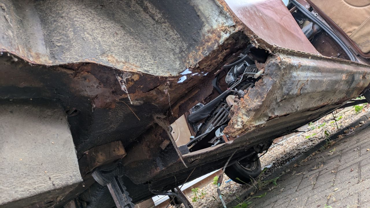

Today I did some welding.

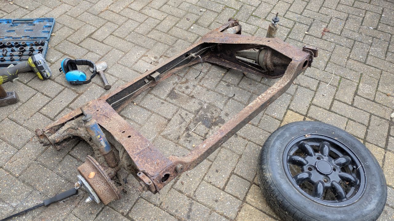

I've been putting this off for a while as it involved removing the rear subframe which will disable the car until I reattach it.
First job was removing said subframe.
This was a pig to get out. Eight bolts hold it in. 2 snapped, 3 rounded, 3 came out ok. So I had to cut three bolts but access isn't great.
The only ones that came out...

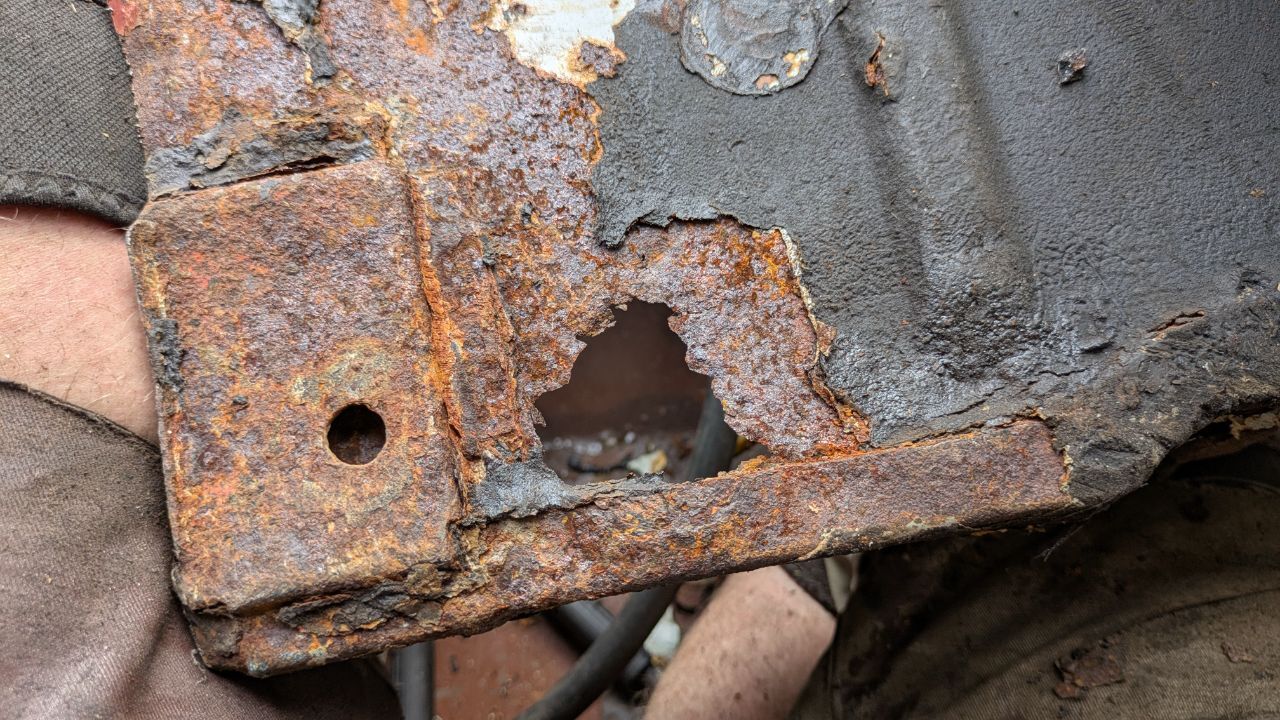

I then set about assessing the corrosion. It isn't great but I knew this. Most of the heelboard that wasn't already cut out fell out. The saving grace is the floor that rests on the subframe wasn't rotten and neither was the frame.
Time to get cracking! First up I had to cut out more of the seat base and closing panels. This exposed a big glob of silicone and bog in the quarter panel. So no I need to repair that too now.
Then time to start glueing it back together. I'm not sure if I mentioned this before but I procured an offcut from another car including the rear of the floor, heelboard and seat base. So I will be using sections of that for a lot of these repairs.
The panels alone would have been about £500 for these repairs. The off cut cost me £50.
