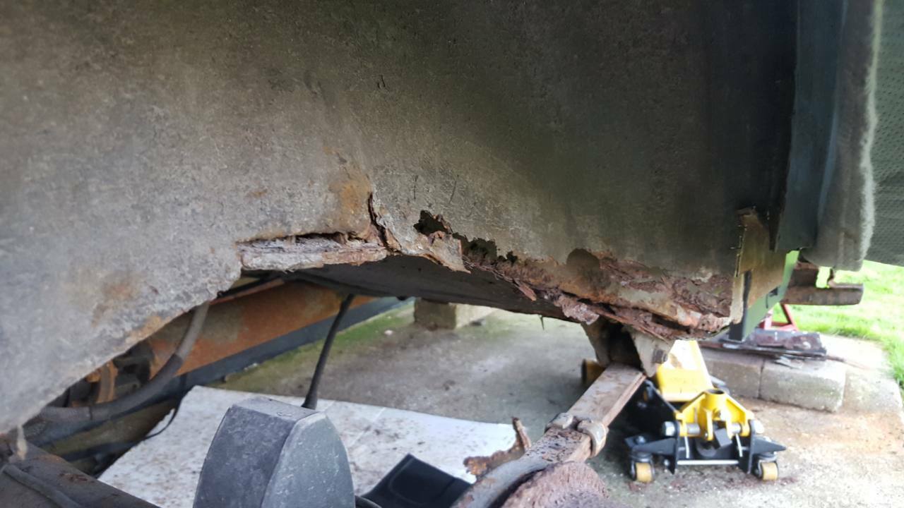

Protected the car as best as possible
Cleaned up more underseal to see what I'm dealing with
Got chopping
Flattened all my batteries, so come in for food.
Chop the lot out and replace it or it's just asking for trouble further down the road.
Replacing the whole thing will be stronger than replacing part of it but either would be strong enough.

I would prefer to do that but I'm determined to do this quickly. You've seen how slow I am normally 🤣
Replacing the whole inner panel will need a lot of fettling and tweaking to get fit. The arch label already is taking a fair bit of time to get even roughly the right place. 😕
You'd get more money when you came to sell it if you cut those patches out and did it right.
You can still do it quickly and fit the whole thing 😂
Seeing your pics is bringing back nightmares of the boundless welding I did to my old one, and why I grew to hate the thing so much  😂
That area is tricky as you need to make sure that lip for the arch is aligned properly or they’ll be gaps to the body.  If I did it again - shinker/stretcher 😉
I’d replace the whole inner arch since you have the panel already and the existing tin work surrounding it is a patchwork quilt.

Is that patchwork effect a series of plates over existing metal or cut out and replacement?
Haha, I knew it would make the pro fabricators on this forum teeth itch. Part of the reason I put my reasoning above about welding a new panel on the remaining good metal of the old. Especially as that would be my usual modus operandi. If my MO was to slap patches on or even filler then it'd be  It doesn't help that I detail everything I do, so my choices end up on the internet for all to see. I can see why many don't detail their progress until done.
However I'm trying to be pragmatic on this as I possibly can. I really don't want this to end up being a weldathon like the Dolomite. Not least that this isn't a rare (literally tens of thousands of Moggies left), special (loads of 2dr saloons) or even the best base to start from for such things (previously repaired). Like many Moggies and similar porridge British classics of this age, it's already had similar repairs elsewhere on its shell. They're strong but they are repairs.
My main aim is if I'm doing a repair, the end result will be both better than when I started and safe. I.e. solid welded repair section is far better than the fibreglass that fell out of it!
I may still rip out those other bits, I haven't got to that yet. Firstly I need to reattach the outer lip. That is a Sri Lanka panel and the accuracy isn't that great. I'm hoping that won't take all Sunday to do!
From what I can tell, I think at the bottom and along the chassis leg it's cut out with this new piece on. Then further up welded over the top of the existing inner arch that had been cleaned up. i.e. rusty stuff cut off the inner and then welded along with a bit of overlap.

I'm no pro fabricator and you never made my teeth itch.
I said either would be fine but if you like cutting corners for the sake of an extra day's work then go ahead, I just think it's a waste of time patching patches when you have a complete panel.
The welding on the patches looks decent, but I'm guessing it's several year's worth of repairs - Otherwise surely you'd just weld in one long strip?
I'd just lop it all out, the amount of welding isn't going to be massively higher and it saves the time of trimming patches etc when you can just throw a full panel at the problem, mangle it to shape with a bit of hammer/vice grip action and have a better looking repair as a finished result. You've already spent the money after all.
I hear and get what you guys are saying but my resistance to cutting all that out is several things.
Firstly, at the moment I have some nice thick steel to weld to. Whatever those patches are welded onto may be thin now and I'll just blow holes in when trying weld.
Secondly, I don't know how good the panel fit is just yet. Looks ok but don't know until I've got more cut out to get it into position.
Thirdly, if I start chopping off more and find stuff, I'll end up wanting to fix it. Thus spiraling to be a big project.
Fourthly, to fit the hole panel I need to drop the axle for the bottom left side. But I might do like 3/4 of the panel and leave that side as it seems quite strong over there anyway.
Finally, I don't know if I should be providing support if I cut any more out. At the moment the hole hasn't been enlarged as only rusty bits that weren't attach have been removed and it hasn't dropped. So I know there is still enough to make it strong enough to not.
I haven't made my decision yet so I've stopped cutting more off. Once I do, I'll be boxed into that decision.

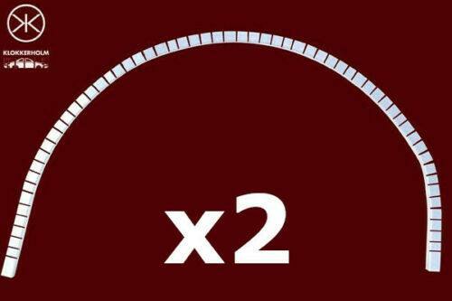

Throw something like this at it, (you could make something similar with the grinder in 10 mins) for that leading edge section and save yourself the hassle of trying to weld to pockmarked bullshit that will start bubbling back through in 6 months. Even if it's not neat a bit of filler will smarten it up, and you'd need to fill over the pitting anyway.
If there is one thing I've learnt from welding shit cars it's that it's 110% easier to do more welding to decent metal than trying to splice in smaller sections to pitted shit.

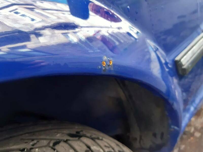

There is also the fact that pitted shit is rusty and rust doesn't die, it always comes back. This (shagged out, and realistically needing replaced) wing on the Acclaim was ground back, welded up, rust converted, pylon primered, filled and painted and has still re-blistered after a year of exposure to the UK's marvellous damp weather.

Good idea captain. Keep meaning to get some of those arch repair strips. Not cheap though. Had some left over roughly right angle steel left over

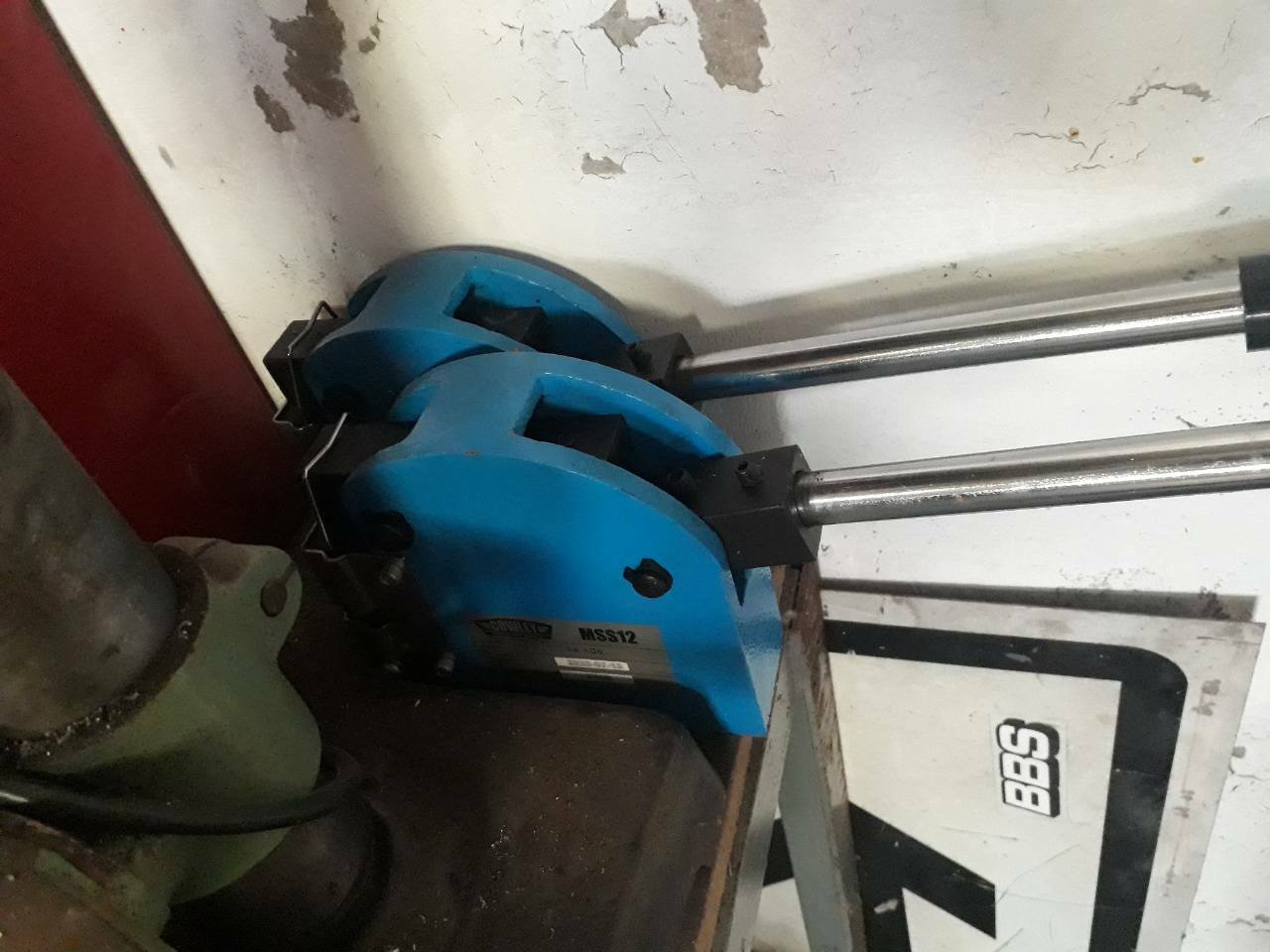

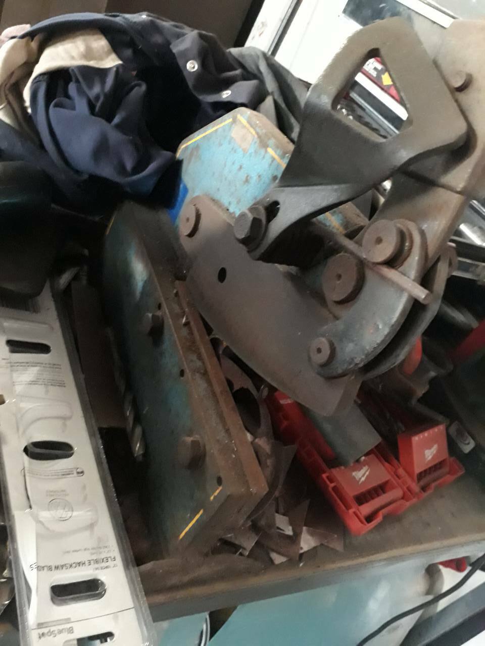

Put the money towards one of these instead,  a shrinker stretcher tool.   A man of your talent will never regret it.
And a used hand shear, best 32 quid i ever spent, angle grinder is hardly used now.
