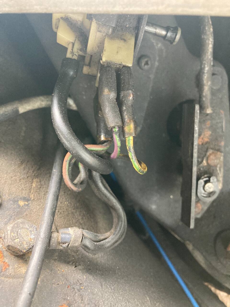

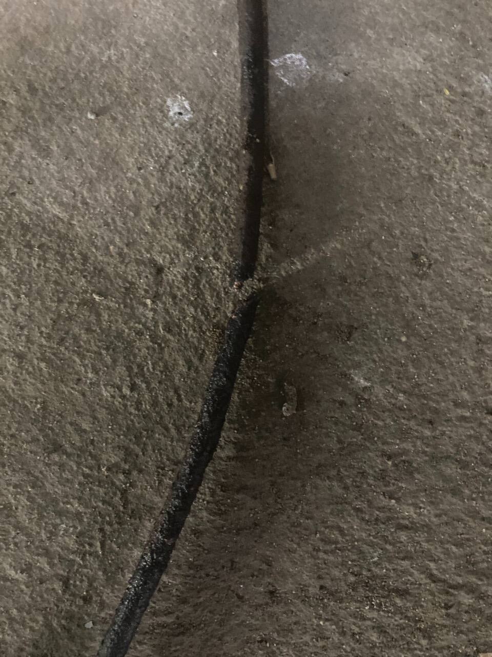

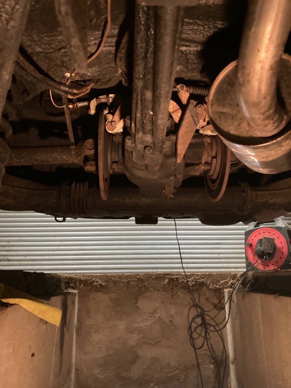

After getting the car back up and running after it’s winter hibernation I enjoyed a brown trouser moment when my braking disappeared whilst simultaneously having a front brake start binding. After limping the car back home I found the culprit:D9A40432-E441-4AFF-88E9-3265BB6889AC.thumb.jpeg.2241edc50ecc1f4defe805430655098f.jpeg
I made some new brake lines and refurbished the front callipers which returned the stopping power to its former glory.784401AC-CCAB-4315-8CA5-6D13C69CBFA5.thumb.jpeg.ff78e55e74e1541c40df49ea645ed21e.jpeg5F9BF163-676D-4758-9728-C43A26C7D4C7.thumb.jpeg.4fced11f70b5b48cb503ab8c6ce4b28b.jpeg88A710FB-316B-44FA-9839-AABEF7F64291.thumb.jpeg.5b5b92f152cee14fded506f2ca1aff28.jpeg

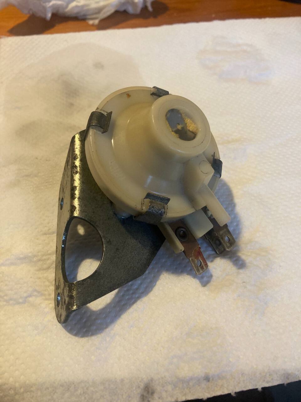

More recently I had a minor win in fixing the bizarre vacuum operated wiper delay unit on the car. There was a small piece of sponge which was meant to push on a bit of rubber and act like a valve. The sponge had just dropped to bits and therefore part of a washing up sponge had to be sacrificed for the greater good.CCA3A447-F184-4664-8D86-104272024F87.thumb.jpeg.6e833bcac5a1b870ce0ed75159693a4e.jpeg

In regards to the wiper delay system I think you can diagnose if the problem is with the delay unit or a split vacuum hose by removing the vacuum hose from the delay unit and putting your finger over the hole. 8ADAD408-1237-4557-8C9D-70FF8A2F2279.thumb.jpeg.298f999123f1070495799350be8541c7.jpegIf you press in the little plunger thing and it springs back straight away then the sponge in the top of the unit has probably disintegrated. If it returns very slowly then the vacuum hose is probably split somewhere. Hope this helps!
