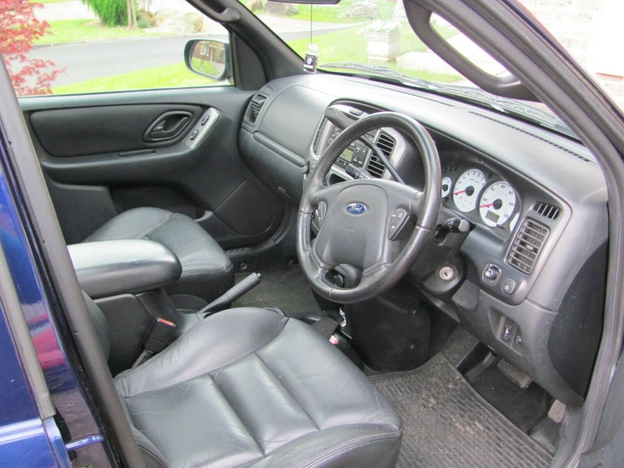

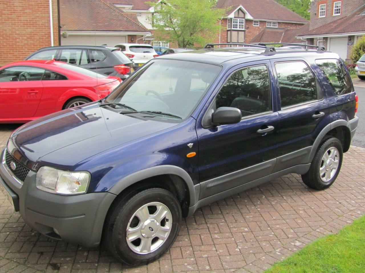

Tom C Posted June 16, 2021 Posted June 16, 2021 Evening all My new daily steed comes in the form of this rather curious looking piece of American shite. 3.0 V6, very comfortable seats, hilariously flimsy plastics, acres of space, key from a 1986 Ford Fiesta........it is all there. Resources regarding the Maverick are very limited and there appears to be no owners group in the UK. Apparently, they sold eleventy million in the US as the Ford Escape so at least we got the good name over here. The car has 106k on the clock, 6 months MOT, quite a lot of recent bills and is in nice condition. I am sure the fuel bills might cause the odd raised pulse but that smooth American engine with those smooth American seats are winning the keepability stakes. Does anyone have any experience with these curiously likeable cars? Parts supply seem a little scary for a kick off. dome, The Moog, Asimo and 7 others 10
