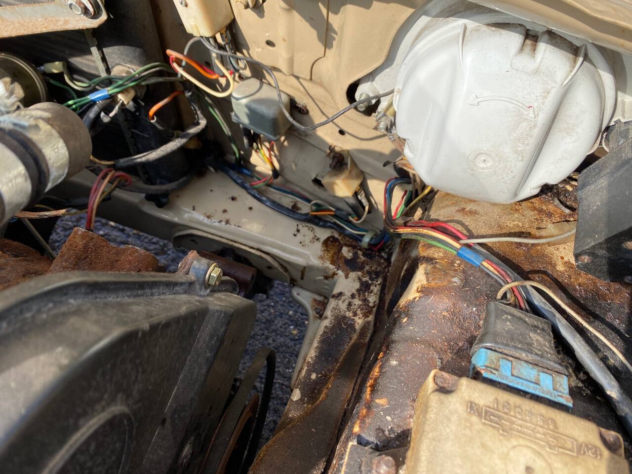

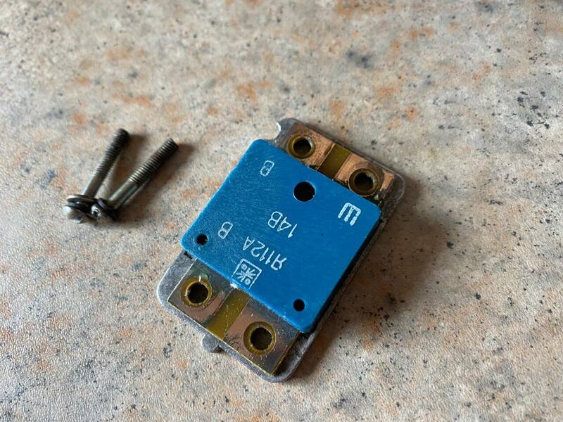

Alternator oot:
Unlike Warren G, I think this may not regulate. Or have anything to regulate judging  by the corroded terminal.
So I need this:
But at least I got to clean this ready to waxoil it.

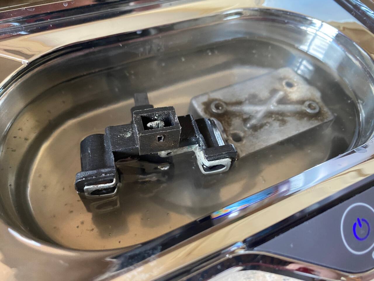

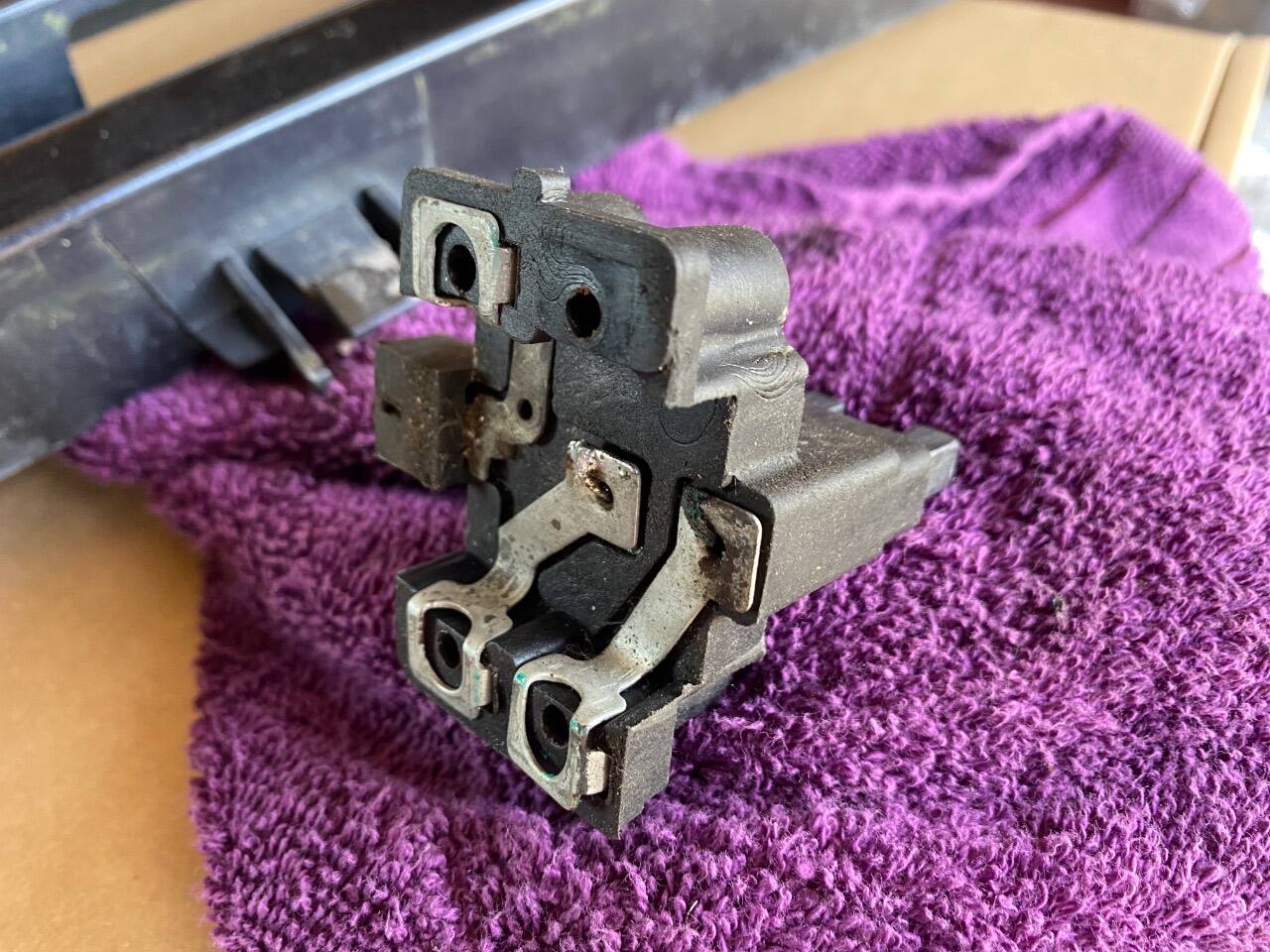

Brushes have continuity to the contacts, contacts were green. Ultrasonic clean brushes, clean contacts on regulator pack, cross fingers. Tried improving solder on manky brush but it's so contaminated it was a wasted effort I suspect. However, I can measure the brush dimensions and get new ones if needed.
Nice thing is now I've seen the alternator body off the car it's clean inside and bearings are good, and the regulator pack can be removed with the alternator in situ so if I put it back together and test and it doesn't work I'll just resume the search for new regulator (found one in Poland but they won't ship to pariah island).
12.4V from the +ve, decreasing under load. I /think/ the regulator is the issue - and the part is shared with Lada, albeit in a different configuration.
The good news, plenty for sale online. $4ish.
The bad news.... guess where they are. No, not Ukraine (LadaPower is still trading apparently but there are bigger things they need to worry about surely), but Russia, where I am sure the people selling are fine and probably normal Russians not supportive of asshat Putin, but can't pay for the bits!
So the same part seems to be shared with all manner of things in the eastern bloc/balkans, but finding one actually for sale and shippable is hilarious.
Latest attempt: MTZ tractor spares supplier in Hungary (damn, wrong revision. Needs to be a 112A as the 112B has different internal wiring for diodes so won't work).

Aha! There's the whole brush pack!
https://www.detava.lt/produktas/krovimo-rele-su-sepeteliais-m4123701500-m4123702000/
