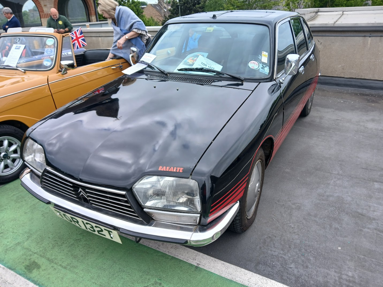

First show since the refit, a local one.
There were a few other AS-worthy displays
