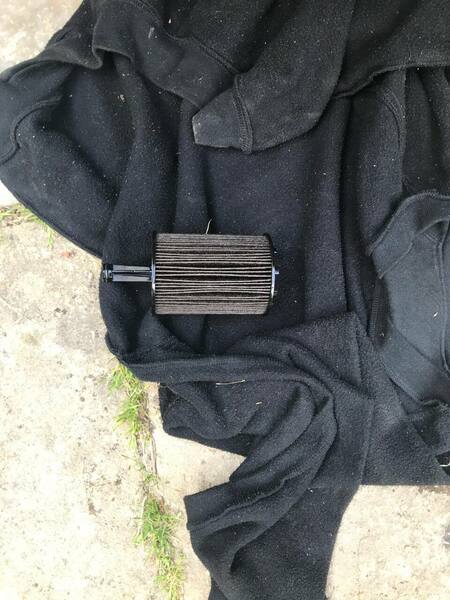

I started the car up for the first time since bringing it back from its MOT last week and even after just one oil change things are improving.
The engine sounds fantastic and although the oil is dirty it’s isn’t that horrific so come April I will use it for a month and try and get 500 miles in and drop the oil and filter again
The journey down to East Kent and back  alone should put close on a couple of hundred miles on the old girl.
That doesn't look too bad. Hopefully a few oil changes will have it nice and toffee coloured.

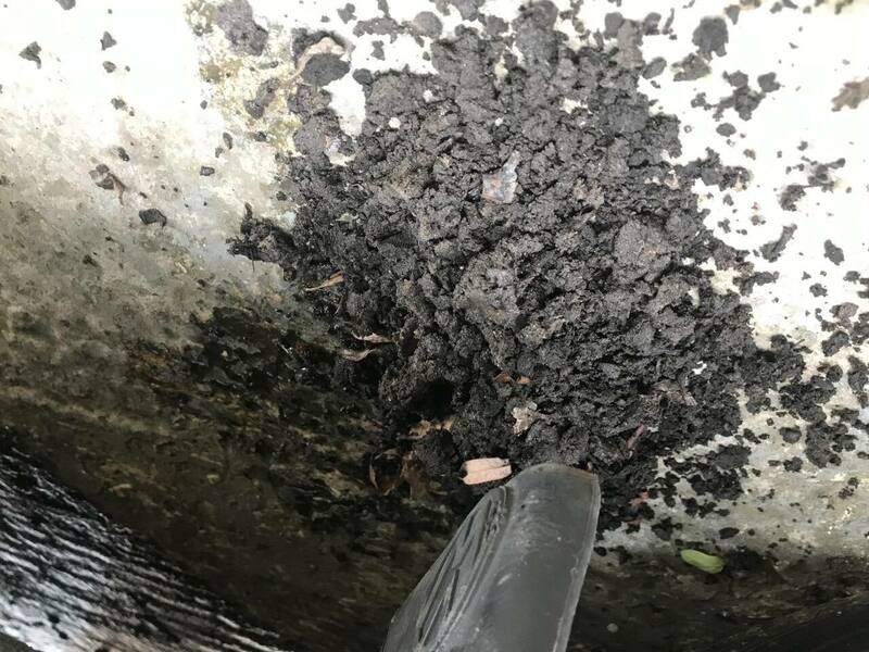

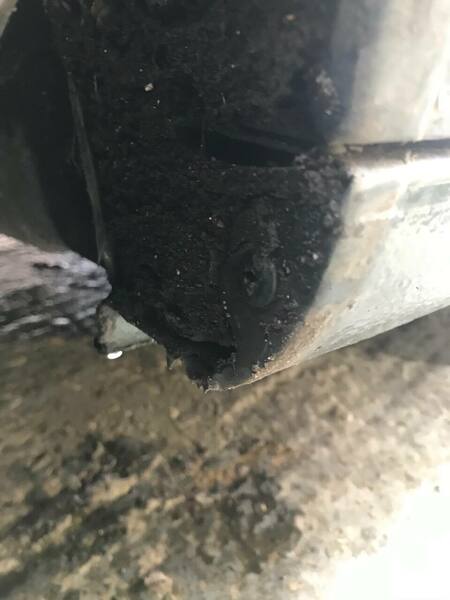

I cleaned behind the arch liners yesterday and although it was full completely of mud I couldn’t find any rot which surprised me so while it was apart I gave it a coat of waxoyl.

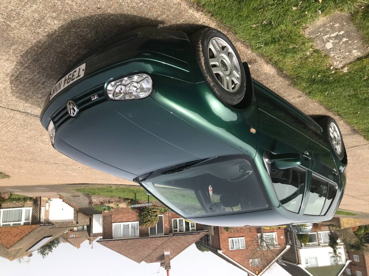

2 minutes ago, Asimo said:

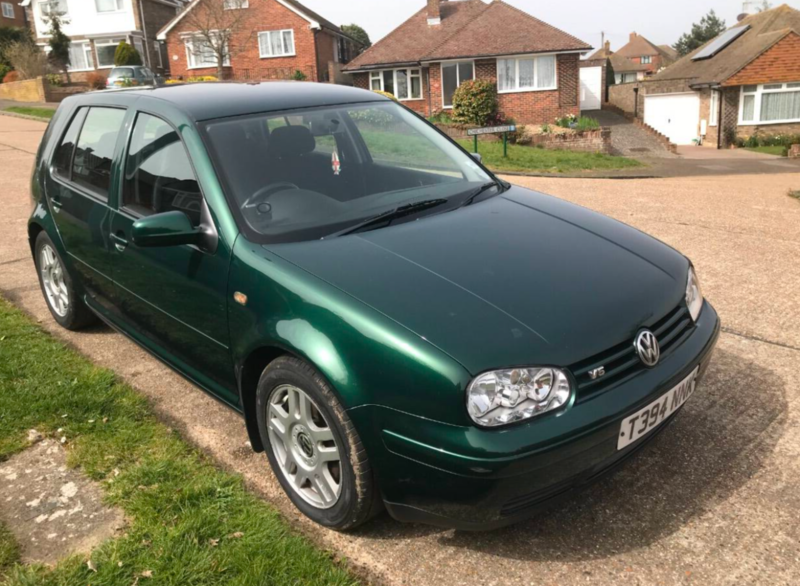

Is that colour "Dragon Green"?
1331063894_Screenshot2021-04-01at18_41_27.thumb.png.165a2e8fe1eec9704f23ef6f1ee7207a.png
I think it is Dragon Green thanks for putting the car up the right way

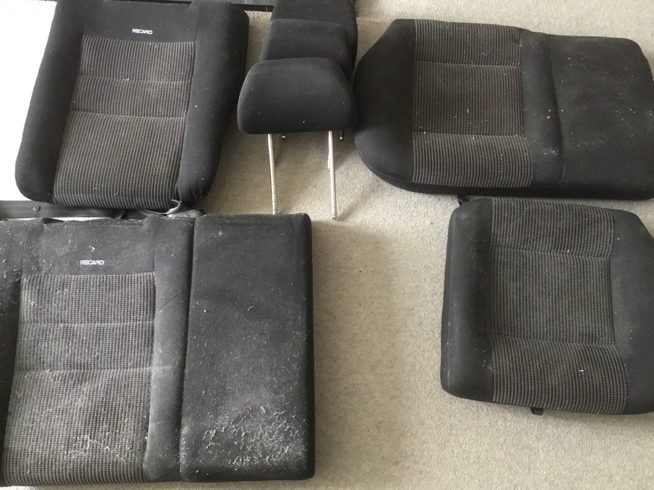

But I had a result the other day as I was on Facebook marketplace and a spare set of rear recaros in mint condition came up for free to collector as they’ve been sitting in the guys loft for years so went and picked those up yesterday so if I ever get a rip in one of my front seats or damage the rears I now won’t have a problem sourcing the material or I can just replace the rears.

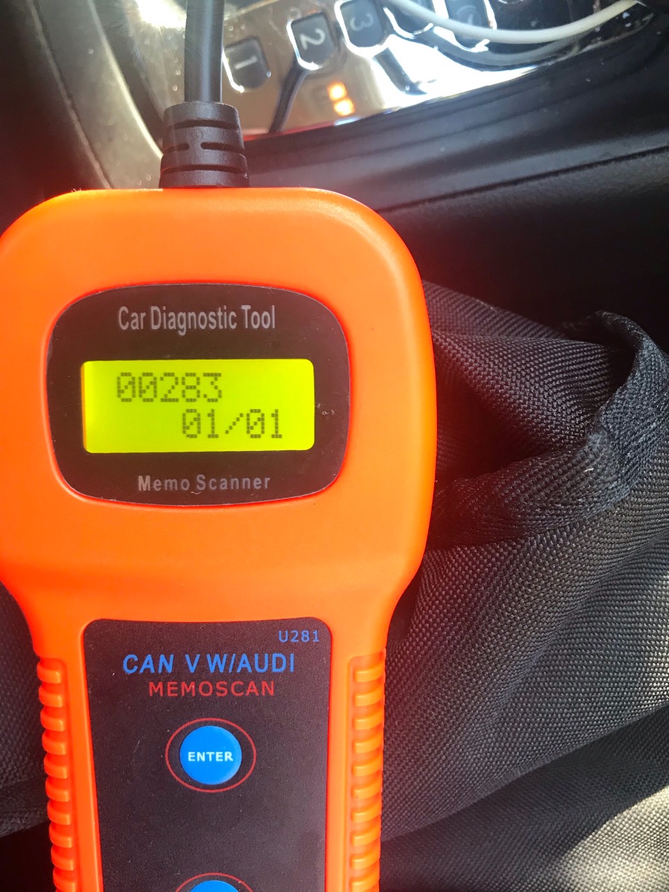

At the moment though it’s at the garage as I’ve started getting a knock when hitting potholes from the front suspension and the ABS light has now decided to come on permanently and my cheap code reader says it’s a near side front sensor and I’m hoping the knock is just drop links and roll bar bushes.

I went and picked the Golf up from the garage as it had a wiring problem with the ABS and it also needed a sensor plus the front suspension was clonking badly so the bushes need refreshing.

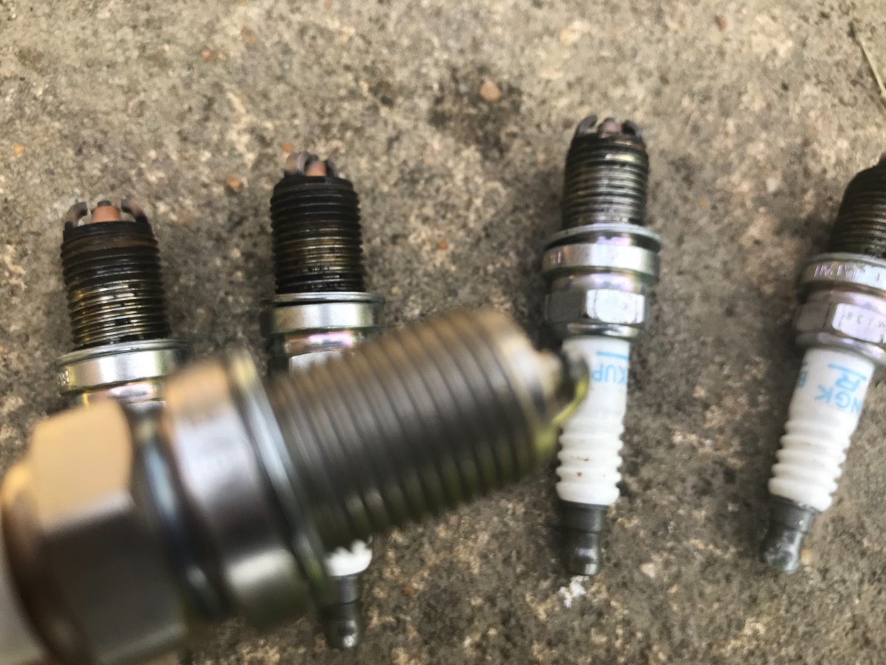

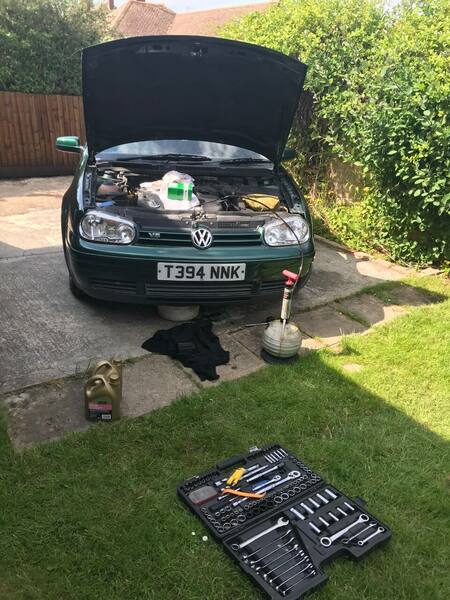

Yesterday while the weather was nice I decided to give the car another oil and filter change to clean the last of the sludge out and all went well but while I was at it I thought it was best to give the car a set of new plugs.

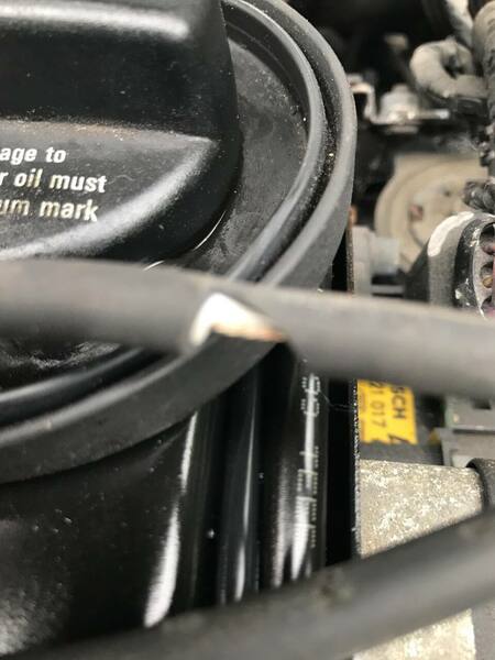

I went to take the engine cover off and found that someone had been there before and the cover was broken with only one loose bolt holding it on so I’ve got to find some bolts for that and when I took the leads off I found one was worn through to the core and the leads on these are not cheap.

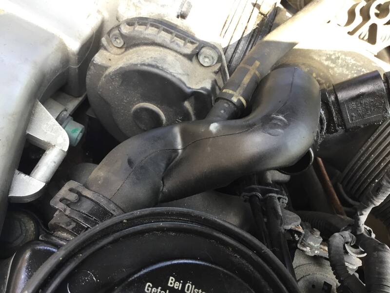

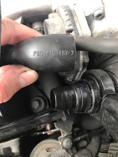

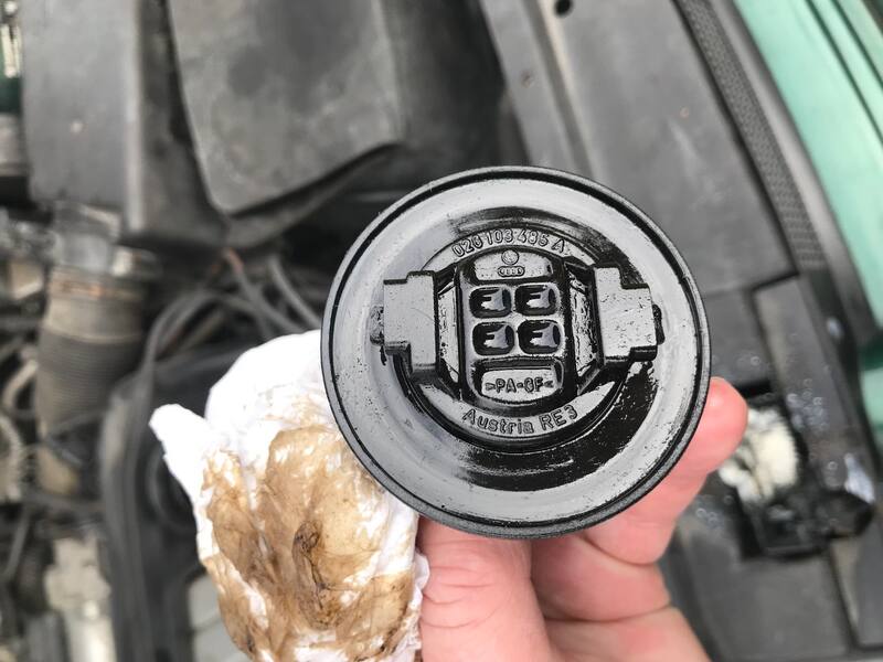

Also one of the breather hoses has collapsed plus it  had a hole in it but when I type the part number PX0 416 487 I can’t find anything online.

That's an odd part number. I would expect something like 1J0 for a MK4 Golf, leaving the (-2) bit off gets some hits. Usually there's a letter at the end to denote which revision of the part it is, I would expect that -2 is version two
Is there a chance someone's been in there before and put something on that shouldn't have been there?
I've found the VW part number for it but can't find a supplier in the UK. Pelican parts in the USA have it but it's $100 minus all the cost of getting it over here.
071 103 474 is the part. Is it bodgeable with a off the shelf T piece?

Today I managed to repair the engine cover with a bit of two pack adhesive  as someone had by the looks of things broke it previously and lost most of the bolts in the process and  I also put in a new set of plugs but was presently surprised that the old ones came out okay and didn’t look that bad.
One of the leads looked in a bad way and had a cut right through to the core so I taped it up for now till my next payday as it’s £56 for a set of leads for this old girl.
I phoned up my local VW main dealership who were really helpful and are part of the same group as my old BMW and I can get spares relatively cheaply through them for the BM but the dealership couldn’t help when it came to the V5 but gave me the proper part number which was nice of them and gave me a phone number to try as VW don’t keep stock in general pre 2005 these days also VW heritage couldn’t help and was told it’s hard to get early V5 bits.
At the moment I’ve put a  bit of insulation tape around the lead and the hole in the breather pipe and it’s running okay and will go with spurious’s idea and put a stent in the breather pipe.

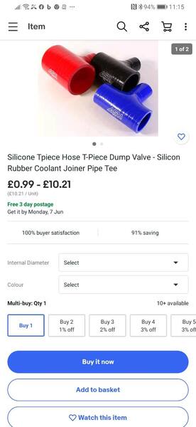

I took spurious’s good advice and went for the silicone t piece hose he put up and for some reason all of them are a tenner apart from the one I want as long as I don’t mind red as that one is 99p delivered to my doorstep so I’m deeply grateful for the link.
