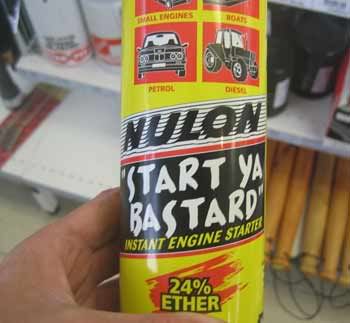

Ah yeah, 'Easi Start'.I've never used that stuff, my mate had some as I remember the 'start ya bastard' thing.

Memories are coming flooding back now. Standing in the cold trying to get a hopeless engine started without flooding the fucking thing. Thank fuck I wasn't in work this morning, I'm still trying to get it started, and have gone through two batteries. :( I had some cans of Easi-start in the cupboard - possibly a few years old. Don't think I've ever started a car with it tbh - good for checking for air leaks though. Think WD40 will clog the crappy thing up!Will need to change to a decent carb ASAP.

But is that ok if you are on a low carb diet?What starter did he recommend?
Easy start/ether is not meant to be sprayed in without cranking the engine. I saw a tard in a garage do that to a bike of mine. I shouted at him loudly. Never use ether, I think. It might possible be bearable on a diesel in an emergency, but don't if you love your car or van. My Wolseley started okay, second turn of the key, choke open a bit longer.
easi start should be used when cranking. Can cause severe knock on start up and engines do become "addicted" to it. So you may find even after a bit of use, even in summer, it may require a snort.Ford used to fit happy gas as standard to the 3.6 diesel A series because it wouldn't start and once used, that was it. The engine needed happy gas every time.
