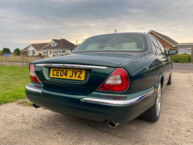

Bear Posted July 3, 2021 Author Posted July 3, 2021 Insured, taxed, going for a spin. 20 mile round trip - suspension: wafty, headlights: working but man I am spoiled by modern LED ones, heater: hot, weather: hot, brakes: not broken, steering: not too vague, not too sharp, radio: lovely, heated seats: working, gearbox: kicks down and lets the remaining ones of the 240 horses work, idling after run: no leaks, atmosphere in car: serene, conclusion: Wish I’d had the motivation to fix this sooner. Coprolalia, uk_senator, rainagain and 1 other 4

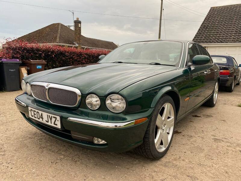

Bear Posted July 4, 2021 Author Posted July 4, 2021 Another drive though storms and sunshine. What’s that in the background? Stats: Still feels good and behaving. Suspension has some wear/wobbles but it’s doing well for the age. Six-cylinder and uk_senator 2

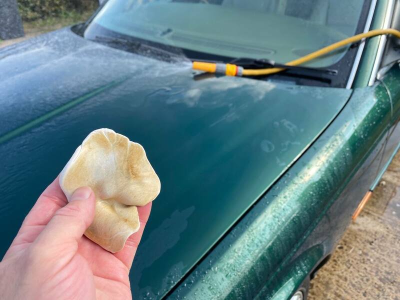

Bear Posted July 4, 2021 Author Posted July 4, 2021 Keeps raining so I can’t clay bar and polish to get the sorbet-look paint over yet. But look at the clean wheels!

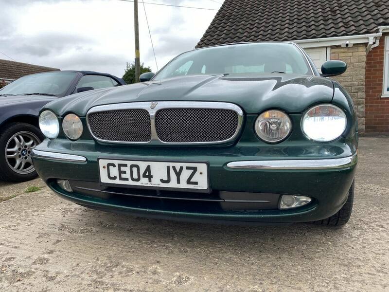

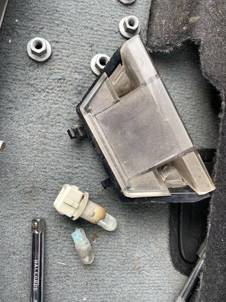

Bear Posted August 25, 2021 Author Posted August 25, 2021 THE JAGUAR IS GETTING ATTENTION! It’s been used a fair bit - put a full tank of fuel in it (super of course) and it is proving a fine, if sometimes flawed bus (headlight won’t dry out and the door locks are annoying - plus front undertray and AC woes of course). So the lack of rear numberplate light lenses/lights and the generally grotty state of them is being sorted. Two brand new assemblies from SNG and a new electronic boot lock button, then the area behind the chrome trim will be cleaned, waxed and generally tidied. I’m going to assume the scorched bulb holders are down to resistance from corroded contacts rather than lights being too hot. Look at the scratch marks from some previous muppet not looking up how the lights are fitted. Lucky they didn’t break the chrome/plastic trim off the boot! uk_senator, Coprolalia, Six-cylinder and 1 other 4

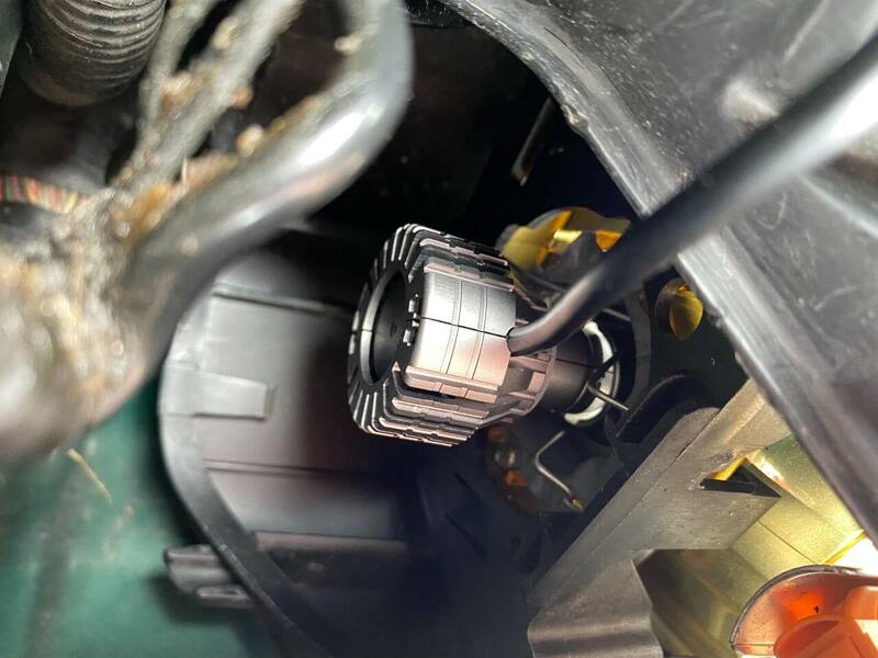

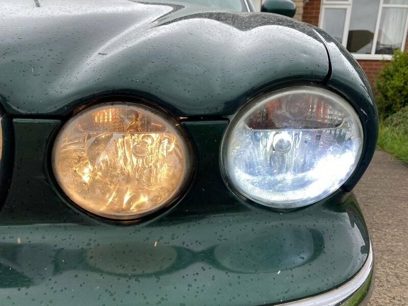

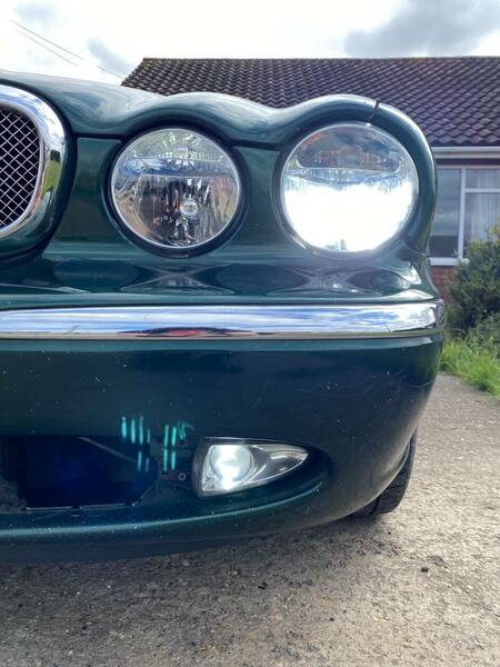

Bear Posted August 26, 2021 Author Posted August 26, 2021 I review things on Amazon and had a glut of LED lights - which appeared to be a pig to fit but actually, they’re easy because the collars detach. These lights are about £15 a pair which is less, I think, than Halfords charges for a pair of uprated halogens. So now the Jaguar is so bright I gotta wear shades… I’ve also clay barred the tail and leading edge of the boot including brushing the seam and cleaning all the edges, then polishing with three coats of Autoglym. Going to investigate ceramic coating the bootlid and chrome strip… pictures to follow when all the parts are here. Right now the dipped beams swamp the mains (cutoff is correct but the mains are just feeble) but I have another set of H7s on the way. uk_senator, Six-cylinder and Coprolalia 3

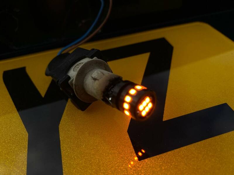

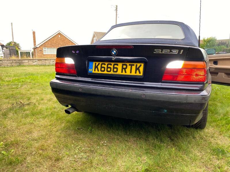

Bear Posted August 27, 2021 Author Posted August 27, 2021 More lighting. Considering using the orange ones in the number plate lights as I always find the white number plate lights a little harsh. Guess which sidelight holder is being a PITA. stripped fred 1

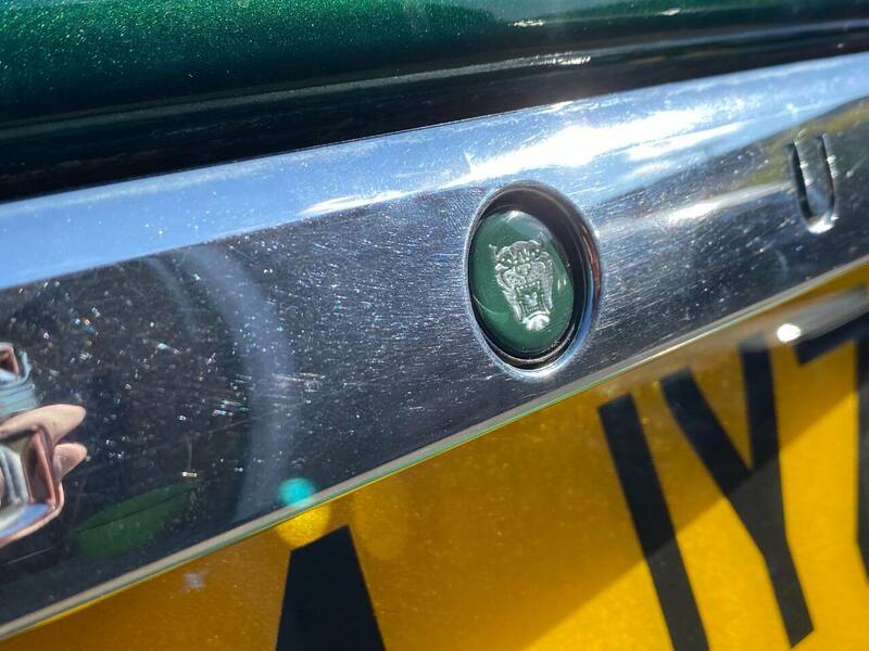

Bear Posted August 28, 2021 Author Posted August 28, 2021 Well, the lamp housings didn’t show up, but one bit done at least… Six-cylinder, LightBulbFun and rainagain 3
Bear Posted August 29, 2021 Author Posted August 29, 2021 Out and about. H3 LED bulbs are too big to reassemble the light with them fitted, but I want yellow ones anyway.
Bear Posted August 31, 2021 Author Posted August 31, 2021 Today in LED all the things… Jaguar didn’t like LED reversing lights so they went in the BMW (The BMW will also get those foglights, I’m a big fan of yellow for fog - genuinely makes it easier for me) stripped fred and Six-cylinder 2
