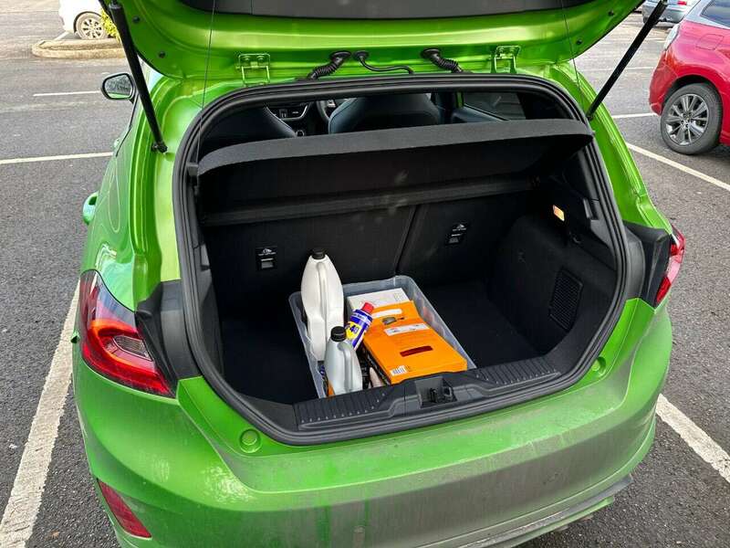

One of them is 1:1 scale - and hasn't moved for six months or so, has a flat battery, so before arranging transport I'm taking advantage of a dry, bright day to get it prepped and checked.
Load up the ST.
Vital fluids:
Upside-down vital fluids (for organic being).

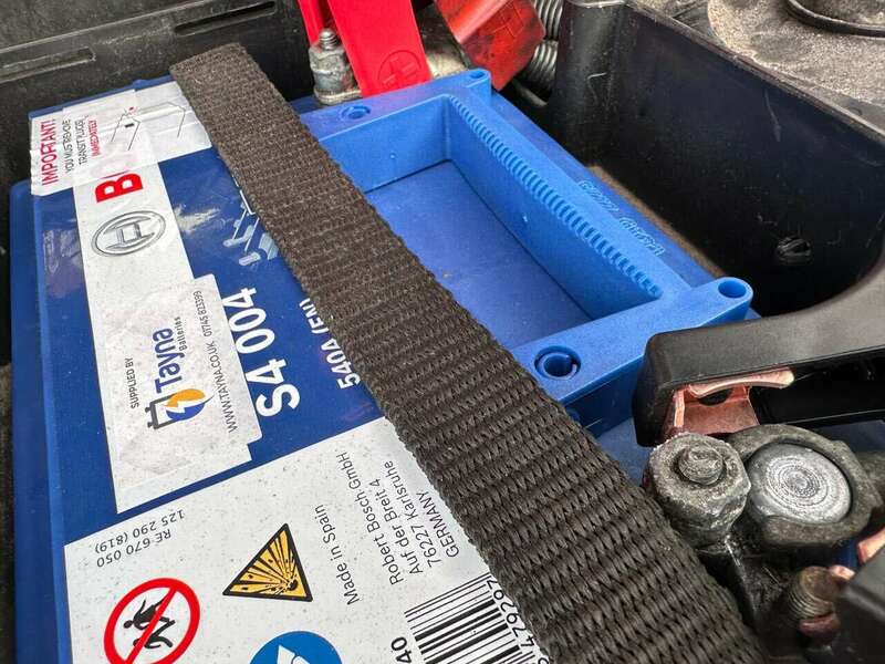

Halfords for a battery - an 063. Before you get excited that this is a clue, it's for the Spitfire "in the future" but it'll do to wake this one up...

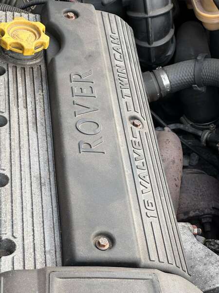

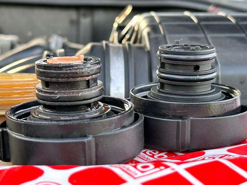

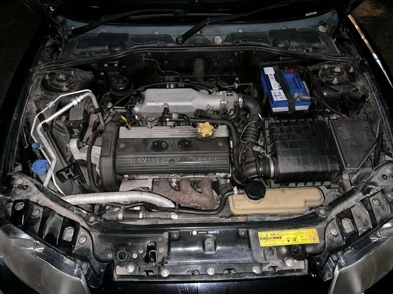

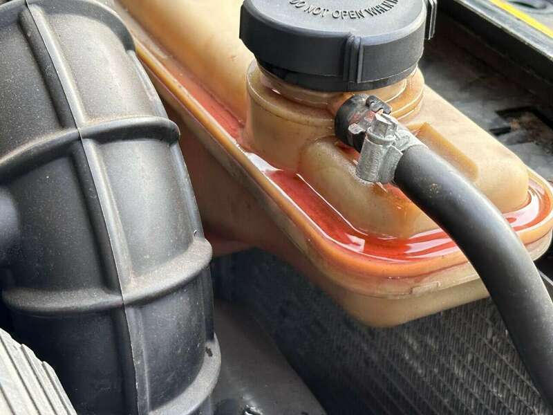

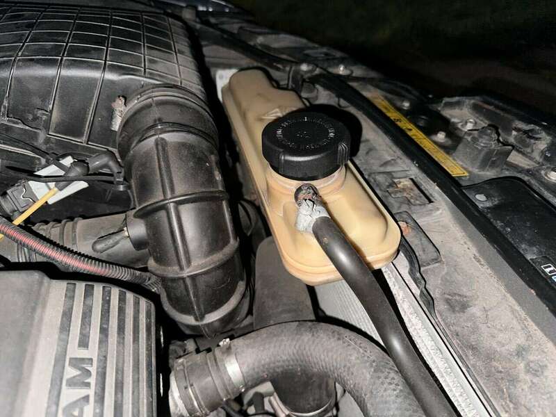

Well, it seems promising, though I can taste coolant in the air...
I think coolant pressure cap - notorious failure on these IIRC.

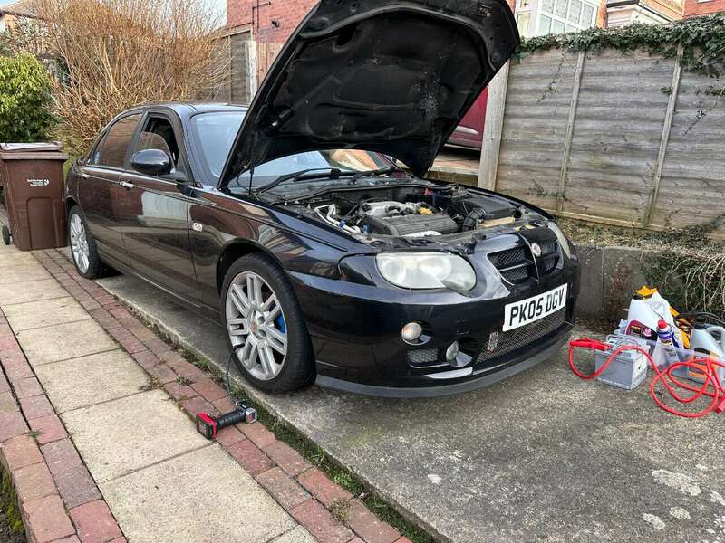

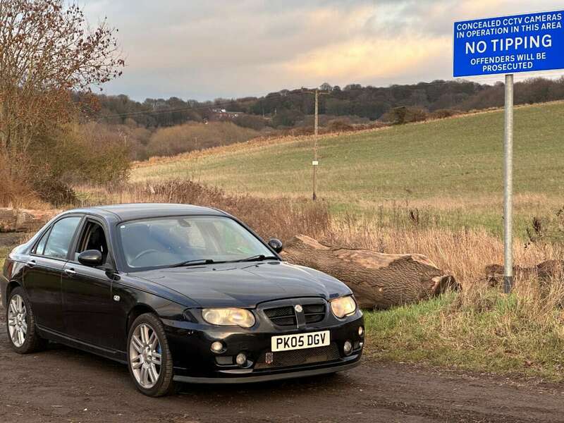

Test drive:
Pondered for a while and decided to take it home and go back for the Ford rather than driving an unknown turbocharged kettle in Monday traffic...

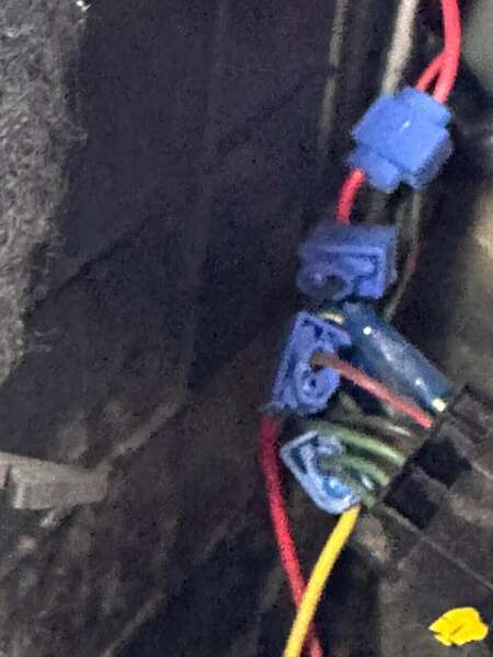

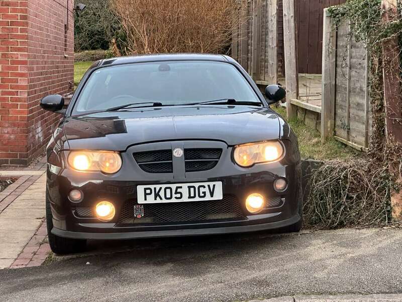

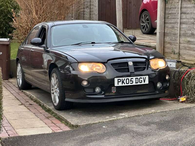

Seemed fine, glitches so far: I had a full set of headlights but OSF dipped failed. Hence the foglights. I may have a brake pad warning or brake fluid light. Mirrors wouldn't adjust but lots of poking the switch on the A1 work them up (power fold works). Drivers door needs key to unlock. Sun blind is stuck up. Hesitation/fuel starvation when foot down but it's improving, maybe a duff boost regulator or something but also it has a gold coloured electronic box cable tied to the fan, and a weird three pipe metal junction with a wire on not commected to owt - with a more production-ey version of the same in the same area.  Maybe a boost mod or something. Cupholders are shit.

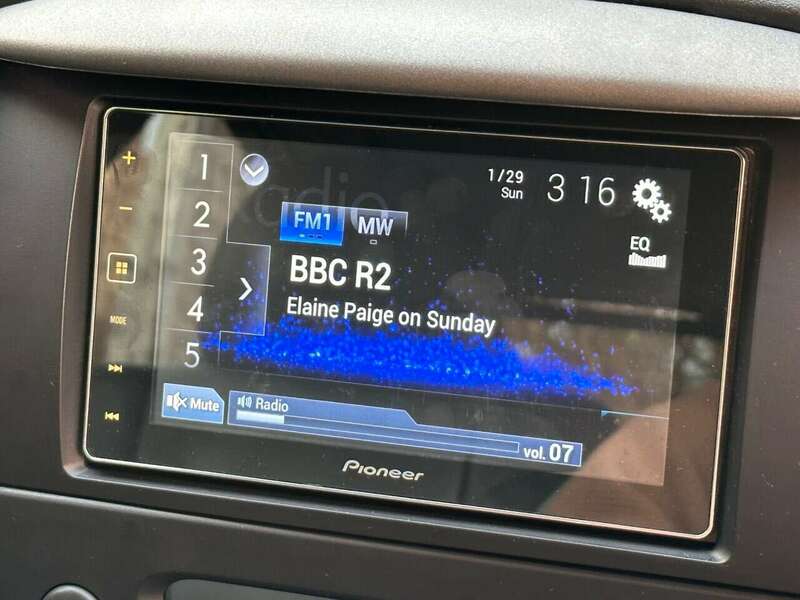

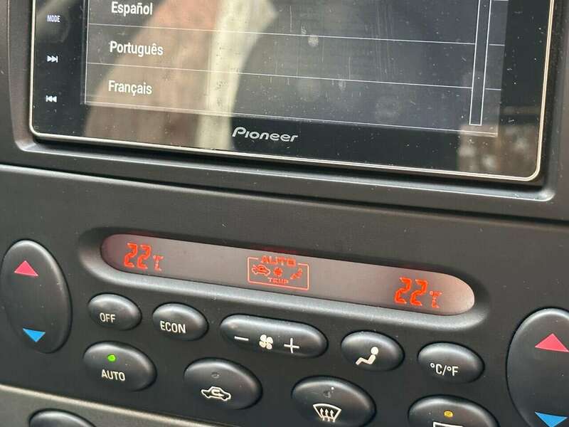

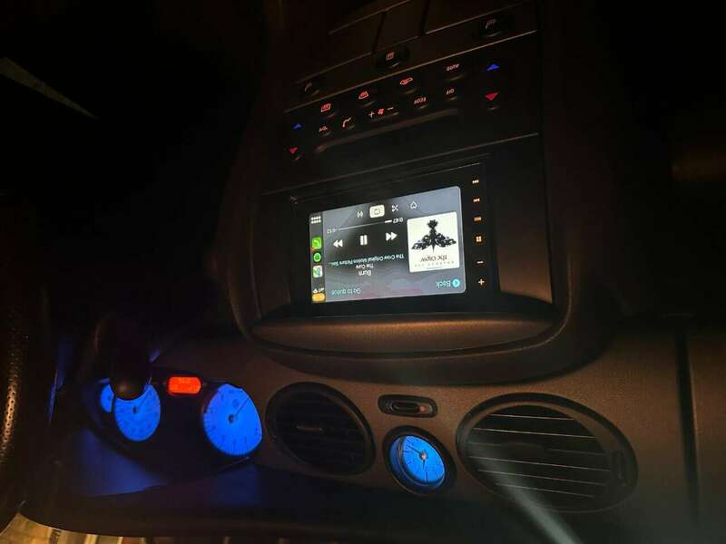

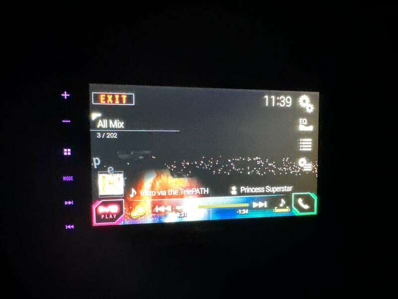

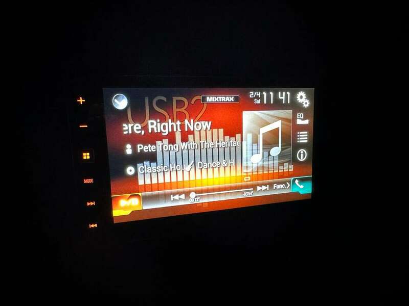

Can't set the clock because non-original radio, but the steering wheel controls work (as does the radio's CarPlay).

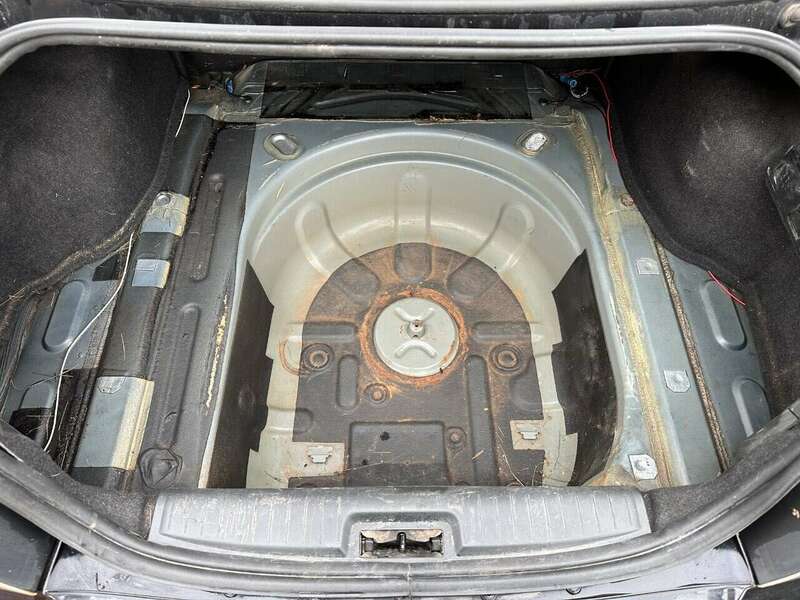

Boot full of new suspension bush and service parts (no coolant cap, boo) and also water. Soggy parts. Soggy fibreboard. Soggy boot trim. Poor car.
Sad bit. I will Kurust for now.

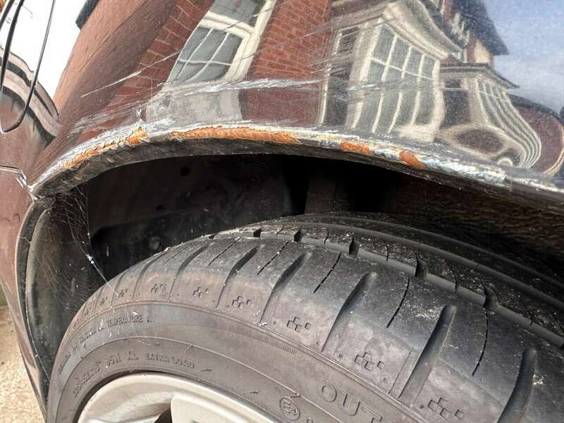

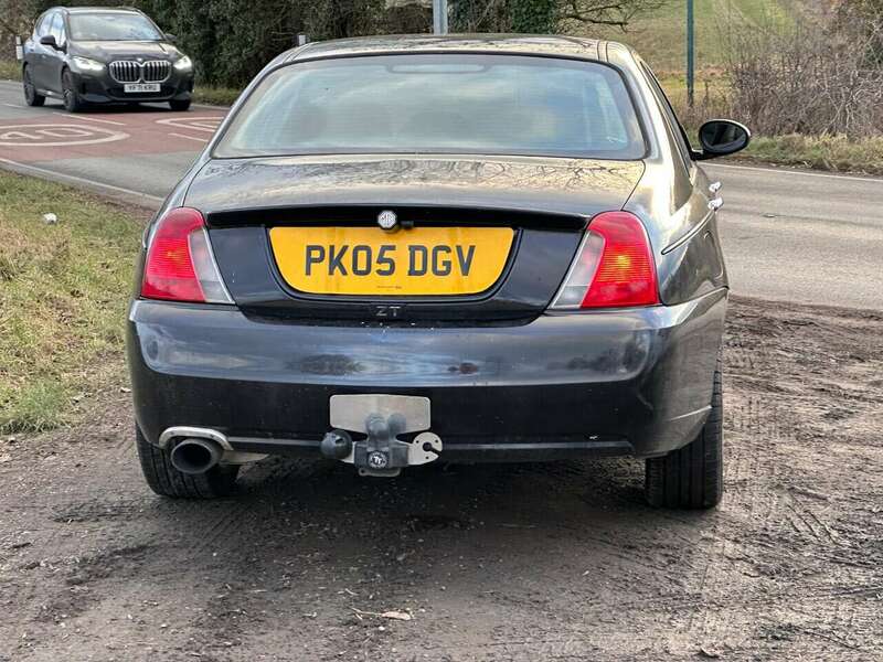

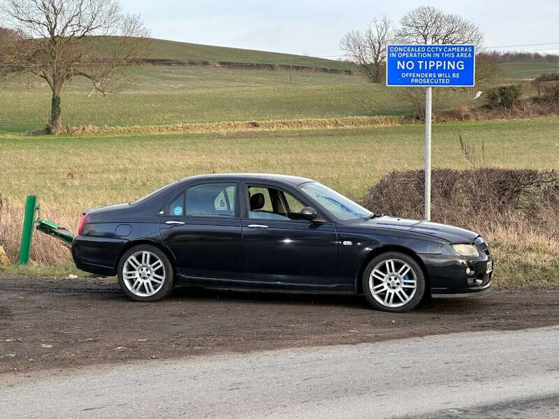

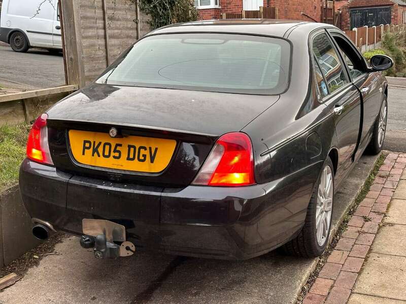

It looks like a car that's lived outdoors for six months over winter. But the brakes didn't bind, the engine didn't overheat, the clutch didn't stick (it did squeak). I wonder if the towbar is any use...
To be fair while a bit underpowered and pedestrian next to the ST, it's quite capable of pulling itself down a bendy Fens corrugated road very well and that's on knackered suspension and shit tyres at a "I'll stick 30psi in" level of fucks given, I'm quite impressed.

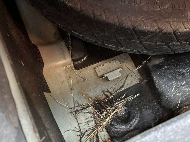

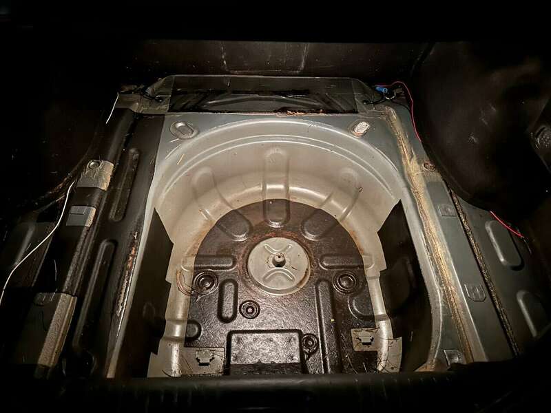

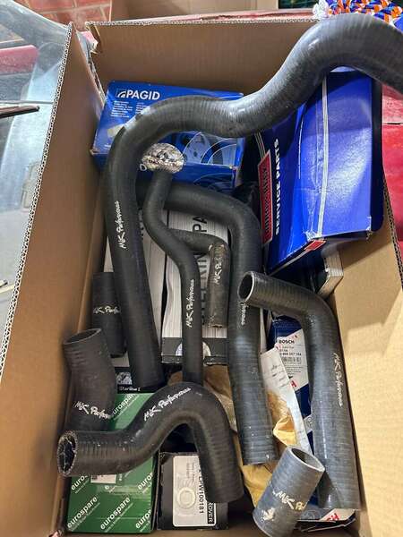

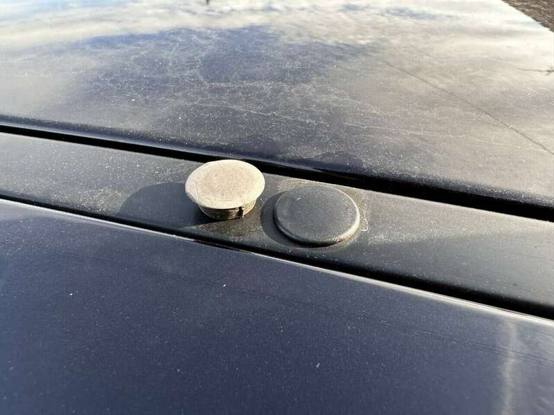

Empty the boot -  some spares in it. Silicone hose set would look nice installed. Dry it out is job 1. New tail light seals needed? Need to do some googling.
The boot floor fibreboard is wrecked 😕

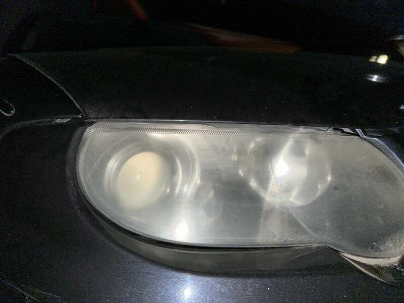

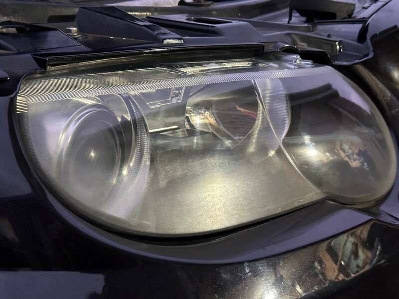

Needs the headlights polishing, but I've done that before.

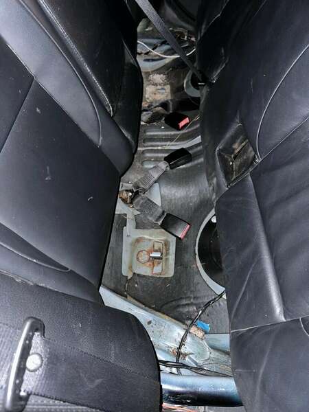

Also I'm looking very askance at that colour inside the boot and rear seat floor compared to the black exterior. Is that just "because MGR" or does this car have STORIES?

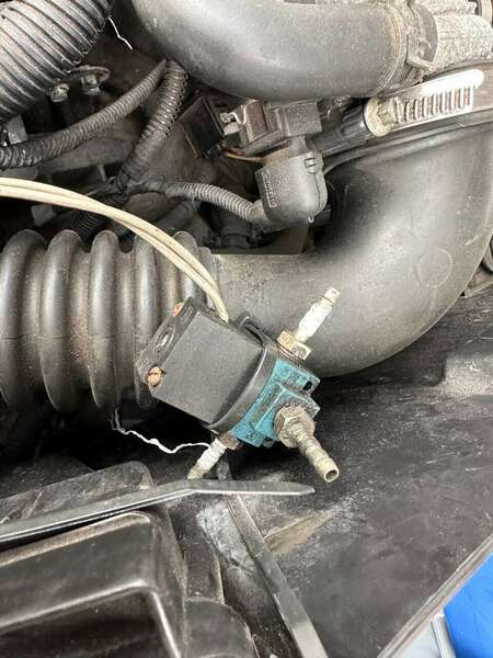

This is a MAC boost controller.
I have a suspicion this car may have maps other than the navigation.
Spoke to previous owner.
Yes. This is going to be a lot of fun when I've got a new coolant cap on and checked that wiring to the boost controller...

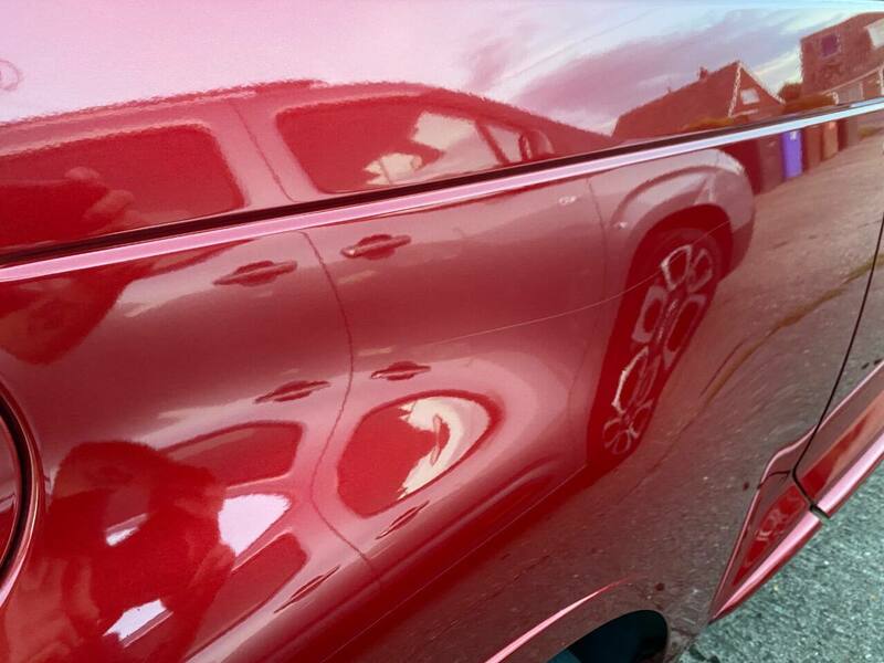

How do you deal with scratched side windows? Thick waxes help or just replace the lot?
Testing: water in boot after jet wash? None. Roof grommets replaced. New coolant cap. Hoof it for traditional dinner. Revs well. Pulls well. Full tank of super and check for piddling...

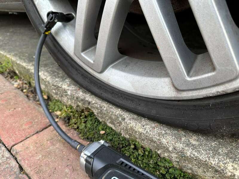

Clutch feels like it needs a fluid change, tyres need pressure sorting, but you can feel the fundamental rightness of how it must have driven new.

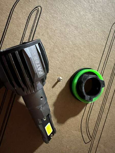

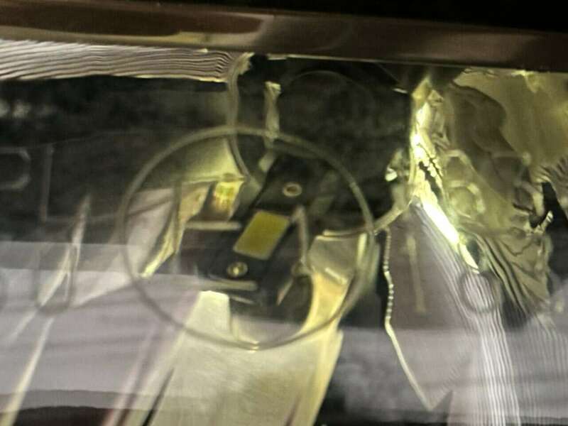

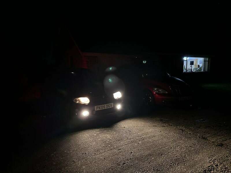

So LED H9 bulb replacements are crap. They're actually H11s, they don't usually rotate in the mount for adjustment, and H9s are designed for high beam so are assumed to be any orientation to suit (I'd question that, and R75 lights are crap anyway which may be down to choices like "we don't care which way the bulb ends up as long as it fits in the offset hole with its bulky connector on").
Dashboard is in bits so I could fit a USB extender to make it possible to upgrade the firmware.
