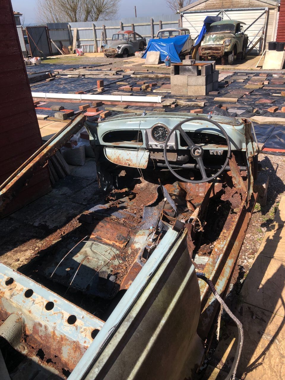

For Β£350 you have to ask yourself, just how rusty is it. I have just read Captain 70's thread. That was a weldathon and a half! On both cars!
It goes without saying you have got to buy a Minor on structural integrity rather than mechanical condition unless you're some kind of cutting, grinding,welding pervert.

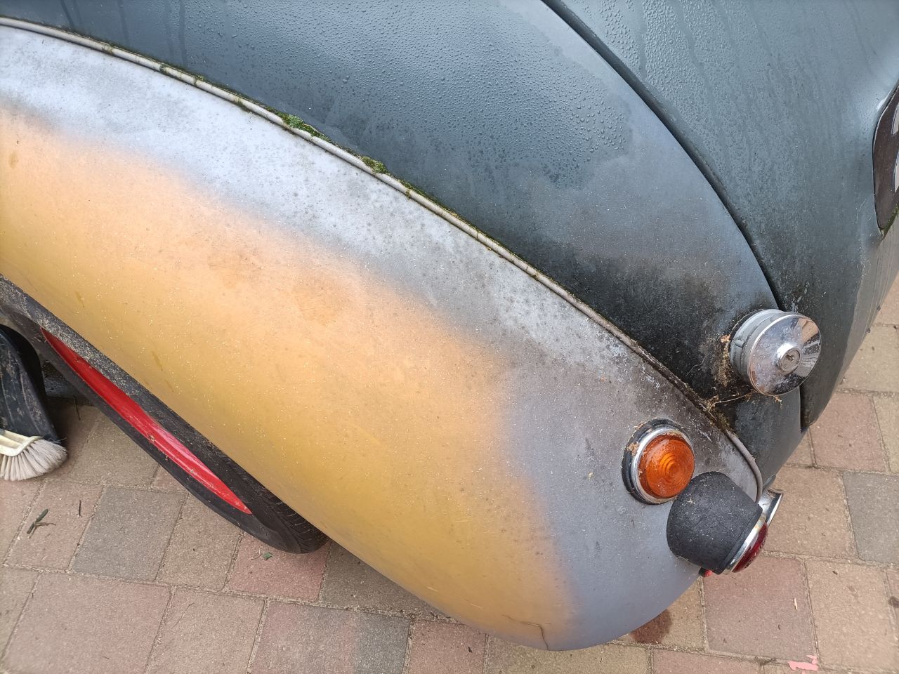

I've still not completed the fourth wheel as I don't fancy the faff of squaring everything up with a dial gauge atm but as mentioned elsewhere all the lights are now fitted and work as intended although I didn't like how I had done the rears as it looked awkward so I did away with the indicator plinths as they didn't sit right and annoyed me greatly and just fitted the lamps flush into the wings instead.
I've got orange lenses coming too as red doesnt look right.

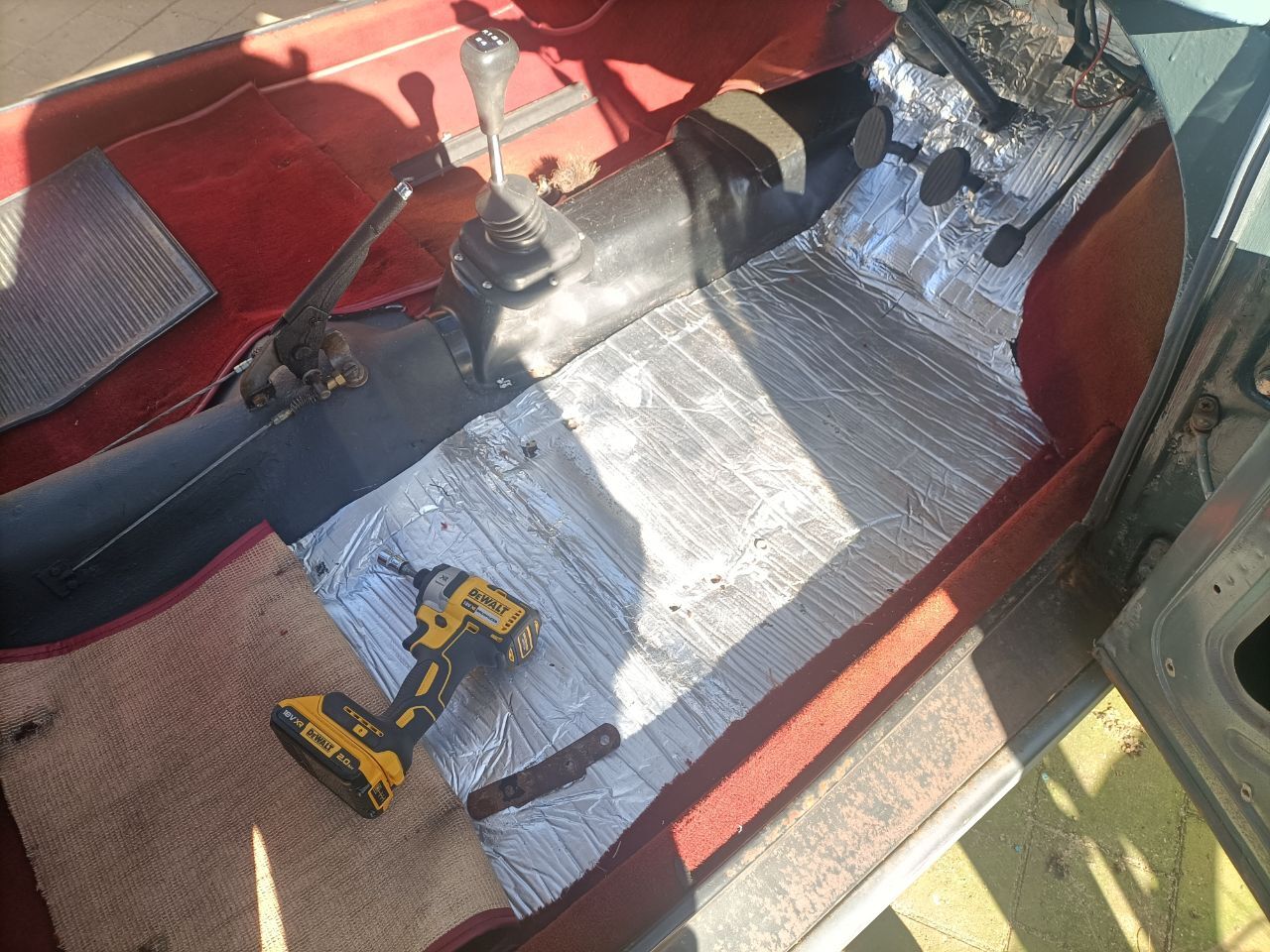

The sound deadening sheets and insulation has been completed.
And the carpets and seats fitted.

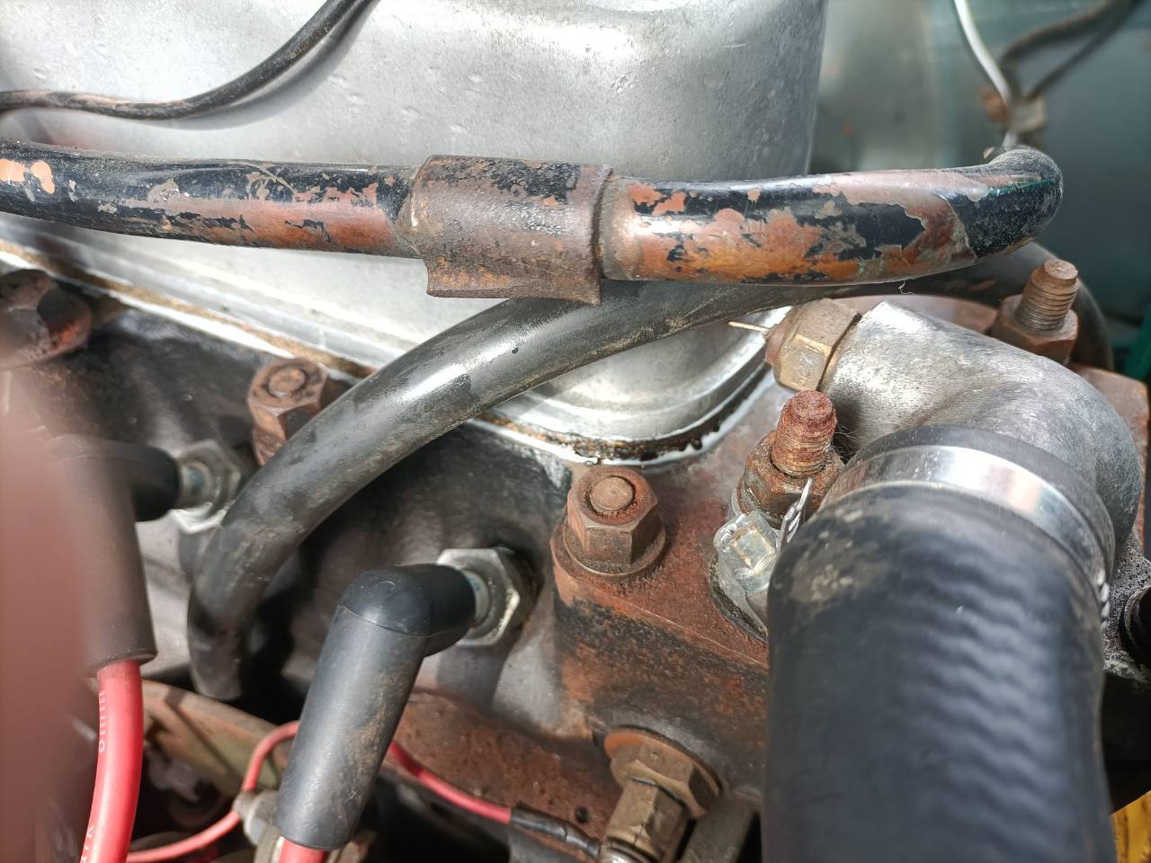

The rocker cover gasket was leaking so I changed it and this time used a thin layer of silicone on both faces only to find that hot oil is now leaking through the cork material.
I mean how is that even possible ?

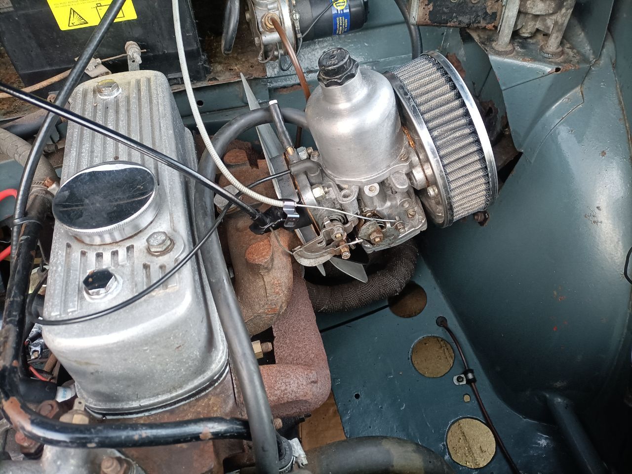

First up is the poor running and holding back the ignition system is new and now electronic so I feel fuel delivery is where my troubles lie.
After watching a clip of it in action I purchased this 38mm Hif. I wanted a 44mm one really but couldn't justify the cost.
I stripped and cleaned it inside and out before fitting it but soon realised my Minor throttle cable didn't fit the mounting plate so rather than order/wait for a Metro cable I cut off and welded the stub from the old HS4 mounting plate on to it instead.
The K+N filter was black and gummed up with oily crud and obviously not ideal so I cleaned it with petrol and a tooth brush before bathing it in really hot soapy water and it seems to have come up like new again.
The needle jet already fitted was allegedly suitable for a 1098 engine and with a bit of research a AAM needle was suggested as being suitable for a Hif 38 on a 1275.
Original needle (ACC) versus the new AAM jobby on the right. There's quite a difference in profile.
So with it all back together and the mixture roughly set using the piston lift pin as a guide I went for a trot around the village and can report that Boris is now a happy little Morris Minor who pulls well and idles sweetly.

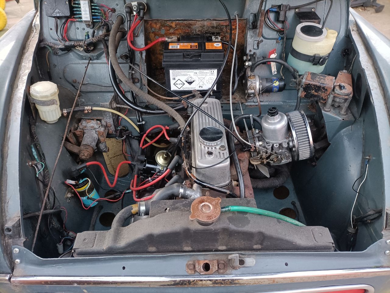

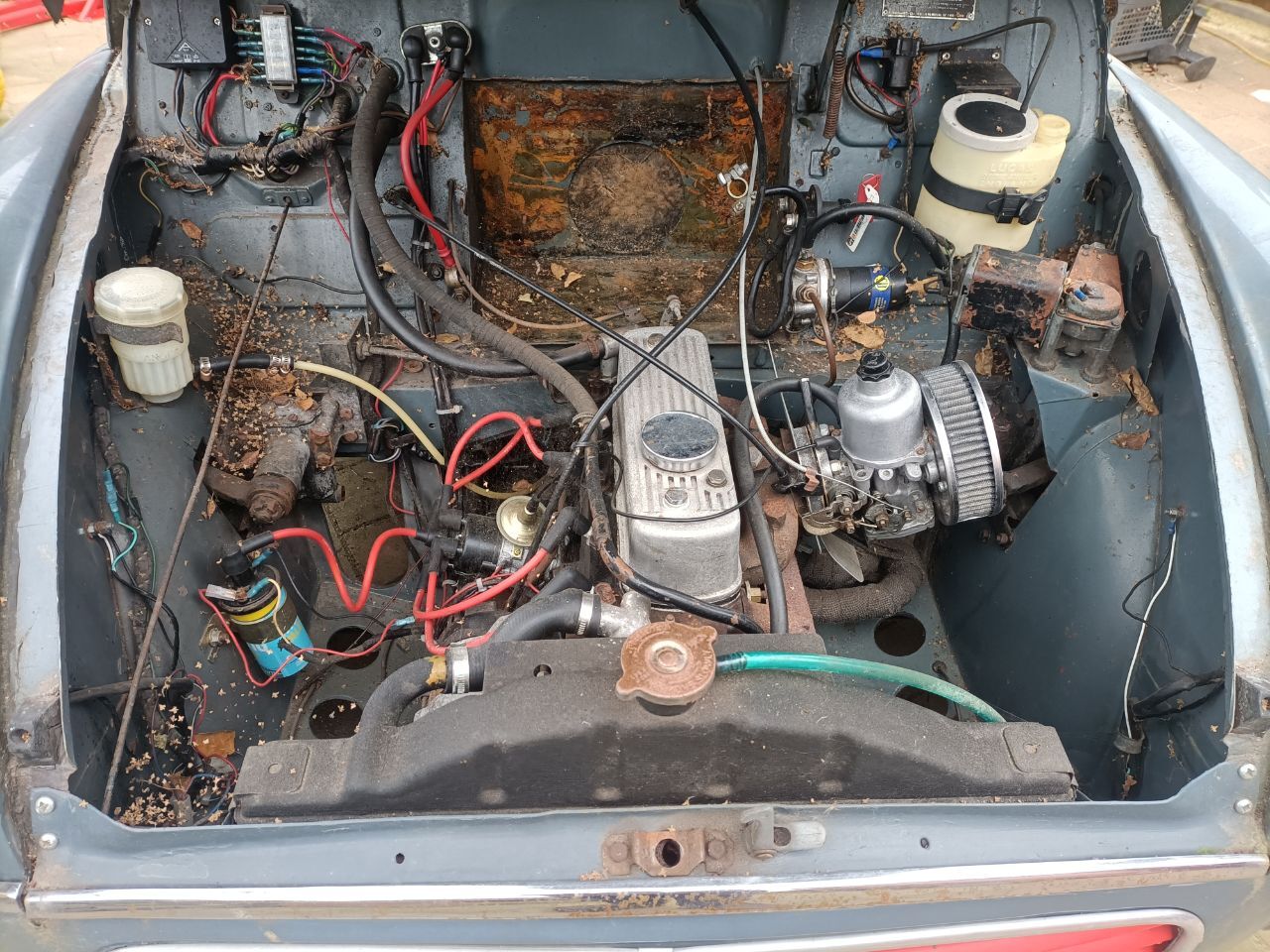

The weather has been kind so I've hoovered off all the detritus from under the bonnet and the cobwebs from inside the car.
A fresh battery and a can of fuel and everything is happy again except the empty brake fluid reservoir.

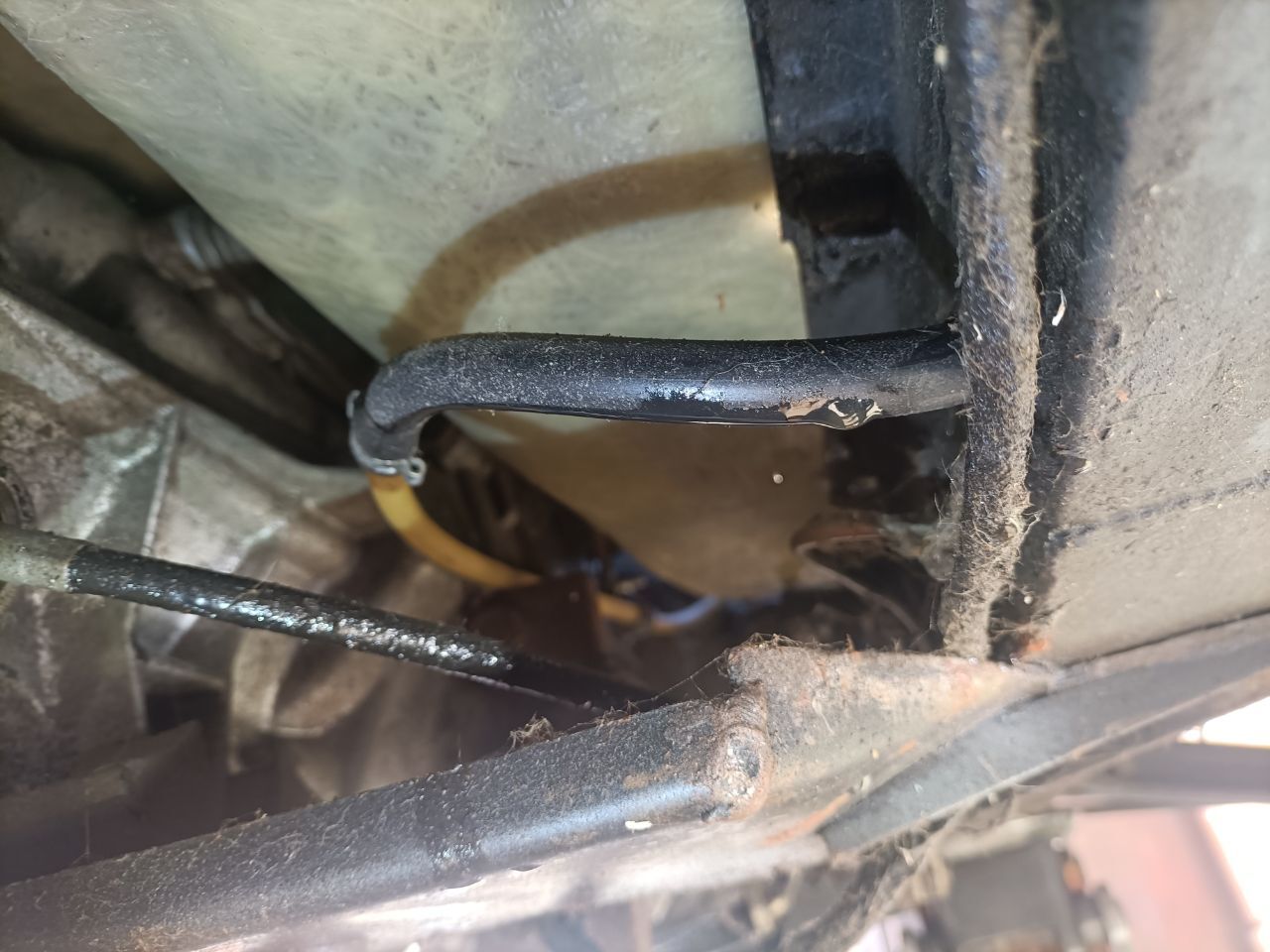

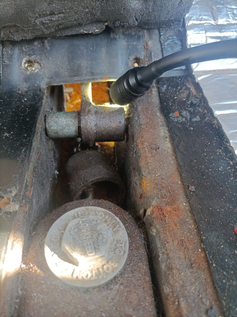

There's no obvious puddle or wetness that I can see underneath so I lifted the little master cylinder cover on the floor to see if there's anything obvious going on.
This self adhesive insulation I fitted last year wasn't my best idea as it's visible through any gaps or wear holes in the carpet and the shiny silver finish really sticks out like a sore tit. And as I need to get to the m/cylinder in the chassis leg I've had to peel it away to gain access.
Shining a light up the chassis leg surprisingly showed me it was swimming in water and waxoyl but not brake fluid. Then when I lifted the front of the car up all the collected water pissed out of a small drilled hole in the chassis rail under the m/cylinder.
Boris has had new front chassis legs at some point in his life but it doesn't look like they have had any drain holes added to them so I'll add a couple later.
Anyhow I tracked the fluid loss down to this perished hose that goes from the plastic line to the master cylinder.
This hose wasn't that old either but I had some reinforced pcl airline stuff that I've used at the reservoir end (that's been good) to replace it with.

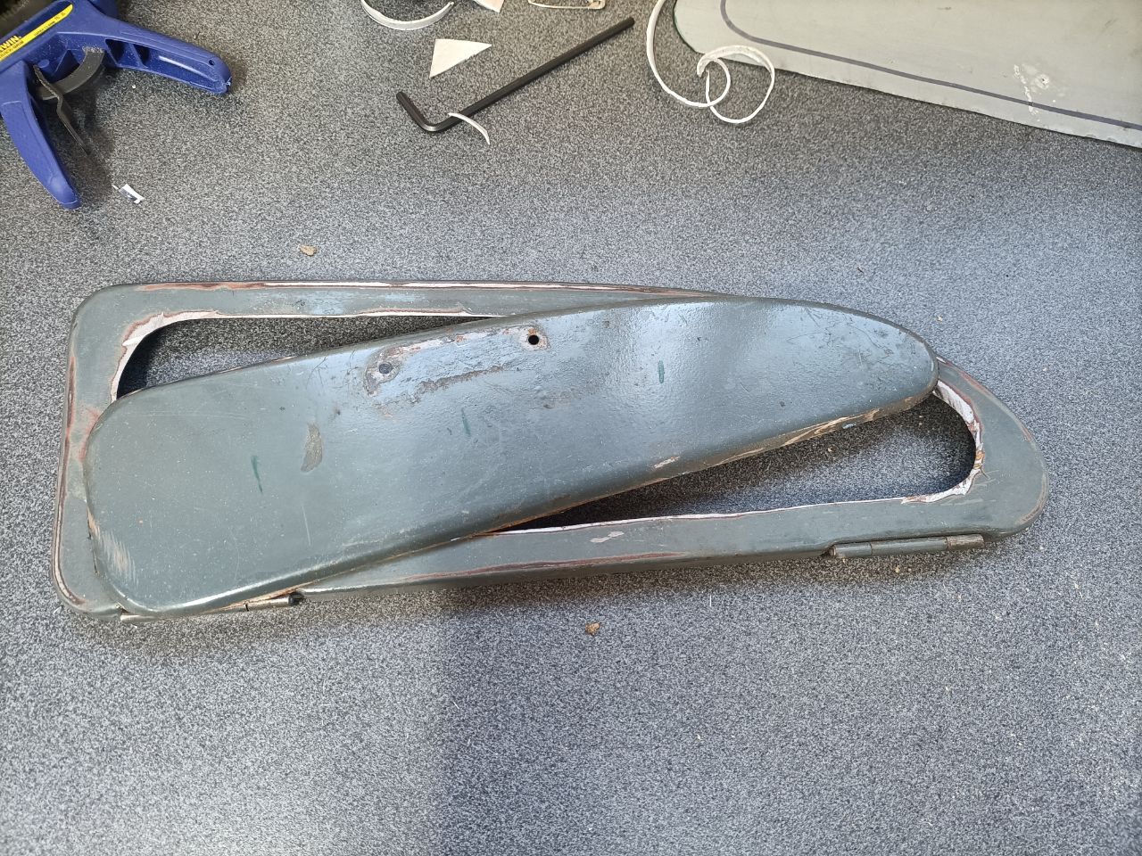

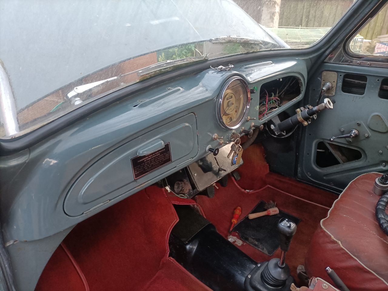

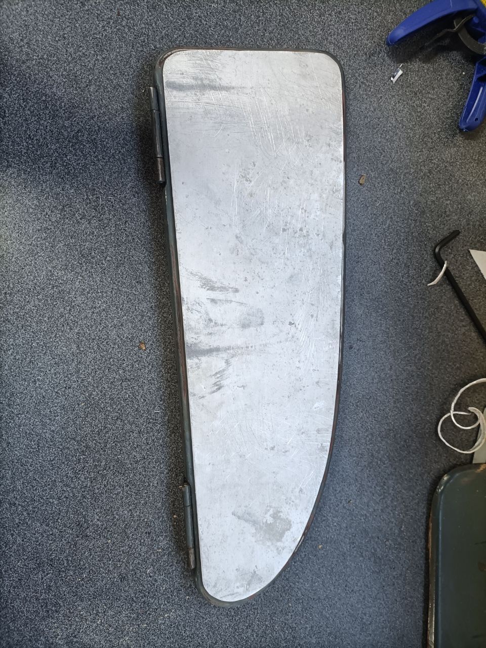

A while back I had this idea of adding extra gauges into the drivers side glove box lid so I butchered it with a grinder then instantly regretted it.
I've cut a bit of aluminium sheet to the right size but I need a way of securing it to the lid and also a way of cutting three 52mm holes in it.

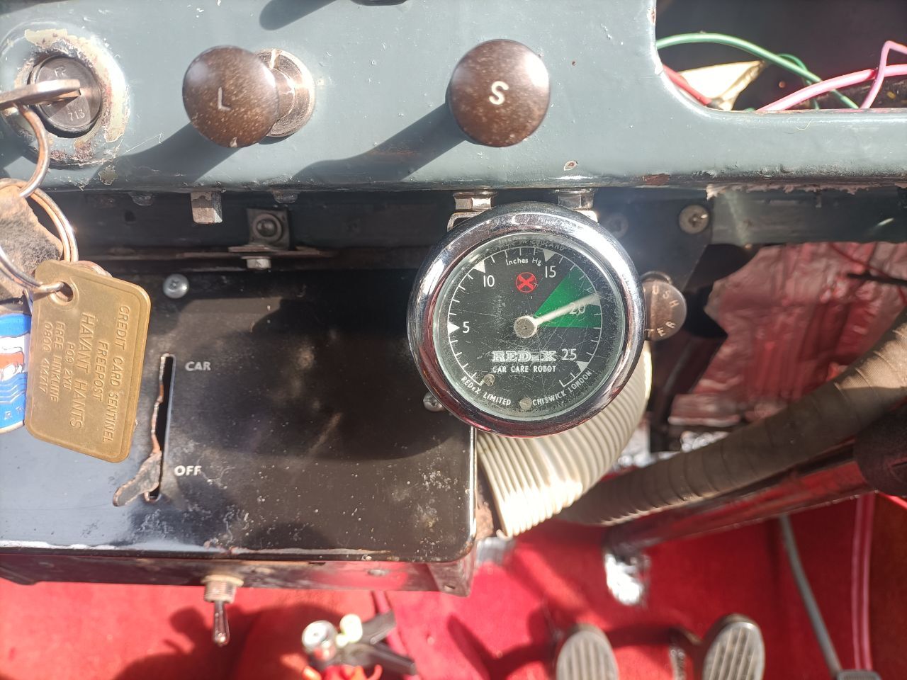

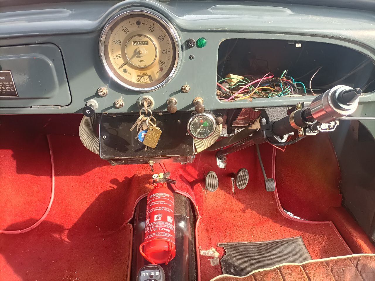

I bought a scruffy Redex Vacuum gauge a couple of years back and seeing as it doesn't have any wiring faff to contend with I thought I would add it to the dash straight away.
First off I had to evict a couple of squatters who were sunning themselves.
About here seemed as good a place as any and while the drill was handy I bunged a fire extinguisher in as well.
Having a dig through one of my "that'll come in useful" piles I found a length of 3mm diesel injector return pipe that was plenty long enough to go from the back of the gauge to the inlet manifold so the installation was complete.
20 whatevers at idle looks about right to me.
I had a similar TIM branded vac gauge fitted to my Datsun 120A coupe (E10 model) back in the late 80's and I think from memory the idea was to try and lift off the throttle once up to speed to keep the needle in the green band to save fuel.
