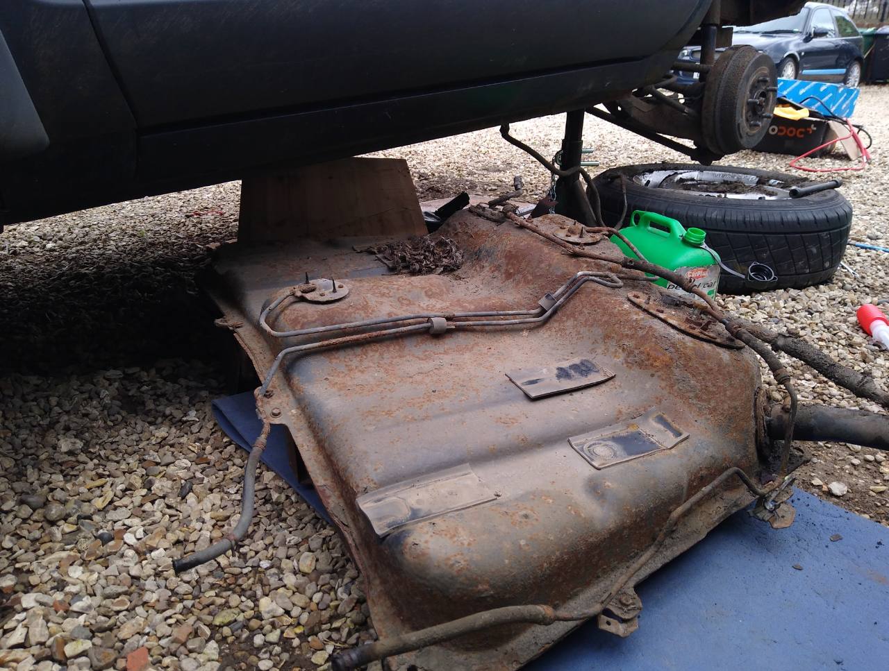

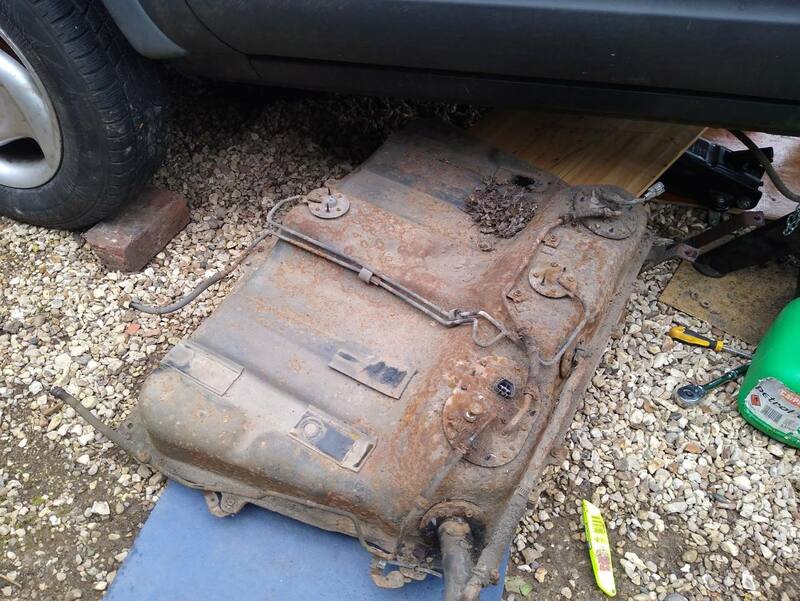

Following on from the previous post, I finally managed to drop the tank. Not too difficult if I bothered to take the petrol out in the first place. It's quite an object to move, especially on your own, two floor jacks made it easier.
I could not be bothered to battle with trying to remove the rubber pipe connecting the tank to the filler pipe. So I cut it.
Tomorrow, or Thursday at least, I will regret that. But at the time, I had enough and decided the knife knew best.
One strap looks great. The other strap looks a bit crusty but I didn't really look at it properly. There's nothing to these straps, so a strip of steel and it'll be good.
There will definitely be some rubber pipe components that need changing, especially in light of the E10 stuff. Some of the pipes also look a bit suspect.
Given the fuel tank is what it is, it was easier for someone before me to tie pipes to the tank that had corroded through with cable ties. A bit sketchy, so I might look to fashion some brackets before it goes back on.
That goes for the shields underneath too.
FYI - I had 20 litres of petrol in there, which are now (much to the delight of my wife) in the Peugeot 107. Filled the bloody thing I did!

That fuel tank looks ok from the photo, a hand wire brush, bit of rust treatment painted on and a coat of paint and it should be ok. If it's rusty inside there's acid kits that you can mix up and fill the tank with that kill it off.
Online only steel sellers take the piss a bit. Do you have a FH Brundle within delivery distance? They are (usually) way cheaper than anywhere else for sheet steel. For me the Glasgow branch have always been excellent. Ordered online, £10 delivery (still £20 cheaper than picking it up from local place in my van) and it appears on my drive in a couple of days with a courtesy call to say they're going to be over. Their bolts and paint and sundries are insanely cheap.
Yeah the tank itself is fine. It's more the lines themselves look a bit crusty. I'm going to treat the outside of the tank and fashion a new shield for it, as one is rotten.

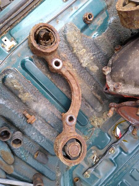

So while I would like to remove the tow bar from the car, it is welded on with some unknown substance. Try as I might, with the heaviest of hammers and brute force, the thing is stuck on there for good. I had a quick look around it, smashed my screwdriver around it, all strong and good. So it'll benefit from a good wire brush, Jenolite bath and primer and it'll be good.
The rear differential came off, meaning now(!) I can start cutting, grinding, making a merry nuisance of myself. Before I started this, and I think it was mentioned before, the car would "clunk" from a standing start. Obviously this is a 25 year old machine with 25 year old rubber, and so I knew I would be changing the rear differential bushes.

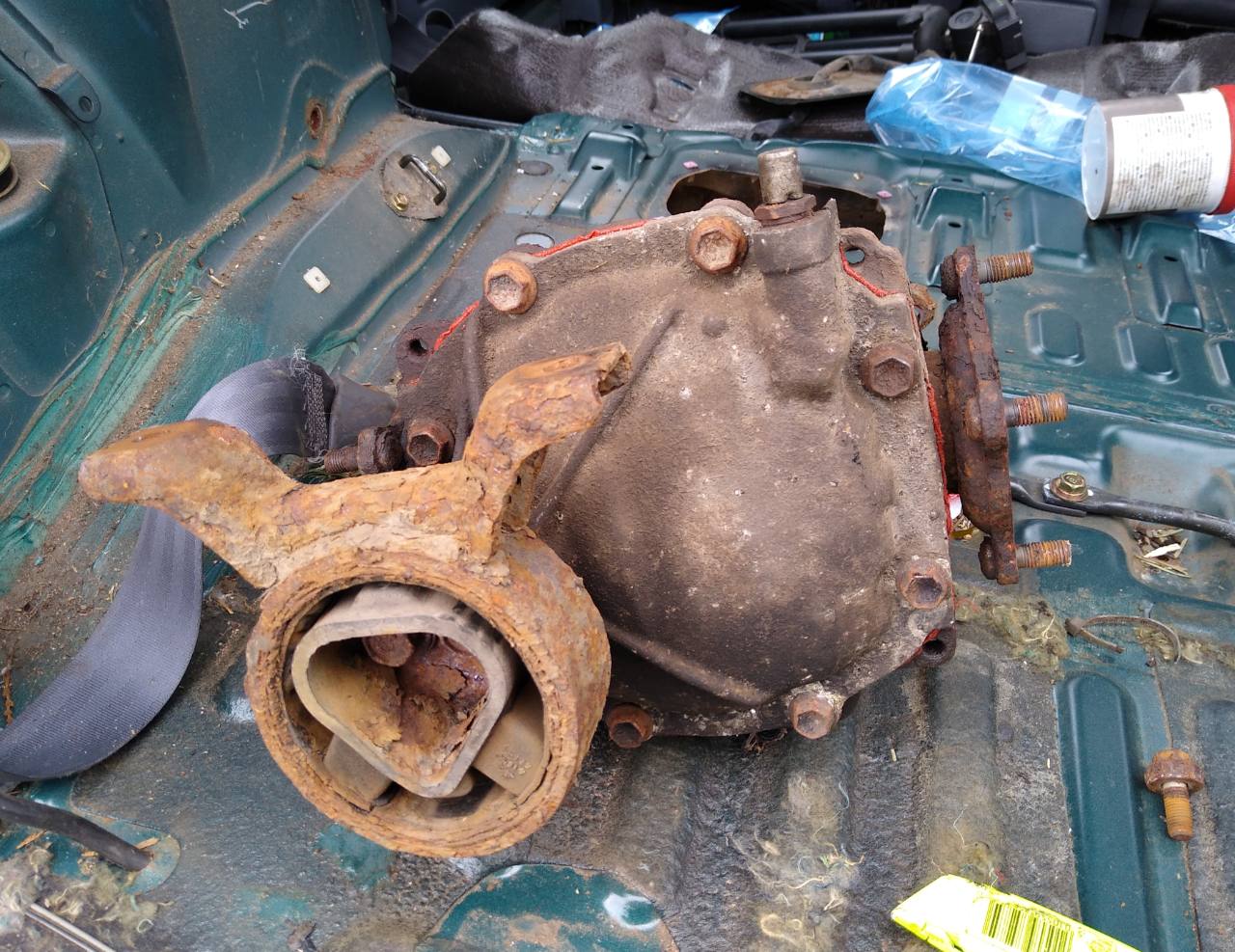

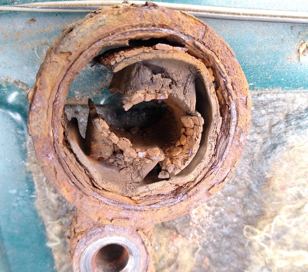

What I didn't know though was that the "front" pair would contain one rubber that was properly gone.
It's like plastic! And I now have a bolt stuck in situ with this bushes sleeve on it.
Now I bought the bushes thinking the brace/bracket would be alright. It was going to be the one job of this whole thing I'd outsource to someone with a hydraulic press, but I'm thinking I might just buy the bracket with new bushes already loaded.

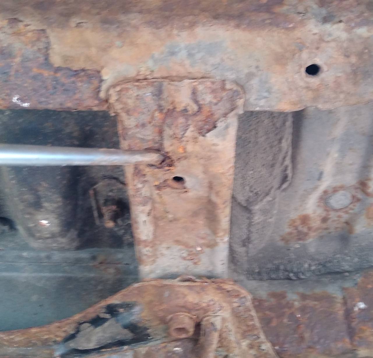

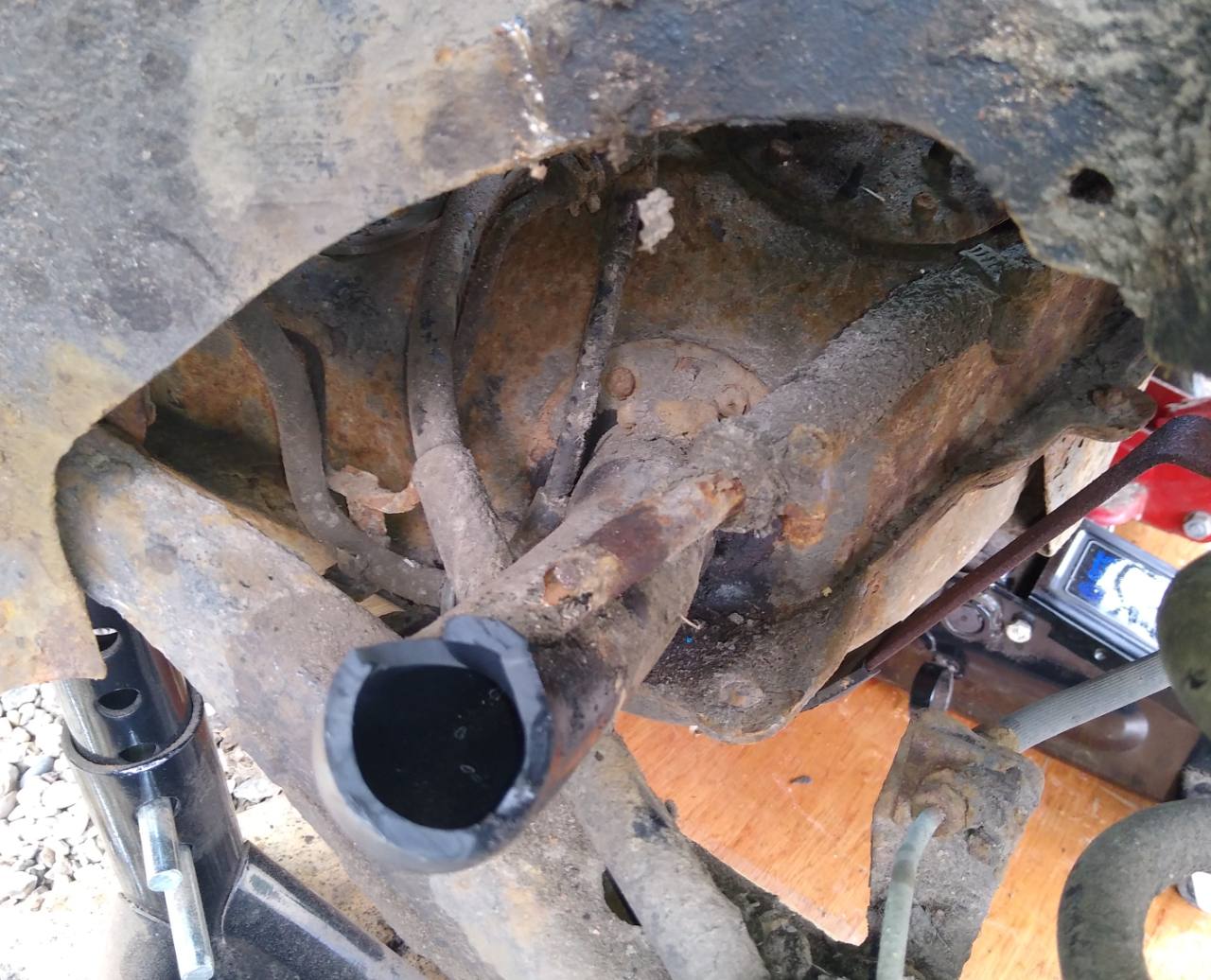

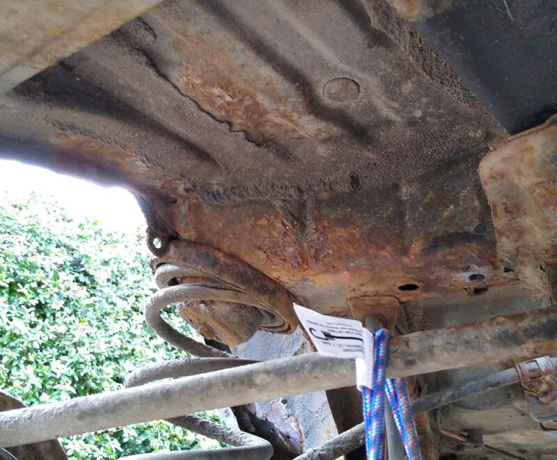

Anyway, I'm now underneath this thing surveying around the differential for any rot. I've found one already but it's quite local and a fairly small place.
But the bit it joins up to, while I can't make a hole in it with the screwdriver, does feel fairly thin.
It really is in that area where you can see ive scraped the loose stuff off, and doesn't seem to be an issue on the sides leading to the floor. It's just the bottom of that section of the beam really that feels thin.
Rear suspension mounts look orange, because they are, but they're strong.
So, without further ado, I'm off to get the angle grinder and raise hell. Starting with that beam!

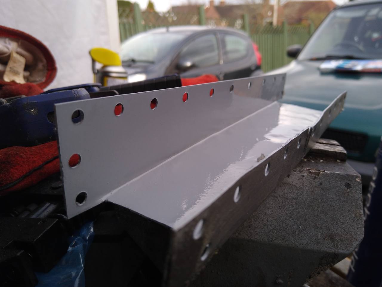

I'm getting better at this CAD stuff.
Degreased the panel, applied weld through primer (I know), and now dragging my sorry arse under the car to prep that as well in the same way.

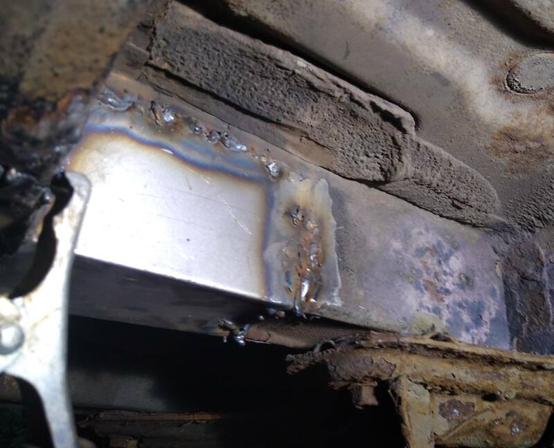

I would just now like to say that yes, I am well aware the following is ugly.
Yes, I am well aware that it's amateurish.
Yes, I can boogie.
It's a total bitch of an area to weld. It's a total bitch of an area to grind. It's a total bitch of an area to make pretty. But, I have the first repair done. I've banged on it with a hammer, I have ground down some welds, and I can see by the discolouration of the steel I have applied good heat penetration.
I am waiting for it to cool down, and I will be priming it now as I may have had a dose of metal fume fever from Saturday, and I'm not totally over it, but I did manage to snag a respirator mask today and done what you see here.
I have improved in my welding, as the repair panels I've made have been bob on and the preparation has been far, far longer than what I did before, and I am getting that sizzling bacon sound when I do it. It spattered in places, and I've lingered too long in others, but honestly I should have just taken the rear axles off completely to get good access to this place. Which, considering everything that's gone on before, I am willing to have an ugly weld compared to having to change more components and suffer with Toyota component corrosion.
It looks like it has penetrated ok, welding upside down is always ugly as it can be hard to see to judge the travel speed, and all the molten metal wants to run down your head.  It's at least 5373748439.79 times better than any MOT patch.
Get some seam sealant on the welds as there will be holes (even when the welds are pretty), and if you can blow some cavity wax through the rail even better, as the primer burns back leaving an exposed area.

Yeah it's a crap place to weld, and the place where I was comfortable the rear drum was in the way, then another place the helmet was coming off. So I was flat on the ground, watching those globs of metal forming and I'd hold my breath when the odd one fell.
I've got to drill a hole in that plate, as it had one originally, and when I do that I'll grind back more of what I've done and apply the seam sealer I've got. It's looking like Friday, Saturday, Monday and Tuesday are available for me to do the welding so I'm hoping to get at least one arch and sill done!
The steel isn't galvanised, I don't think. He did say he usually only had that but had this mild steel in stock which was handy.

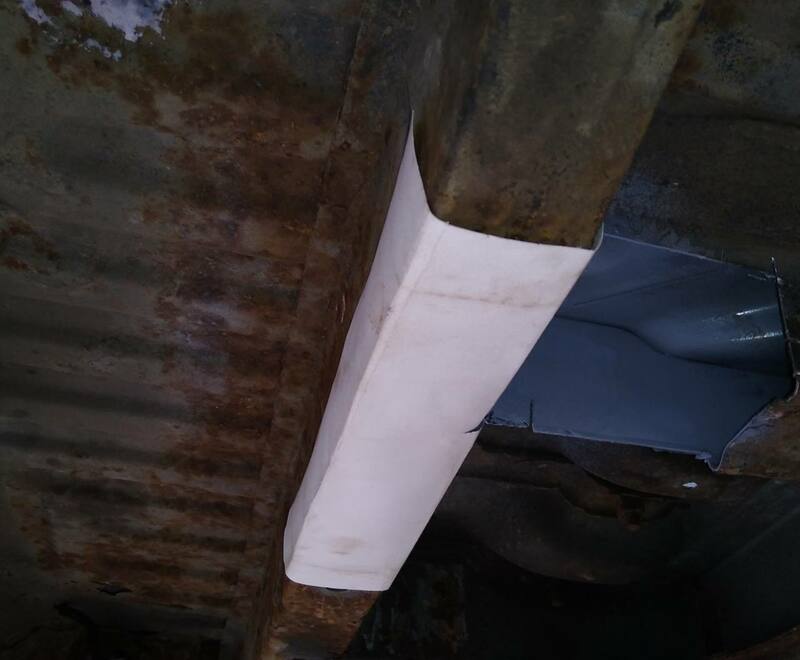

There's not a lot I can do now as both the area on the car and the repair panels are both drying with the weld through stuff. Tomorrow I'll be welding upside down (again - joy) and then I can move on to the arch.

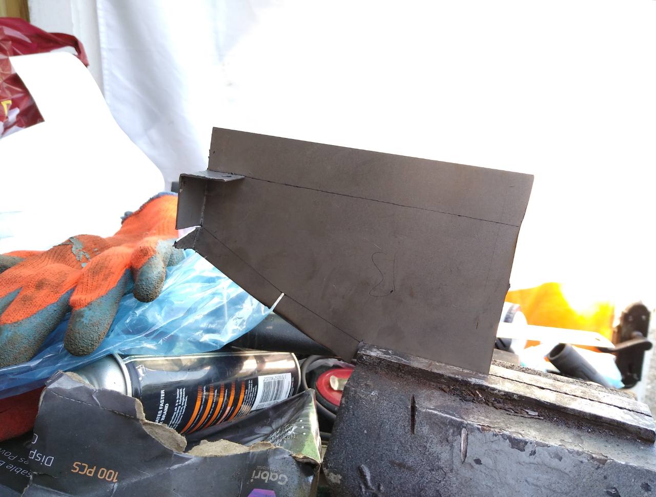

That panel was a pain in the arse. I had the size right, but it also had a curve that I didn't appreciate until I had the panel made up. Plus the bottom of the arch gets welded on to this panel.

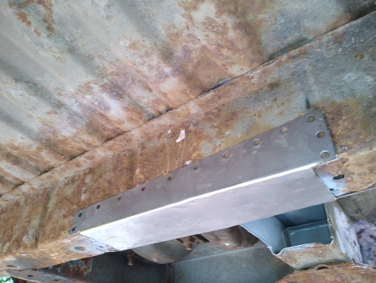

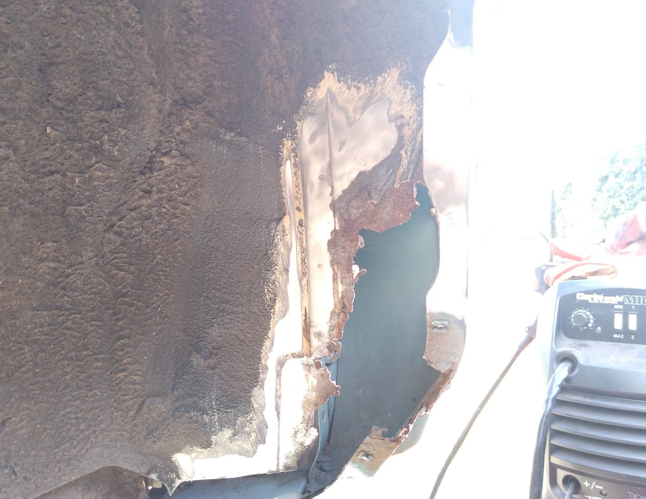

The new panel from yesterday is welded in place. Needs cleaning up as always, given it was another upside down welding job.

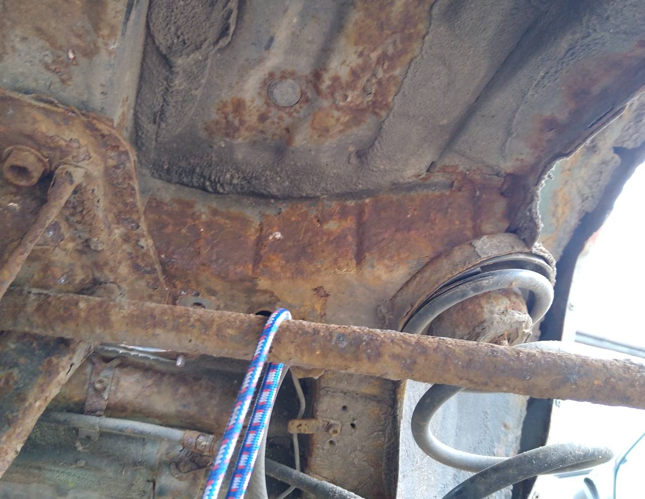

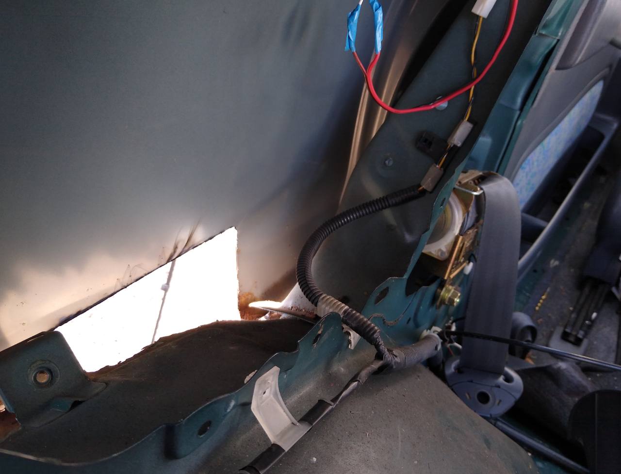

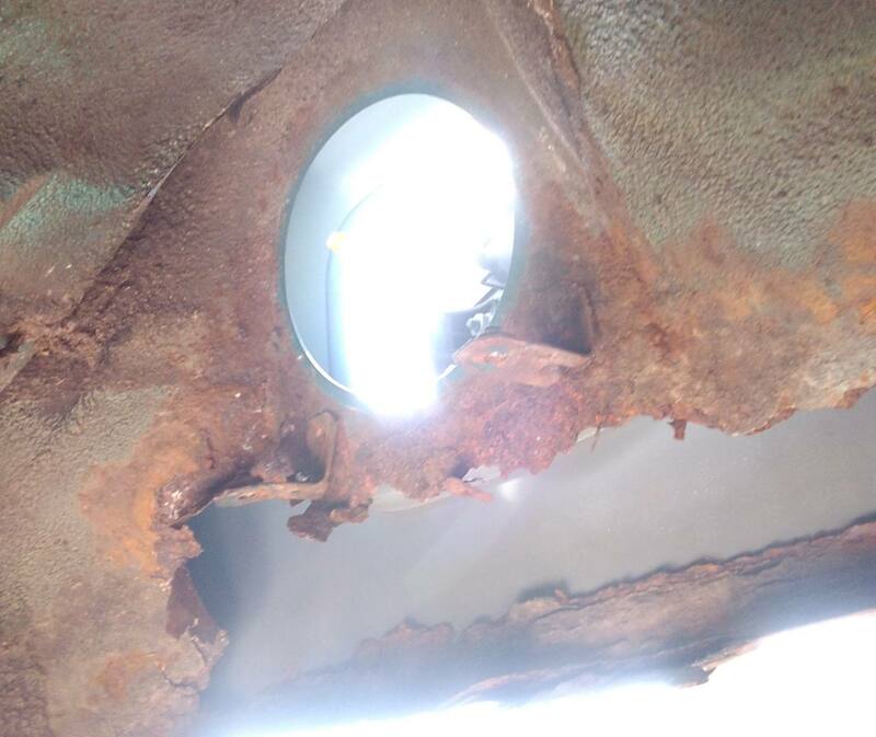

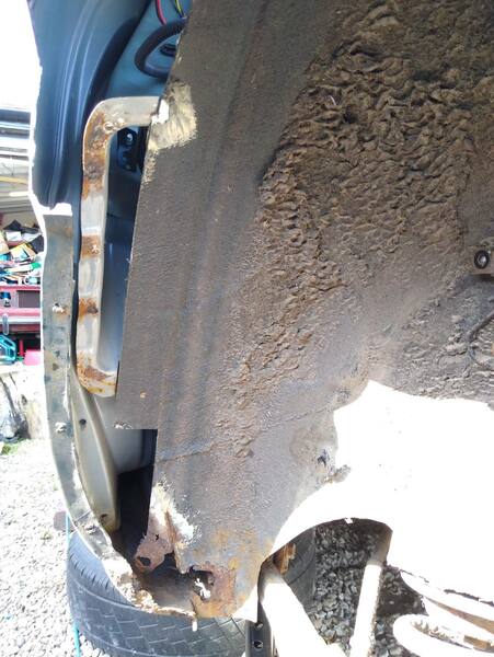

I've really been spending today working out how best to proceed with the arch repairs. I don't want to introduce the same mud shelf that the car had which caused a lot of this rot to begin with.

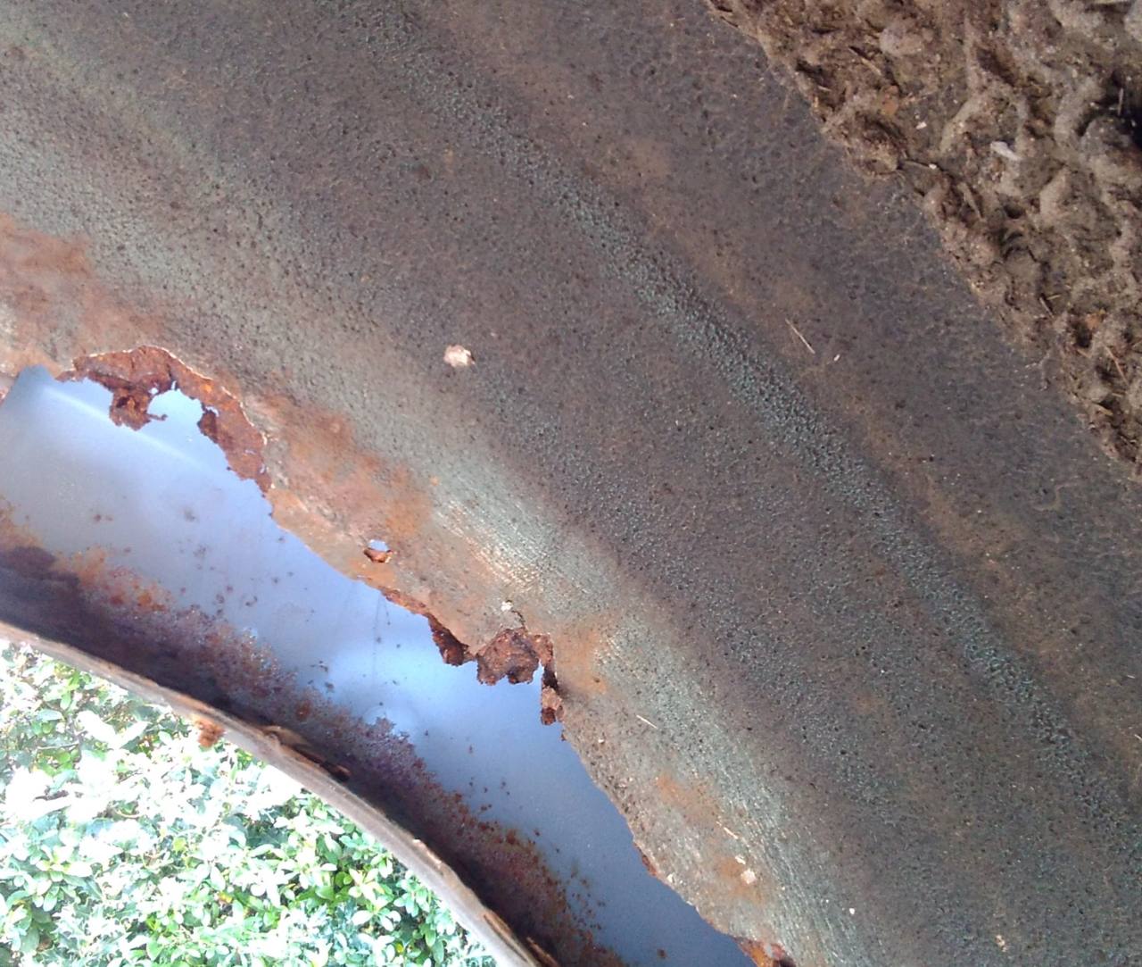

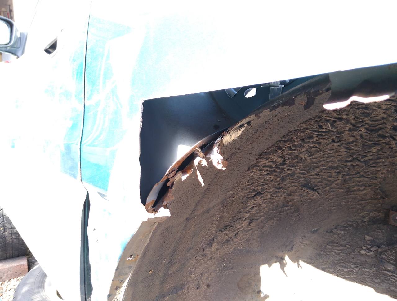

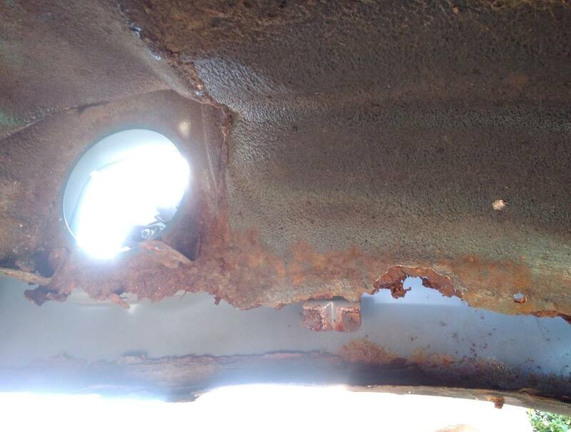

So, as I welded that section, I went to see how much of the arch was sound at the rear.

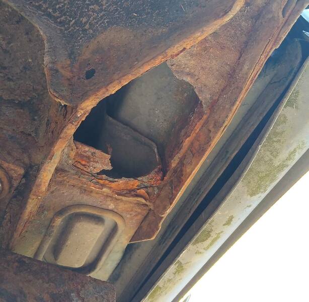

You might see some spot welds there, and it welds on to a box section which is fairly perfect (from what I can see with the air vent removed). Although some rot has been introduced to it. So I think here I need to try and cut the rotten bits off of this section without damaging the rear section, and have that as a nice clean section to weld to.

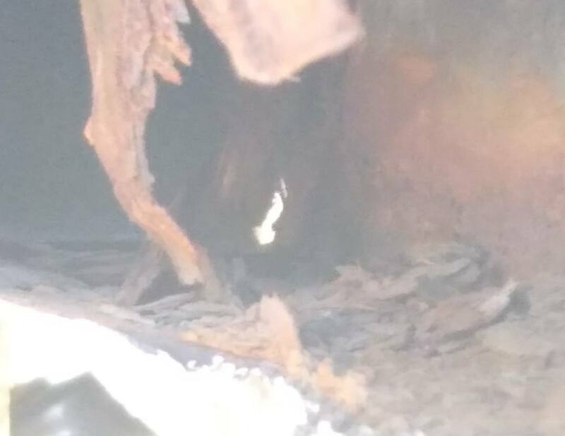

The further forward I went along the arch, the more rot I saw. A good section of the steel that holds the fuel filler spout is rotten.
Inside the RAV4  there's a cubby hole, so I decided to remove it. Doing that gives a good view in to the arch from the inside. Doing that also showed that the outer skin was also showing signs some form of rot. Well, the beginnings of it.
I am probably wrong doing this, but given that the arch joining the outer shell was rotten, I decided I might as well cut the outside to give me a better chance of repairing it properly. Which I did.

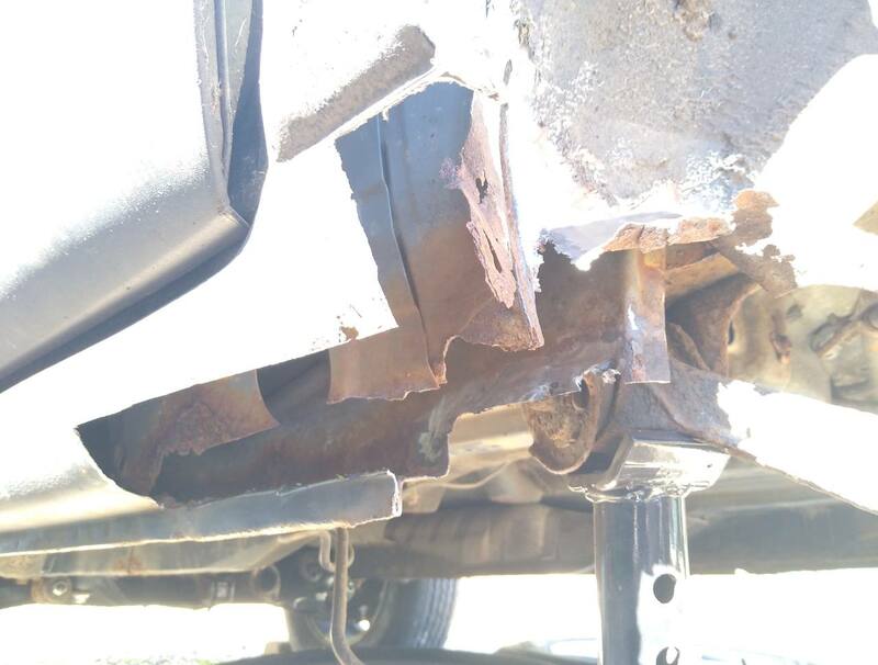

Rot wise, it's anything but. And I'm now stuck with a decision to make.

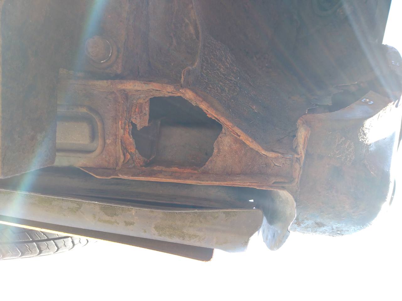

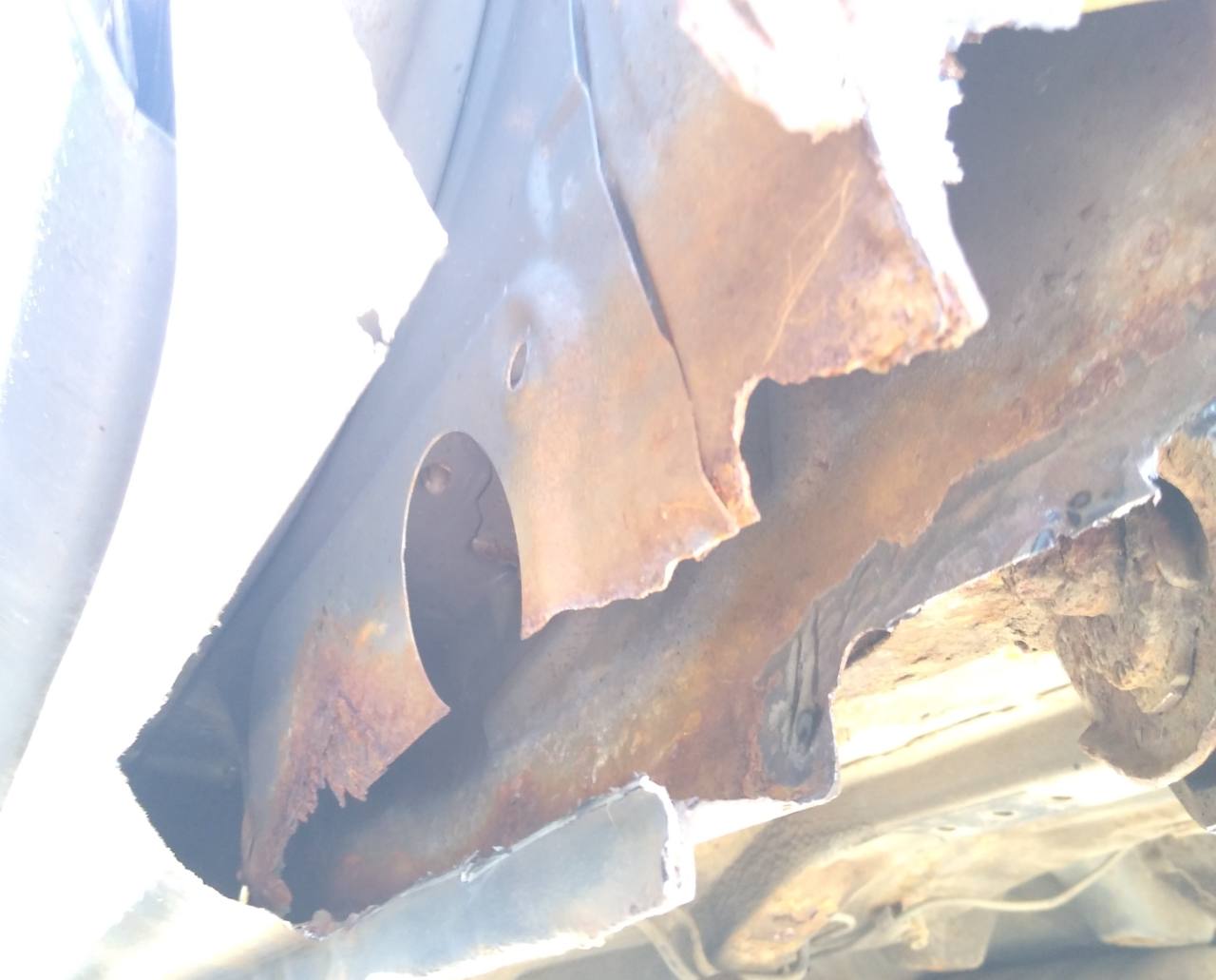

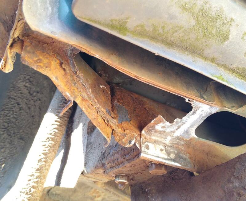

I'm dealing with the sill on the passenger side, given the above/last post it's kinda rotten here and only the second item on the MOT list that needed doing.
I've had to cut the repair section from the sill (as in the previous repair) as it's rotten behind it. As you can see.
Inside the sill is where I have a dilemma, based on how the Lada is put together. So the Lada has an inner, middle and outer sill. That was in my head when I saw this:
That last photo, where I'm zoomed up to it, was connected to the sill below.
So on the outset, I don't think that bit of steel in the middle is all that important, given that the previous repairer to me cut part of it off. That section also doesn't run down the whole length of the sill, just seemed to be joined to it in this particular area.
The question is: can I continue to weld the outer sill on to the car and it'll be fine? Or do I have to attempt to add a section to the inner sill and then weld that in to the complete repair?
Advice - other than weighing it in which is being considered again - is sought and welcomed!

That looks like reinforcement panel, probably for the rear jack point on the sill.
If you remove it, beware of the 2 post ramp. If you patch it, it just wants to be strong, not pretty. The sill should probably be welded to three layers on the bottom flange front and back, two in the middle.
I wasn't going to remove it, as it's already been cut off previously. I'd need to cut some of it off to stop the rot anyway.
Yeah I'm considering using some 2mm steel for this section instead of the 1mm stuff. Or rob some of the Lada's 1.2mm stock...
I’d try to do it as originally intended, so I’d fold a run of steel to go from the remains of the intermediate sill, down to the bottom flange.
Repair floor or inner sills, plug weld to this new bit, grind and then plug weld the outer sill or patch to it. You’d then have three seperate 1mm bits joined, and full strength.
Welding 2mm to Japanese tin would be a challenge I’d guess, without blowing a golf course amount of holes anyway.
