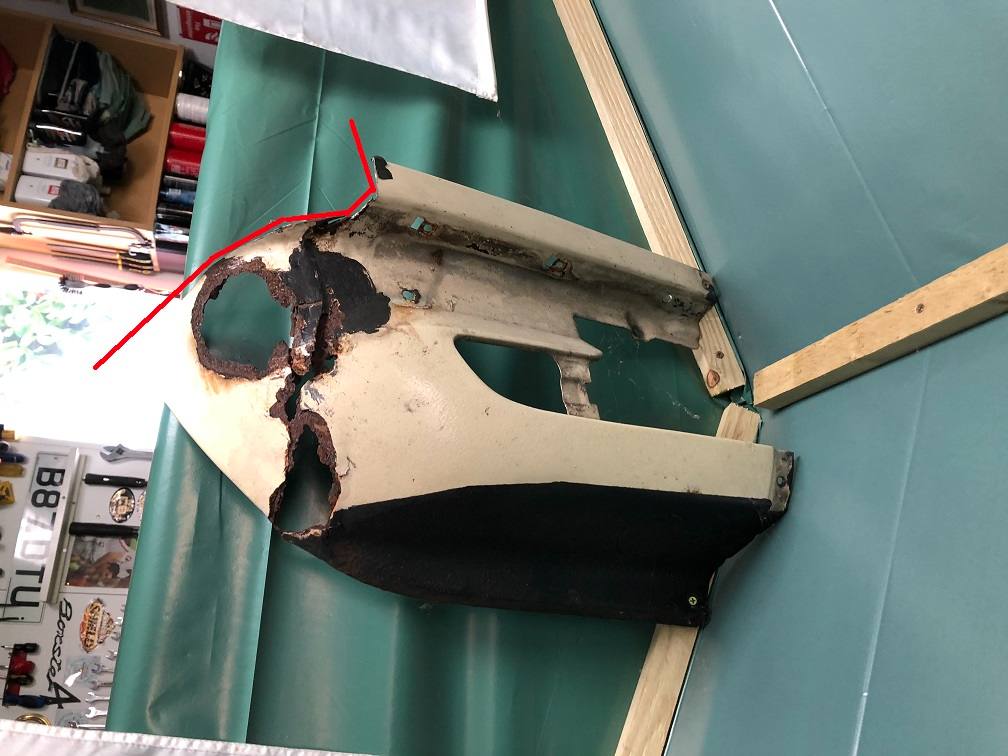

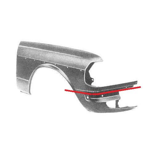

Peter C Posted January 17, 2021 Posted January 17, 2021 If the front wings are original, I would advise against replacing them with pattern parts. They just don't fit properly. Years ago my W123's front offside wing had rusted away in the same way as yours. As the rest of the wing was original and in good condition, I cut it along the red line, bought a pattern wing and cut it along the same line and had the new repair section welded to my original wing. The joint, which is mostly hidden by the corner bumper trim, was made good and I only sprayed the repair section, blending the paint with the original where necessary. Job done, my original wing still fitted perfectly and I had no issues with colour matching. artdjones, Royale80, Tickman and 2 others 5

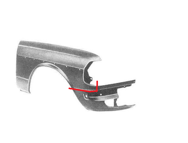

Peter C Posted January 17, 2021 Posted January 17, 2021 I didn't cut the wing as shown above. This is the remains of my old wing, which hangs from my workshop ceiling. I actually cut the wing like this: nacho man 1

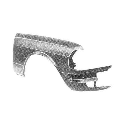

nacho man Posted March 2, 2021 Author Posted March 2, 2021 So this has been in the body shop since Jan, still there by the way. First off, getting the wings was a bit of a nightmare, everywhere selling them saying they had stock was lying. They ended getting two sent over from France. Obviously the new import/export fiasco made that go on longer than needed.Then last week they said they are painting both full sides, as they have had the dent man in getting rid of every last dent in site. I agreed to make it top nana.Then I needed a rear wing trim piece that bends around to the boot. Obviously couldn’t get one. Found a full set of trims on eBay.de coming from Turkey. Hope there bleeding right, as cost a few quid. Then they rang this morning to say they had found something dodgy on the edge of the bonnet.Also they want to take the screen out to do it properly. And they reckon it will probably crack when they take it out. Brill To be continued....Sent from my iPhone using Tapatalk theshadow 1

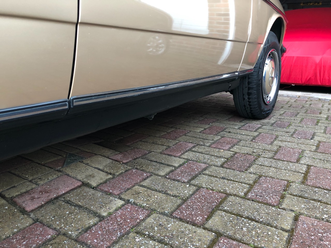

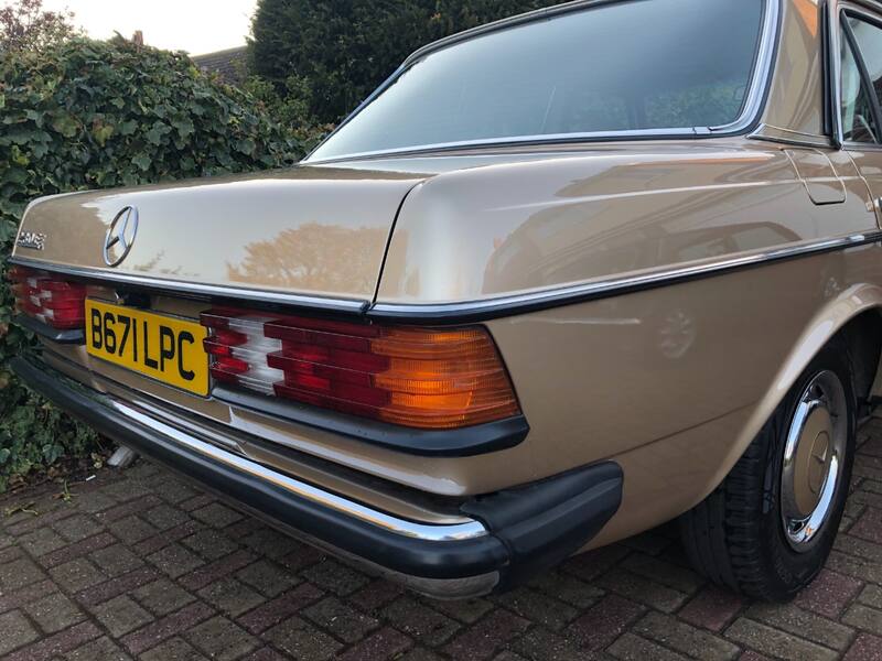

nacho man Posted March 10, 2021 Author Posted March 10, 2021 Picked this up this evening after work. Happy with how it’s looking now. In the end both sides and the boot were done. Might as well have the bonnet done now and it will be mintola. No more pics as two mins later it pissed it down and then got dark. Still awaiting the other side rear arch trim, there going to put it on once it’s delivered. Not sure what to do with it now really. Want to take it on some major road trip when we can. But also I actually enquired about parting it off to a fancy classic car place to sell, who seem to reckon they can sell it for a good wedge. But one of them wanted £1800 to sell it and the other a minimum of £2500. Was ace to drive it back. I just love bombing about in it. Sent from my iPhone using Tapatalk RobT, Royale80, Low Horatio gearbox and 12 others 15
cort16 Posted March 10, 2021 Posted March 10, 2021 It looks great now. How's the colour match against the original panels? Friggin nora £2500 quid! Have you thought about Chris Harris's collectable car auction site? https://collectingcars.com/
nacho man Posted March 10, 2021 Author Posted March 10, 2021 The match is pretty good will give it a good clean weekend and have a proper look. The bonnet looked slightly off but that’s the last big panel left not done apart from the roof. However that’s not original paint on the bonnet either. But then when I got it outside you couldn’t really tell. Might give it a go on one of them sites, but might also keep it and use it all over summer. Burnside 1

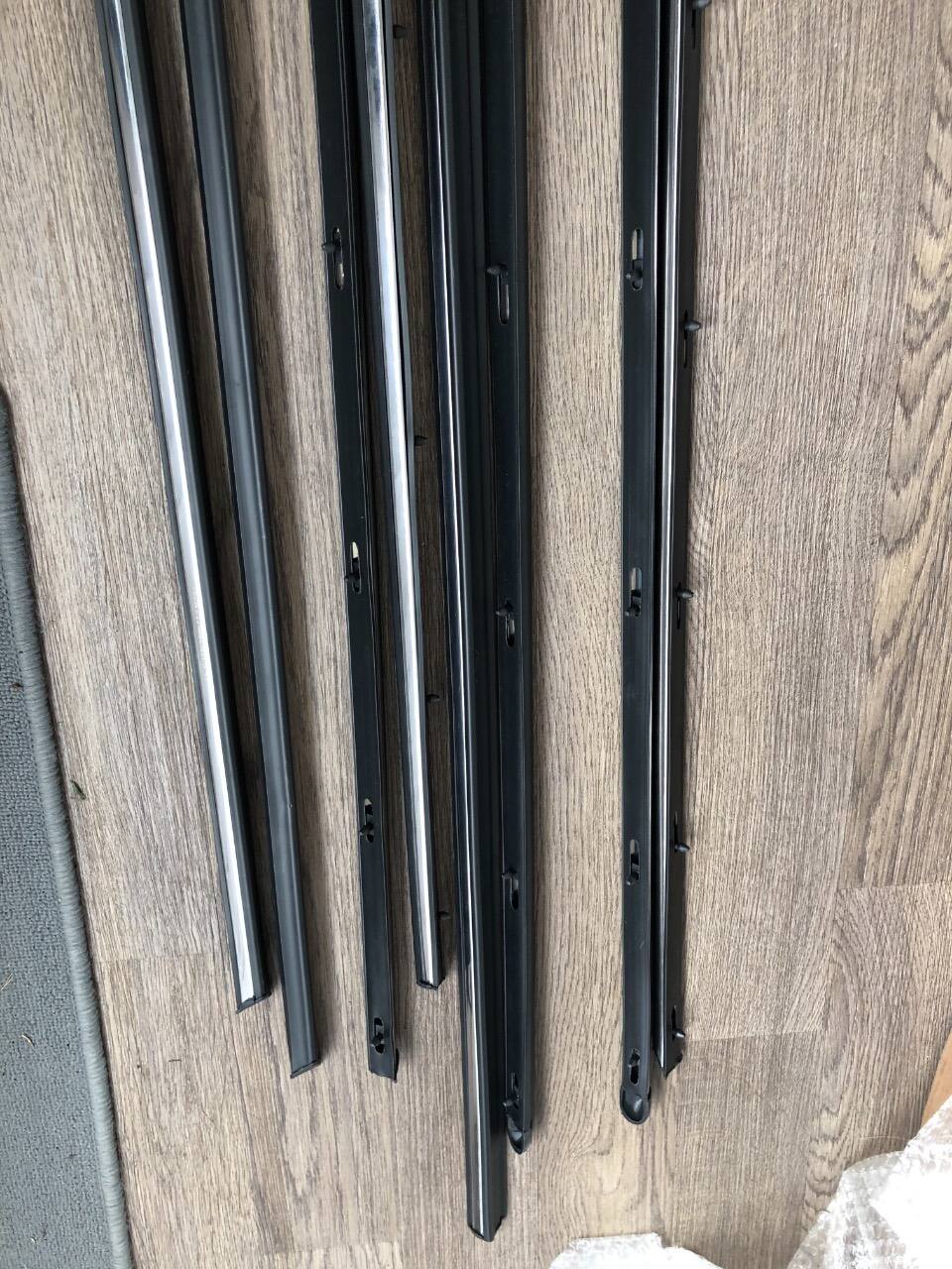

nacho man Posted April 10, 2021 Author Posted April 10, 2021 This is back at the painters having the bonnet done, so it’s basically all been going to be painted now bar the roof. Also my trims I got from Turkey turned out to be a bob on fit. Which was a nice surprise, thought they would be shite. I mean they took 7 weeks to turn up, but beggars can’t be chooses. It’s also started blowing from the downpipe. So ordered two as they come in two bits, and two fitting kits so it will have pretty much a new system apart from the manifold. From eBay and from a company called bm catalysts, so will see how many miles they are off when I come to fit them. They were cheap though. Shite Ron and Burnside 2
