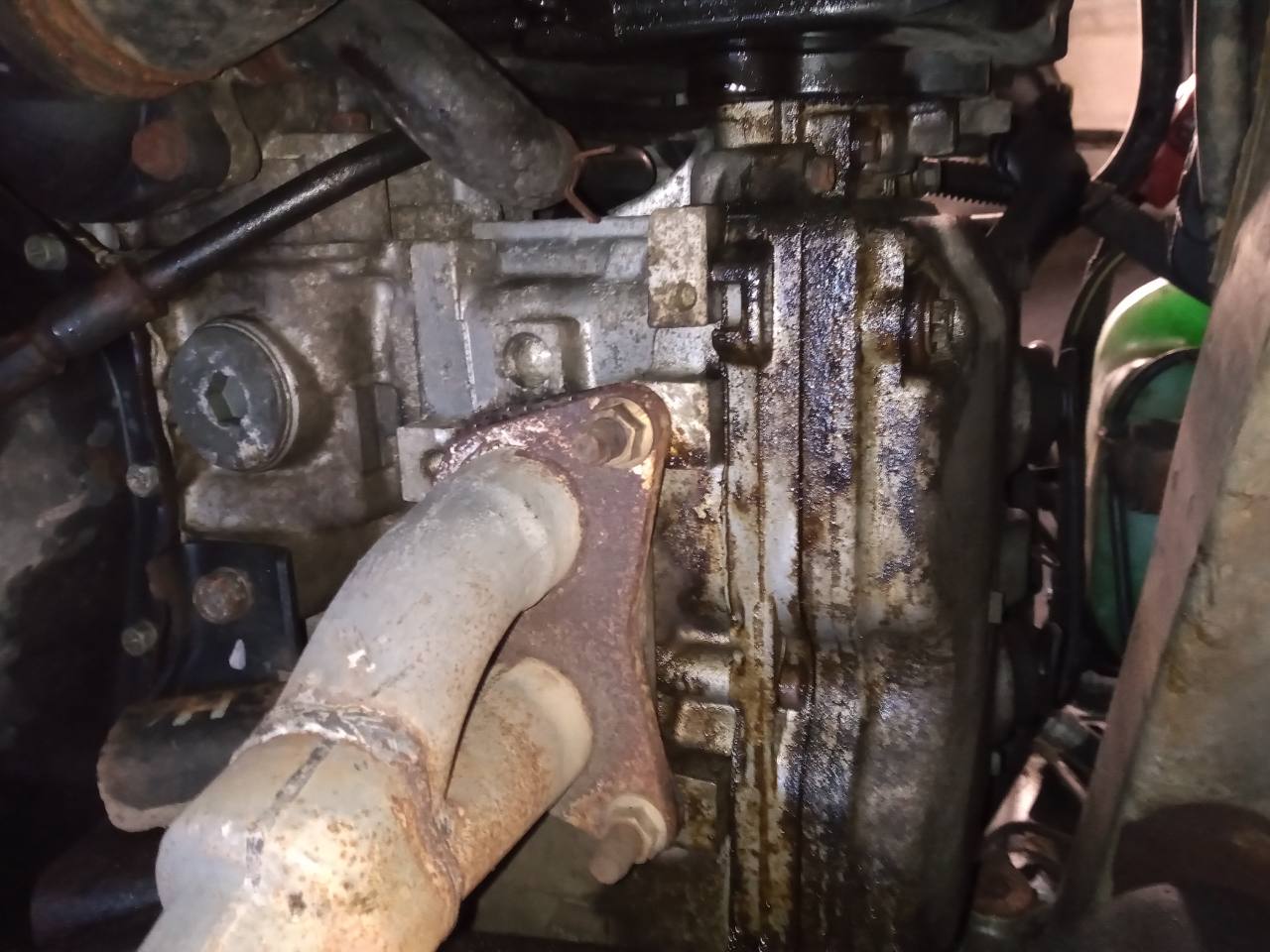

Whilst I was scrabbling about under the car I noticed a bit of oil leakage, the rocker covers need attention soon but there is also oil coming for what I think is the rear main seal, not looking forward to that job!

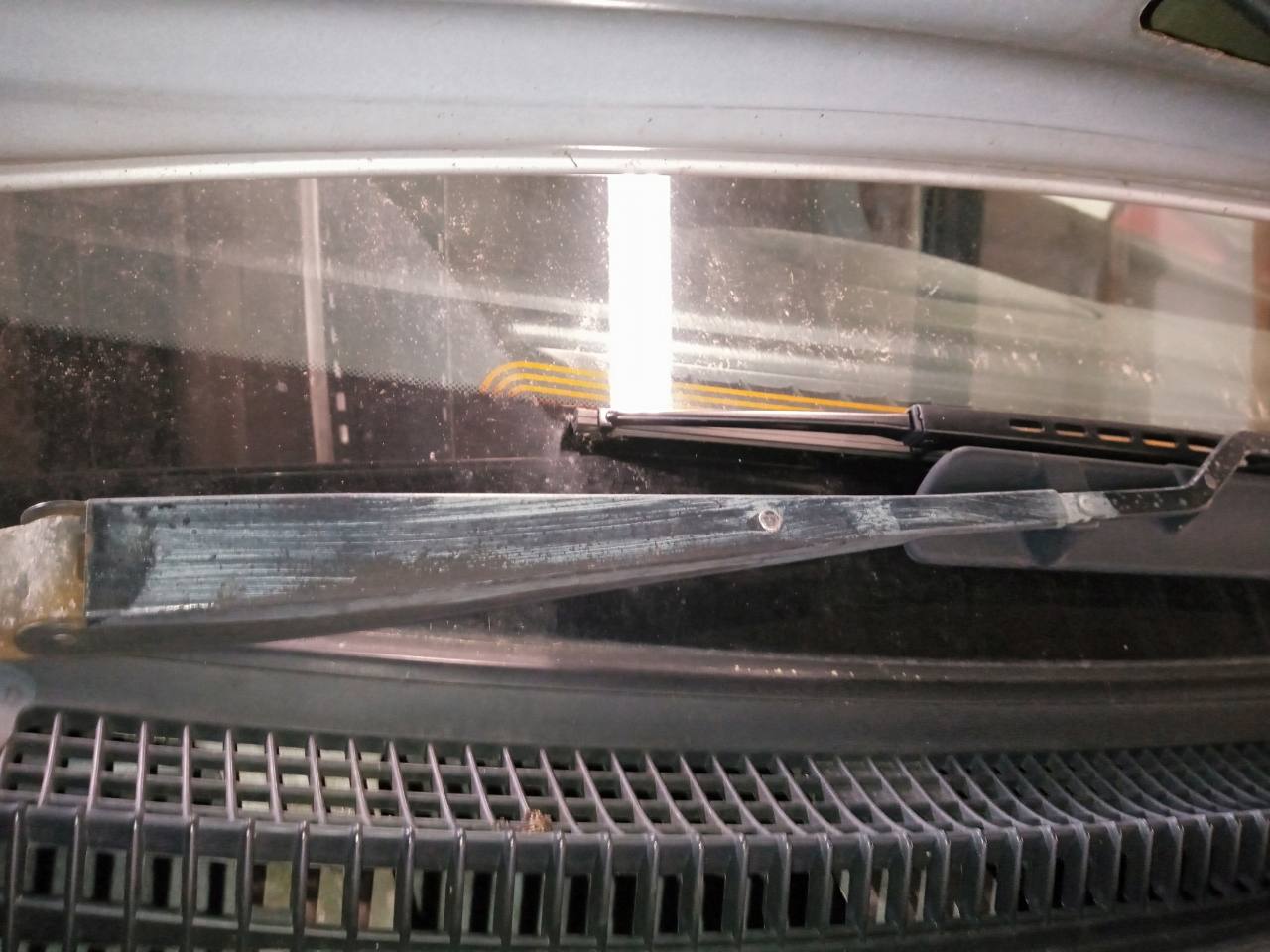

Second oddity it has heating elements on the windscreen to unfreeze the wipers....
You don't see that everyday do you!

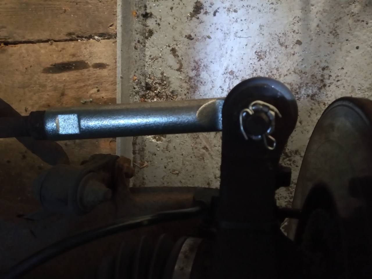

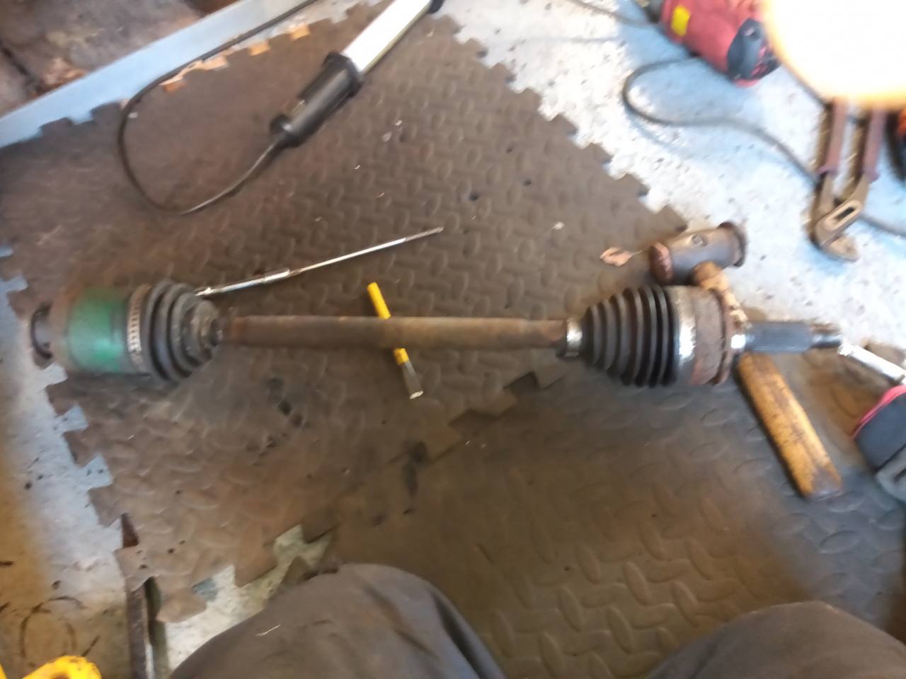

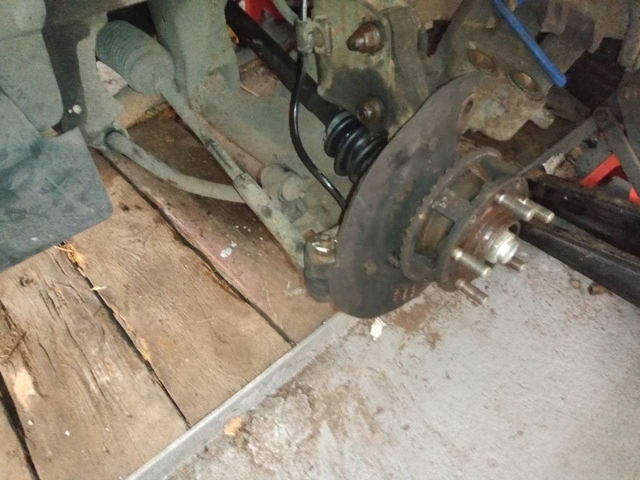

Carrying on from yesterday, I spotted that one of the drive shaft boots on the other side had a small split. So as the car is incapacitated I decided to get down and dirty and tackle it.  Firstly dugga dugga gun off the hub  nut, strip off the brakes, pop the steering ball joint out of the hub...... Sorry hang on, actually mash the split pin so you can get a socket over the nut, then use the dugga dugga gun to get the nut off, then hammer the arm so it releases its vice like grip on the ball joint, then it pops out!
After that the bolts holding the hub to the strut were easy apart from on of the bolts deciding to weld it self to the socket on the end of the gun, its currently soaking in oil and maybe I will be able to hammer it off later.
Then scrabble under neath and knock out the roll pin that holds the drive shaft to the diff and wiggle it out, hey presto...
Sorry about the lack of focus!  After that I went to measure the boot as there are a couple of options, only to discover that my vernier calipers have run out of batteries and I don't have a spare. I think that will do for today because I have wall paper stripping duties to attend to...........

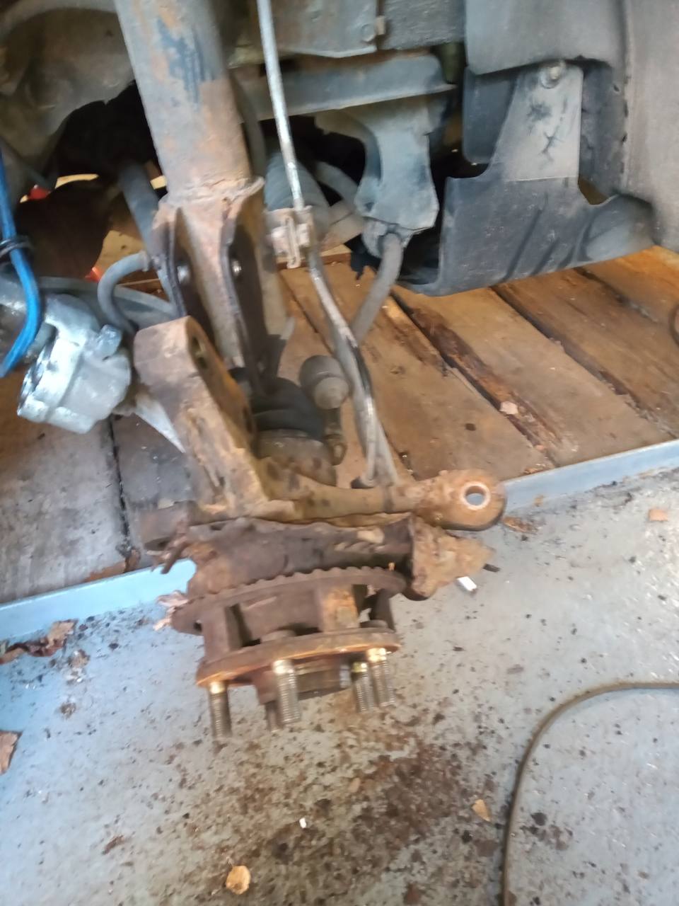

well like a lot of things this job escalated a tad... once I had the newly refreshed hub back (from having the bearing pressed in) I compared it to the supposed good side. At this point I realised that I really needed to replace that bearing as well.  So off came the hub which as its a bit older and mankier than the other side was given an oil bath to help release the bolt for the ball joint.

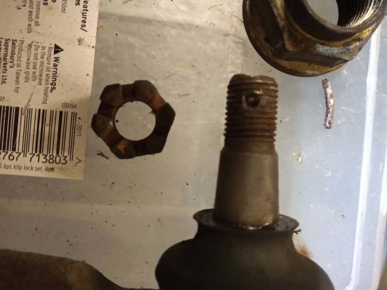

After a 24hr bath I managed to get the ball joint bolt out, without it shearing (a common problem on these). Then I sent it off for a new bearing and ball joint. About a week later i got it back and thought I will throw it all back together, easy..... Errr no, firstly on refitting one of the track rod ends I found that under no circumstances would the remains of the split pin come out of the shaft, I even tried drilling it out, no dice!

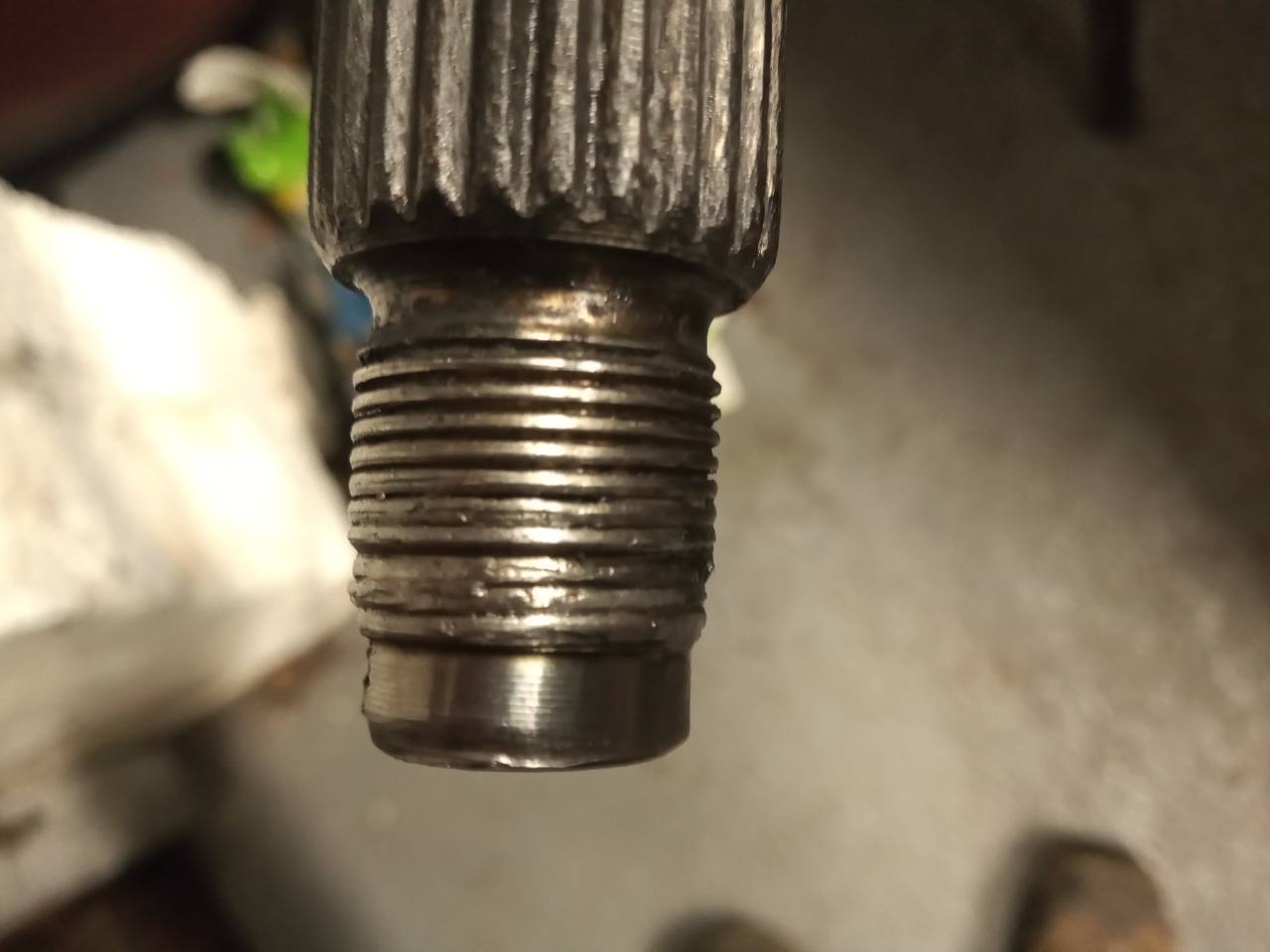

Then I noticed a more expensive issue were I had gunned off the hub nut on the drivers side the thread on the drive shaft end had been damaged and couldn't be repaired. So a new CV joint was required....

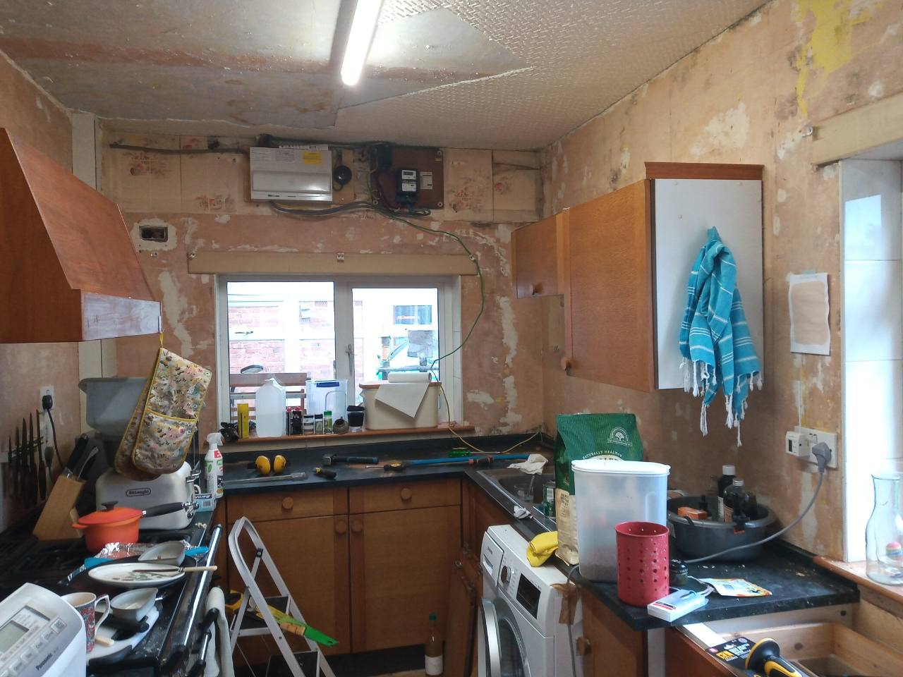

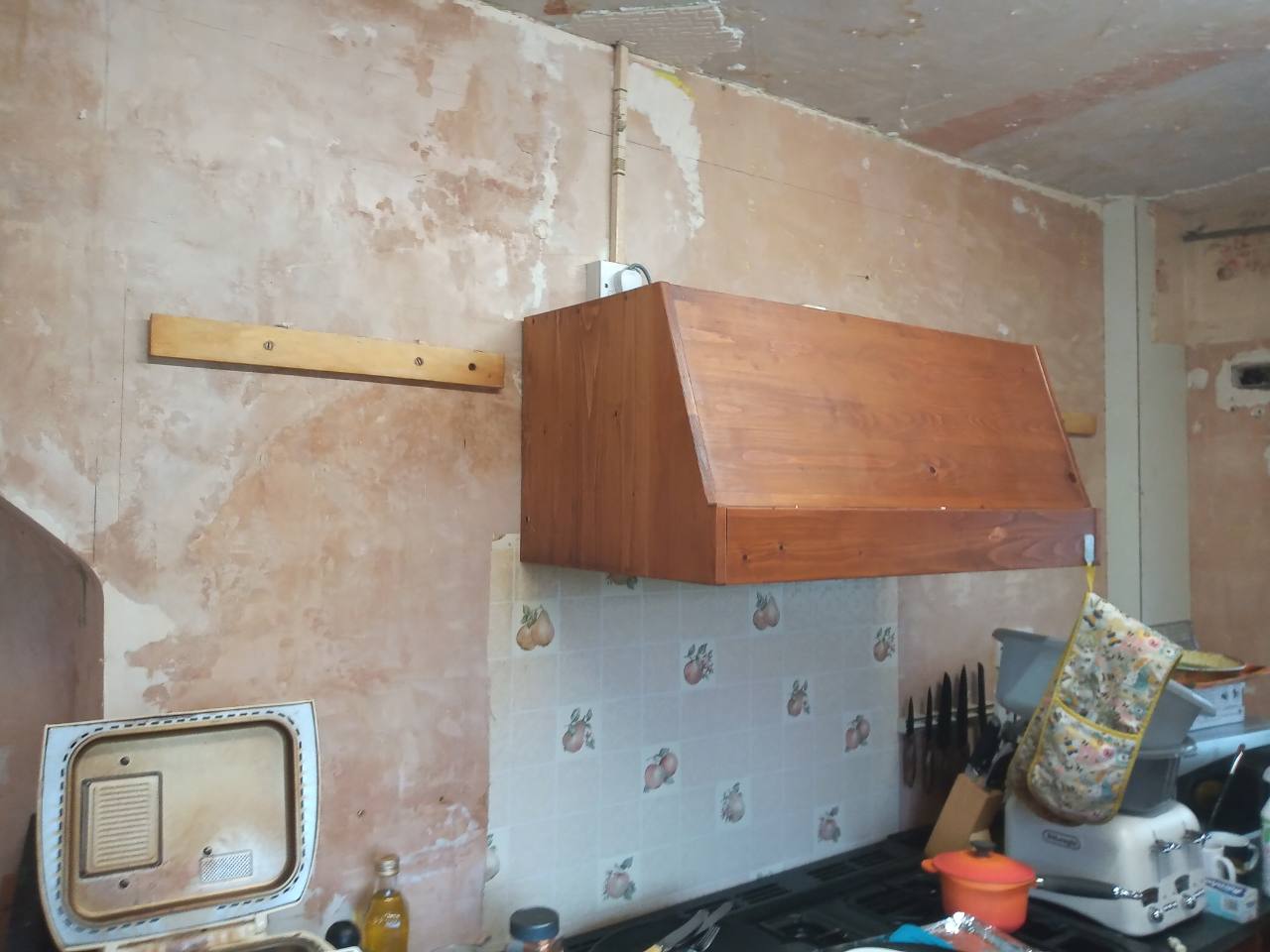

so back to the house bashing whilst I waited for the postie to deliver.......
My poor kitchen! Well it will look great when we are finished, hopefully.

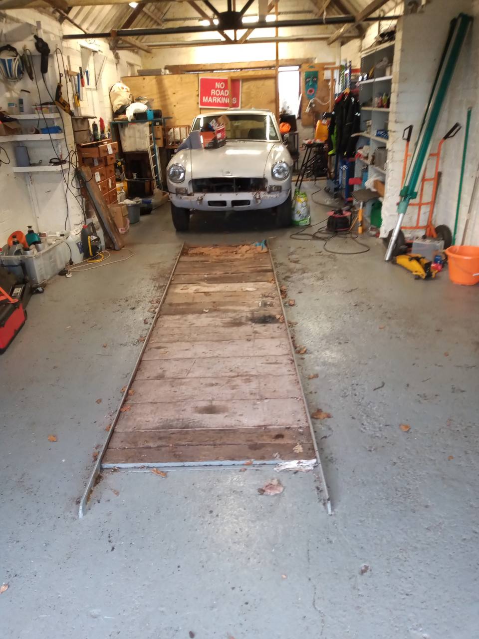

A bit of a change of pace now did I mention my garage has a pit, a fucking pit!!! wooo and indeed hoooooo  (this is a massive improvement for me as my last garage was a pop up Clarke one which was always the wrong temperature and held the damp in) but there is a slight issue....

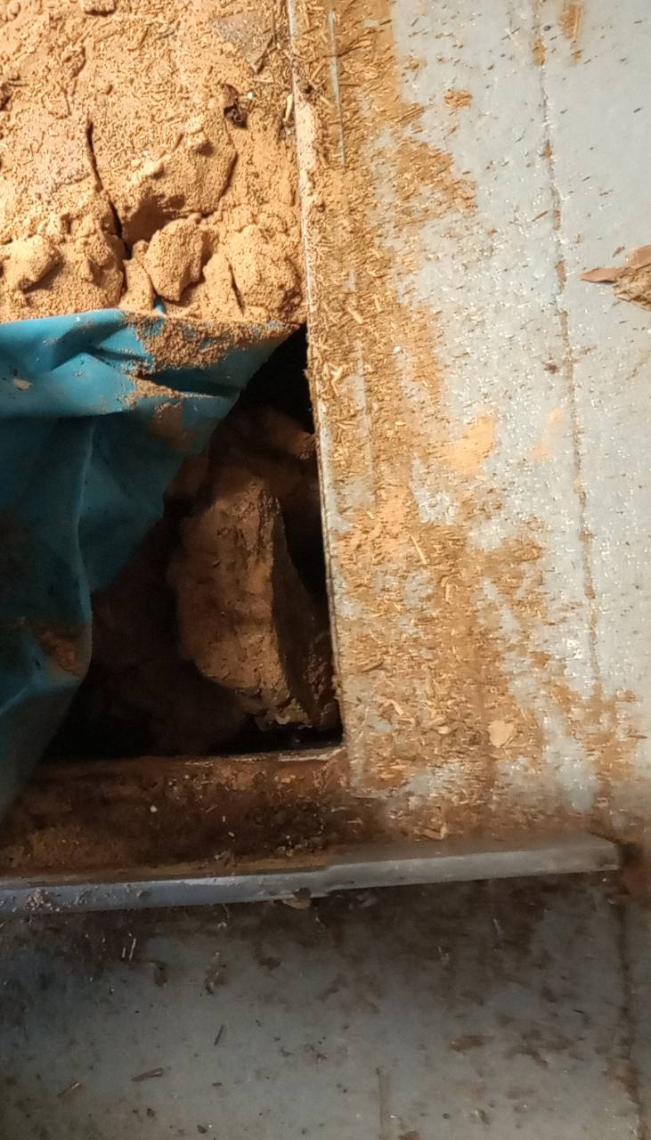

When the Husband of the previous owner passed away the pit was filled in for safety.  Actually that isn't the only issue if you are working over the pit area you are rather restricted on were you can put axle stands, which wouldn't really be an issue of you could work from in the pit! how they filled the area in is a bit quirky, when I pulled up the boards I found this.
Initially I thought it had been filled with sand which would be an utter ball ache to dig out, until I noticed what looks like pond liner. When you lift the pond liner it reveals chunks of rubble underneath, so the sand is just to create a smooth surface.
I would love to crack on and get all this dug out but first I need to replace all the boarding as its ropey and rotten I had some planks lying around but that only gave me enough wood to  replace 2 boards. I am probably going to end up buying a load of planks unless any one can advise me of a more modern/cost effective way of safely covering a pit?

Doesn't look very wide, scaffolding board?
