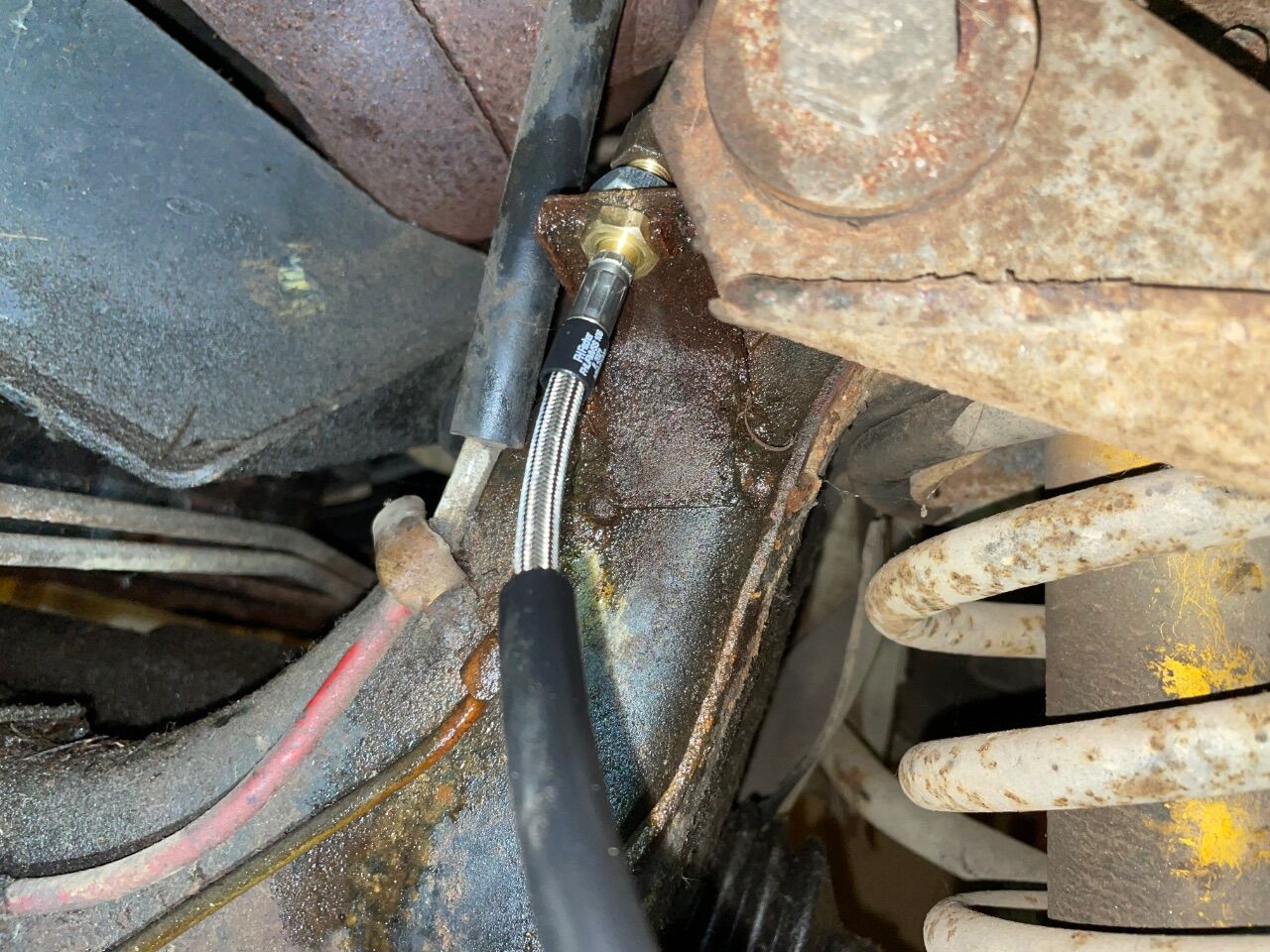

Not wanting to disassemble and reassemble the drum brakes again I have filed that particular job under “L” for Later and moved on to the fronts.
Flexis first, and during which I found another brake line that wasn’t too clever looking. I was just about to ignore it when I came over all productive and decided I’d flex my new brake line mending skills once more.
The suspect bit is in that photo above somewhere. It’s part of quite a long run across the subframe. Annoyingly once off it actually looked alright.
Nevertheless, I’ve come this far; I am Bender, please insert girder brake line.
Once reinstalled to the car it was looking much better.

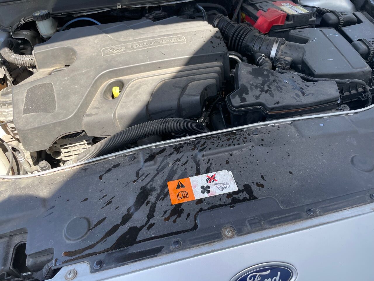

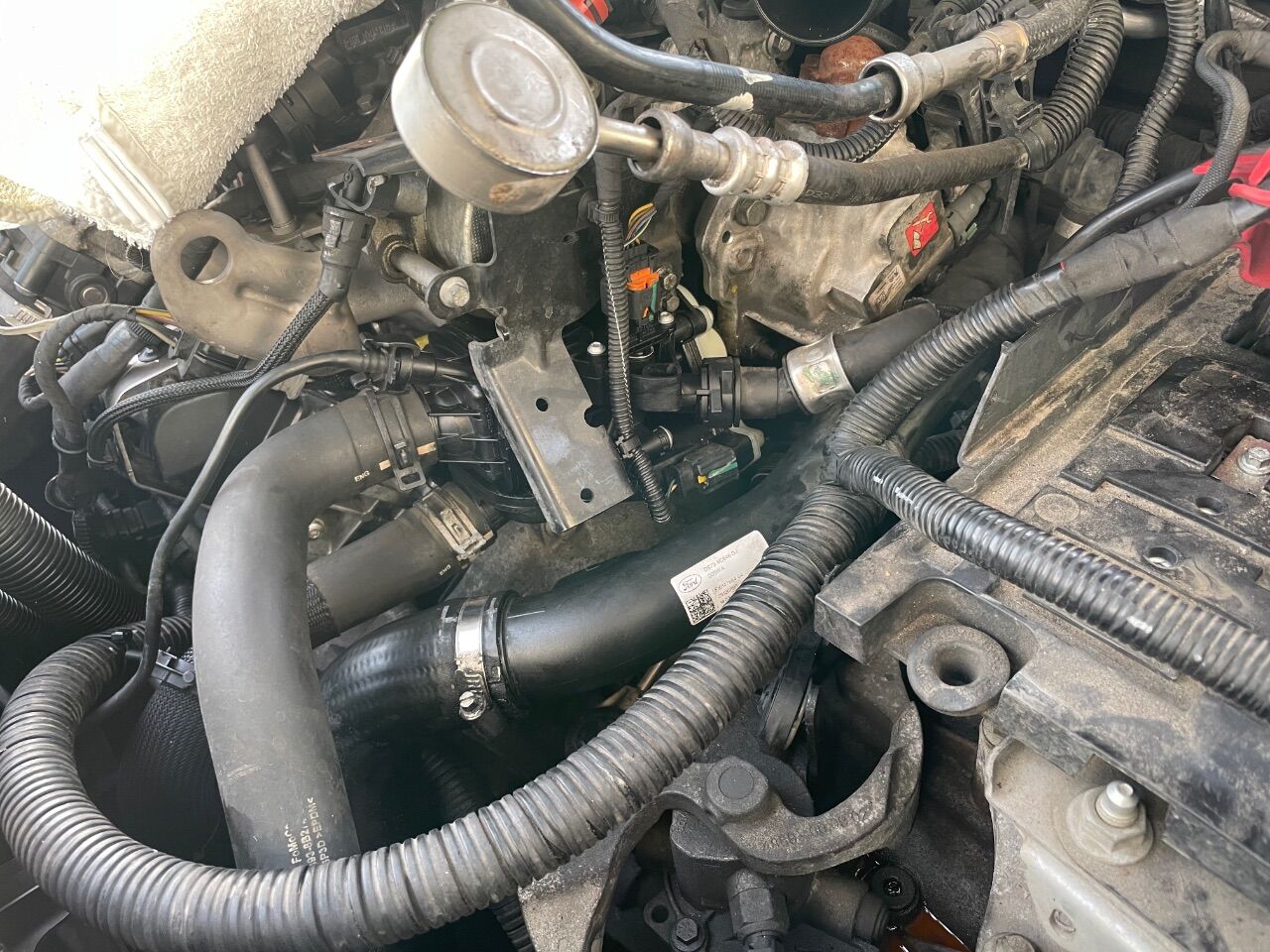

The Mondeo exploded. During a really hot spell in May. The thermostat housing literally split in two!
As this is our “dependable” family transport I had to quite quickly sort this, which took longer and cost more than I’d hoped. Being a “Modern” the thermostat is quite complicated, read expensive, and buried quite deep in engine bay.
But it was just a case of undo stuff, remove stuff, get stuff out of the way.
The cylinder head looks a bit pitted, so I tried to clean it up with some wet and dry emery and in the end I used a bit of Hylomar Blue on the new seal. The photo makes the pitting look worse than it feels by hand.
With regards to why it exploded; Best not to think about it. But, when dismantling, the lower of the two electrical connectors was undone, so that or age or that and age could have been why it did it. For now though, everything seems to work. Here is the barge dwarfing an admittedly large XM.

The 2nd most annoying ftp I've ever had was when the plastic stat housing split on my Ford Puma at asda when the ex was heavily pregnant.
Drove there fine. We went shopping, came back and the coolant was noticeable from several rows away as it ran down the car park, and when we followed it it led to the Puma. Seems they all do that sir
Got it recovered to mums driveway eventually and got a new stat housing a few days later. Fitting it was a right twat involving removing the drivers headlight for the most access. It was rhe job that made me buy the fancy locking hose clamp pliers I've used maybe 4 times since.
