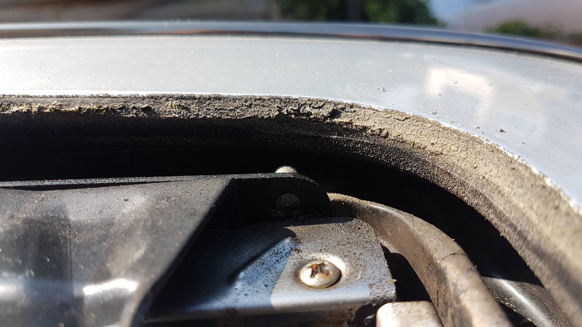

the seal around the edge of the apeture was covered in dirt, moss and grim detritus, some gentle washing with some hot water, fairy liquid and a cloth got it back to the flock, what I do is leave it to dry fully and then soak with silicon spray and leave it, 20200411_120251.thumb.jpg.294512b5f2863279350924d2cfe8fc6e.jpg

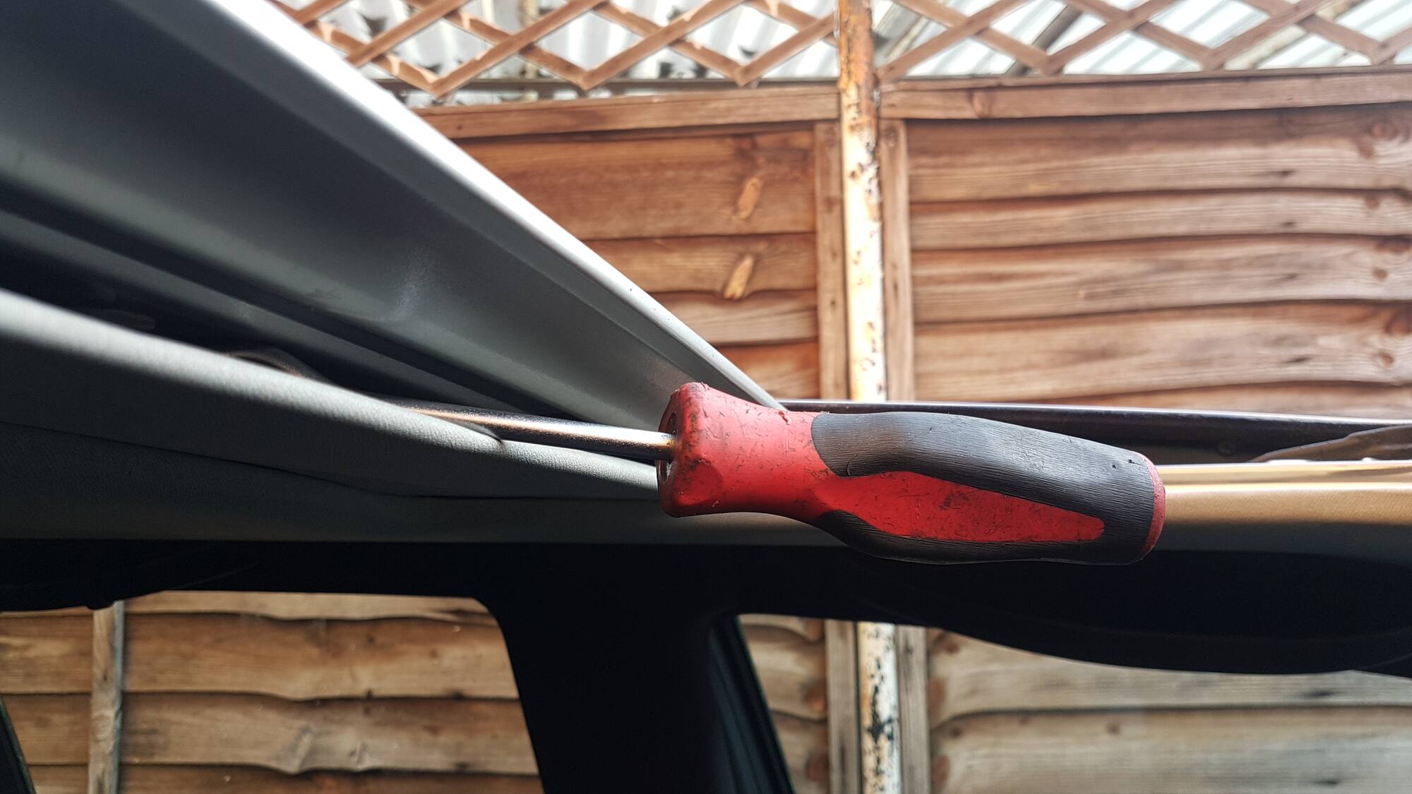

On strip down I found dirty old grease as suspected,  this was all removed and new grease was applied,

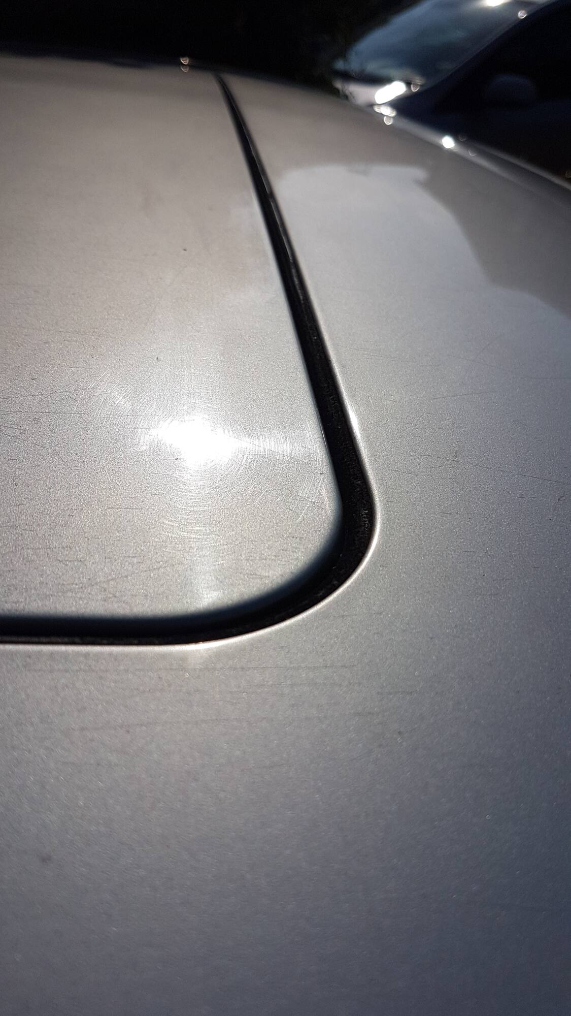

the edge of the sunroof panel was filthy so some fast cut polish was used to clean it up, this has two purposes,  one to get rid of the dirt and two it smoothes the paintwork which should help reduce any sliding resistance,

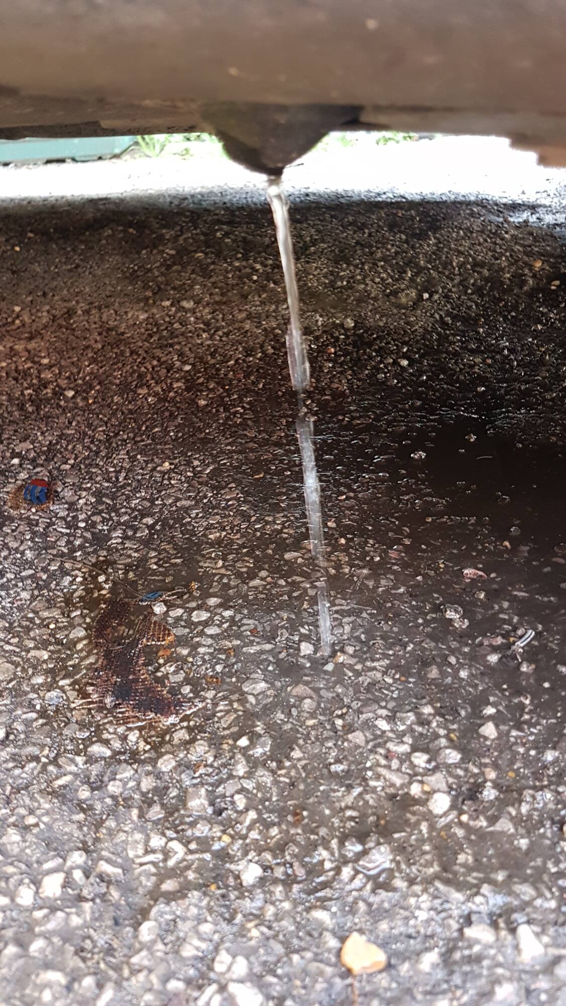

A good test of the drainage system on ff is to open the sunroof and pour some water into the side drain and see what comes out the bottom,  warning pour the water slowly or you will flood the drainage system with water and end up with it cascading into your car,
If all is good your car will have a little wee
20200411_130406.thumb.jpg.7e31618c2fac87e14d4e03b5c8833e4d.jpg20200411_130332.thumb.jpg.c0218189d49ad2284a40a71051f1f638.jpg
turns out that I've been lucky with the front drains on the Merc, the car was facing downwards on the driveway so I will test the rear ones tomorrow but I'm sure they are okay,

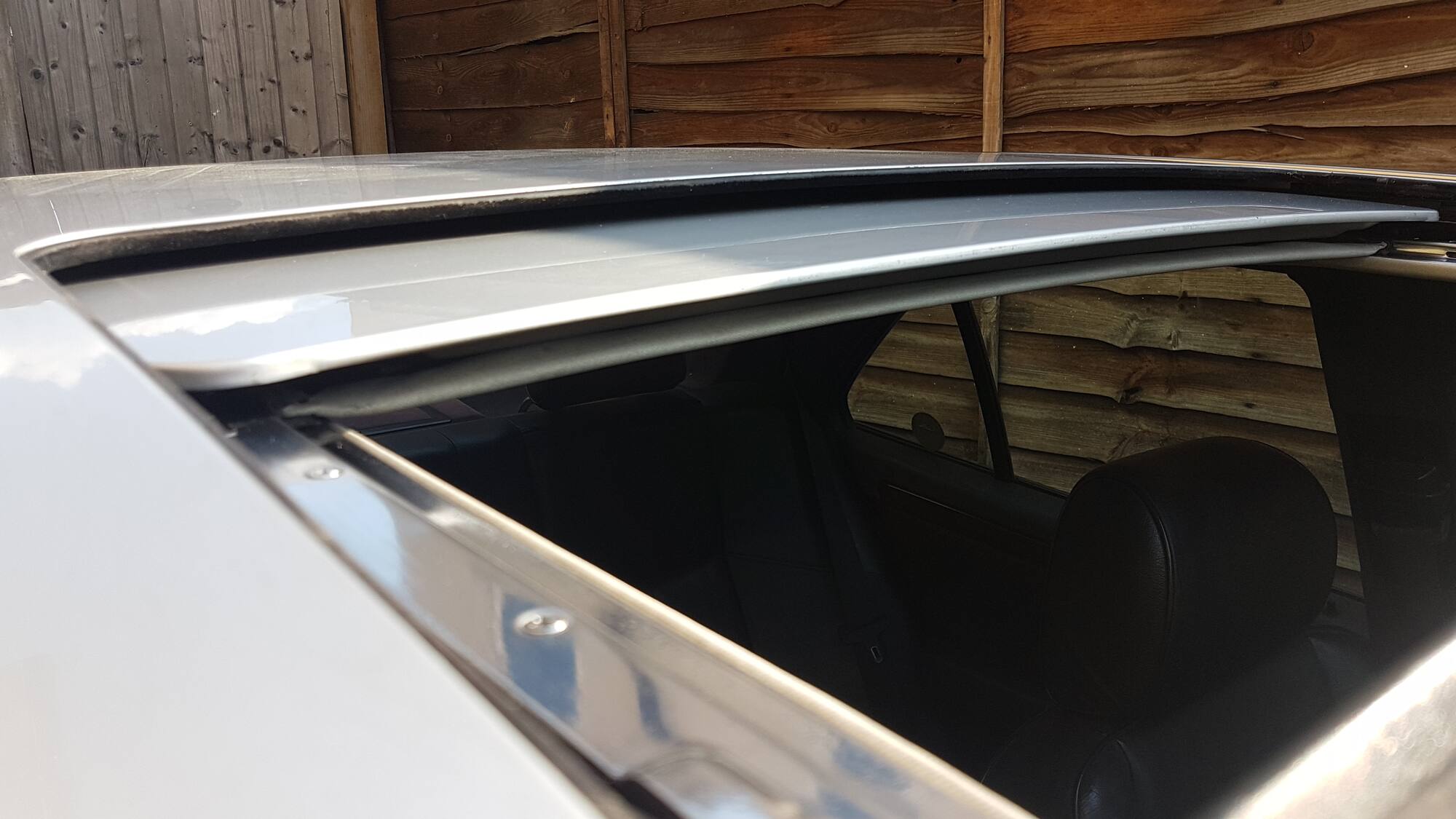

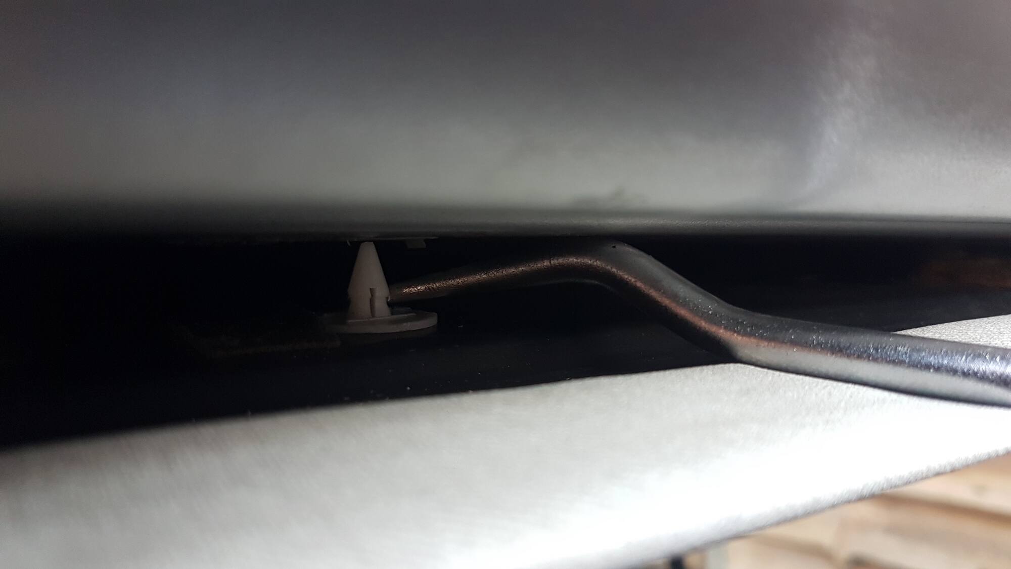

That's why I had to sort this one out on the Merc,  it was functioning but rather slow and I could hear the motor straining a bit, I cleaned everything, greased parts that needed it and sprayed all of the side mechanisms with silicone then put it all back together,  the panel itself simply bolts onto the mechanisms, access to the mechanisms is gained by sliding the inner trim panel back out of the way,
20200411_184935.thumb.jpg.21ce0b971af96e4fa8202ebfa2d3f8cb.jpg20200411_185147.thumb.jpg.7634e3490f4a0ede45cec481079ad069.jpgthree 8mm nuts and one screw each side then the panel can be taken away, it's really quite simple, it also helps that this era Merc has decent quality fixings,
The sunroof now slides freely and is quieter so I'm happy with the results of today's work, plus I properly topped up my Vitamin D levels,
