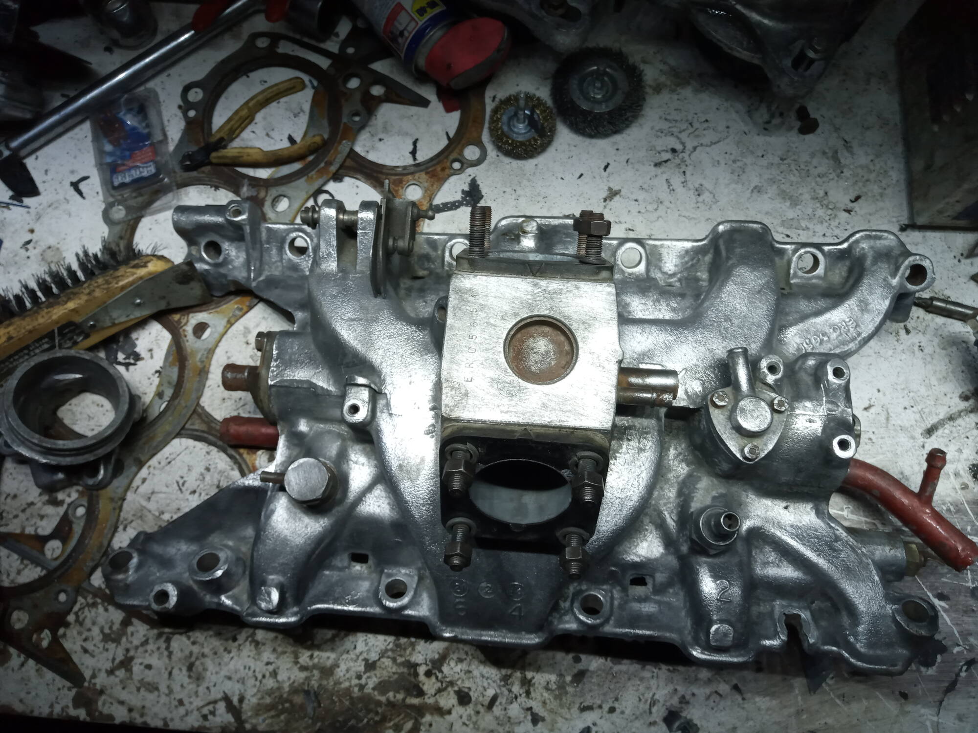

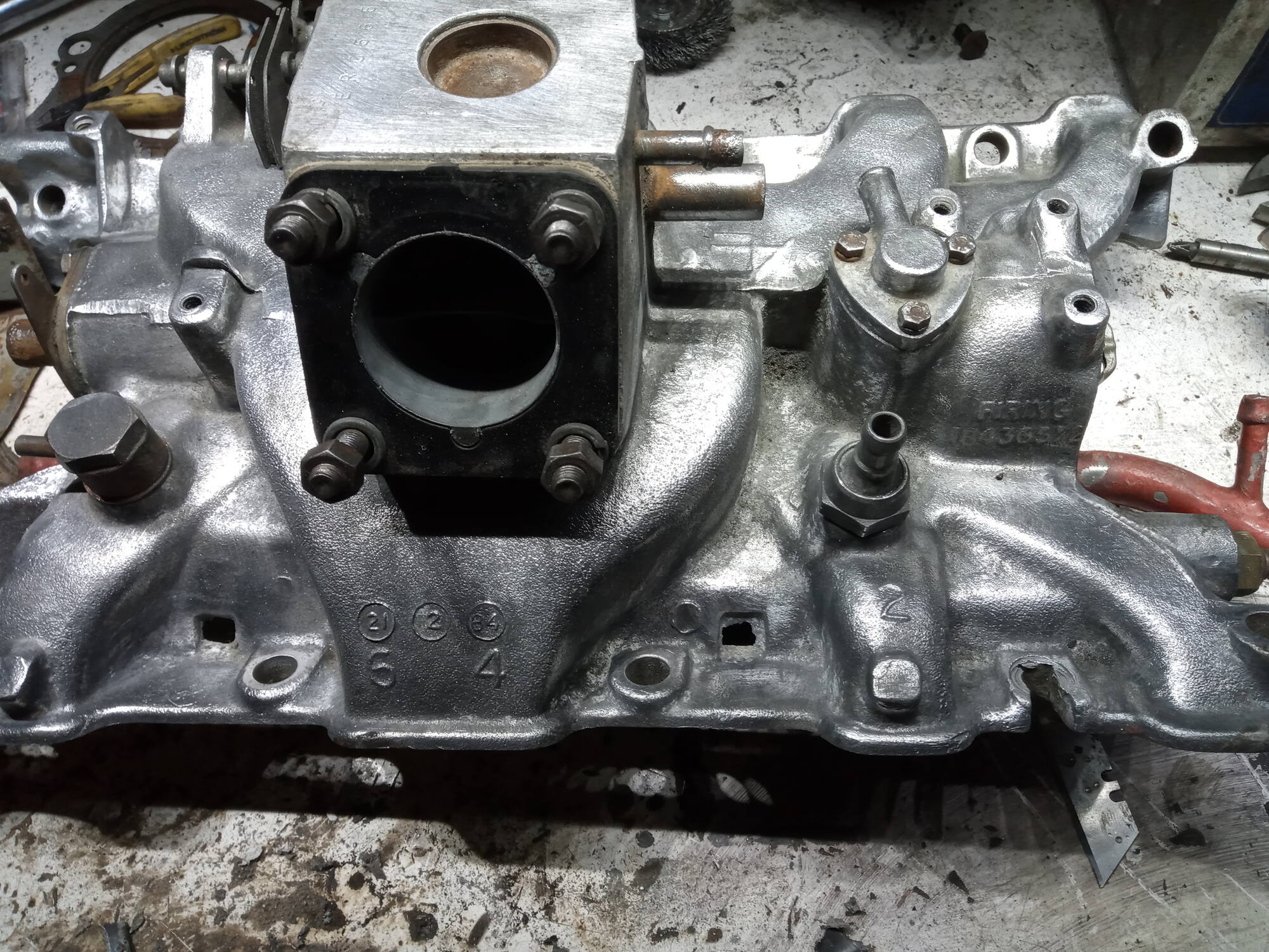

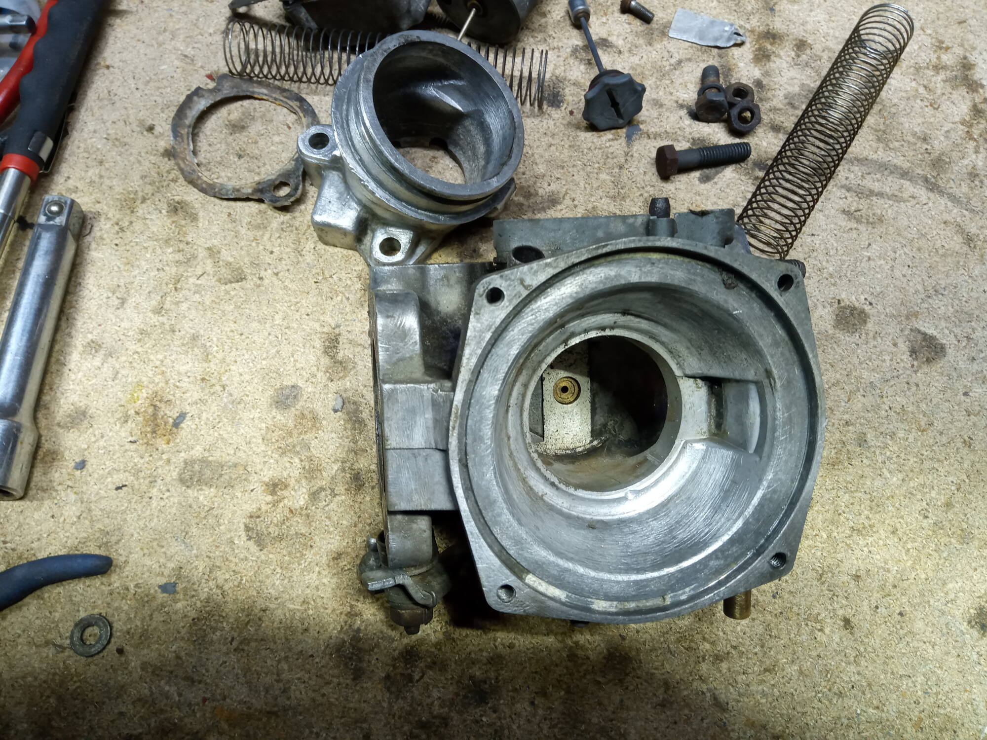

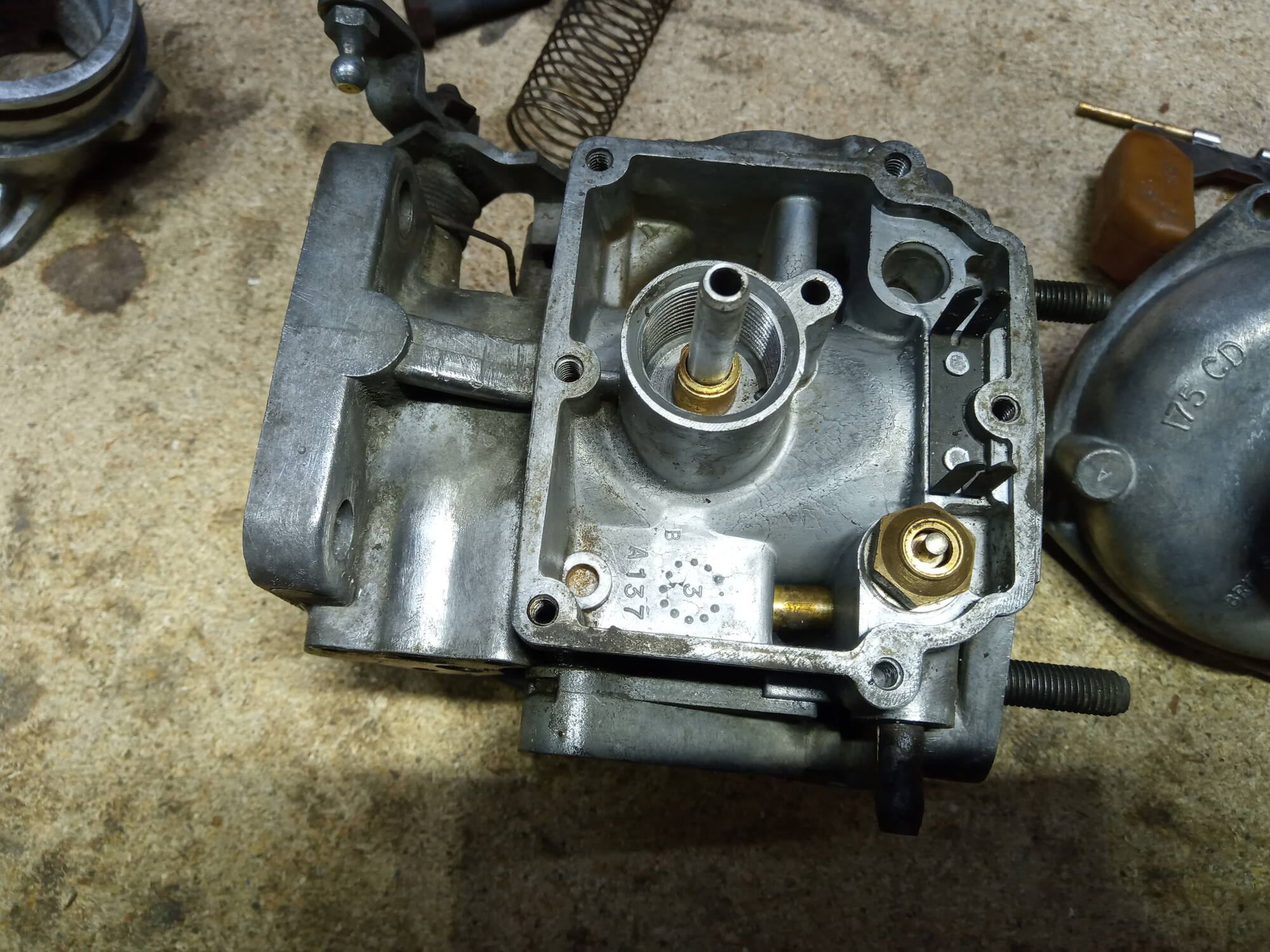

PhilMcCrakin Posted January 5, 2020 Author Posted January 5, 2020 On 1/3/2020 at 1:06 PM, Jikovron said: This is the worst restrictor I've found in these so far, 5 8mm holes through an inch thick bung That's crazy I've never seen that before. But that is more to do with me always buying engines and fitting the 4 barrel holly kits on them.

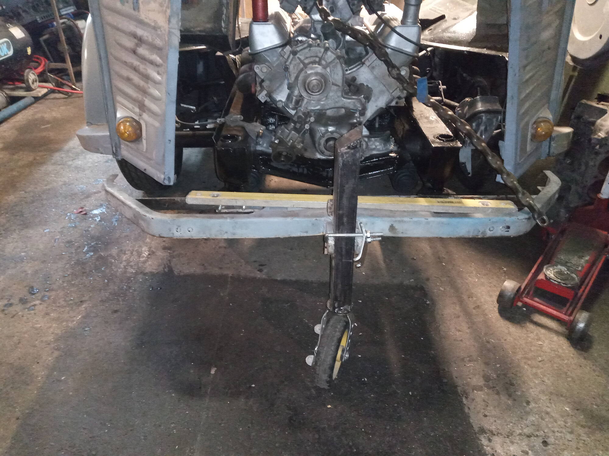

PhilMcCrakin Posted January 28, 2020 Author Posted January 28, 2020 Hello all, It's been a while since my last post on the van but work is progressing nicely. I still haven't done anything with the brakes as yet. Well I tried however as the front clip/chassis has no weight in it I was unable to undo the 38mm hub nuts. Tried impact gun no joy so tried a huge lever bar but all that did was flip the chassis over and led to a lump on my head and grazed knuckles. So I've moved on to other jobs. Engine assembled now I'm going to stick with the solex175 carbs for now, will fit the efi head and lpg system later on. I found what looked like a silk nest inside the carbs, cleaned and scrubbed all perishables replaced. Still missing a few bits but will source these later. Jim Bell, mat_the_cat and Tickman 3

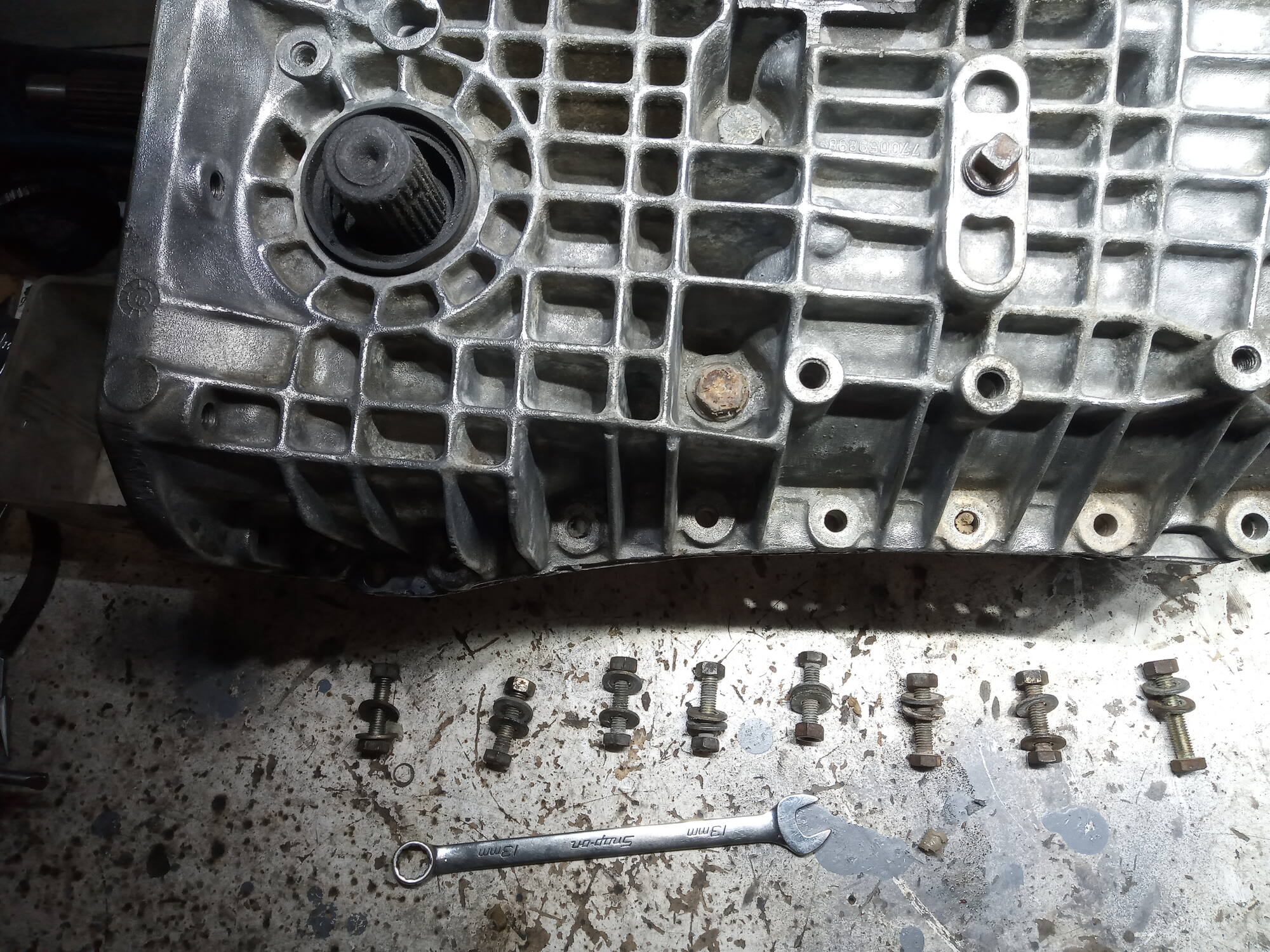

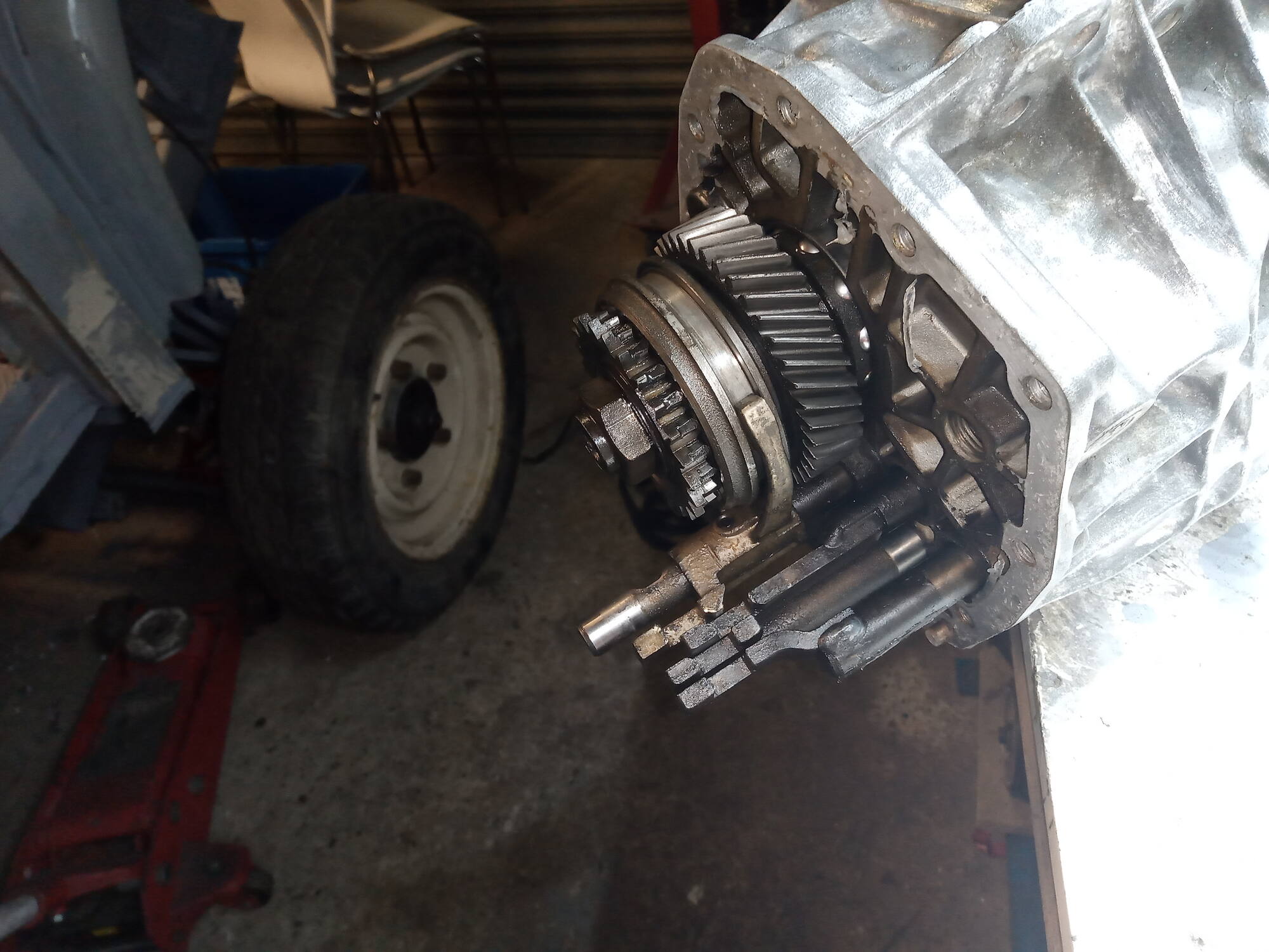

PhilMcCrakin Posted January 28, 2020 Author Posted January 28, 2020 Once done I moved onto the gearbox, I cleaned and scrubbed and brass brushed the outer casing. When I open it up I found that the last person to abuse it had used bathroom silicon to seal the two halves together so further internal cleaning was needed. I have mostly put it back together and torq'd all the bolts but I am struggling to get the selector box back on the rear. I can't work out which gears are which or how to get it to align back on. I found a UN1 Lotus esprit rebuild manual but this is for the un1 025/026. See pics below 4th, 5th, 6th and seventh images are of the forks and the selector. I'm loath to take it to a gearbox place (ridiculous I know) more because it is so rare and parts are a B***h to get hold of. I looked up renault 21 turbo on how many left .com and out of all the cars sold in the uk only 23 are still on the road with 121 sorn at the moment. Jim Bell and Tickman 2
PhilMcCrakin Posted January 28, 2020 Author Posted January 28, 2020 I've also just this minute noticed another problem with the bell housing in picture one. it looks like some bits have broken off not even sure what those bits are for. Does the clutch release arm and bearing fit in there. (oh arsebiscuits something else to do) Jim Bell 1

Stinkwheel Posted January 28, 2020 Posted January 28, 2020 That does look suspiciously like it should be the mounting for the clutch release fork. Sent from my iPhone using Tapatalk
PhilMcCrakin Posted January 28, 2020 Author Posted January 28, 2020 7 minutes ago, Stinkwheel said: That does look suspiciously like it should be the mounting for the clutch release fork. I think they are (he says sobbing into a cup of tea). Looks like I'm going to have to get the bell housing brazed/welded as well now.

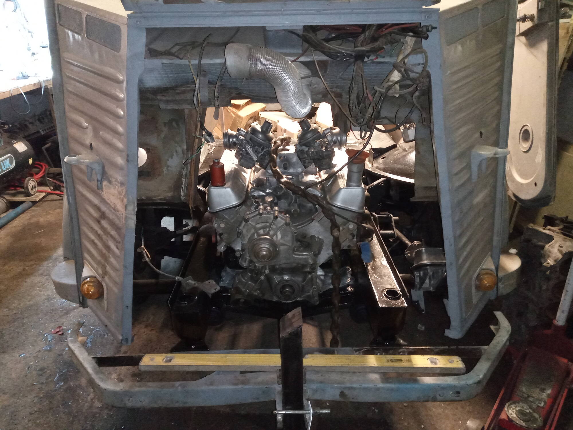

PhilMcCrakin Posted February 1, 2020 Author Posted February 1, 2020 Progress has been made, huzzzah! Gearbox is off being repaired. I've got the chassis back on the van and a V8 (partially built) in a very tight position. Going to start making exhaust manifolds next week. Tickman, mat_the_cat, LightBulbFun and 1 other 4

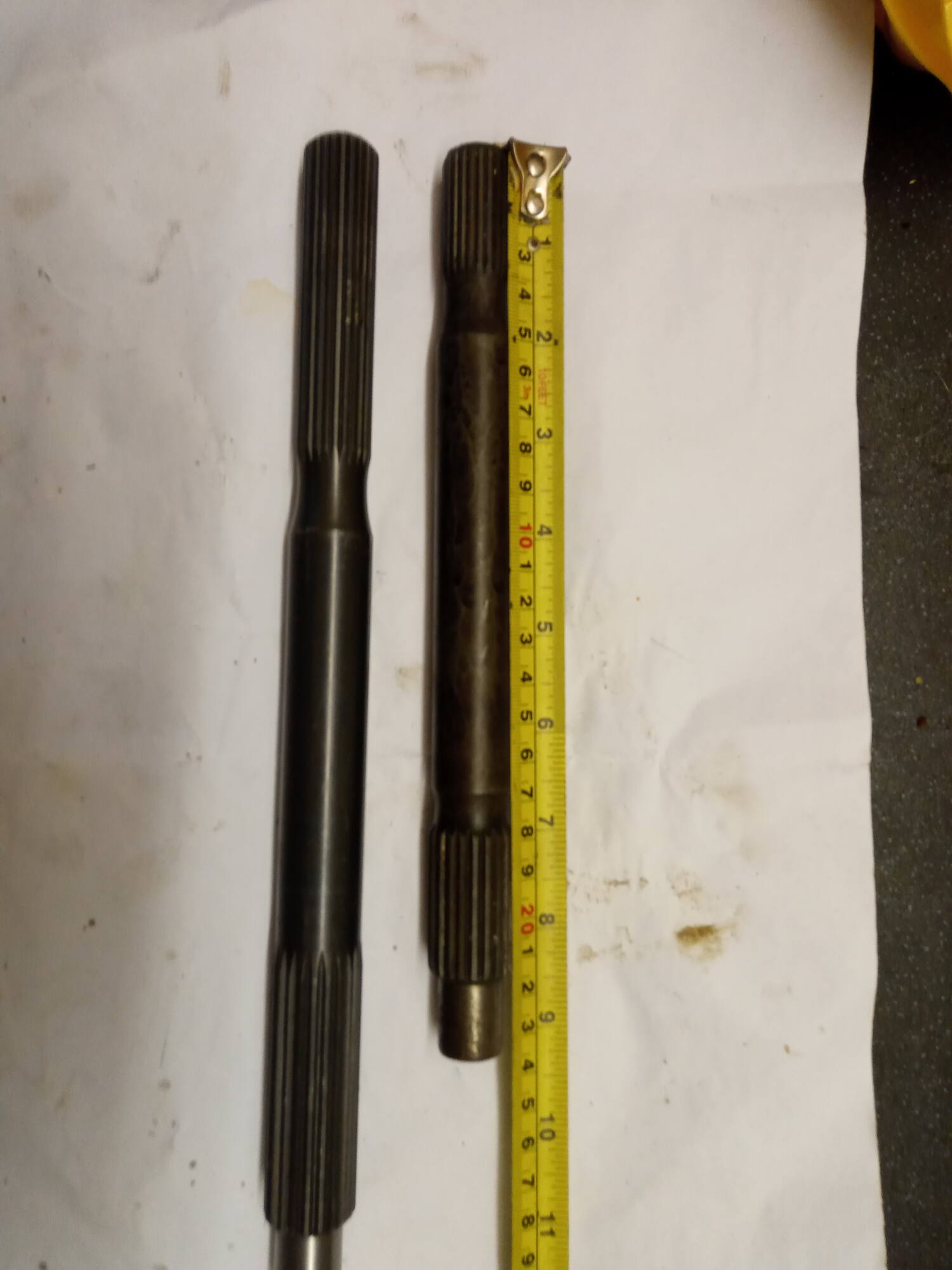

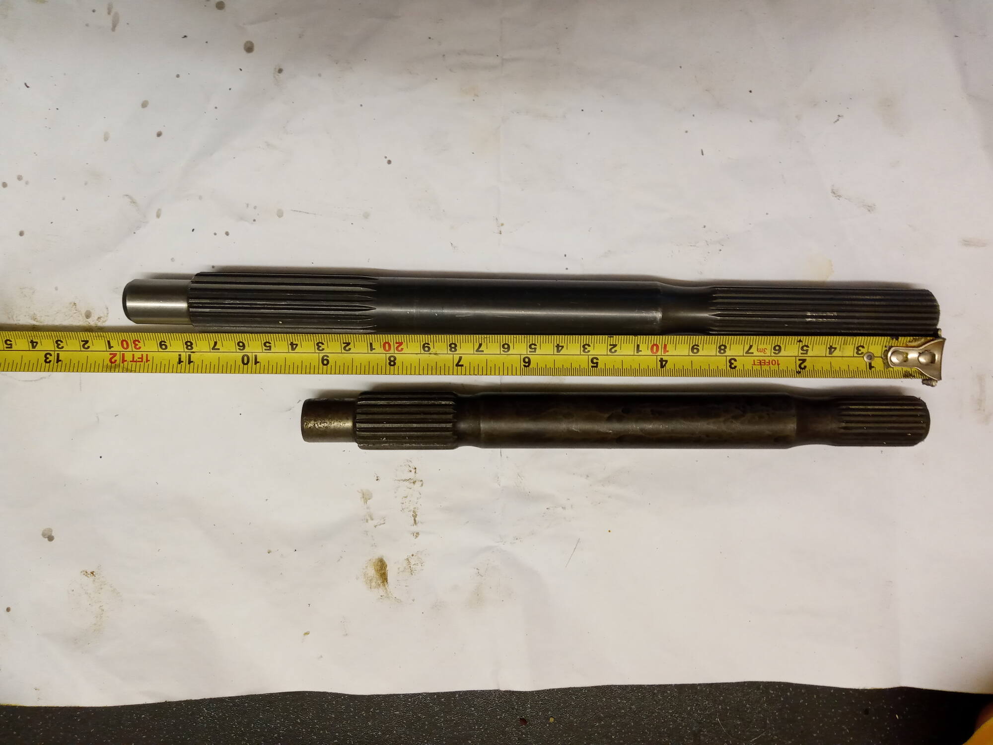

PhilMcCrakin Posted February 1, 2020 Author Posted February 1, 2020 Renault UN1 Gearbox input shaft for the V8. the difference in size to make up the gap created by the adaptor plate.
