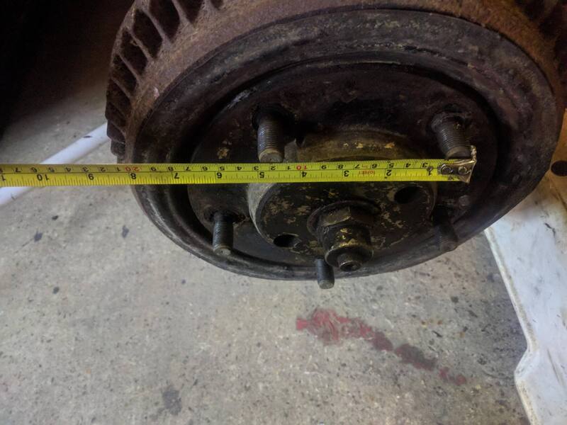

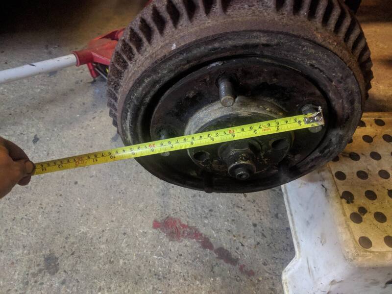

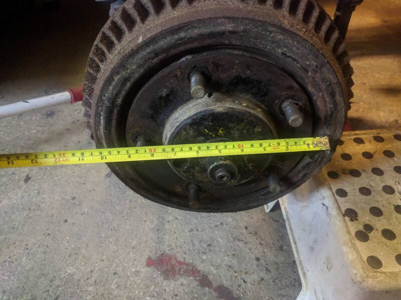

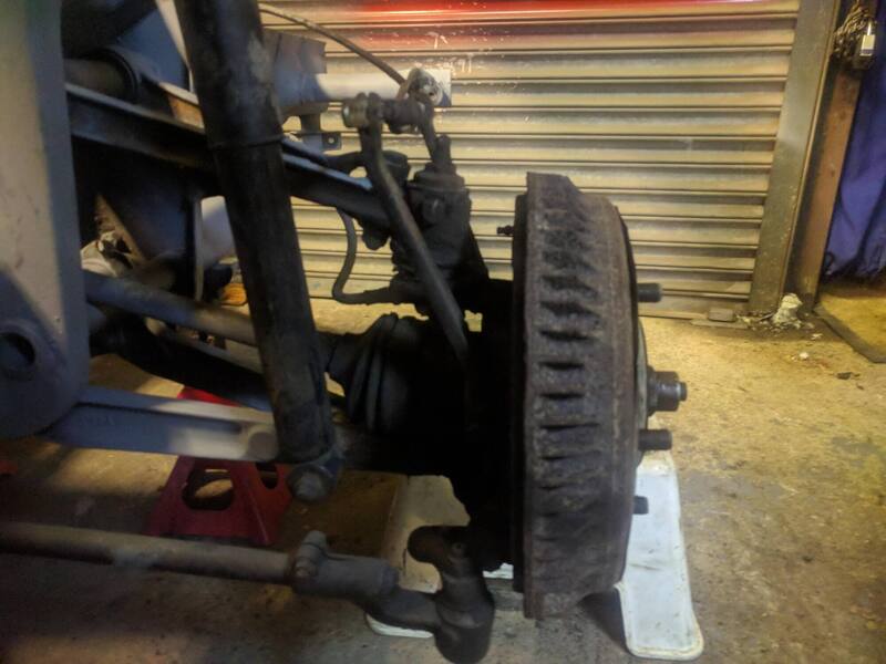

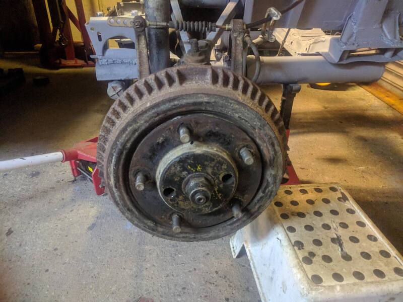

PhilMcCrakin Posted December 30, 2019 Posted December 30, 2019 Hello Autoshiters, I'm stuck in a quandary, I want to take the non-self adjusting drum brakes of my rust bucket and replace them with disc brakes front and back. "But why do you want to do this?" I hear you say, well I've only gone and fitted a rover 3.5 V8 with a Renault UN1 trans-axle gearbox to it so stopping is quite important. I have in the past done this conversion but with an off the shelf made for that model of car kit. There is however no off the shelf kit for the H van. So my question is what do I need to measure/considered/know to order the correct set of discs calipers and associated box of OEM crap. I have rung around a few places but all are less than interested in helping and know almost nothing about the parts they sell. I've attached some pics of what is there for your enjoyment. jon.k, HarmonicCheeseburger, The Moog and 8 others 10 1
Mr Pastry Posted December 30, 2019 Posted December 30, 2019 That's a major design and engineering job. It will be expensive. As your top speed will be limited by aerodynamics, a set of harder linings and a brake servo might be the best option, and that is quite easy to achieve.
PhilMcCrakin Posted December 30, 2019 Author Posted December 30, 2019 2 minutes ago, Mr Pastry said: As your top speed will be limited by aerodynamics Yes it will basically a pig nosed box on wheels, I'm more interested in the torque of the V8 than the speed.
PhilMcCrakin Posted December 30, 2019 Author Posted December 30, 2019 3 minutes ago, Mr Pastry said: harder linings and a brake servo So upgrade the drums to self adjusting "modern" versions of themselves? The whole system on this van was autoshite, the lines the master cylinder and all the slaves I've already stripped all this out so have Cart-Blanche. I budgeted to spend between £500 and £1000 on the braking system but obviously if i can get donor parts that fit that would be better.

Tamworthbay Posted December 30, 2019 Posted December 30, 2019 First port of call is to see If anyone else has done it then see if the original hubs were shared with anything that was later converted to discs, sometimes dimensions of hubs etc can survive across model revamps/ new introductions. Then it’s looking at other vehicles that may work - hope you are patient if you try this. You can often find websites with the dimensions on replacement parts but finding the right one could be an epic quest.
PhilMcCrakin Posted December 30, 2019 Author Posted December 30, 2019 27 minutes ago, Tamworthbay said: First port of call is to see If anyone else has done it then see if the original hubs were shared with anything that was later converted to discs, sometimes dimensions of hubs etc can survive across model revamps/ new introductions. Then it’s looking at other vehicles that may work - hope you are patient if you try this. You can often find websites with the dimensions on replacement parts but finding the right one could be an epic quest. Sobs quietly into cup of tea while eating a jam donut....epic quest.

PhilMcCrakin Posted December 30, 2019 Author Posted December 30, 2019 1 hour ago, Tamworthbay said: First port of call is to see If anyone else has done it then see if the original hubs were shared with anything that was later converted to discs, sometimes dimensions of hubs etc can survive across model revamps/ new introductions. Then it’s looking at other vehicles that may work - hope you are patient if you try this. You can often find websites with the dimensions on replacement parts but finding the right one could be an epic quest. You sir are a genius. So the quest begins in earnest: My compass points me in the direction of 3 other later citroen models that all have disc brakes and have a similar hub size. C25 C35 and CXI (MA). Tamworthbay 1
Tamworthbay Posted December 30, 2019 Posted December 30, 2019 6 minutes ago, PhilMcCrakin said: You sir are a genius. So the quest begins in earnest: My compass points me in the direction of 3 other later citroen models that all have disc brakes and have a similar hub size. C25 C35 and CXI (MA). Woohoo!fingers crossed there will be a match!

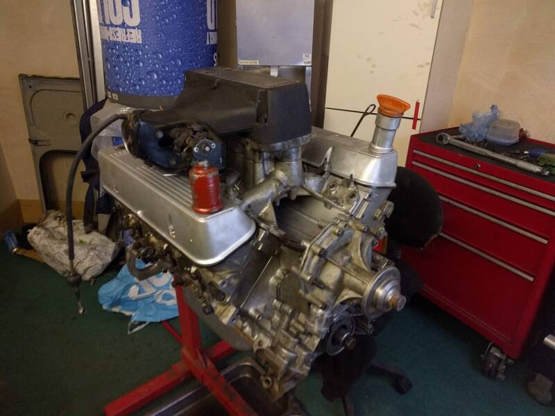

PhilMcCrakin Posted December 31, 2019 Author Posted December 31, 2019 15 hours ago, Mr Pastry said: What is the BHP of your V8 engine? What is the gearing going to be like with the R30 transaxle and van wheels? I'm thinking what speed it will pull. It is standard V8 3.5 lump with electronic injection (LPG and Petrol) with Renault un1 trans axle standard ratio box. Max power on it is 91Bhp@3500rpm but I doubt that is still true as it came out of a range rover classic with 120K on the clock. I have rebuilt the engine, pistons rings bearings cam all replaced with the crank re balanced. The van also has kitchen in the back (it's a catering van) so add another 500kg on board. I'm not building a hotrod just a cool old van but I need safety and functionality out of it hence ditching the indenor engine and gearbox. Mr Pastry 1

PhilMcCrakin Posted December 31, 2019 Author Posted December 31, 2019 16 hours ago, Tamworthbay said: Woohoo!fingers crossed there will be a match! Looks like the talbot (hahahahaaaaodear) is the same van as the c25. I've taken a punt on a set of c25 discs (only 29.99 with postage) I'll test fit these and return if not suitable. (I love amazon) Tamworthbay and mat_the_cat 2
PhilMcCrakin Posted December 31, 2019 Author Posted December 31, 2019 15 hours ago, Mr Pastry said: What is the BHP of your V8 engine? What is the gearing going to be like with the R30 transaxle and van wheels? I'm thinking what speed it will pull. take a few weeks back. Jim Bell and The Moog 2

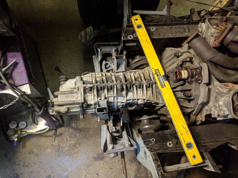

PhilMcCrakin Posted December 31, 2019 Author Posted December 31, 2019 15 hours ago, Mr Pastry said: What is the BHP of your V8 engine? What is the gearing going to be like with the R30 transaxle and van wheels? I'm thinking what speed it will pull. Here is the UN1 with the first mockup of the gearbox mounts Mr Pastry 1
Mr Pastry Posted December 31, 2019 Posted December 31, 2019 Interesting pics, thanks. Only 91BHP? That may be correct, but I don't know the Rover engine. I have done some ball-park figures, but let's wait and see what Darren has to say.
Jikovron Posted December 31, 2019 Posted December 31, 2019 If the engine is a 9.35:1 efi then its 160bhp/205lb/ft and aslong as the exhaust isnt restricted too badly then it should still be those figures given the rebuild 91bhp would be a 8.13:1 twin carb engine with carb restrictions only fitted to LR101s That kit looks to be a custom hub with proprietary disc and c5 caliper , I imagine any brake disc will have to be mounted on the rear face rather than sandwich between the hub and wheel https://www.apecbraking.co.uk/Catalogue.aspx The above catalogue let's you search by dimensions HTH Nicola H 1
PhilMcCrakin Posted December 31, 2019 Author Posted December 31, 2019 5 minutes ago, Jikovron said: If the engine is a 9.35:1 efi then its 160bhp/205lb/ft and aslong as the exhaust isnt restricted too badly then it should still be those figures given the rebuild 91bhp would be a 8.13:1 twin carb engine with carb restrictions only fitted to LR101s That kit looks to be a custom hub with proprietary disc and c5 caliper , I imagine any brake disc will have to be mounted on the rear face rather than sandwich between the hub and wheel https://www.apecbraking.co.uk/Catalogue.aspx The above catalogue let's you search by dimensions HTH nice very, very nice! I'm awarding you legendary status, effective immediately.
PhilMcCrakin Posted December 31, 2019 Author Posted December 31, 2019 12 minutes ago, Jikovron said: If the engine is a 9.35:1 efi then its 160bhp/205lb/ft and aslong as the exhaust isnt restricted too badly then it should still be those figures given the rebuild yes it is the 9.35:1 engine, I'm modifying a set of P4 headers (more space than anything) 2 into 1 and 2 into 1 with both 1's going to one for each side with 2 pipes out the back. no cat maybe a back box maybe not.
