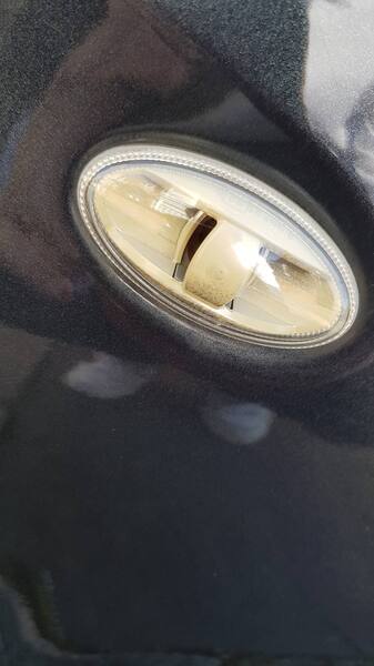

maxxo Posted April 7, 2020 Author Share Posted April 7, 2020 Did some aesthetic work today, went quite well too ooooh shiny! of course these old ones broke the moment i tried to remove them, look rather nasty too i must admit with no chrome left prefer the older style ones anyway and we're done, a lot brighter too and look so nice and shiny! Dan302, rainagain and paulplom 3 Link to comment Share on other sites More sharing options...

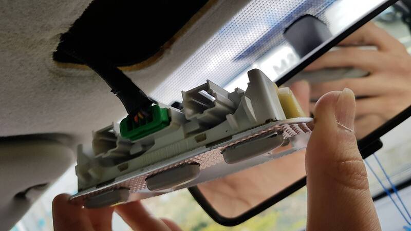

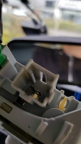

maxxo Posted April 13, 2020 Author Share Posted April 13, 2020 waiting a car park boredom stuck again! but wait......those connectors either side of the main plug almost look like sun visor light plugs! oh wait they are!! seems that will be my next job, gonna be a mega spec! paulplom, theshadow and purplebargeken 3 Link to comment Share on other sites More sharing options...

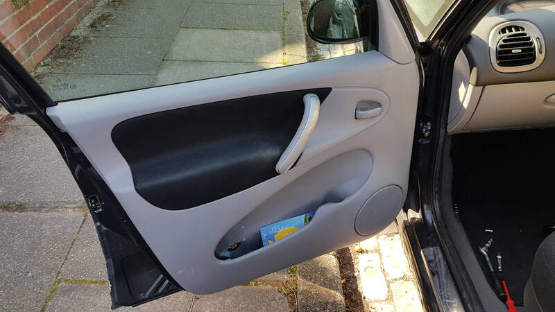

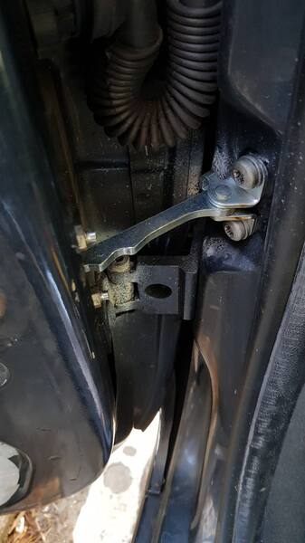

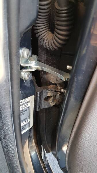

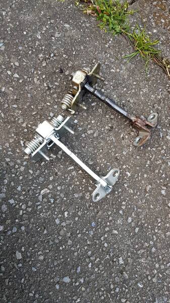

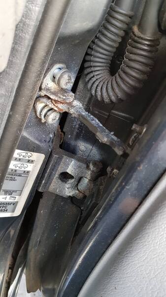

maxxo Posted April 20, 2020 Author Share Posted April 20, 2020 So today we started on a job i've been putting off since july, the door straps! no amount of grease would solve this....stupid loud clicking, holding the door open far too well and looking absolutely awful dissasembly time! of course have to remove everything but i can show off the super easy speaker replacement! surprisngly the door cards on these are really easy to remove, and nothing really broke that badly, just a snapped clip but i don't care about that as i find it funny so after a nice bit of messing around trying to get the old one out here we go, including nice shiny new part! i didn't take pictures of the re assembly, it was a massive fuck on involving much swearing as it just didn't want to go in..... after what felt like many hours of this we finally got it in place! and after more faff with a non magnectic torx set we managed to get it in place ah wonderful! but wait!! theres more!! the door card would not go back on, well not easily at least but finally after again what felt like many hours, we finally got it mostly in place....again i find it funny so it's fine ah yes very nice door! but wait, i will have to do the whole thing again for the drivers side ahahahaha......wonder how long i can put that off for! but isn't it just lovely and smooth! need to spray a bit of silicone lubricant on the new strap but i'm just glad it's over with 20200420_145113.mp4 next jobs are the drivers side and the parking sensors, which again should be an absolutely awful job! theshadow, purplebargeken, rainagain and 1 other 4 Link to comment Share on other sites More sharing options...
paulplom Posted April 20, 2020 Share Posted April 20, 2020 You need one of these for your drivers.Sent from my SM-G975F using Tapatalk maxxo and stonedagain 2 Link to comment Share on other sites More sharing options...
maxxo Posted April 20, 2020 Author Share Posted April 20, 2020 1 hour ago, paulplom said: You need one of these for your drivers. Sent from my SM-G975F using Tapatalk  i absolutely do! as that had to be one of the single most annoying things i've ever dealt with in my life haha stonedagain and paulplom 2 Link to comment Share on other sites More sharing options...
bub2006 Posted April 20, 2020 Share Posted April 20, 2020 It must be common,3 out of 4 doors on mine crack and groan. Must try to rectify it as I've seen them rip right out the door. Do you happen to know what dimensions the speakers need to be to fit the doors? Thanks. Link to comment Share on other sites More sharing options...
maxxo Posted April 20, 2020 Author Share Posted April 20, 2020 14 minutes ago, bub2006 said: It must be common,3 out of 4 doors on mine crack and groan. Must try to rectify it as I've seen them rip right out the door. Do you happen to know what dimensions the speakers need to be to fit the doors? Thanks. i have also seen that, it really mangles them to bits inside as far as i know the front speakers are 17cm and the rears 13cm, at least that was the size of the ones i ordered Link to comment Share on other sites More sharing options...

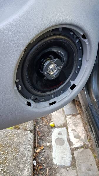

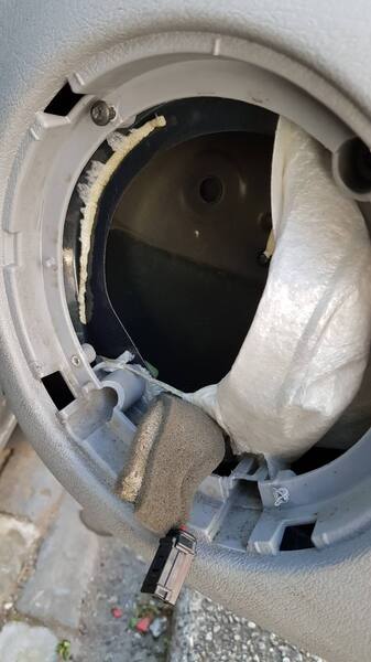

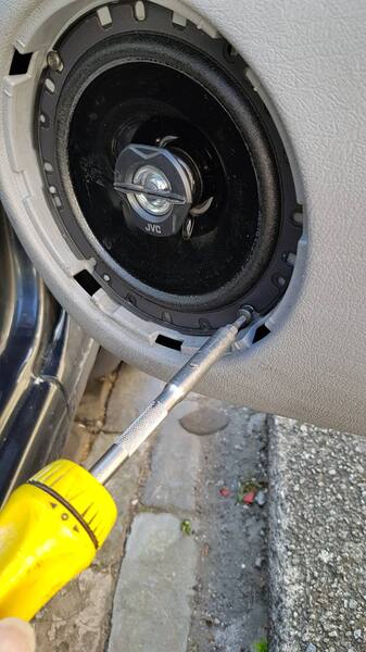

maxxo Posted April 24, 2020 Author Share Posted April 24, 2020 So I gave the picasso some more love today, sorting the other door strap i'd heard they can be removed through the speaker hole I love how easy the speakers are to remove in these, really is a lovely design just some torx screws and out they come, obviously these aren't factory speakers as they actually sound good (and i will say what i always say, the factory head unit is pretty good it's just the speakers which let it down) Once i removed the speaker and the pretty broken foam padding it's obvious it's nice and easy to get the strap out! Well the moment before i spent 15 minutes fucking around trying to get it out, oh yeah it also broke as i was removing it so i was past the point of no return yay! oh and my hands were absolutely full of oil and grease! which was fun especially trying to remove sockets from the rachet wrench, but we managed to get it out after much swearing aaaaand we are done, obviously was a fuck on but i'm glad it's sorted now I dread to think what my neighbours think of me the amount of honestly foul words i was saying as i couldn't get it through the hole even shocked me........ obviously we couldn't leave the car being dirty could we....it's me after all and yes i was cleaning my car as it was getting dark, and yes i am a weirdo! i'm driving to the other side of town tomorrow to go for a walk where it's quiet and going to fill up with shell V power so we know i'll either have some form of major expensive exciting problem or a decent crash mind you that's more likely to happen on tuesday after i have had my wheels balancing......oh yes i'm actually fixing the wheel wobble...well paying a man to fix it rainagain, Jim Bell, The Moog and 3 others 6 Link to comment Share on other sites More sharing options...

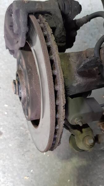

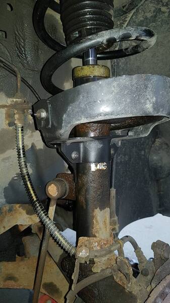

maxxo Posted April 28, 2020 Author Share Posted April 28, 2020 So you know how i've given the picasso a fair amount of love recently? well i've been repaid by a burst shock! oh yes! much oil everywhere oh and my discs ummmm may look like this....... rather embarrasing for that to be seen buy the guy at ATS doing my wheel balancing oh and i've got a lot of play in both track rod ends.......yay, on the drive home yes i did notice it drives like shit and doesn't feel right at all as ATS didn't seem to want to rip me off.....and we bad mouthed kwik fit, they've got the job going in at 10:30 tomorrow morning Link to comment Share on other sites More sharing options...
paulplom Posted April 28, 2020 Share Posted April 28, 2020 Looks like the rear pad has been binding. Uneven wear by the look of it.Sent from my SM-G975F using Tapatalk maxxo 1 Link to comment Share on other sites More sharing options...
maxxo Posted April 28, 2020 Author Share Posted April 28, 2020 2 minutes ago, paulplom said: Looks like the rear pad has been binding. Uneven wear by the look of it. Sent from my SM-G975F using Tapatalk  i thought the same! cars are fun! i'm pretty excited to get it sorted, probably drive completely different paulplom 1 Link to comment Share on other sites More sharing options...
