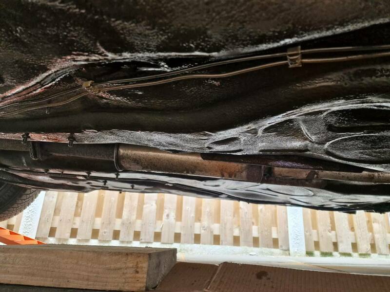

Underside has a coating of Lanoguard.  Easy to put on. It nearly took the entire 2.5 litre tub though but it's probably twice the area of a small car underneath, overhangs for days...

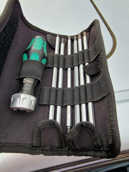

Whilst cleaning it out, I found my Wera bit set. Thought I'd lost this moving house, not seen it in 12 months.
Bonus.

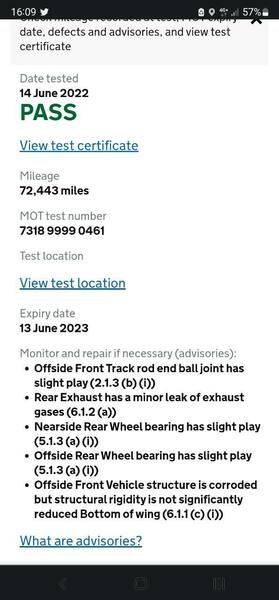

Also, it's a summer's anniversary for an MOT. No faffing in the winter changing a brake caliper. Winner
Well done, nothing too worrying there!
Are the rear bearings on these the taper roller type?
Yea, they're taper rollers, supposed to have a bit of slack in them rather than too tight, I'll have a look at them but it's not an advisory I'm going to loose sleep over.

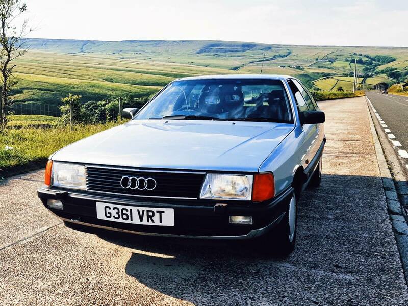

The drive to work
The drive home from work, catching the sunrise, empty roads, had to avoid sheep.

that's a great result on the MoT - gotta be happy with that
Nothing in it that I'm not too concerned about.
The wings needed doing 2 years ago. Still need doing.
The back box is blowing, know about that. Maybe a custom back box.
I'll have to investigate the drop link.
Wheel bearings? Not worried about.
The timing belt could do with a change I'm sure, it seems to have a 2015 date code on it, but I've nothing to prove when it was done actually. Could have been 2017 or 2018, who knows... It looks fine on inspection.
