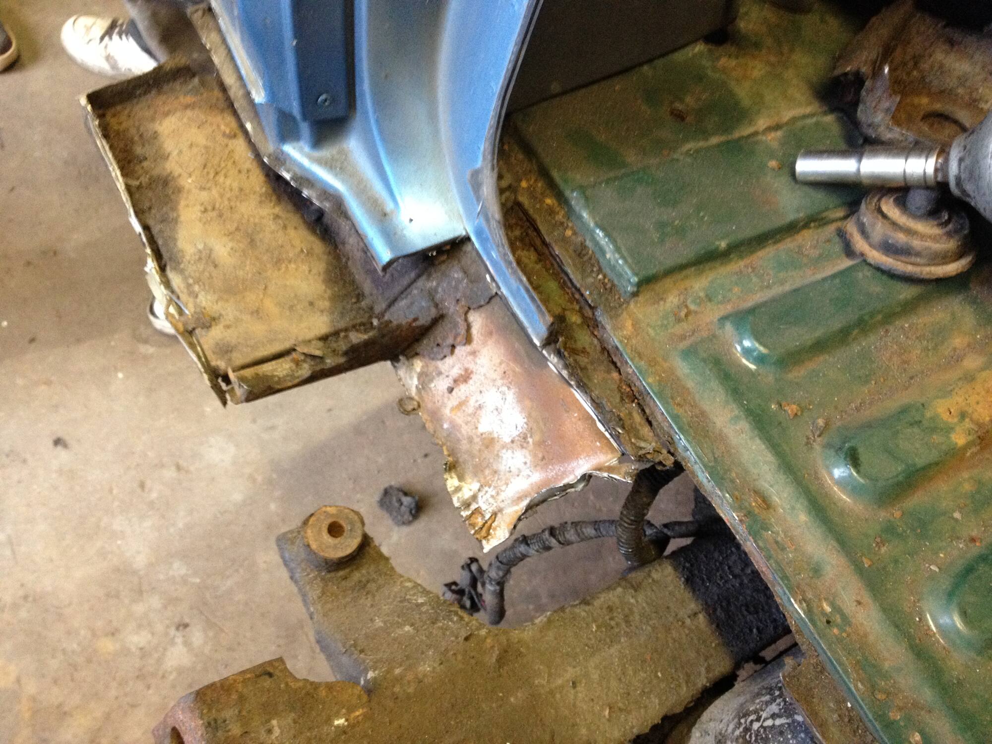

Mot day today on the Peugeot which aside from track rod ends, a shock and tyres hasn’t been touched in about a year. So today, I didn’t really know what to expect.
Failed on corrosion which is a bit of a shock considering the car is rust free.. on top
Looks like it’s been damaged maybe by a jack and rotted away. It’s been over a year since I fired the welder up so gonna give this a blast and see if we can’t push it through it’s test this weekend. Luckily I already have an arm and a balljoint, so aside from sundries and part of a combo van for a plate I’m not bad off really. Unless I can’t weld upside down.
Need to find the wax oil to do the inside first, and then I imagine within a year the other side. Not easy on the drive in scottish weather. Well shall see.

Top tip. I’m just gonna spot it every inch or so then join them up with more spots. Best thing is I have enough of this panel to get the welder settings right on the bench. Bonus is I’m not directly under it, more to the side. It’s gonna be dark in an hour so not starting now - but found some wax oil so it’s ready to go tomorrow

Don't patches need to be continuous seam welds?
I hate welding upside down. Fucking hurts. Especially when they go down your neck.
I think the key word is “continuous” as in no gaps. As in you can tack weld in inch gaps, then “spot” weld over and over again between your tacks so it looks like a seam weld. With the thickness of car metal it’s gonna blow through without a doubt otherwise?
Like this is what I was gonna do (welding starts at 1:45) and tbh before I start if anyone can tell me this will fail please do
Yanks call it stitch welding I think. I’ve seen some welded patches on cars - particularly a x type I owned for a bit - and mine will be better.
I don't know the answer, just don't want you going back and failing on it!
It’ll be better than the hole it had originally. And it sounds like the tester doesn’t care too much anyways. You could probably glue a patch on with seam sealer and plough a tin of waxoil at it and he’ll be happy.

This was acceptable for my discovery 1 on MOT the week before I bought it. Glued in patches of steel for the rear crossmember. 2 weeks later it all collapsed while off roading. Needless to say, it was replaced with zintec box section and actual welds.

Fun fact I once glued a sill repair on my 307 using industrial metal epoxy, it passed the mot no problem but then fell off one day when I jacked it up at front. Turns out the proper method is to drill a series of holes in both the repair panel and the original car metal. Making sure they don’t line up. The adhesive then mushrooms into these holes preventing ‘peel failure’ which is what happened to mine. I have since welded the same panel back on.

You will be fine,  I often do the same due to thin metal or run the chance of blowing holes,
Can I ask, are you going to waxoil inside before you weld ?
If you are you could burn the car to the ground due to the internal fire risk,
Drill a hole after and spray the waxoil inside then rubber bung it,

Well I’m not amazingly proud of my welding as I literally hate being upside down, but first pass looks almost as good as hammered dogshit. Point is all the gaps filled, one continuous line, ground down and redid a few bits.
Added a drain hole and all waxoiled. It actually looked quite smart once it was flap disked down.
Thankful it’s done. Laid on the floor all morning in 4 degrees is not fun. I’d actually be confident to say even if I had to strip all the waxoil off it looks like a tidier job than I’d anticipated.
Balljoint and spring fun tomorrow then in for a retest.

Passed. Another chapter eh.
