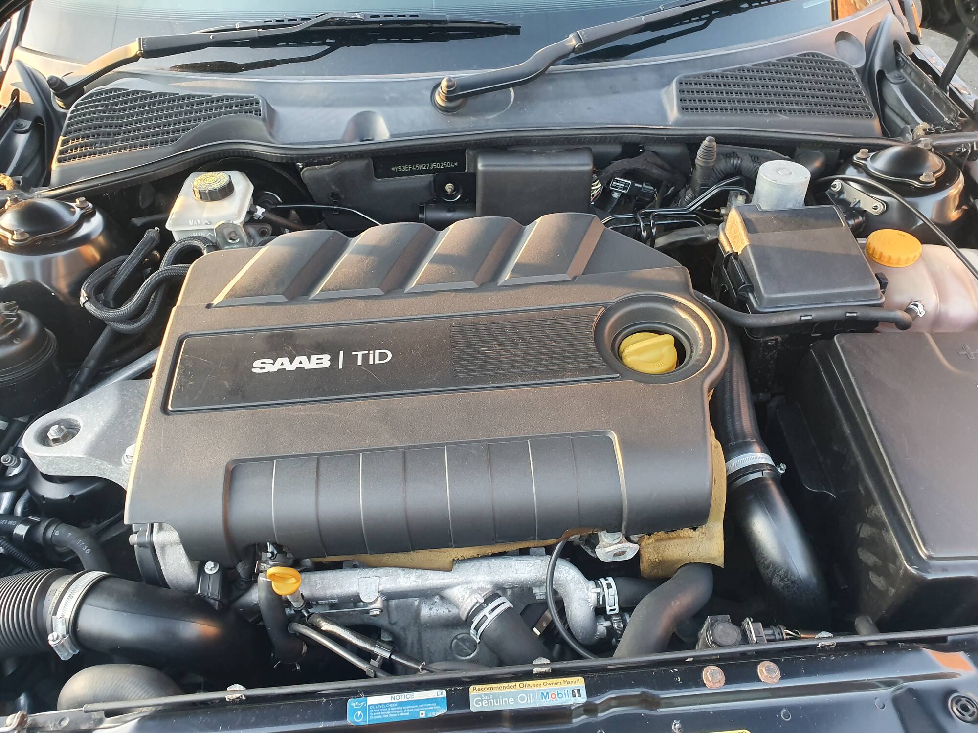

currently the only picture I have of it, I'm sure more pictures will happen but likely to be of the engine parts covered in diesel crap for the time being,
First job will be removing the throttle body for a clean.
The EGR will be coming off tomorrow to give me an idea of what it's like, I did this with my last two 1.9 tdi Fabia's to get a general idea of the condition of the engine,  as my brother in law didn't do great long journeys with his job this might be why it's being flagged up?

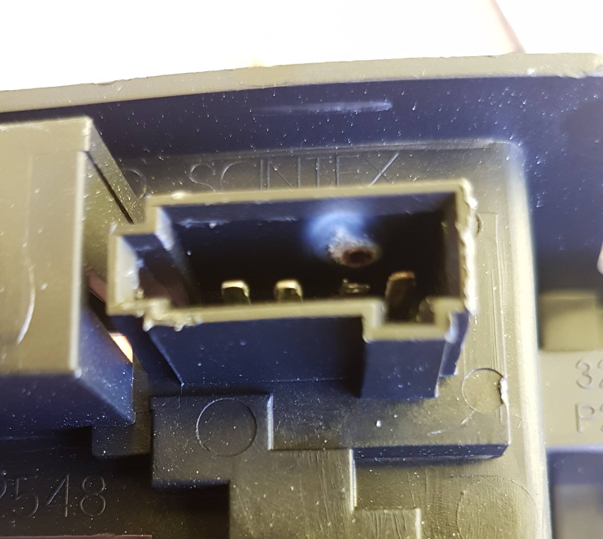

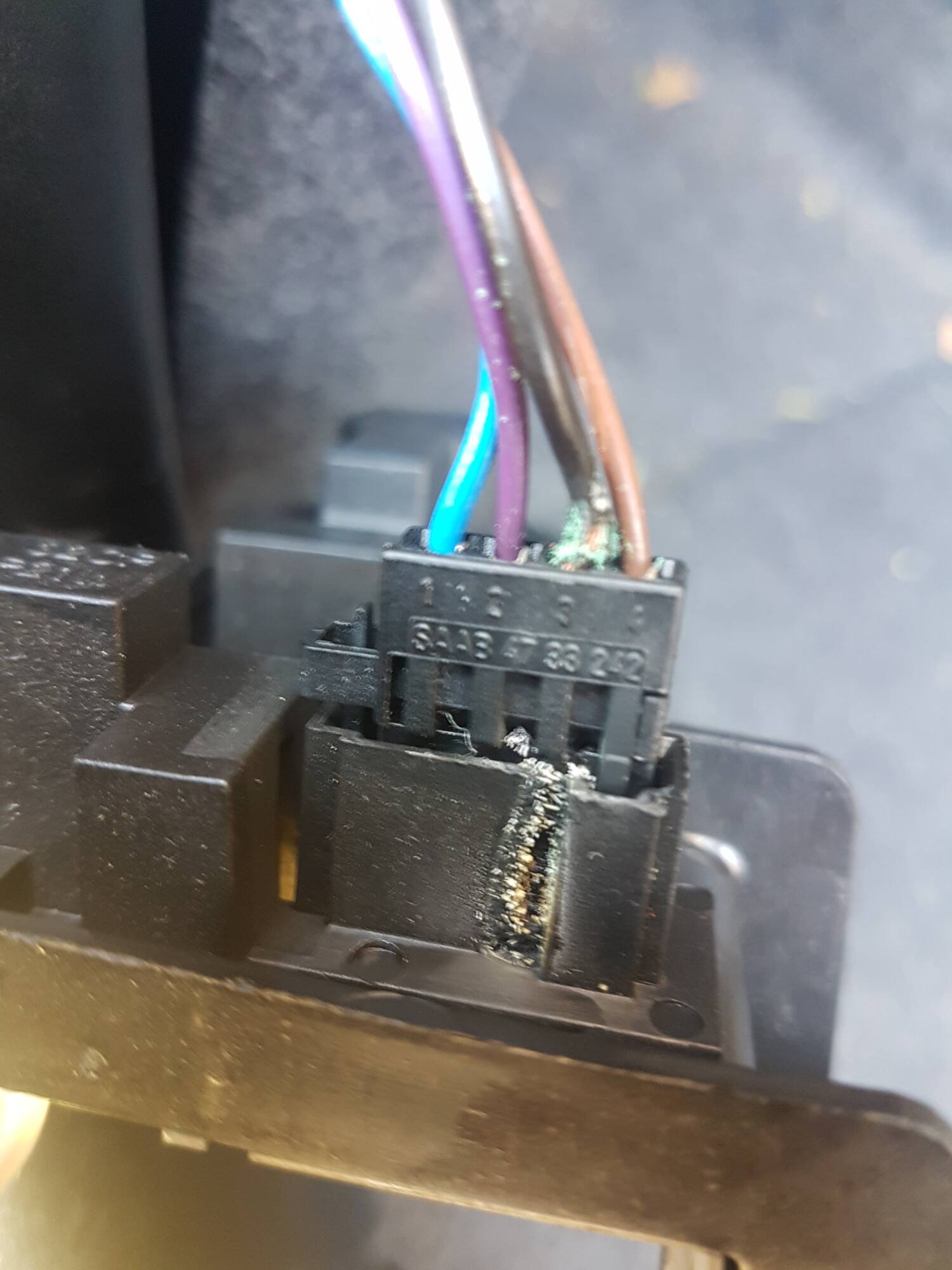

Just been out to look at the bulbs in the back and found green fuz on both connectors with mild melting bulb holder's
20190918_104409.thumb.jpg.ac55ea9d3c3f4b5934eb305c54079633.jpg20190918_104347.thumb.jpg.034169c450fcc9401241396b4d974fcf.jpg

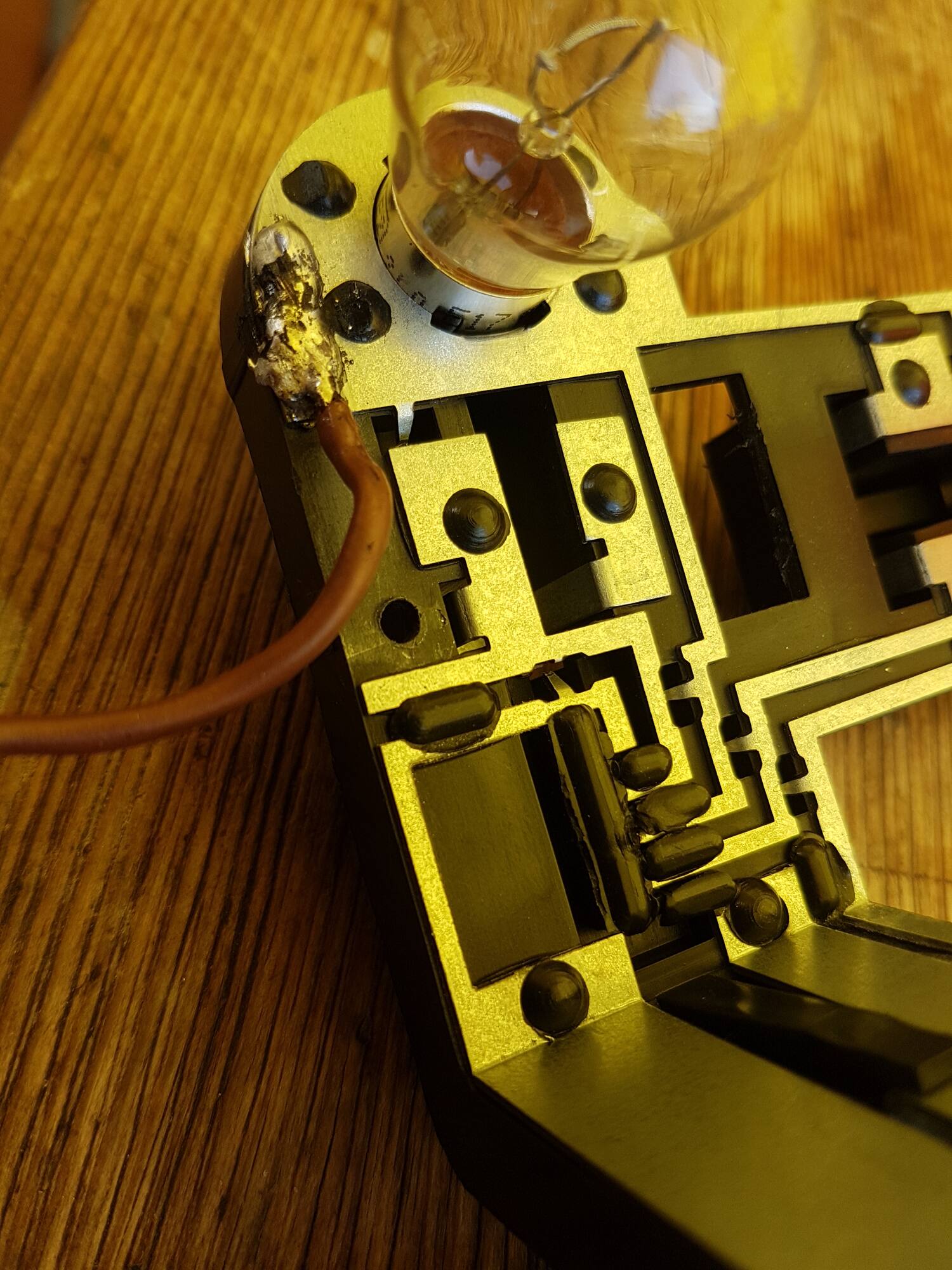

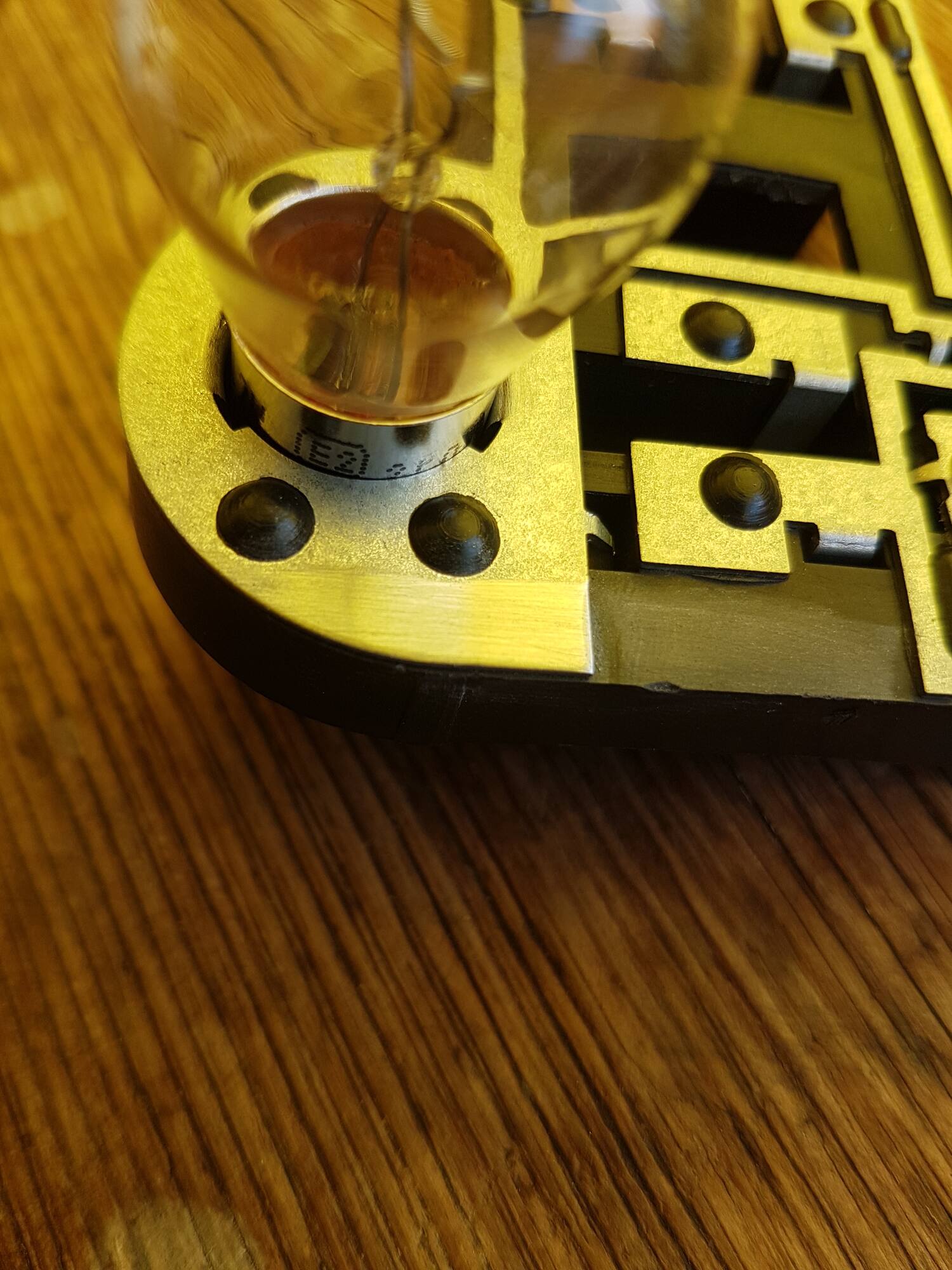

Today after I had unblocked the toilet and then the drain my attention turned to the Saab,  I started with repairing the rear lights bulb holder's,  both had been burned and something had to be done as the SIC Saab warning display had flagged up all of the rear lower bulbs as dodgy , the terminal with the black wire's had dissolved on both side's internally,  so out with the gas soldering iron and a plan of action was made, there was no point trying to rewire it as OE due to the damage caused,  so bypassing the plug was the only way, plus if this worked I would save best part of £50 for both, that money can now be pushed towards buying a complete cambelt kit for the engine, some pictures of the damage caused,
20190920_180213.thumb.jpg.f2359c7e5fa58bf1a7b38c4c72e92f57.jpg20190920_180246.thumb.jpg.5d5121aa77c6623fd96ffdb951892cad.jpg20190920_180331.thumb.jpg.428f52ac1ab7558df3c10e56243c889b.jpg
So as not to disturb the crumbley plastic I worked out which part of the bulb holder's circuit the black wire's were connected to then sanded through the galvanised layer to make sure I got a good solder joint, then soldered the wire to it, I then drilled a hole and popped the wire through it 20190920_120357.thumb.jpg.1e1c90308b31bbee5f2322cc768ce712.jpg20190920_121046.thumb.jpg.ac05e9cb97c0734273b205721daa91fa.jpg20190920_121203.thumb.jpg.174ae7c15cef95522227a1a46809b138.jpg
Then to the Saab to see if they worked ?
20190920_183420.thumb.jpg.16428966a939053d9be85fb78c8e134b.jpg20190920_183551.thumb.jpg.3257799b274524c1cf0d1a36c60457e0.jpg

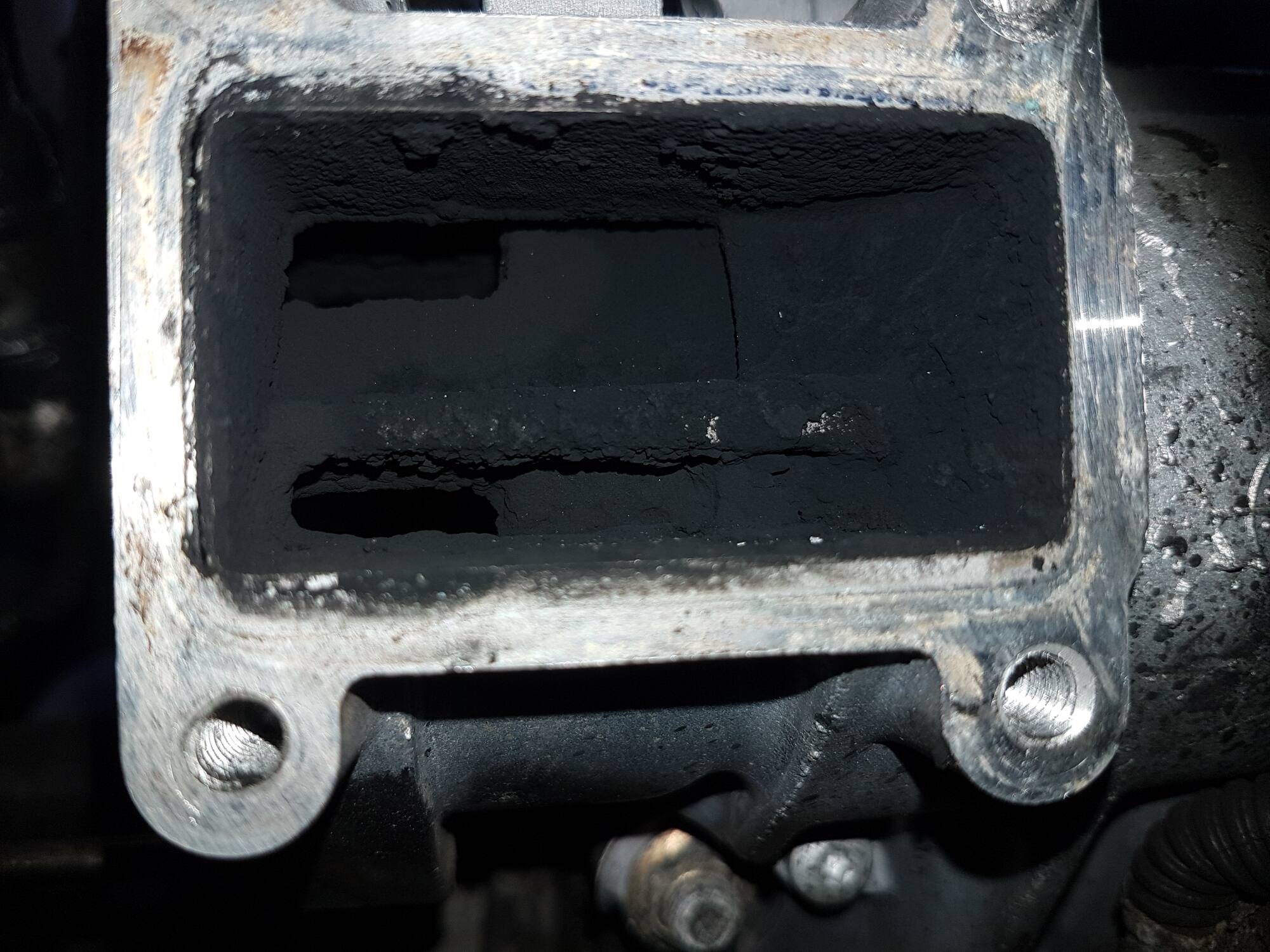

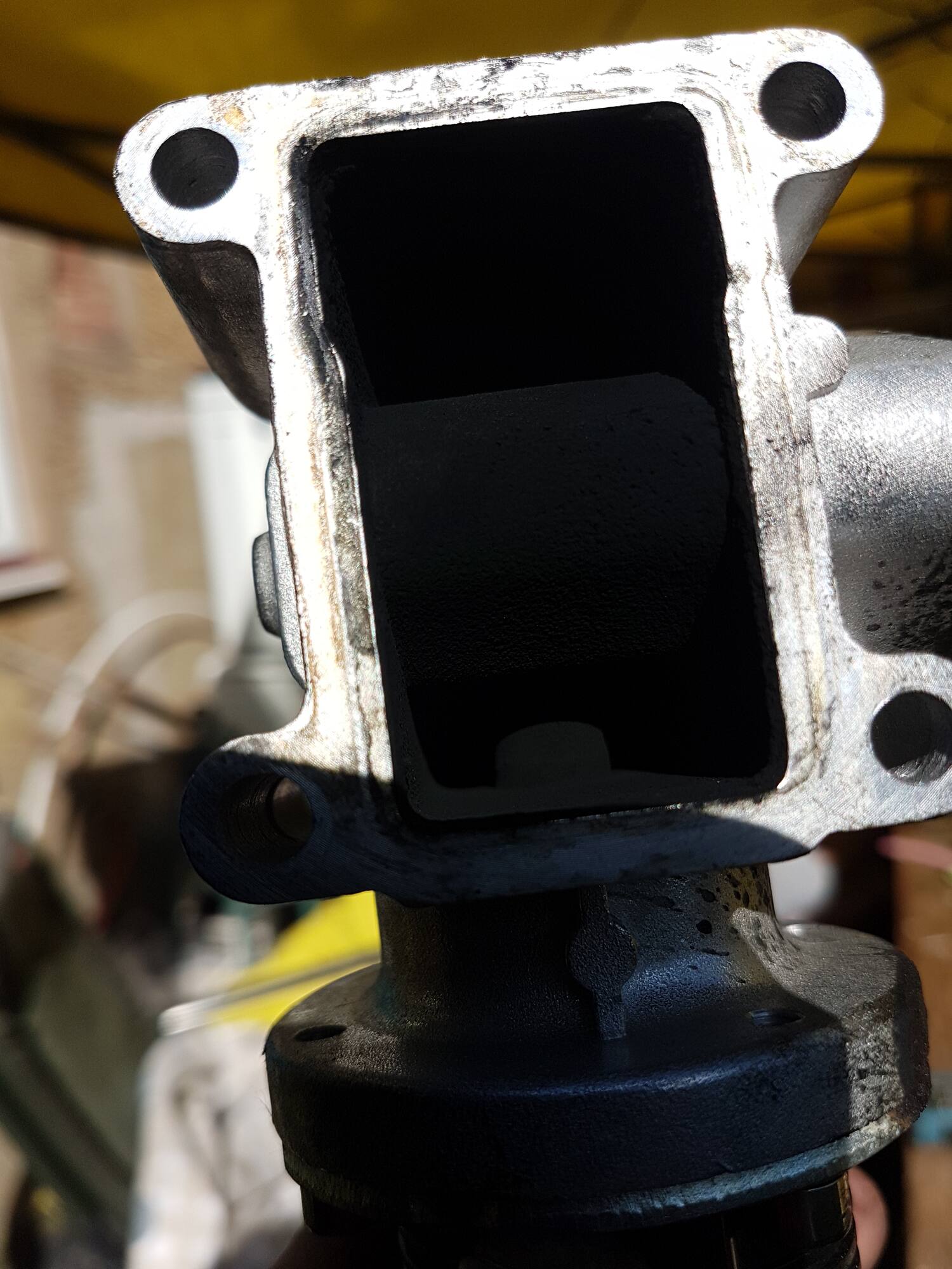

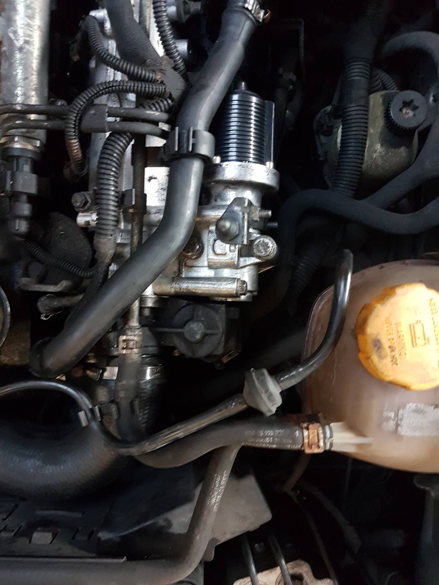

happy with the results I went to deal with the EGR and associated fault codes, throttle body and EGR removed I could see they both needed a clean so set to them both with carburetor cleaner and G101, they came up ok but I failed to take a picture once done,
20190920_141445.thumb.jpg.2e61c3ddee0899e234c680343f2c031d.jpg20190920_141505.thumb.jpg.0f5164e2f3f498c364feb53eeb752d63.jpg
the intake manifold was a little worse than the other parts but also got a good clean with the aid of a small screwdriver, Hoover, tissue, carb cleaner and a work light, again I didn't get a picture but it was clean enough,  I've put it all back together and I will take it out on a run tomorrow to see if it's repaired?
20190920_155845.thumb.jpg.0093488f282ede53290e48433dc6a794.jpg20190920_155249.thumb.jpg.10b62425e974921070d8550cd7034f11.jpg20190920_185523.thumb.jpg.a9027f6ae7178aec79c72e01cbfe435a.jpg

I have just taken this oot for a drive to get it up to speed, left it in 2nd gear for about a mile maintaining the revs above 3000 rpm, then a blast up the bypass and home, I am glad to report that a check with the obd reader has come back as no codes stored in the module!!! This is a good thing as I have a prospective buyer for my Skoda Fabia,  the Saab will need some new boots on the front as they are done, the rear tyres are Pirelli and have plenty of tread but cracking on the side walls which might be a fail? I will get the tracking done once the MOT has been achieved,
20190921_130114.thumb.jpg.2e78fa46f9b6363f8f69f5e07ca17af4.jpg20190921_130134.thumb.jpg.73257175cf6b7b5ed216f2cc76916340.jpg20190921_124757.thumb.jpg.740a0fecf69914d556b0544113b2d73a.jpg
