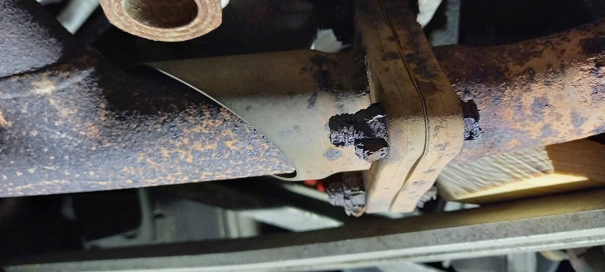

But to be honest, the access still isn't brilliant. I can't move the CV joint forward as it fouls the lower suspension arm. It moves better to the rear of the car, until it fouls the exhaust. With that removed the access would be heap plenty. But just look at the state of the studs which connect the front pipe/manifold to the cat'.  :jaw-dropping: That way lies danger...

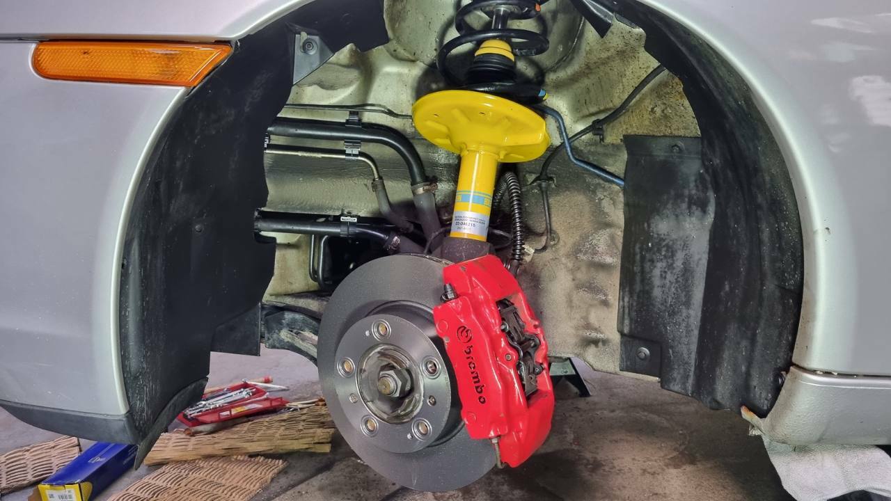

Hit another snag. The lower stop plate/washer is fixed to the old strut, non removeable. I've had to order two that will fit the new struts in at 25 quid each. Genuine Porsche parts/washers are £50 each! #Porschetax. Should be ready to get it rebuilt at the weekend.
All the parts arrived pretty quickly, so today, this happened. Phil that works with us gave a hand, we didn't bother/need the spring compressors to refit the springs, just put it together and used pure muscle and man power to get the securing nut on and then nipped them both up.  :thumbsup:
I took the chance to lash on two coats o' Lanoguard on everything, except the calipers, natch!  :beer:
Should all going well, be back on its wheels and out for a road-test tomorrow night. Hope so.

This finally happened today. Drivers side completed, N/S getting done in the morning. Brembo pads and discs are lovely things, as are the calipers, so much better than normal shyte on normal cages.  :salute:
And yes those are brand new wheel bolts, the alloy spacers on the old ones were corroded and falling to bits and eating into the wheel.
