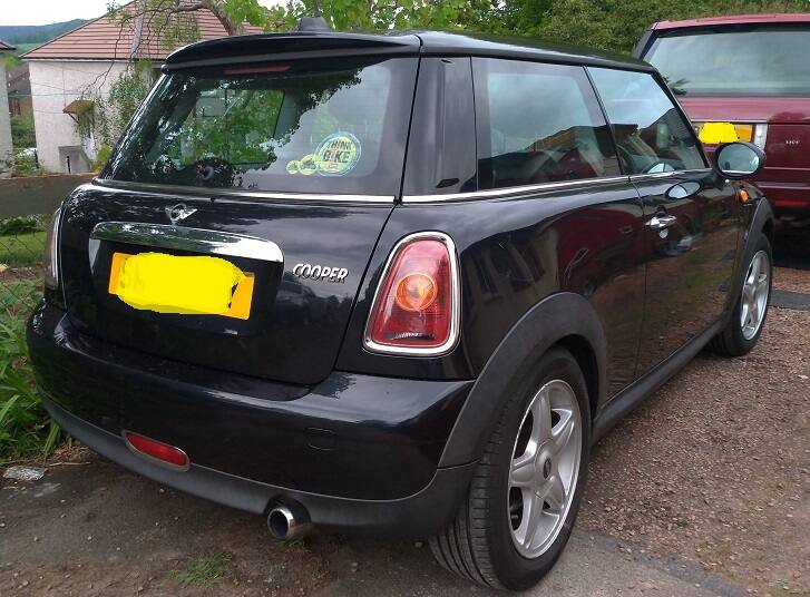

Hawkeyethenoo Posted May 20, 2019 Posted May 20, 2019 One out one in.... Having sold my 1998 R170 SLK230 at 1pm on Saturday, paid £1400 two years ago, fixed it, new brakes, shocks, air pump, sold it for £1950. I was done with the car really, I'd bought it to do a European tour and having done that last year, 5000 miles in a month. It was time to move it on. So by 1:25pm I was on the NET looking for something interesting and cheap. Up popped this Mini Cooper. Face lift Dec 2006, few girly owners, in Astro Black. £950. I phoned the seller and the next thing I know I'm in Kirkcaldy shaking hands on £900 for 'Enry (Cooper). Money transfer done, I'm heading for the nearest supermarket to blow up the soft NSF tyre and get some temp' insurance. MOT'd till Feb 2020 with advisories on worn front tyres, yes were fooked, replaced yesterday. Insurance done we set off the 50 miles home (Mini Adventure?) and that goes without a hitch and it's returning 40+ mpgsss as we bomb home via some nice B and A roads with me thinking, what am I going to tell the wife??? Tartan58, mrbenn, The Moog and 4 others 7

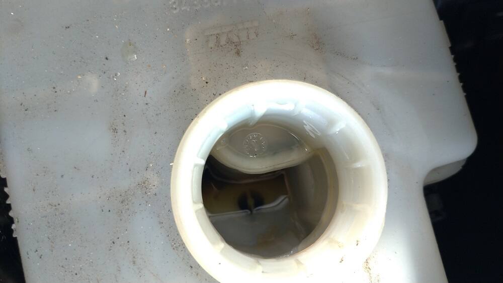

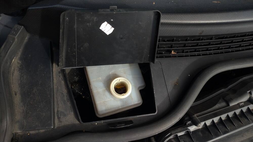

Hawkeyethenoo Posted May 21, 2019 Author Posted May 21, 2019 Plugs changed. Had to borrow bi-hex socket from the local friendly garage, will return tomorrow. Old plugs look pretty normal and have been in there, a while? That done I thought. Where's the brake master res' on this car? Oh yeah it's hidden under a flap. Opened the flap and the bloody res' cap is missing! Not there! FFS! Never had that before.... On Evilbay now sourcing one and a full brake fluid change is now the very next job. rainagain, dome and DVee8 3
Hawkeyethenoo Posted May 22, 2019 Author Posted May 22, 2019 Back at yon the now. Decided the syphon out the skank brake fulid from the open-to-air for period unknown, the brake master reserviour, using an errrr, syphon, and refill to the correct level with fresh DOT 4. The res' being hidden under a flap is good and bad thing. Bad that it's hidden from immediate view/inspection everytime the bonnet is opened, nothing more important than working hydrhaulic disc brakes! Good that the flap prevented even more dirt, water, small mamals from entering than would have otherwise. It still shocks me that it is missing & that it took me 3 days of ownership to spot it. Photos..... Can you see me now? Overfilled and very dark looking like overbrewed tea = skank. More sook than a Bangcock LB. There's more where that came from too.... This much horrible looking shyte came out of the res'. That Pyrex jug, no messing about in this garage is sitting nicely on top of the running at smooth idle, Made in Britain, engine. #Quality. Fresh DOT4 going in nicely, just a little more, the remainder of the bottle and it was bang on where it should be, just below MAX. #Nice Adhoc, air N dust N water N small Mamal tight cover. Replacement cap sourced on Eckybay for £4.99 FREEPOST! Can't fecking wait for IT to arrive as the car's 'ticket to ride' has been 'revoked' until it does. #Unroadworthy Don't have nightmares, but do check your brake fluid regularly and refit anything you loosen in the process, OKAY!? Help ma Boab.... Hawkeye.

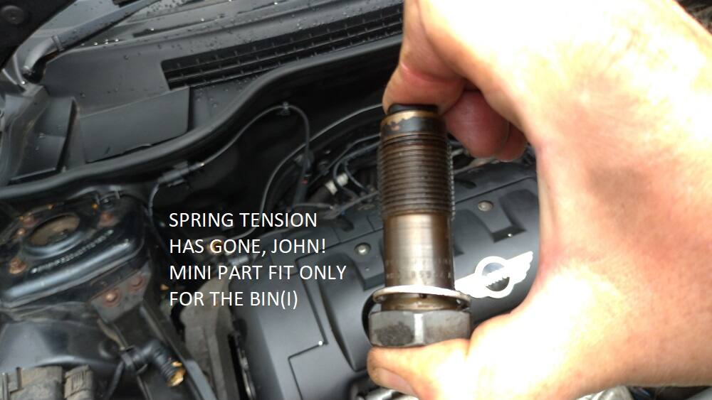

Hawkeyethenoo Posted May 26, 2019 Author Posted May 26, 2019 Noticed a bit of a rattle from the LHS of the motor from the dun, dun, dun, timing chain. Not the death rattle, just a bit of a rattle as the engine revs drop back to tickover. Suspect the timing chain spring tensioner, so decide to set about removing that to see what gives. Notice the now replaced res' cap and the 'cleaned' engine bay... ?️♂️ First thing is to remove cover/filter/airbox. And throw away store safely in the boot/trunk. Which gives access to the whatyahmacallit thingy / throttle body Which clears access to the route of the problem? The camshaft chain tensioner shown here with gaint red arrow. Releasing that requires a 27mm socket after the throttle body is removed. Now we're getting somewhere. Access with the TB removed is good to excellent. Two mins later the bastid thing is removed for testing using the short, fat, stubby fingers which I'm equipped with.... Which shows that - The tensioner is goosed as I can actually squash it just using by thumb and pinky finger, not shown..... Good call and I think I've caught this before it starts to wear the plastic cam chain guides and becomes a proper "death rattle" that these engines are somewhat prone too. Replacing the entire timing chain and guides is not actually a massive job, but it does require, speshul tools and the replacement kit isn't cheap.... £££ stonedagain and dome 2

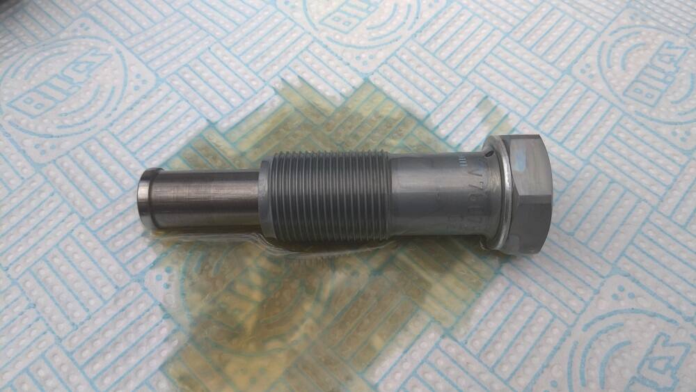

Hawkeyethenoo Posted May 26, 2019 Author Posted May 26, 2019 This the replacement part https://www.minigenuineparts.co.uk/info-bm11-31-7-607-551.html I've ordered one from Douglas Park Mini = £51.40, collect it Tuesday.
Hawkeyethenoo Posted May 26, 2019 Author Posted May 26, 2019 While I was there, decided to have the cam cover off, briefly, to check the condition of the timing chain and top follower/retainer, which was all a-okay! Will replace cam cover gasket too. dome, rainagain, Twiggy and 1 other 4

Hawkeyethenoo Posted May 29, 2019 Author Posted May 29, 2019 Cheers for the kinds words, folks. It's an easy enough motor to work on and hats off to Mini for making the camchain tensioner so easy to get at and replace. That was done yesterday evening after collecting the new part from the Mini dealer. I donated the old one to the workshop so they have a reference for one that's well passed its best. Spring resistance on the new part is far superiour and it's smooth in action too. Wee bit of effort required pushing the tensioner home enough to catch the thread but with that done it was nipped up to 50Nm. Shiny! For now at least.... Then moved onto fitting the new vacuum pump which again is pretty straightforward. Perhaps a bit OTT on my part, but peace of mind. That all done and the throttle body refitted and everything double checked it was time for the test start.... First touch of the button it fired up and was running very sweetly. Once warmed up a bit it was pleasing that the horrible rattle had gone and it's running bloody well even without the airbox fitted for now. Jobs still to do. Get leccy mirrors working, replace worn rear discs N pads and also fit the set of Wipac 5" driving lamps I appear to have just bought, opps. Don't tell the wife.... stonedagain, Vince70 and Sigmund Fraud 3
