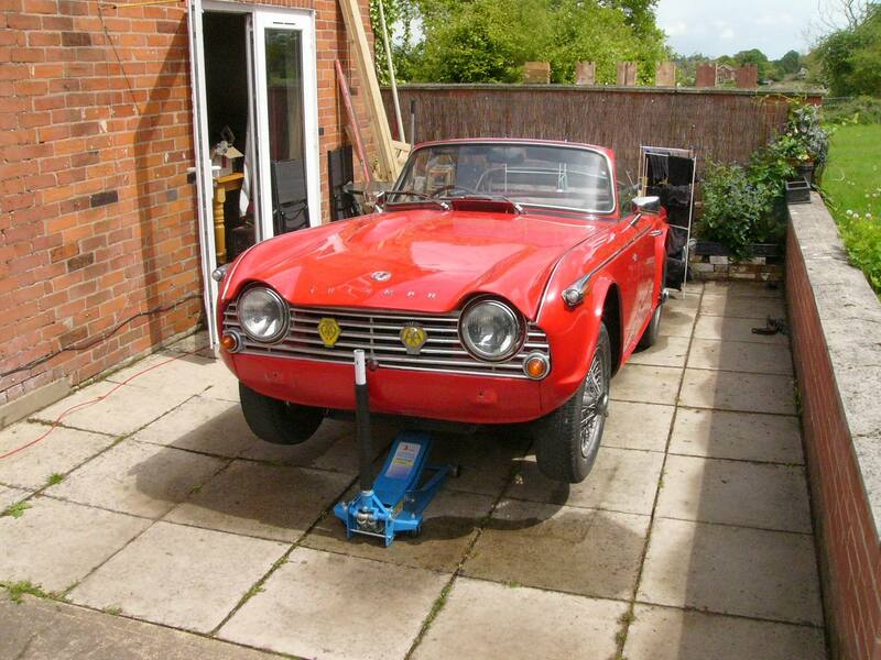

I moved the weekend before last from one side of the car park to the other (..in the apartment block complex), primarily because the studio apartment was too small for all my unsorted 'stuff' and equally because I wanted needed a designated place to work on the car..  The new residence is a one-bed apartment but with patio large enough to land the car on. . .
^ Although south facing, the first job I did was to jet-wash the patio of most of its dingy green algae.  And then with the new low entry / high lift trolley jack ..and borrowed ramps - the car is now safely elevated enough for me to slide under and investigate various issues ..essentially regarding Katie's  very poor passenger-door-gap and how much chassis / car flex might I expect when jacking the car up.?

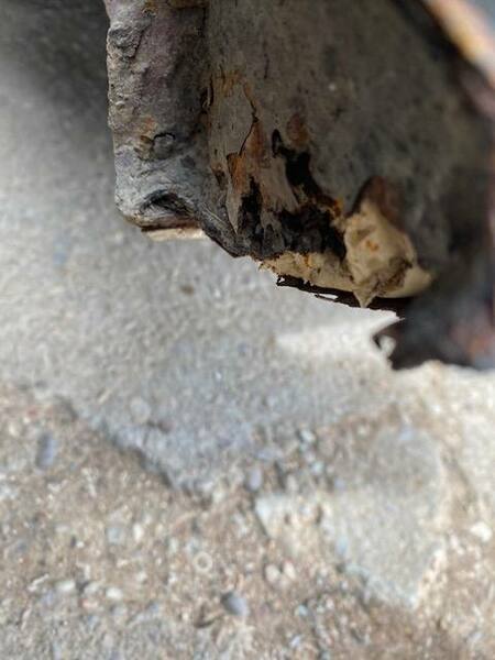

I slipped under the jacked up car to have a look at the chassis when I bought her  ..just two months ago now, and then again when the car was jacked up briefly while removing / refitting the gearbox / clutch.  In general it appeared to have been locally patched but in good shape.  Before I jacked the car up this time I measured the top of the door gaps, then lifted the car under the rear swing arm and measured the door gap again.  I was pleasantly surprised that there was just 1.5mm difference on one side and 2mm on the other.  A kind gent dropped me a PM to share that his car was much the same.
Pleased that the main backbone wasn't moving too much, and now with the car on stands I investigated further. The rear chassis leg on the LHS is cracked as is the rear bridge between the two rear chassis legs, onto which the dampers are bolted.  This also supports the rear diff mounts. . .
^ LHS rear chassis leg (which goes to the rear bumper bracket).  This would not be difficult to clean up re-weld and to add a doubler plate.  It has been welded before but I don't know if that was from new or a repair.  The question I must ask is ; whether there is some issue to have caused it to crack (some time ago by the looks of things) or is it just the result of fatigue over many years ?
^ photo of across the car with the arrow left indicating where the crack is on the LHS.  Immediately above this is the bridge from one side of the chassis to the other, onto which the lever-arm dampers are bolted and the rear diff mounts.  That is also cracked on both sides. . .
^ LHS -  looking into the corner of the rear chassis leg with the bridge
^ LHS looking back to the bridge with the lever-arm damper in light grey. The crack appears to go right the way across.
On the RHS its probably worse . . .
RHS bottom of the rear leg has a little rusty orange stain, so looks to be just starting to crack in the same place as has happened on the LHS rear leg.  The crack between that chassis member and the bridge is obvious.
RHS looking forward to that bridge.   Again I wonder - why has it cracked through ?
So., all in all a bit of welding needed.  Whether it is necessary / much better to replace that bridge for a box section tubular one I don't know.  I don't want to lift the body off but I can't see getting above it to weld a replacement bridge in is going to be possible even if the exhaust + lever arm dampers + diff + possibly fuel tank (for safety reasons) are removed.

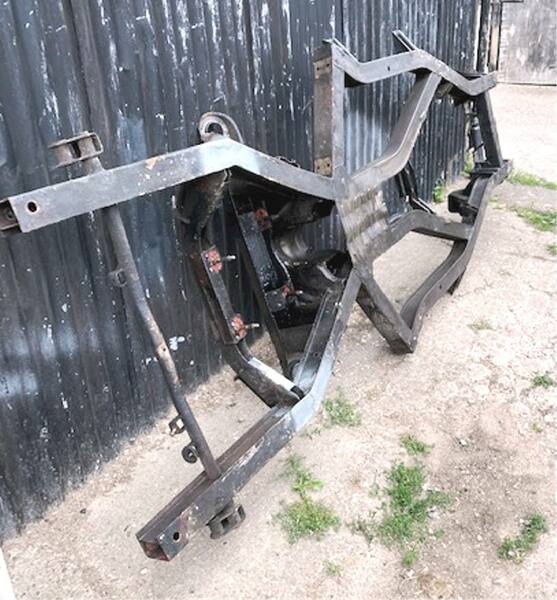

For those who might be interested here are a few illustrations to explain what chassis mods I'm asking for (these being on top of the 'usual' stiffening mods carried out on these chassis such as boxing in open channels of the diff mounts and doubling up on the the front suspension's wishbone brackets) . . .
^  07 refers to a flat plate welded inbetween the flanges of the chassis rear legs.  The one shown was done by Malcolm in Australia, following the theory that this plate on edge is difficult to bend (in the vertical plane).  He used 9mm thick plate, and did this with body on from under the car.  Whereas I'm asking for 5 or 6mm plate ..but for that to be extended right the way to the back, so that I have something secure to bolt a towing hitch onto.
^ Red numbers refer to various more-major mods (addendum to the standard TR4A chassis), whereas the yellow arrows indicate additional gusset plates.  Perhaps you can visualise the load paths I'm attempting to smooth-out diagonally across the car (01, 02, & 08), and then how the rear diff mounts being tied together at their tops (05 & 06) and gusseted at the bottom help create a longitudinal support bridge forward to the main chassis rails.  The TR6 body also mounts to the chassis via brackets (04). These were not fitted to the TR4A chassis but I feel are useful to link the body structure together with the chassis.  It looks a lot of work, but when the body is off it's not such a big job.  IMO the chassis design is a sad compromise without them, with one side of the car barely attached to the other.
Below  shows the standard chassis - which clearly illustrates that one side of the chassis is barely (structurally) joined to the other side anywhere between the front chassis cross-member (forward of the engine's sump) and the 1.25mm pressed metal plate just forward of the diff  ..that's half the length of the car.!
Rear of that thin plate, the chassis legs splay out and mostly rely on open channel section bridges to join one side of the car to the other.  Bolted onto these bridges are not only the differential, with its torsional loading from the drive, but also the suspension springs and dampers.  The torsional load, just from the diff, is enough to tear the metal around its mounting studs (a very common failure).., so imagine if you might the chassis twist induced by one wheel going over a bump and the kinetic force through that suspension spring and damper.  There's little wonder that the early / sidescreen TR's and TR4 are preferred for race and rallying. Their chassis is clearly a more coherent design.
 ^ shown in green ; proposed 5 or 6mm thick jacking plates to be added, just where the car is usually lifted on a two poster or trolley jack.  I'll paint these to highlight them to garage mechanics and tyre fitters.!

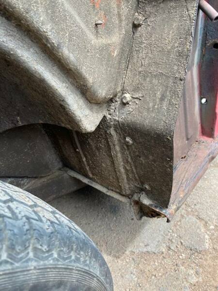

Story so far is that ; the inner panels, A and B-posts are in pretty good shape..  no unexpected horrors.  There's fraying to the rear wing bottom corner flanges, but nothing that will stop the world from spinning.  Driver's side sill is good but needs a few spot welds, which I knew about.  And the LHS foot-well side panel is detached from the sill. Again I knew about this.
Detached with no upturn flange. although there do appear to be rivets or perhaps lug welds visible under the underseal.  The sill being foam filled doesn't help, nor does the vent's plenum drainage into this area.
The sill's ends are also rusted on this side so the prospect is to replace this sill.  Driver side sill is in much better shape.
So far then, nothing devastating for a 54 year old car which was amateur restored 22 years ago.

The cracks around the chassis rear legs were imo repairable in-situ with the body on, particularly if i replaced that bridge, but it was seeing this attempt at welding from the underside of the car which led to the decision to have the body lifted off and to do the job properly.
^ Outriggers and rear-end-of-the sill body mounts in surprisingly excellent condition and the suspension was (subsequent to the original restoration) fitted with poly-bushes.   Body to chassis contact is evident in various places ...more clanking / vibration noises !   And unfortunately, the trailing arm poly-bushes were assembled dry (no silicon grease ?) and their bolts without Coppaslip ..so are seized.  Together these may account for the distinctive creaking noises from the car's suspension.   The bolts will have to be cut out and the poly-bushes replaced.  more cost !

^ This is the area of rear outrigger / diff & damper mounting bridge, I clean off from underneath, which more clearly shows the cracks I could see.  There may be something obscure about my spraying zinc/cold galvanising paint on this, but even for a short while I couldn't leave bare metal showing. :blink:
^ Body mounting washers &/or rubbers were missing and the body tub was chafing against the chassis in several places. Most would have just caused annoying rattles and squeaks, but this is the rear suspension spring turret.  In the bottom-right of the photo you can see a groove worn mostly through that spring cup by the rear inner-wing's flange.  Before very long that spring-cup would have cracked through.
^ This is one of the differential's mounting studs pulling out of the bridge (which also serves as the rear suspension spring turret).   I had seen this from under the car but, with restricted access, all I could see was weld splatter over weld splatter ..which I just knew would not have penetrated the metal to hold the pin secure.   My Tr4 engine has just 105bhp and 128 ft.lb of torque (on a good day) ..which is considerably less than a tuned Tr5 or Tr6, but still.. just the torque through the drive-train, pulling and twisting at these pins, cause their mountings to crack and rip out (.. so common on each IRS TR model - that it is a usual place to reinforce).

OK., NOW SOLD     FOR SALE - TR4A chassis  (easily modified to TR5 or TR6 spec).     Just a thought ..and I have OK'ed it with Mark before I suggested this..  it is available for collection from Wolverhampton, or in a few weeks time from Ipswich, Suffolk
I don't wish to discuss prices on an open forum,  but as a starting point the chassis replacement I've just bought cost me £2,550 and that had also been welded (those being aside from the modifications I subsequently asked for).  A new replacement chassis from CTM is I believe in the region of £6,700 + collection costs, with present delivery being ; six months to one year.
Emotion of the moment of discovery aside., an impartial look at these photos would suggest that my car's chassis condition is generally very good.  However, its damage would have been difficult to repair properly from underneath with the body on, as indeed it would have been nigh-on-impossible to do the stiffening-mods I specifically asked for.  Having seen numerous other blogs of TR4A - TR6 chassis ..in far worse condition, being successfully repaired.., if I had the space to do so, then I would have lifted the body off my car, repaired the chassis and refitted it.
And had I taken on a project TR, as I had originally hoped to do, then again my intent was to first restore 'a spare' chassis and then to transfer assemblies across, one at a time as they were reconditioned.  Much easier IMO than taking everything off and then being confronted with a huge mixed-up jigsaw puzzle of loose parts.  I've been there done that with motorcycles ..which take up very much less space.
Personally speaking, I would have locally cut out the old poorer-quality repairs (..which have only lasted 22 years road-use since restoration) and inset new metal. And then with shiny clean metal (clear access is the key here) and the chassis rotated to a position where welding is easy - I would have every confidence that the repaired structure would be both strong and would have been barely discernible.  Btw., I had been offered a replacement rear diff mount (after-market tubular section) and so would have fitted that.
Mark is going to send me other photos, now that the chassis is completely stripped down, but as far as I'm aware there is no evidence of accident damage nor of any place where the chassis has rusted (not even pin-holes) through. That is unusual, even with many US cars where the T-shirt plate conceals rust and the trailing-arm outriggers need replacing.  The rear legs of this chassis may  have drooped (can't really tell because some body mounting rubbers or spacers were missing - the cause of surface chafing), but either way I honestly believe that this would have been easily corrected in the course of general repairs (dimensions in the workshop manual).
Anyway., these things are for you to determine for yourself.  I can forward Mark's photos of the chassis, as it is now, to anyone who is seriously interested in buying.
Please contact me in person via a PM.
