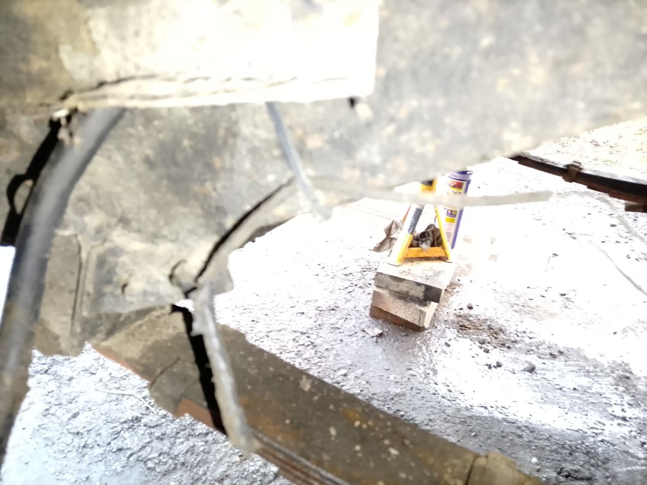

To aid access to the tank for removal, the exhaust would be better out the way, which is ok as it is past it's best...
That split has appeared over time, as my right foot has got heavier!  Initial plans are to remove that silencer, replacing with stainless pipe... let's hear the old six pot sing!

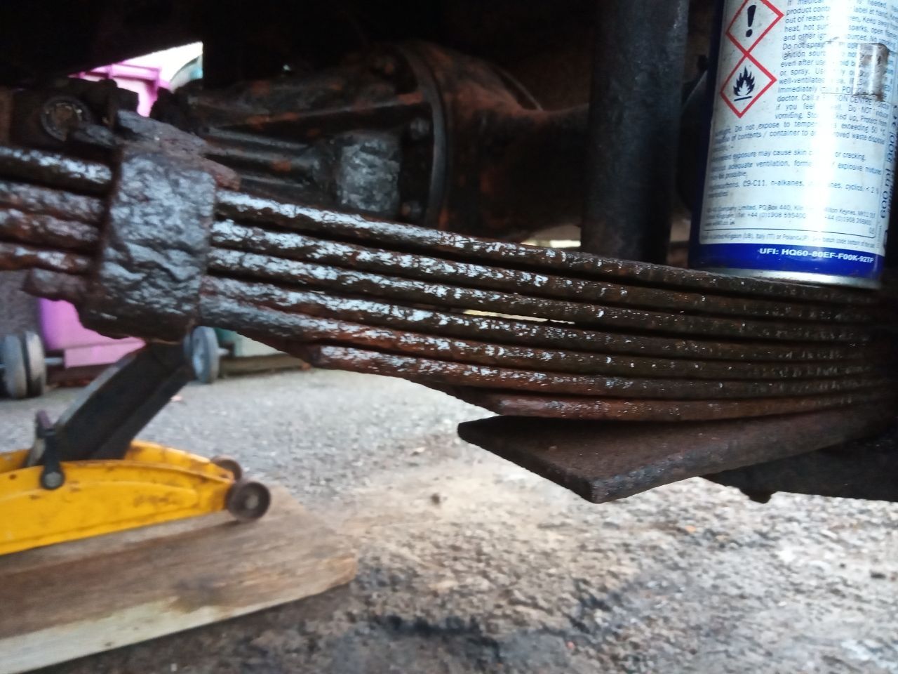

The only other thing I want to do this time is clean/oil the leaf springs, they seem fine, but I'd like to preserve them as they don't have the Gucci wee covers I've seen on some.

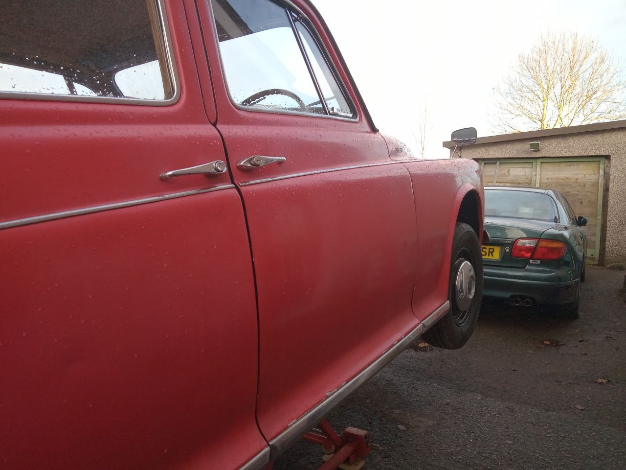

Further works this morning...
First off, I removed the drain pan from under the tank...
The true state of things inside there is obvious after a bit of settling, urgh.

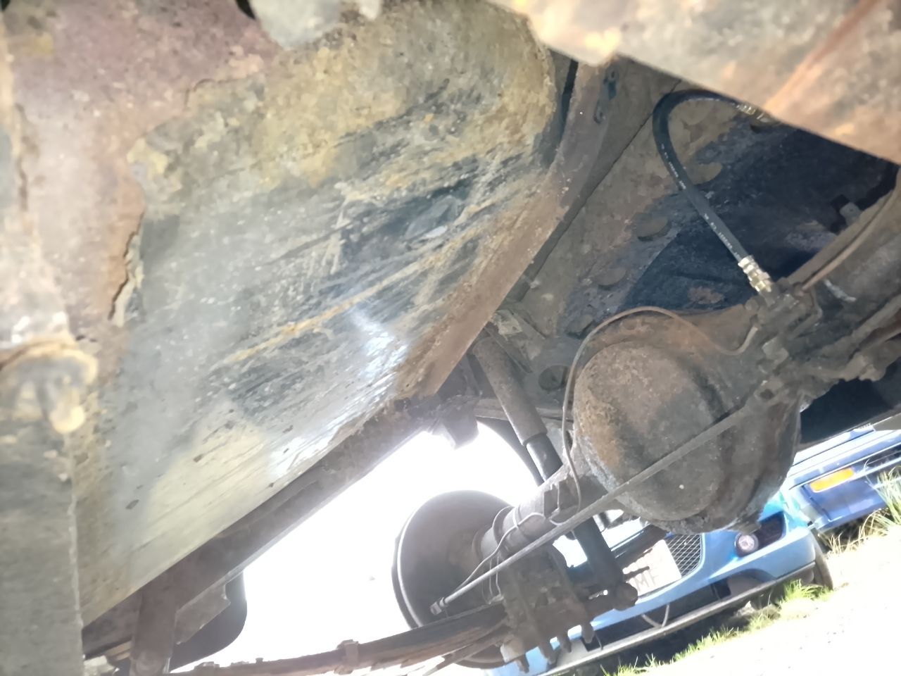

I then set about removing the exhaust, from about the A-post back, as that's where the joint is.  I'm planning to re-use the flange and a small straight section (which will provide the original sprung mount), before making the rest up in stainless.  I'll add silencers as I deem necessary...!
Loads of space underneath now, and good access to the tank's four hard mounts.  This'll be dropped out tomorrow if the weather's still good.
Generally great underbody condition too, probably the best non-aluminium car on fleet to be honest!
While the weights off the springs, I've given them an initial wire-brush and WD treatment...
They seem alright.  Small steps I know, but 'tis the season, so lots of family commitments are dragging me away even though I'm off work!

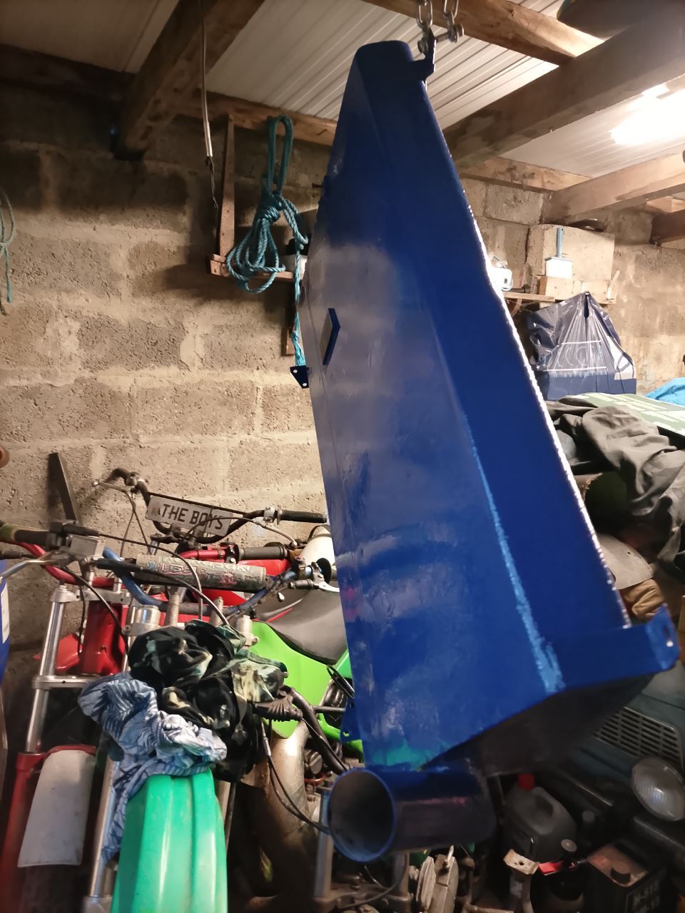

I'll paint the outside before refitting, but it honestly seems solid, with hardly any rust.  I saw one of the P4 suppliers had a tank online, an aluminium one I think, but it was over £500...
Well, I didn't really plan this tank job too well, with work shifts taking up most of my waking hours yesterday and Thursday, it's been on the boil for a week!
I've been nipping in to the garage each night to remove, clean and replace the anode though, and every day it pulled more rusty goodness out...
(You can't just switch it off of course, otherwise it's just a tank of salty water!).
Anyway, I've been out today and emptied and rinsed it out multiple times.  The water now comes out crystal clear.
Next step was a thorough drying out...
...followed by a quick wire-brushing.
I'm planning a coat of rustoleum before it goes back under, but that'll be tomorrow's job.
Painting completed...
Blue is the colour, as it was the only Rustoleum tin I had!
Adds a bit of 'racecar' I think, and no-one will ever see it (all being well!)...
I then gave the old girl a wash with my new snow foam thingy, finished up just as it was going dark...
Slow progress in these cold, short days...
Northern lights over Old Red tonight...
I'm taking it as a positive omen for her 67th year on the road!
