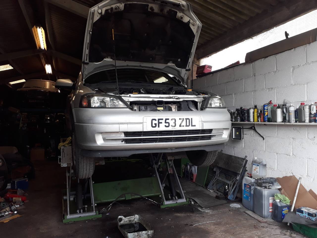

With the Astra past my usual change interval and rapidly approaching 180k some of the finest 10w40 and a new filter went on. I said to my friend id drop the oil and while thats dripping every last drop out ill change the engine mounts on the VP1300, well. . .
It had at least 3 hours to drip, because though (still not finished) mounts were just a pain in the arse.  And the concerning crusty rad now leaks, bumhats.

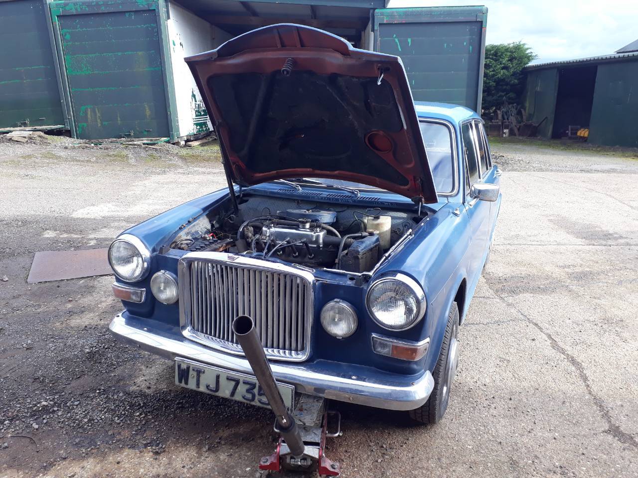

Few bits picked up from mini spares as i was passing. Key one being an exhaust clamp as i couldnt get the exhaust too seal now the mounts have moved the engine where it should be (it was blowing before)  and a stat gasket.
New clamp on , Exhaust still blowing. flange is miles off from going on straight and stat housing stuck. Balls.
With the sun out i stripped out the old rad and numerous bits bolted to the engine. the cacked on oil and grime taken off.  Parts were cleaned up and some cases a quick and dirty paintjob given.
Back to minispares a few days later. New stabilizer bushes (poly for the lower and rubber on the uppeelr), new stat housing and overflow pipe and a few other bits.
Wire tidy and the coil got a neat little boot. It didnt need it. I just wanted it!
  • Like 8
Old shite new trick.

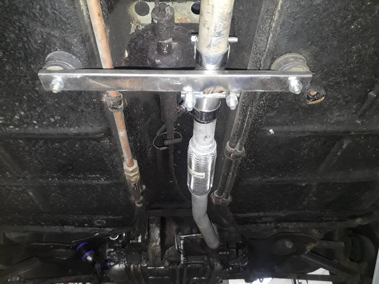

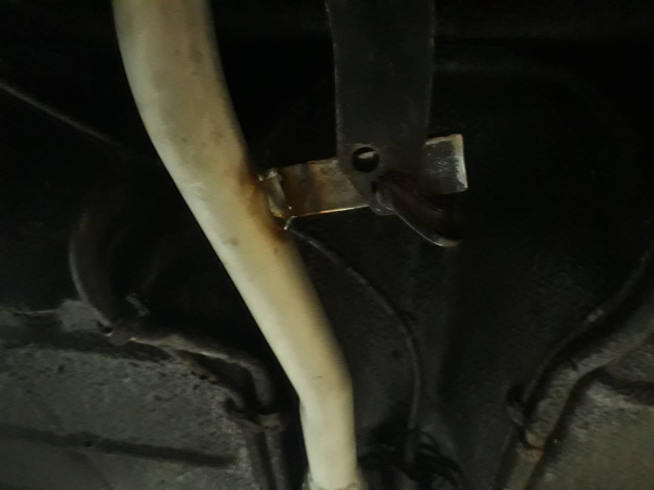

A quick google suggests any A series with this down to manifold flange style struggles to seal. And if it does seal after a while it will blow again as there is no flex to exhaust appart from bending it.
With new mounts and beefed up stab bar bushes id guess we would probably be okay for longer if i could get it to seal. However the part on the exhaust came in at the wrong angle in my eyes. And was barely sealing one side. Maybe tweaked from the engine moving about alot before.  So bollocks im cutting it. Choppy choppy.

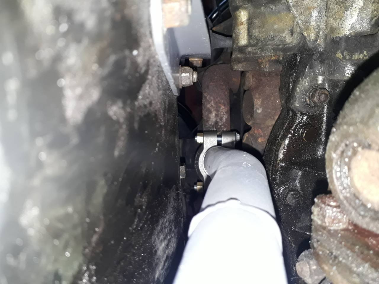

A snip on the down pipe part and i bolted the flange up as inline as possible. I then cut the first curve off and tweaked that a bit so its pointing in a direction i was happy with.
As far as im concerned the exhaust would benifit from being isolated from the engine like a more modern motor so having found just one seller on ebay i ordered the smallest flexi ive ever seen at 32mm ID. Also a sleeve so i can make the single piece exhaust into two, so its not a massive arse to move about when fitting.
It would probably be fine as is but some Additional brackets and mounts will be welded on to the front part of the rear section to  support the exhaust so the flexi isnt under a downward load
Im told the new exhausts fit well but given this so far has cost only 40 quid in parts and the new systems are very pricey, im Hopeful this will be a reliable cure to a common problem, but we will see.

Welded on a tab to pick up on the engine support. Just g clamped for now untill ive run the car and know its not blowing from the joint.
Stub of pipe welding into the flexi, the onto the car and sleeve clamped up.
Next time ill weld on some support mounts and ill call that done.

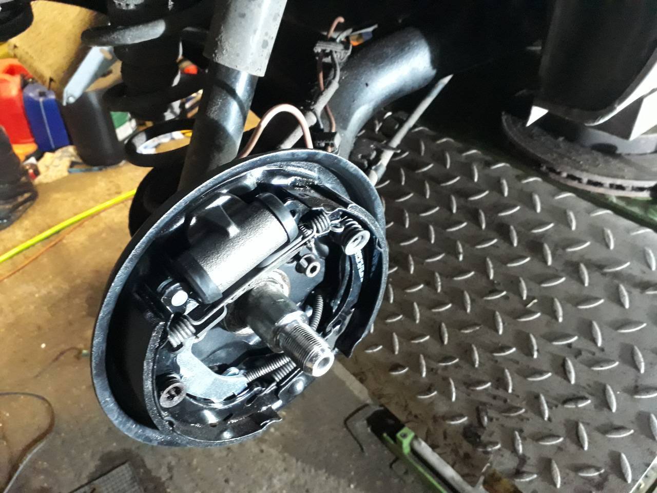

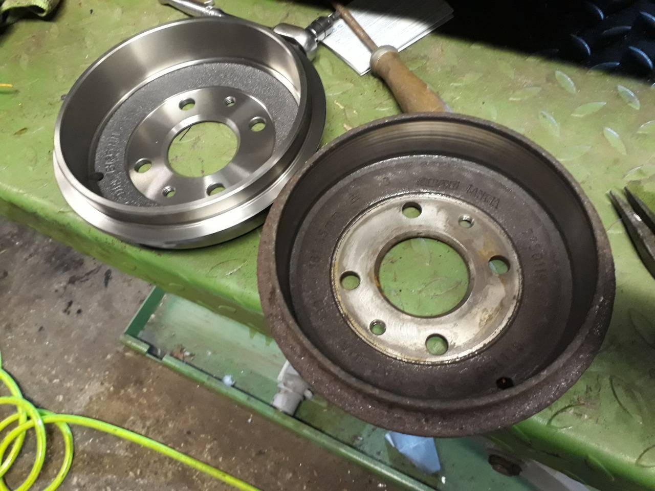

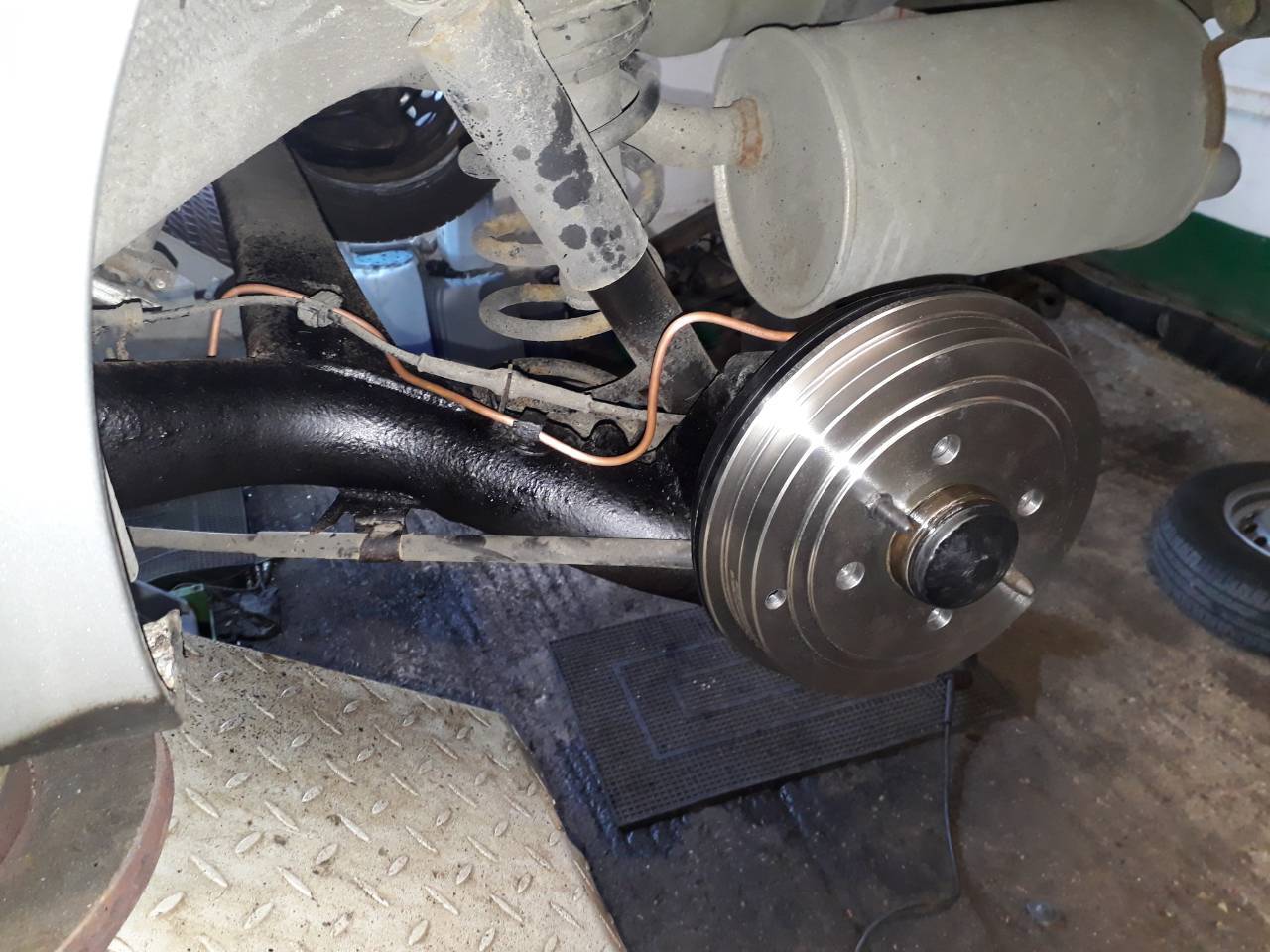

On the last look over id noted a duff wheel cylinder, the drums are original and pretty well worn now given the cars miles.  new drums, shoes and cylinders ordered in, forgot a fitting kit tho.
Bosch are actually cheapest for these as they are the OEM manufacturer.
The back plates were very crusty so i unbolted the wheel bearing, and the back plates got taken off and hit with the knot wheel. The axle was given a quick go over with the  needle scaler and then wire brush before a splash of shultz. Im not a fan of this stuff but it has a place.
Having done the KA2 previously in this thread id already experienced the seized union on the brake pipe so just went straight to making two new pipes and cut the old ones off. Id like to have done a neater job but i was getting pushed for time today after doing the doblo and VP this morning.
Back plates bolted on and pipe installed.
Shoes and adjusters fitted.
New drums on and a tweakof the  handbrake. All seems okay, ill paint the drums next time ive got the car on the lift. Finished around 10pm and dropped the car back.

Today see the last (for now) of dicking with the exhaust. The mount picks up on two existing bung holes. A simple bit of box section with an exhaust clamp  zapped to it. I want to weld the sleeve to the front section of exhaust to loose that clamp as its persistant on leaking. No exhaust paste used on anything yet untill i a few miles proves its working.  May try and make the gap between the hydo lines and the exhaust larger too.

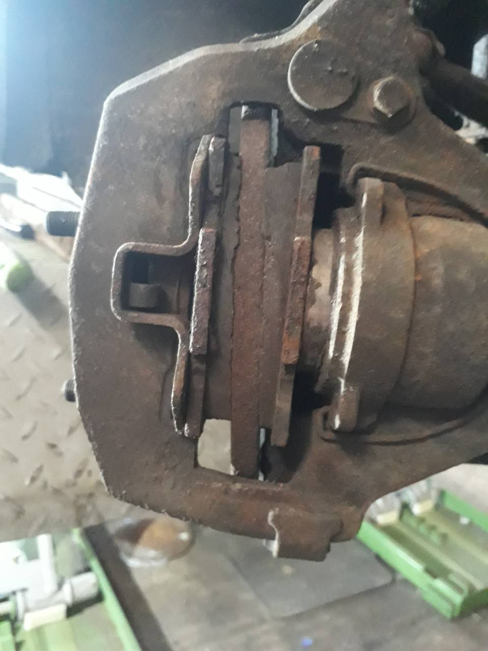

Time to get a few miles under its belt then. *Turns wheel while cars on lift* Ohh is that a stuck caliper? Guess im going to be visiting minspares again for brakes.
Ohh what the fuck is this design all about.
The swinging caliper design it seems of which EBC are the only people that make the correct wedge pads at £57 and Bigg Red  make a rebuild kit for £60, ouch.
For now tho. Slung back together while i wait for all the brake parts to arrive as im bored of this thing being on the lift.
Yeah the MK2 onwards have the swing calipers that were only ever used on the ADO16. I think the MK1 was MG Midget calipers.
Longbridge Motor Spares do rebuilt calipers too.

I was expecting the earlier cars to have been mostly mini but after offering a caliper up found this not to be.
Also noted the brake hoses are like this at the front and looking like originals at the back. I think mini at the rear will do and ive got some for another bit of BL tat which should work but just a smidge longer, while complete Ado16 set are avalible on ebay the 50 quid price had me hunting for alternatives via work coming in around half that.

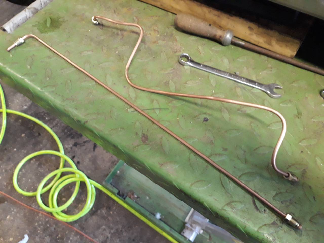

New brake pipes all round going in so not an issue.

With news flexi hoses and the car on the lift the hardlines looked a bit crusty. Assummed original, were they going to fail soon? Probably not but i have the tools and the copper pipe (omg teh kittens!) so new lines run all the way to the rear subframe. Rear onwards is the next job on the list.
Yes that rusty bulkhead looks bad ive wire brushed it back and yes it is bothering me too,  But for now lets just sort the mechanicals okay?.
