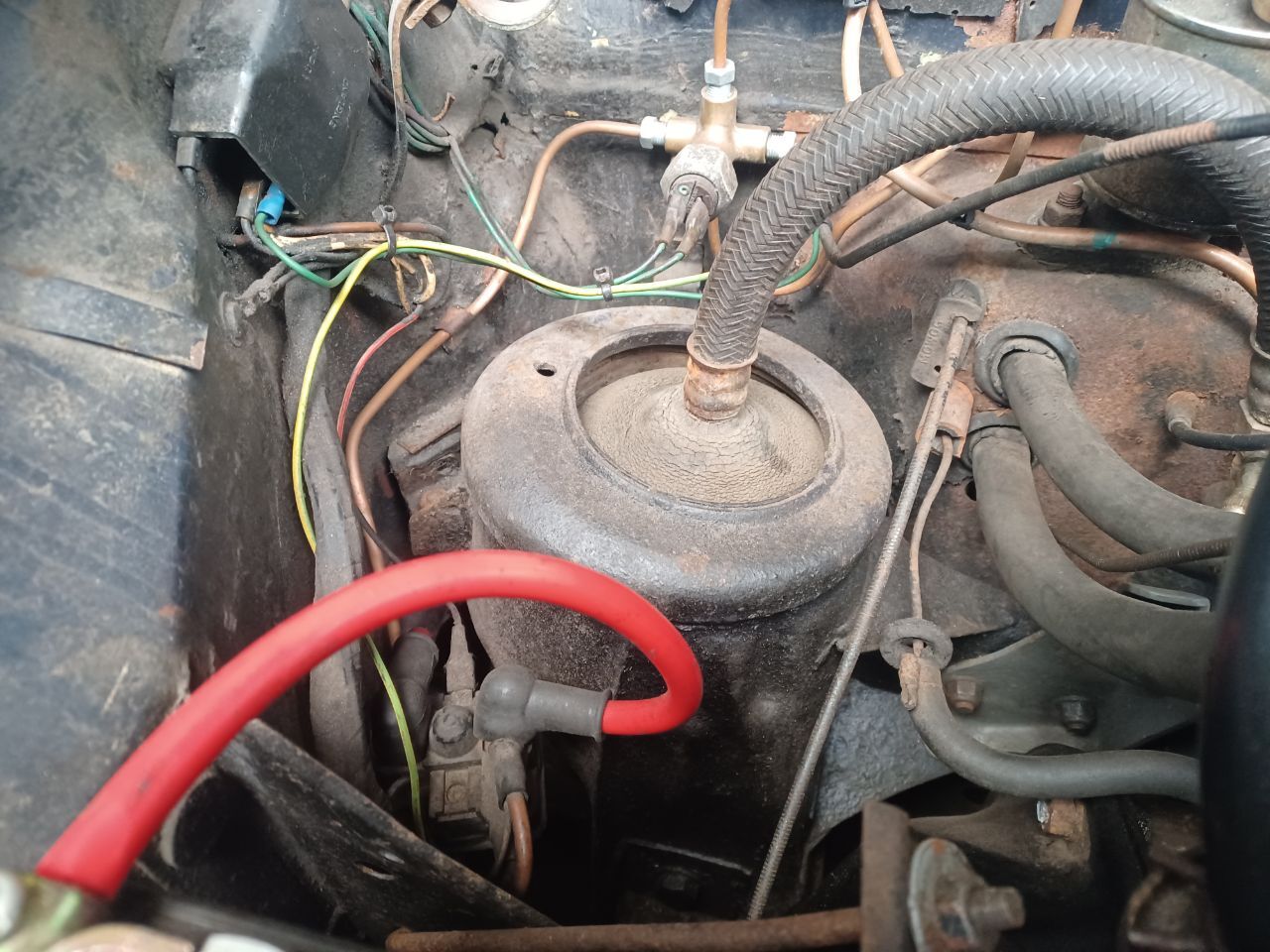

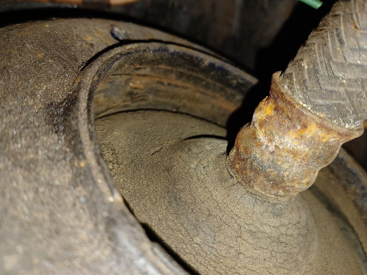

Displaced-er?
Before leaving for Scotland I'd noticed the passengers displacer was looking different to the drivers side.
The car was sat level so I assume the displacer is a little tired. However it may well still be tired still but today I spotted something else I've never noticed before. Looking back at some older pics of the engine bay on here it appears the two have been uneven for some time.
Today spot, Well that's a little skewed.
Sure enough the drivers side displacer displacer isn't seated correctly. So is sitting lower
system drained, upper arm removed. Displacer dropped down and reseated then re assembled and pumped back up and it's now sitting correctly.
Free fixes are the best fixes!

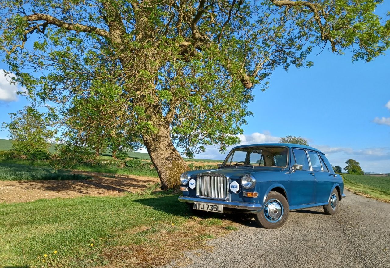

WTJ 735L The Vanden plas princess 1300
With this little blue beast leaving soon and the weather going a little grey for the rest of the week, i figured Id get one last photo and do a little review on this car.
Its Far far from perfect, and the questionable bodywork repairs lets it down a bit, but also it being a bit rough makes using it anytime in any weather with zero concern so nice. Over the past 18months This car has been a little trooper, Having covered somewhere around 3.5k miles in my ownership and never failing to proceed (looking at you Spitfire!) Its Never got hot, cut out or had fueling issues. It's just cracked on regardless, maybe leaking a bit too much oil at certain times but given that was after 1000+ miles over a few days i couldn't be mad.
The 1275 under the bonnet has been mega reliable, a little stumble at idle and maybe a splash rich, both Probably an easy tweak but as it's never given me any issues I left it as is. I can see why people like the A series engines.
The suspension was broken when I got the car, but a new hose fitted to a displacer later and it's been fine. Its very comfy and soaks up bumps no problem .
The Autobox then, it's a bit crude. But to me it's not awful, it makes the car amusingly charming and easy to drive. The fact ive done so many miles in 18 months shows its really not that bad. 83k later there's alot of slack in the drivetrain and reverse is a delicate procedure but if you treat it like a 52 year old gearbox with a weak reverse,I think it's fine. Again some tweaking could possibly make the box function better but as this cars been so dependable I just never felt the need to open it up.
The ADO16,  I can see why people like these, I'd happily have another (maybe check the subframes first) so if you are thinking of trying one just GIB!
I'll certainly miss having the little wagon around as its been the perfect jump in and enjoy car. Its been fun,I've had some good times with it and I hope the new owner will enjoy it, improve it, but most importantly take it on an adventure too.

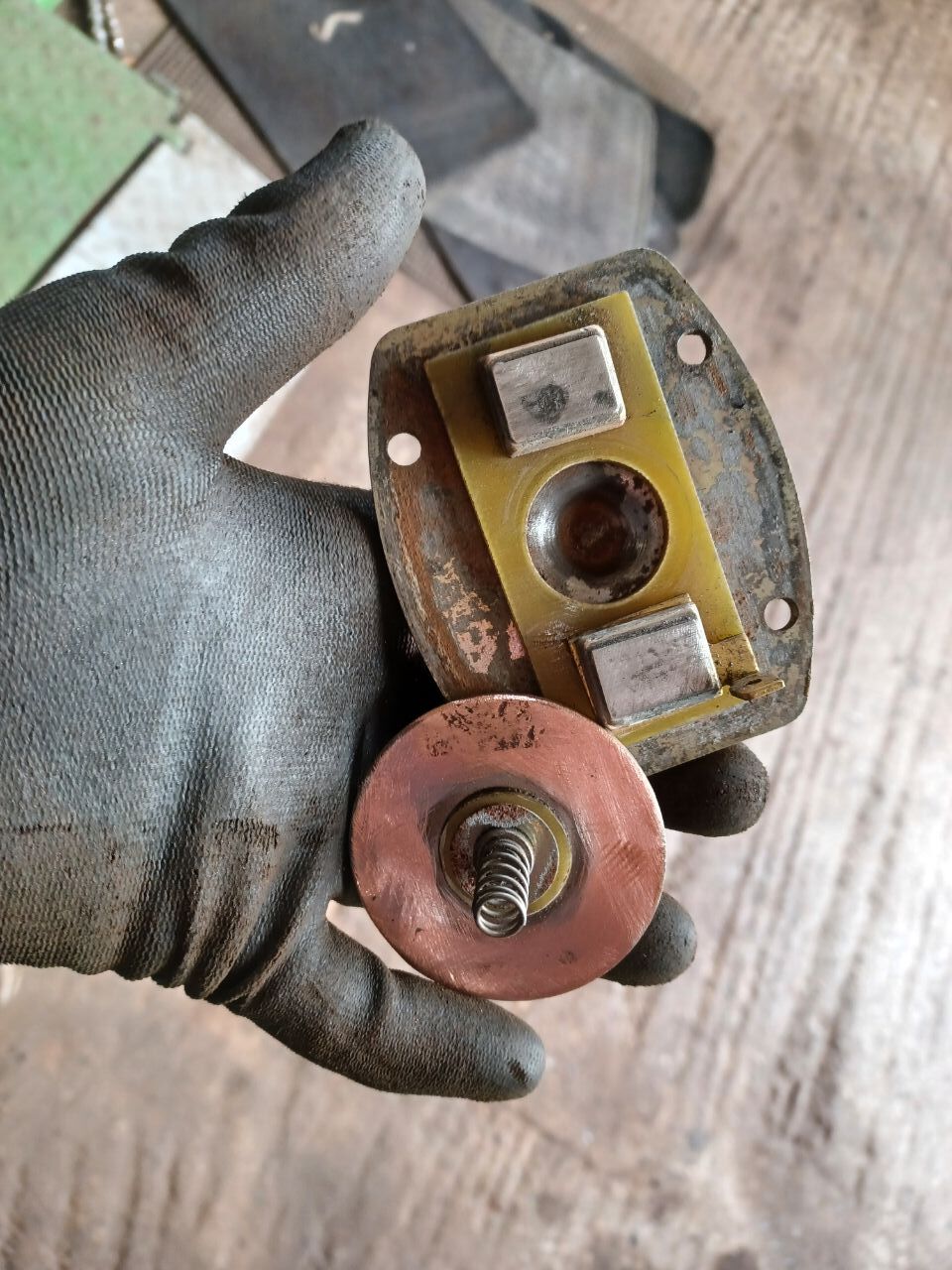

Today I helped my friend (and landlord) move one of his vehicles out so it can be sold. There was a couple of issues, one being a stuck starter solenoid and another a vehicle was sort of in the way, but when we went to fire that up it turned out that it too had a gummed up starter solenoid. Both used the same starter however one was much harder to access. Starter solenoid stripped and cleaned up got it running and after moving the blade on the first one, With some very skilled driving the first one was out side.
The starter in question is an absolute unit
the second vehicle while wasnt getting moved, now that we knew it didn't run we decided to sort the starter on that too. It however is a fucking monster of a thing. Access was me laying on the track and gained via the gap in the lower hydro ram and the lift arm.20250506_152949.jpg.6555d39a0cf2628d65ef15d406fc0388.jpg
Cleaned up
refitted, a bit of Heat and it fired first turn and sounded lovely.

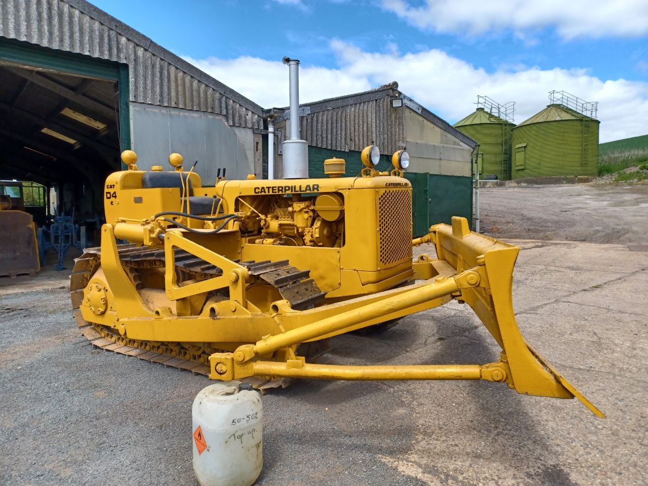

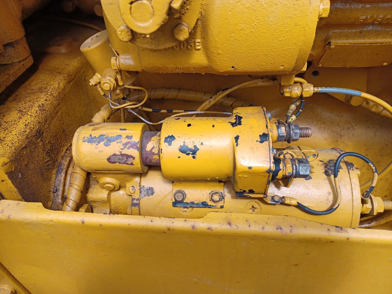

5 minutes ago, Andyrew said:
Same same but different
Today I helped my friend and landlord move one of his vehicles out so it can be sold. There was a couple of  issues being a stuck starter solenoid and another vehicle was sort of in the way, but when we went to fire that up it turned out it too had a gummed up starter solenoid. Both used the same starter however one was much harder to access. Starter solenoid stripped and cleaned up got it running and after moving the blade on the first one, With some very skilled driving the first one was out side.
the second vehicle while wasnt getting moved, now that we knew it didn't running we decided to sort the starter on that too. It however is a fucking monster of a thing. Access was me laying on the track and gained via the gap in the lower hydro ram and the lift arm.
Cleaned up
refitted a bit of Heat and it fired first turn and sounded lovely.
Is that ex mines appearing to be low ? (The second one with the loader shovel on the front)
Unfortunately  im not sure on the history of these big buggers

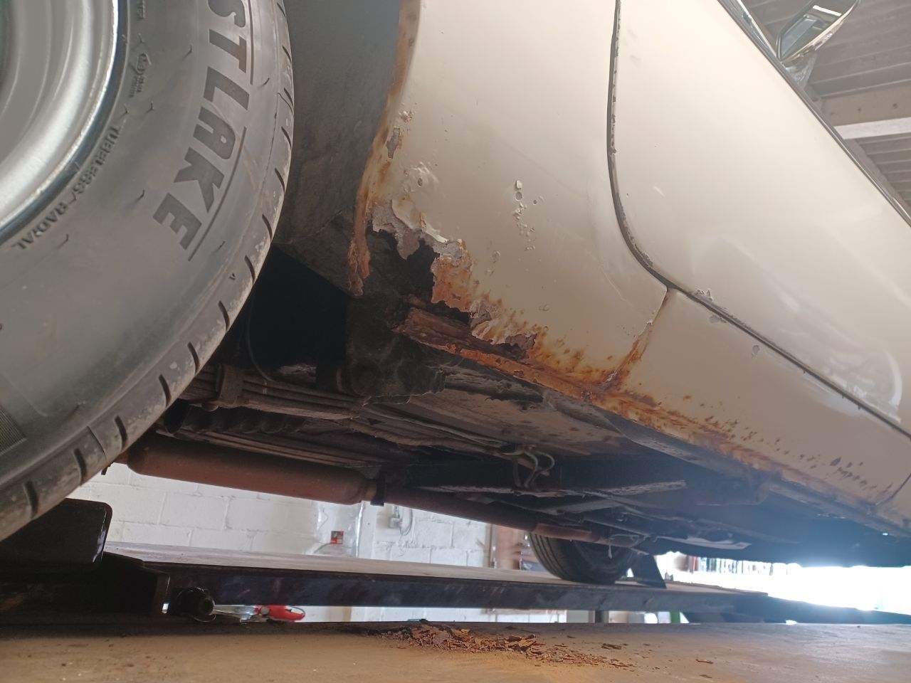

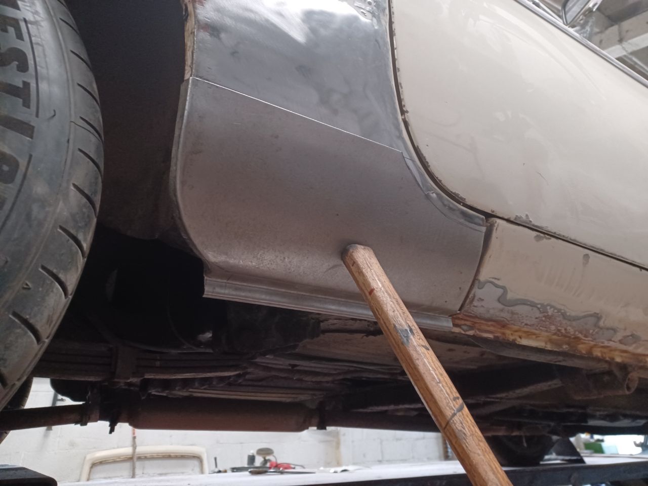

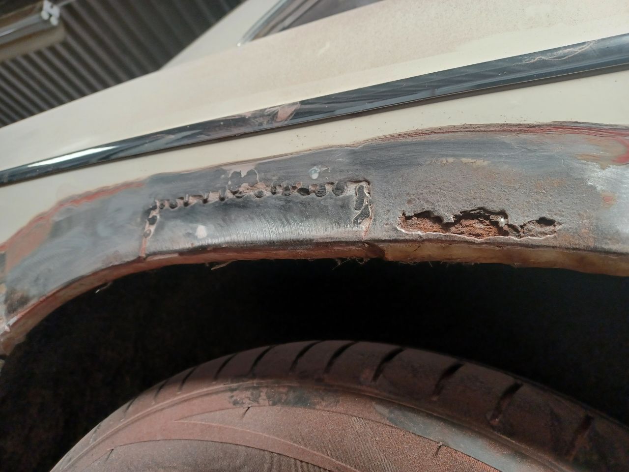

Okay, so it's not great, but neither is the whole car. Ideally it needs 2 full quarters but while I'm glad they are avaliable, I'm not spending 200 quid a side on this car, for them.
The lower part has already had a proper quarter repair panel welded in and they have absolutely warped the shite out of the joint hence all the wob. These are available for about 60 quid a side, fairly reasonable. However I have sheet steel already , a sheet metal folder and a selection of hammers so let's just make one for the cost of some time and effort.
Some more tweaking to do but now I can start chopping the old bit off too access the grot that lurks behind.

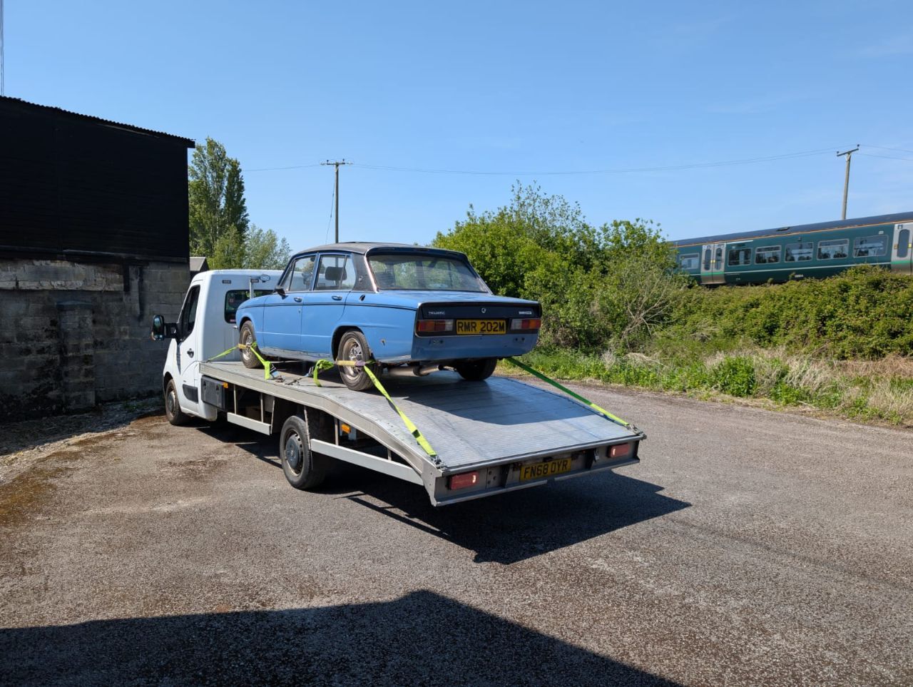

This morning Dave arrived to collect the VP for it to go to its new home.

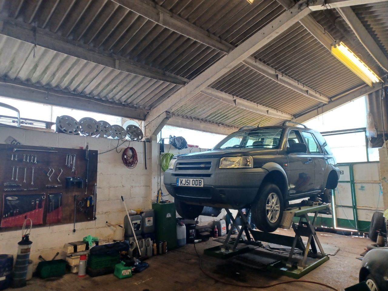

The freelander returned for some rear brake work and a worn out drop link

Finished the day with a little metal shaping on the MGB and knocked up a repair sectioned for one of the wheel arch grotty bits

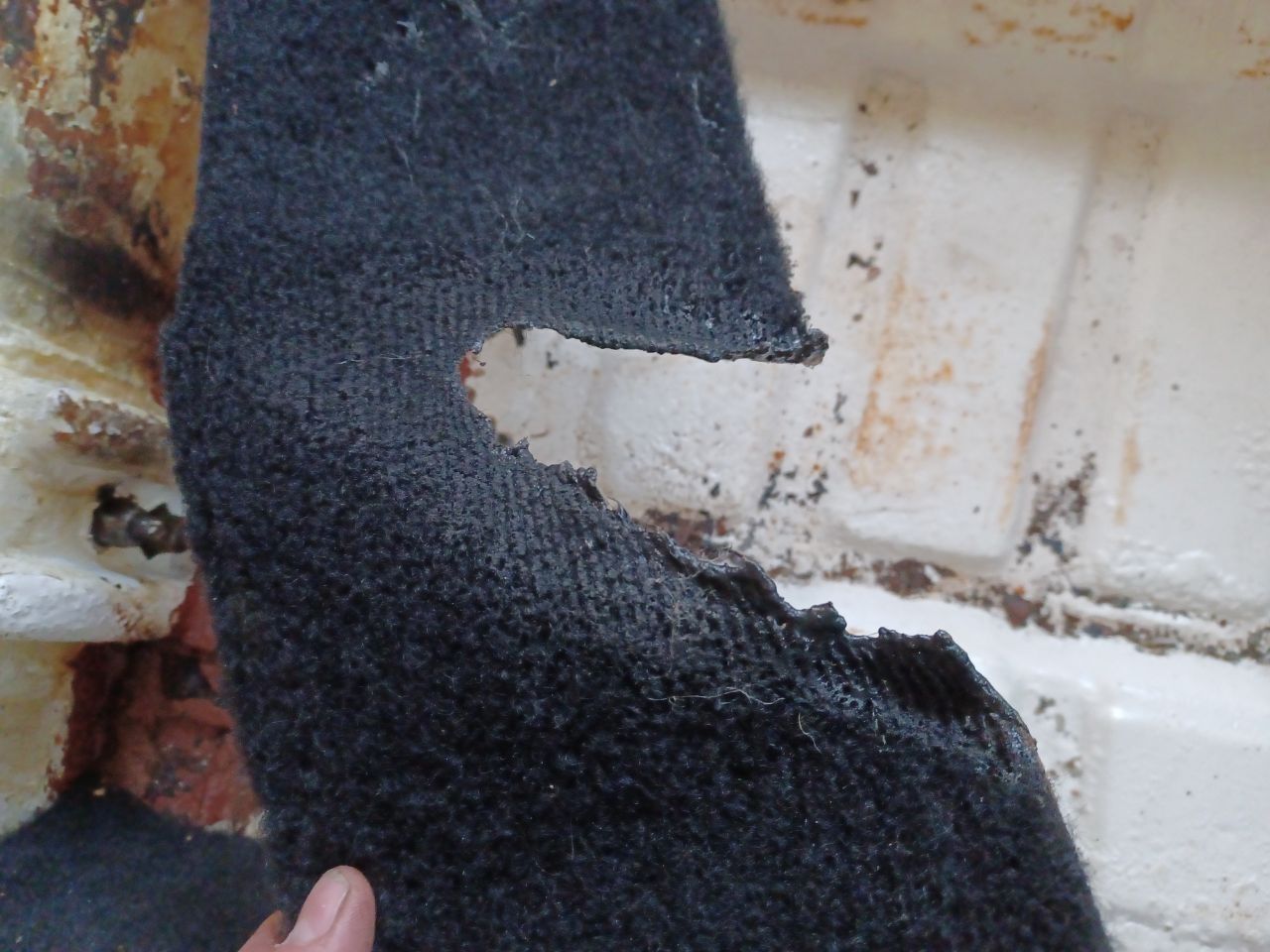

The rear quarter panels were just a warped mess, holes in then, shrunk and nasty. White overspray too

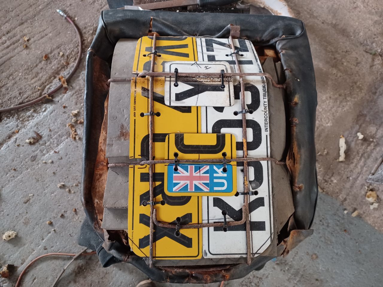

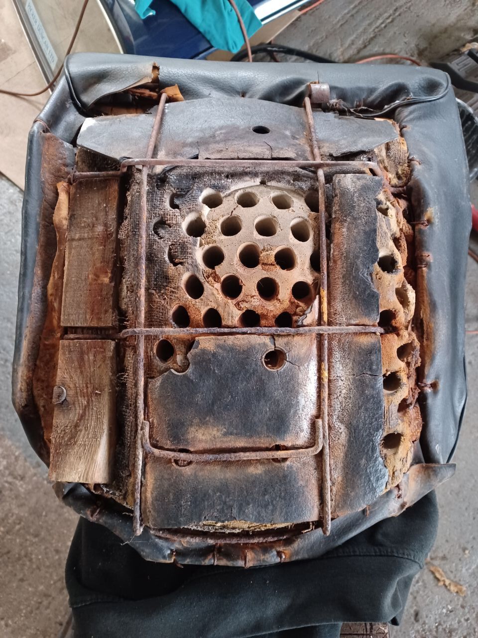

The drivers seats had a hard time, the seat frame its pretty knackered, possibly twisted , The vinyl torn and the foam collapsed. You can buy new sponge kits and covers, Used decent frames come up from time to time. However all in probably looking around 800 quid. I don't want to spend 8 quid on this interior so Let's have a look at what we can do. The woods an interesting touch!
Thankfully after fixing the VP seat I now keep seat repair kits in stock at the workshop.
