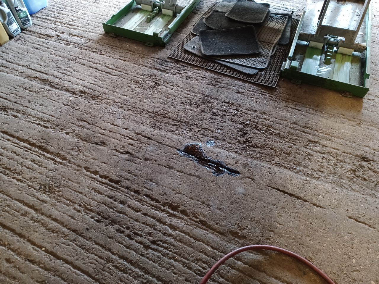

The chuggy buggy appeared the other day and it was noted that its leaving concerningly large oil patches on the ground, its always had a small weep from the bellhousing which we filed under ignore, With upcoming busyness this weekend seemed like a last min good time to have a look, I'd already collected a seal from my old work at the same time as collecting the replacement (correct) thermostat housing for the Mondeo, i however didn't check the seal until the car appeared and seems my old colleague got me the flipping timing end. Fuck sake.
Quick nip to a local MPD and they thankfully had one in stock and I even got a cheeky discount , nice!
Below we can see the size of the leak, that's about 12hrs worth of parked.
Right then, let's remove some shite.
One bolt had picked up a thread and put up a tedious fight, I shit you not it was the last bolt. Everything else went smoothly. Anyway after wrestling it out and calling it all the curse words. I cleaned out all the shit inside the bellhousing so the gearbox is ready to go back in.
According to the writing in the engine bay a clutch had been fitted at 65k, cars on around 100 k now i think, with an upcoming wedding for the owner it was decided to just re use the clutch. The flywheel had marks showing it has been off before so looks like the crank seal had been done before.
A quick spritz of brake cleaner and a wipe over later, it seems our seal isn't to blame hear but the oil gallery bung was just completely loose and it just wound out by hand.  The crank seal is going to be replaced regardless as a just in case as the seal was clogged in shite so it's probably has a bit of a hard time in there.
Bung cleaned up and I put some threadlocker on and nipped it right up.
Leave that for today and fight the gearbox back in in the morning.
