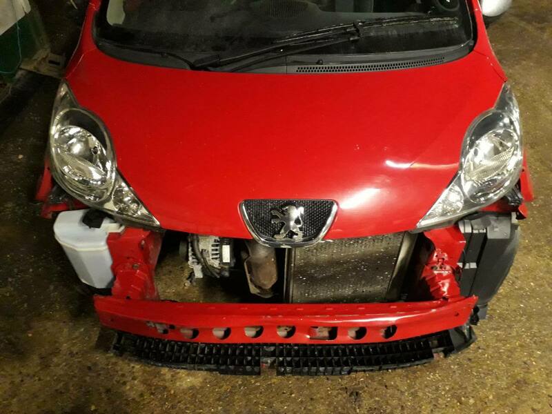

Front bumper off, engine bay degreased and given a quick rinse
Shitting Nora, taking the front bumper off that is like removing the front end off a Triumph Herald!
When the little pug was collected the  o.s headlight had a hole in it so a replacement was required.
To an automotive tight arse like me These are fairly pricey, the cheapest i found was 30 quid as it had one broken mount. It turned up with another bit of damaged and i recieved a 6 quid refund.
As seen in the other post the replacement the headlights have now been polished up.

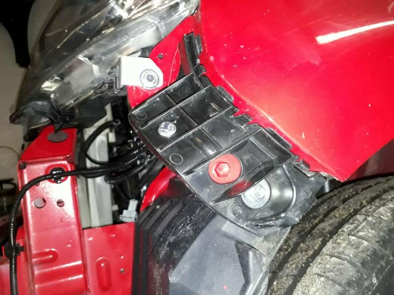

When the bumper came off the n.s had the same broken mount issue. having used glues in the past to almost zero success on other cars, i just knocked up two little support bracket
The bumper brackets, were also cracked and busted. Seems they are fairly common and easily avalible at 8 quid each but again i just opted to neaten them up and nut and bolt them in place rather that the shit plastic clips
Replacements probably wouldnt have worked with my headlight brackets anyway.
Nice bolts and washer. No wanky clips.
Also cheap!
