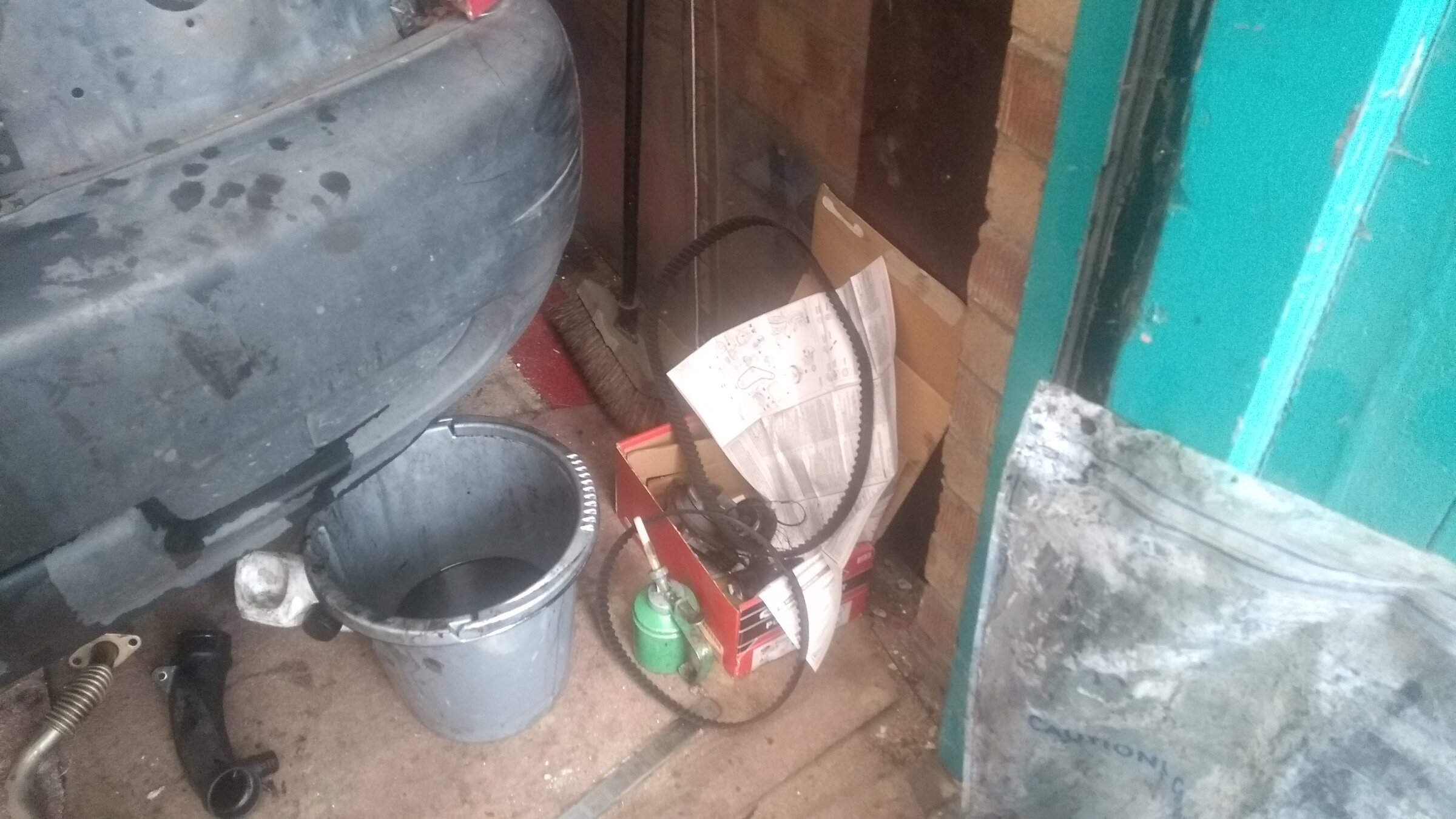

DaveDorson Posted May 3, 2019 Author Posted May 3, 2019 Well, found the source of the oil leak.  Cooler missing a bolt so not sealing, done the gasket while at it as it's a common failure.   Rocker cover gasket missing a bolt, also replaced.  The water pump was well shagged, but given I'm doing the belts it made sense to buy a pump too so that's being changed also.  Coolant flushed, found another grotty water pipe so new parts now ordered.  Now to wait for my bits to turn up so we can nail it back together. stephen01 and LightBulbFun 2

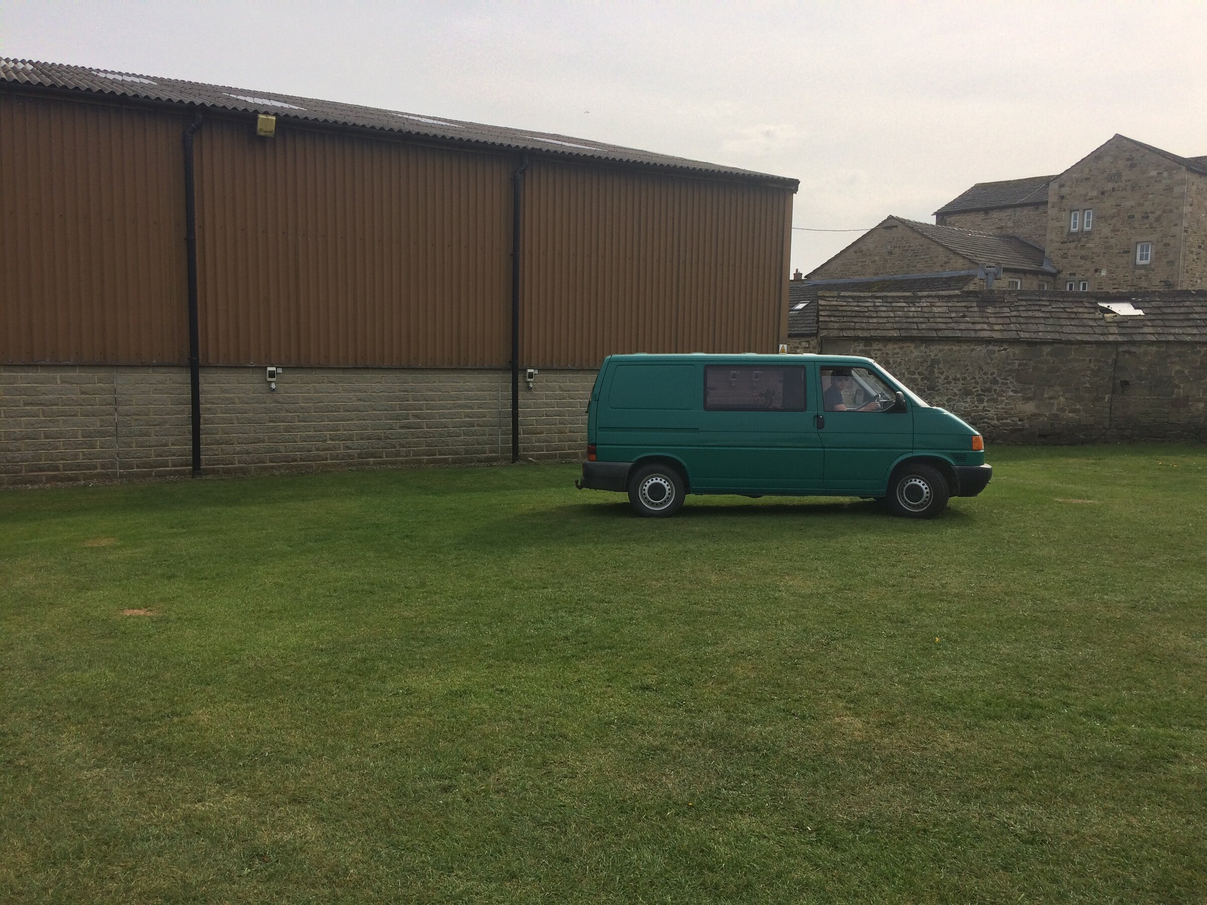

jon.k Posted May 3, 2019 Posted May 3, 2019 I got one of these in similar circumstances this year, but I’ve been too afraid to put it on here because it’s actually not shite. I’ve done the clean, service, tidy, insulate, line and add a battery and lights. Best mod though... factory cruise control stalk just plugs in! we even went camping on a campsite for a night. mrbenn, BeEP, Dirk Diggler and 3 others 6

DaveDorson Posted May 7, 2019 Author Posted May 7, 2019 Belt are in with new stuff, found the remains of an old auxiliary belt in there too. ?.  Looks like it's got a recent new set of aux tensioners and a recent bottom pulley as well as a set of Sachs front shocks fitted. Nicely.  While it's apart it makes sense to see what the old EGR has done to the inlet manifold...  It's a bit grim. Currently the inlet is soaking and will get jetwashed clear, the small deposits you see are from the egr valve only..  Turbo actually doesn't feel like it has any play, it's free too so I might have a spare one. The boost pipes were best described as badly fitted though (read, they were hanging off).  Oil leaks, well if it has an O ring or gasket it's shagged so they've been replaced now.   LightBulbFun, Cavcraft, dieselassist and 1 other 4
