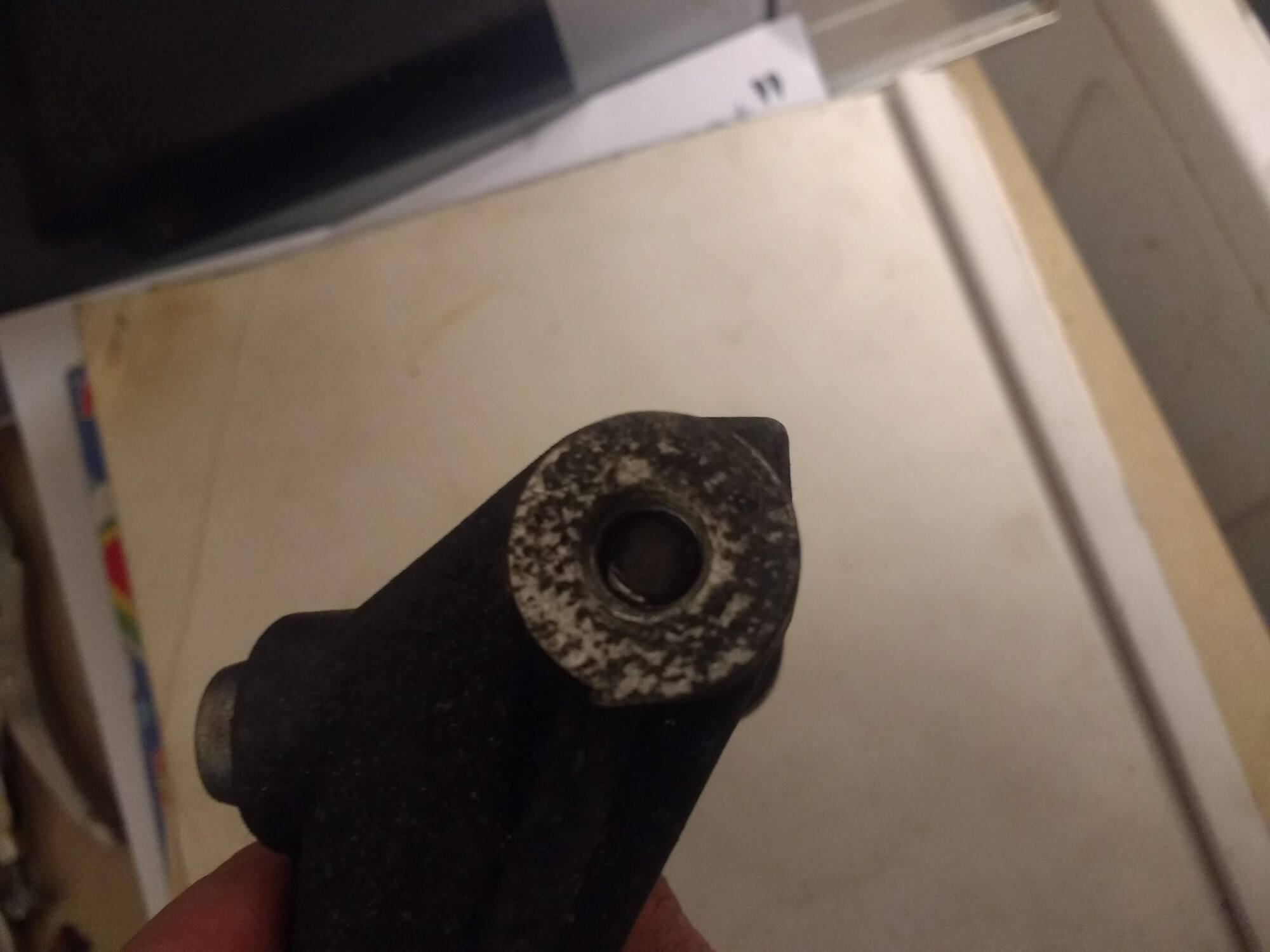

After a bit of faffing around I was able to 'set aside' the 214's alternator (read: wrap in plastic bag and leave in engine bay as it wouldn't quite fit through the narrowest of gaps) . I was then able to coax the bracket away from the block.
See this ? Unobtainium, that is:
You can see where the bolt that holds one side of the alternator in place has sheared off:
Awkward place to get to, need some mega thin pliers
Nothing doing up top, well re-cessed, so plan B will be centre punch, centre drill, left handed drill bit. Soaked in Plusgas, and I'll have a crack tomorrow night when I get in from work
