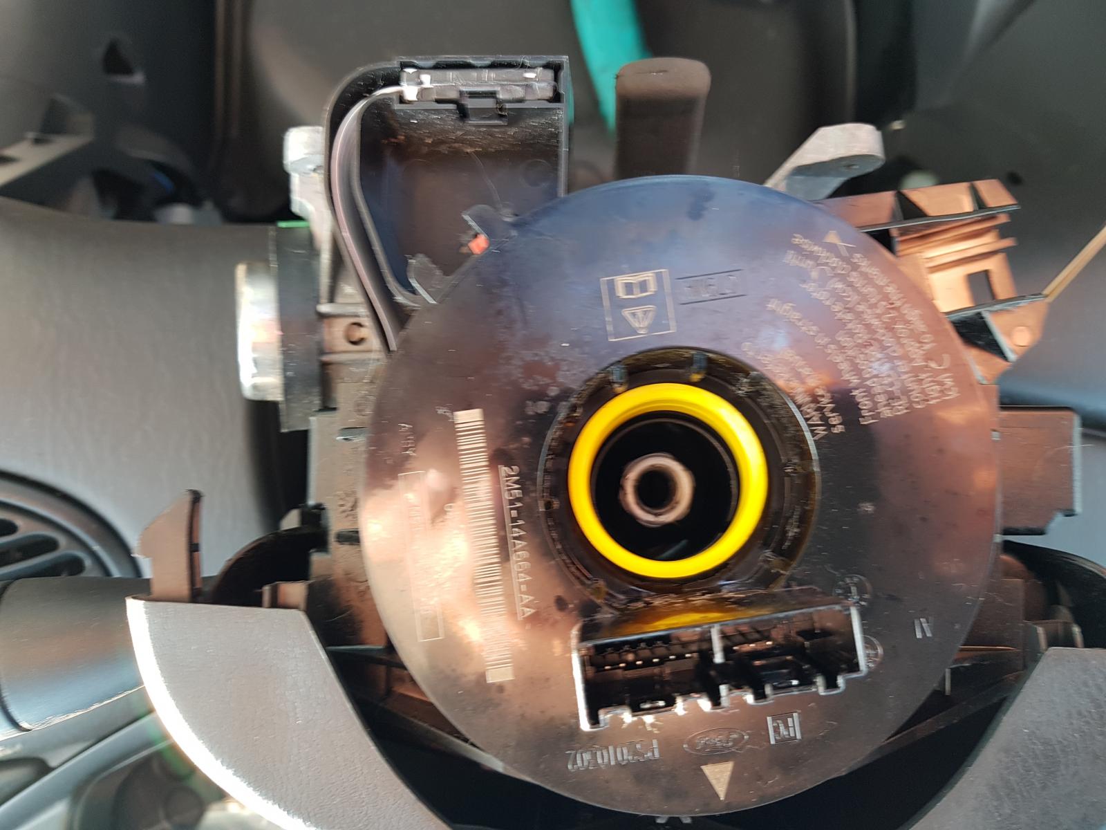

So - I removed the air bag and then undid the 24mm bolt holding the steering wheel to the column. Removed the wheel. There was a bang!
Here is the result
For the uninitiated the metal ring in the middle is the end of the steering column. It should be proud of the black plate by a fair bit. Why did that happen I thought, Ah! The ignition key was in the lock and it was in position 1. Should have been out and the steering lock engaged! NUMPTY
2 hours trying to get it back up (phnarr) to no avail.
How to fix it would be most welcome:-
Ideas, prior knowledge (Go on admit it you did it too), ridicule, postcards, it's fucked, what the bloke from the pub said, etc,etc

No airbag. twas already off so Mechanical bang.
Would rather avoid changing column as take too much time.
It's apparently spring loaded, and can be pulled back up with a threaded rod, in order that you can insert a SMOLL plastic stopper.
Most people give up and buy a steering column from a scrapper.

Can you not get a longer bolt to pull it up, then insert a screwdriver in the hole further down the column that lines up when the column is in the right place, as loserone says above?
EDIT: Will post a query on the Focus FB group.
that sounds a good idea to try ..threaded bolt to pull it up and some one to wiggle the front wheels to see if the lock clamps it ????
Yes I can. Not until next week though. The spring is a strong one though and I do not want to damage the clockspring. Anyway I could not see where the plastic stopper was to stick a screwdriver/bolt in.
Can you get your hand under the dash and push the column up while someone else gets the bolt in?
I did wonder if moving the column around may relax the spring a bit ?
I have tried. The only bolt I currently have is fine thread thing. The thread in the column is a metric coarse thread so it just locks in on it. therefore I have to be gentle.
The spring still sticks out by about 2cm
Someone on FB has mentioned the lever which lets you move the column, guess you’ve tried that?
Otherwise it may end up needing the column swapped ????

Chap on the FB page posted this:
It’s possible to do but difficult.
I pushed it up as far as I could which got it fair enough up to get a bolt on it. I then put something to stop it dropping back down.
On the longer bolt I pulled it up more and then used a longer stopper.
Gradually adding more and more spacers to get it high enough to get the standard bolt back in.
Can also pull it up once the steering wheel is bolted at least to help move it quicker.
It’s a pain but doable.
Well its back up.(insert Finbar Comment here!).
Took the column assembly out of the car looked everywhere for a bolt hole, remains of plastic stopper, thingmyajig in a hole and finding no trace. Staring at pictures on fleabay to see if there was something missing. I decided to have a go at getting it back up. At my age this is some challenge!
So ignition key in position one, holding the column frame between me feet sit on the garden bench and pull on the bolt with a pair of molegrips. Expecting to rearrange my teeth when the tiny bit of fine threaded bolt engaged in the coarse threaded column gave up the fight.
A couple of goes a bit of jiggling to get the right spot and it came up far enough for me to remove the key and the steering lock now holds it. Sill got my teeth I thought. Will it stay there! Quick get it into the car!
15 minutes later. Well nearer 30.
Got it in the car and after a quick test drive I need to get the cowlings back on and get the wheel and clock spring in the correct position.
Air bag light is on as I did not put it back on so battery is disconnected and the wait begins.....Hopefully will have an unstreet ornament by this afternoon.
