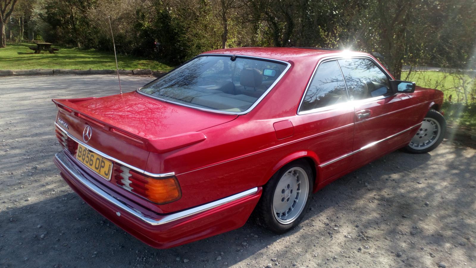

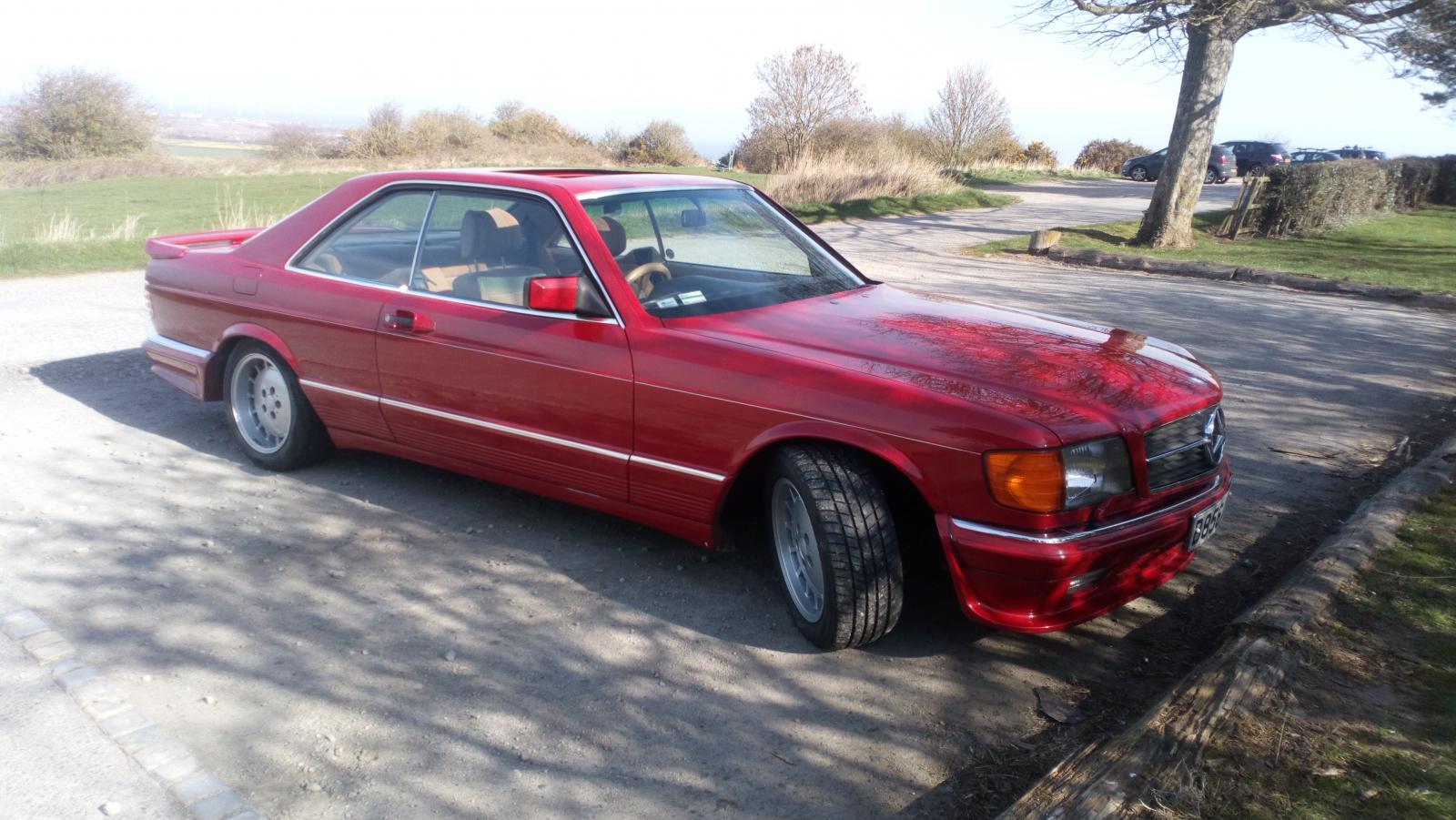

Please stick some more pics of it up as I thought it looked bloody spectacular!

Sorry, no new pics the only ones I have have been posted though someone else took some at Tesco's today! The pics flatter it, the paint is  bloomy and  could do with a good cut and polish but my priority has been getting it useable first.

It's had a week on general work duty so it had a scub up this morning.
The pics flatter it a little, the paint is a bit patchworky and the horizontal stuff is  bloomy and swirly.
Good result on the stat. Maybe the Mb replacement one was a bit lazy just to lead you astray? Having said that I’ve bought loads of new Mb stats over the years and never had a dud, although each of the 4 v8 126 chassis cars I’ve owned came to me needing a new one due to over cooling issues.
Car looks amazing BTW!
