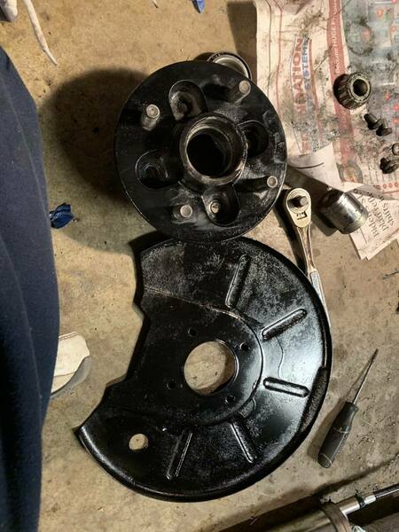

I've been on a "neglected maintenance" kick.

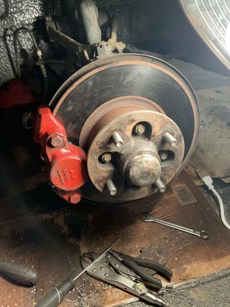

A few weeks ago, I started doing the front brakes(which had a lot of meat but definitely were getting thin-thinner than I realized until I put them next to new pads). I'd had pads+rotors on hand for a while. I had also bought new calipers at the time, but decided instead to get adventurous and rebuild the Lockheed calipers.
I guess I never had looked at it closely, but didn't realize the rotors were bolted to the BACK of the hub. I guess that's not a terribly uncommon arrangement on older cars, but it was a first for me after being use to basically just having the rotor sandwiched between the wheel and the hub on the lugnuts as on a modern car. At first I said I'd just leave the old rotors, but was unhappy with it left like this(please excuse my poor rattle can work on the caliper-it was more a rust preventative than anything)

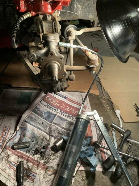

I figured I really should just break down the whole stub axle and service it, and then replace the rotors while doing it.
So, I broke it down to here
I had bought new bearings-they're inexpensive and are an in stock item at most auto parts stores . As it so happens, they are shared with most 70s full size GM cars(which means to me either the GMs are grossly undersized or the MG grossly oversized-I'd lean towards the latter). In any case, though, my old TImkens were perfectly fine after a clean up and repack, so I chose quality Timken over Chinesium replacements.
The hubs were a real bear to separate from the rotors-it took a lot of PB Blaster and heat to get them to cooperate. Fortunately those are a hardware store part, so they got replaced with new.
After that, I spent a while slathering Naval Jelly on the hubs and backing plates, then wire brushing to clean up.
Again, this is ugly rattle can work but at least it looks better than it did and will hopefully not rust for a few weeks at least :)
All of it back together

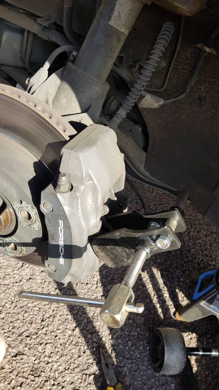

3 hours ago, SiC said:
When I first worked on my MGB, fixed calipers were a revelation to the sliding calipers that I've only ever worked on before. So much easier to work on and less sliding surfaces to seize up. Stuff I worked on before was moderns, I presumed that calipers were all of the sliding variety.
However since getting my 986 Boxster, I realised that fixed calipers are still used on modern cars but invariably it's the performance stuff that gets them. Presumably because they must be considerably more expensive to manufacture than sliding. The Boxster gets them because a lot of it was a parts bin raid on the 911.
They also were considerate enough to put a bleed nipple on the outside for easy access.
http://986forum.com/forums/attachments/diy-project-guides/16705d1350863097-rotors-pads-calipers-completed-img_0495.jpg
If all calipers were like that, brake work would be an awful lot easier.
It was definitely a surprise to me too.
And yes, I agree that ti's a superior design. On Boxsters and others that use a fixed caliper, can you change the pads without removing the caliper like you can an MG?
I got "ruined" on sliding calipers after an annoyingly sticky sliding pin killed the right rear brake on my Lincoln. I pride myself in staying on top of stuff like this, and I can remember being on the road one day making the ~300 mile trip to my then-girlfriend(now wife's) house. I made my halfway gas/pee/water stop, and when I went to slow down on the interstate heard an almighty roar from the back of the car. I limped into the gas station and found the right rear metal-on-metal seemingly out of nowhere. Since I still had 3 good brakes and the off one was a rear, I decided to just keep on trucking(maybe not the best idea-you don't play with brakes-but I also had other things on my mind).
The car had 50K or so on the clock at the time and still had its factory pads all around. The usual rule of thumb I've heard is fronts at 40K and rears at 80K, but that car has done enough interstate miles that I only did the fronts at about 80K, and even then because "I have the time and the parts to do them now even though the could go longer."
In any case, of course I broke it all down, borrowed the retracting tool from Autozone since Ford does the twist-to-retract rear pistons(not sure if it's related to the handbrake tying into the disk rather than being a separate drum-in-disk), and threw new pads and rotors on both sides. I didn't change the caliper, but took it apart as much as I dared to clean and grease every sliding surface.
A week later, I take off to drive to work. I'd had the handbrake on overnight and it was a chilly morning. I get out onto the street and say "something's not right"-the car is struggling at 35mph and pulling to the right. I'm in decent traffic but am on a surface street, so go about a mile before I can pull over. By that point, I can smell brakes, and in the dim morning light I walk back and see the right rear rotor glowing red. I gave it a minute to cool off, then hopped back in and it was fine. Another trip inside it to regrease it, and it's been fine since, but I check and double check it on cold mornings.
Yeah it's pretty much identical. Retract the pistons, remove the split pins and pull out.
There is a big pin in the middle that the pads slide on and keeps them in position. This is handy as it stops them falling out of place. I keep having that problem with my BGT and the anti-squeal pads move out of position too. Making some horrific squealing noises when breaking.
I used the insides of a piston spreader on the top of the pads to push the pistons inwards.
You can see the four pots that make up a four pot caliper that you sometimes on some cars in brake upgrade kits. This is stock on the Boxster though. I guess it allows repeatedly high speed braking (e.g. track and/or autobahn) with good stopping force.
The red wire is for the brake wear sensor and simply clips in a circular hole in the pads. Essentially it's a consumable piece of wire that wears away when it hits the disc. As it's a normally closed circuit, the warning light will indicate when the circuit is broken. However as the wire hits the disc first, that creates a path to body ground and thus causes the light to trigger. Hence the light starts indicating before the pads are all used up. The light latches and reset on ignition off. Simple but effective.
Perhaps the friction material on your Lincoln came away from the backing pad? Not a completely unusual ocurrance on cars. More of possibility if the caliper is sticking and heating the pads up a lot more without allowing to cool off too.
For all the flak German engineering gets over complexity, I'm loving how simple that pad wear indicator is. That's actually brilliant.
One thing I ran into on the B as pads go is that I had one set-bought from Moss-that just was a little too big in every dimension. I spent a while modifying them, but still was never happy with their fit or their movement, and yes the rattle shims kept coming loose in my doing that. I found a box of I think TRW pads that I'd forgotten I had and they dropped right in without any trouble.
