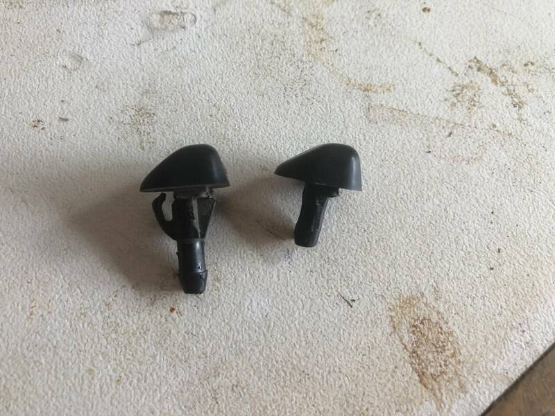

Another small job ticked of the list today. Last week one of the windscreen washer jets snapped off where the rubber hose slips on, rendering the washers inoperable.
My side of the road fix involved whittling down the body of the jet with my Stanley knife so the hose would fit over it, this worked but as the jet now had no locating clip it would move around and poke out of the bonnet.
So a trip to the local Toyota dealership later and I had a pair of new jets (that cost far too much for two little pieces of plastic).
The added bonus of the new jets is they have a rubber gasket to stop them rattling in the bonnet, I’d imagine mine had rubber gaskets at some point but these had long since perished and disappeared.
Minor adjustments were made with a pin and they work flawlessly.
